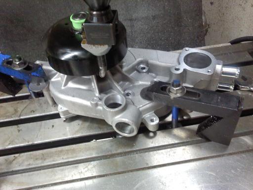

I have googled it, no solid answers. What is the best way to remove one, and where can I find a new one? I will be boring out the boss on the front of the water pump.

just wiggle it while twisting.

A Little heat and twisting as you pull, is how I have removed them.

Will I got it, and machined the front boss. Kind of screwed up the tube, will have to machine a plug, and a new tube.

That looks like a boring job, lol! Looks good. Can't wait to see how it turns out.

Here is what I have come up with.

Do you realize you could have purchased an LS1 water pump and .75" spacers to achieve the same thing? Unless you needed the mechanical fan boss.

Yes, but at what price? This was free for me, just my time, I have more time then money right now. And I wanted to use as much of the truck parts as possible.

I say good job. I'd tap the top for a bleeder.

Same problem, different solution. I put the truck pulley on the LS1 water pump (I needed the mechanical fan and truck spacing.
BTW, I did play with moving the fitting to the front, but messed it up.
