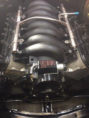

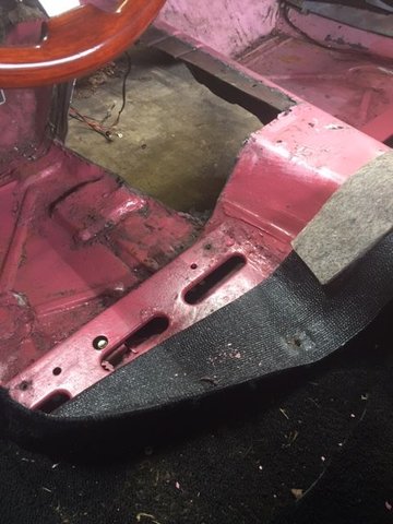

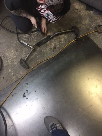

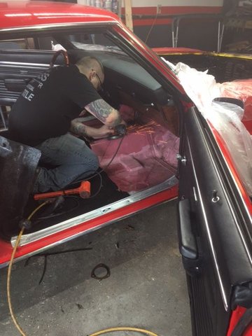

I was able to finally start the 6.0 liter swap in my 69 Camaro. Here are a couple pics of the start for now.

Its already a finished car so nothing there to do. Itll have the 6.0 woth a T56. Already has 9inch rear with 3.70. BTR cam with ported LS3 heads. Itll just be a street car with maybe a little street racing now and then. I took out a sbc 383 with 4 speed.

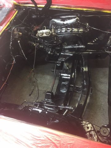

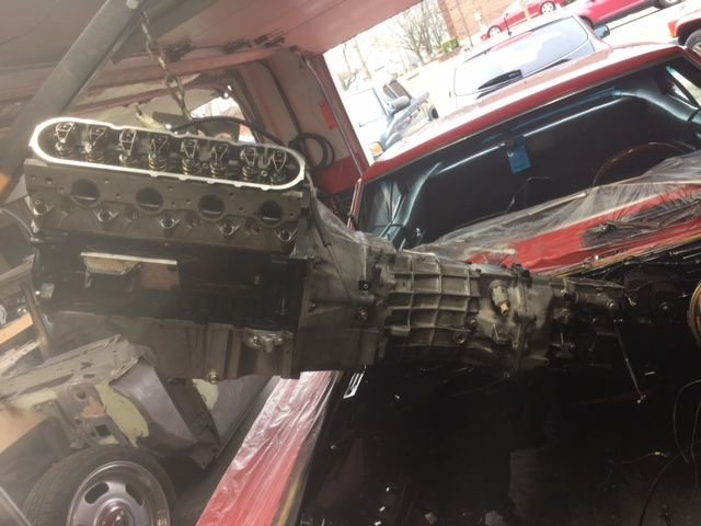

Couple more

Quick question for anyone who knows. I kept my original steering box and linkage rods. just a quick glance it looks like the rods when i turn the wheels is gonna hit my oil pan. I used the fbody oil pan which worked great for clearance from the crossmember. but its does look like the rods is gonna hit the oil pan. if this is the case, what has others done to fix this issue?? thanks.

I used the MAST oil pan on my 67 camaro and everything clears the linkage with that. What I was told is match the oil pan, headers, and steering box and make sure that they all work together.

Mast pan is a great recommendation. The fbody pan will be a tough fit unless you move the motor quite a bit forward. As you see, it will then hit the linkage. I feel the best package is the complete set of holley parts- their newest pieces that match with the 302-2 oil pan. These holley parts work together & take out all the guesswork , including the the correct driveline angles- without cutting the tunnel. If you already have all that stuff, the mast pan is the best choice. It has the best clearance of all the pans I have used.
