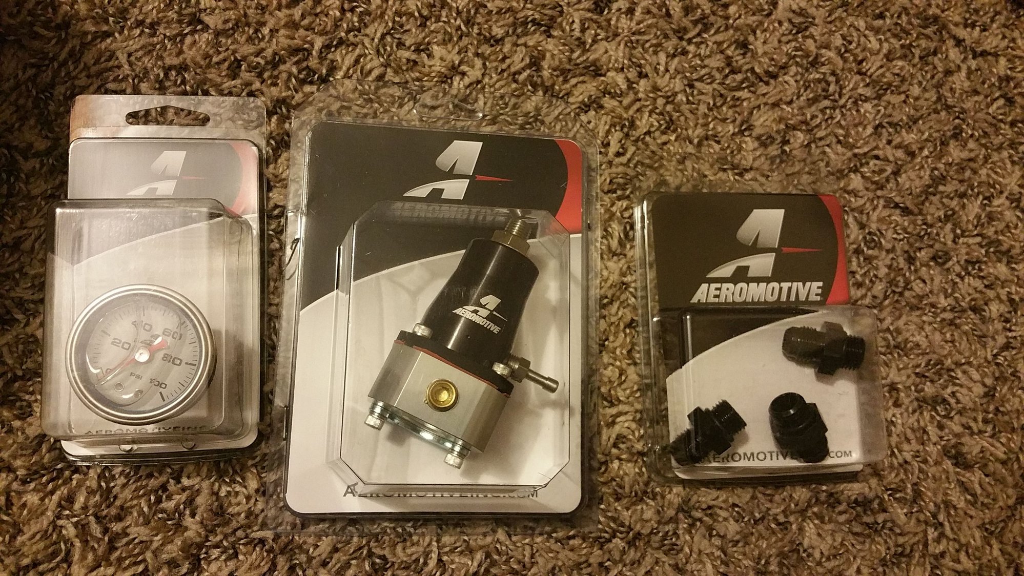

For the fuel system iv got an aeromotive 340 and a pro m racing dual 3/8" an fitting pump hanger going to an aeromotive regulator, and -6 an trend e85 compatable fuel hose with trend push on an fittings.

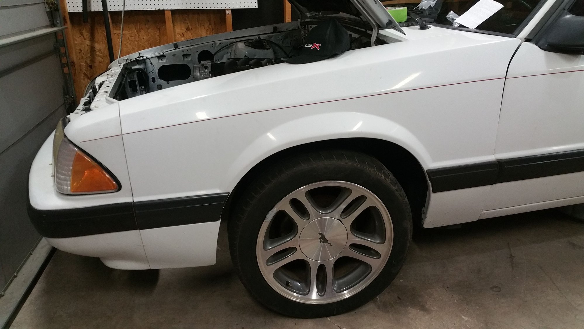

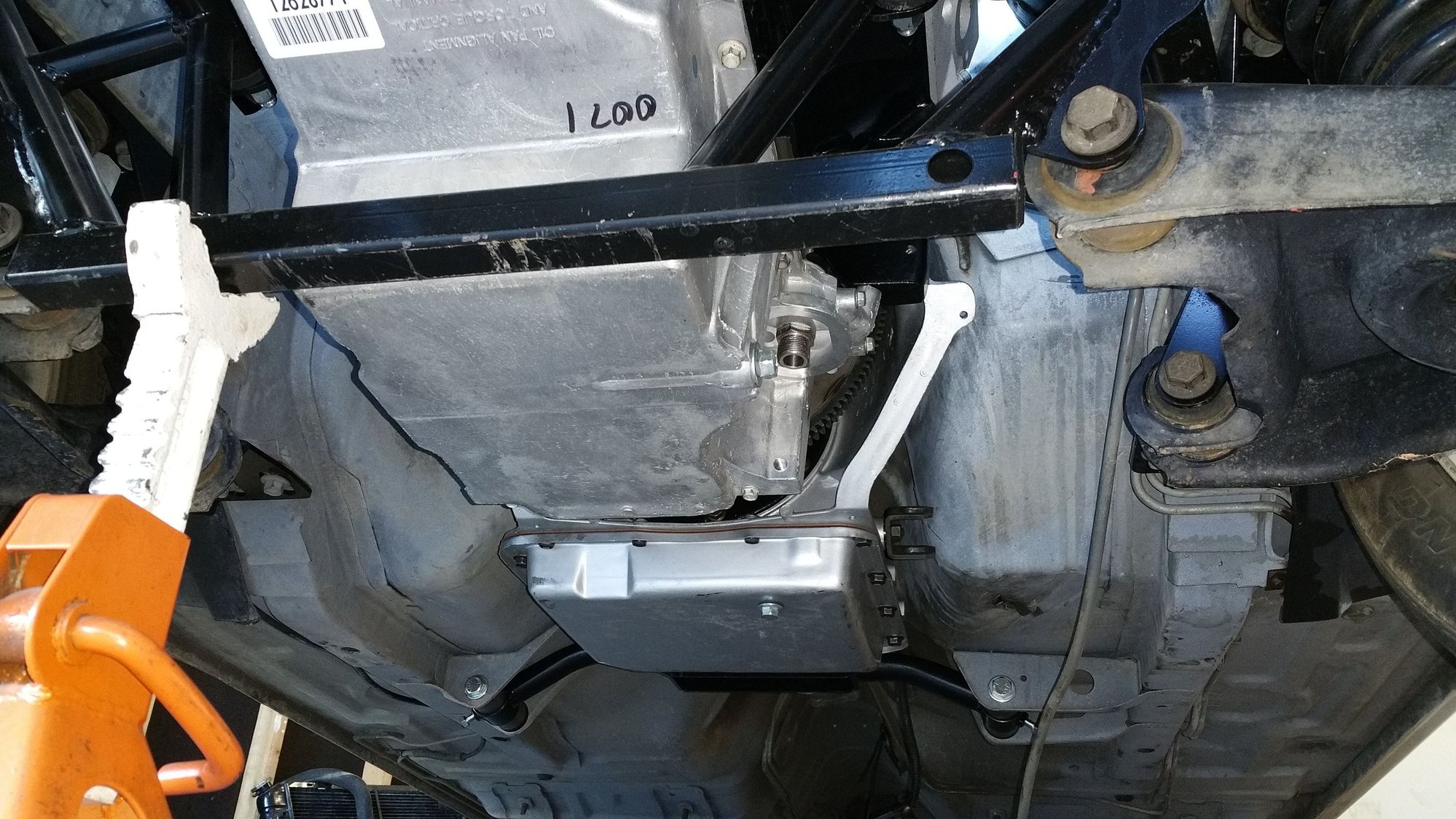

There's some time period differences here, but the upper pics are new, engine is in the car with the new balancer, headers are here but not on at the moment, and the car is on all four tires with the 5 lug stuff. As you can see, im going cheap for now with the stock springs, and some koni str's. I'll do coilovers and tubular arms in the future. I have 4 mouths to feed haha. The car is VERY clean, owned by an old lady its whole life and stayed here in colo so not even a hint of rust. Picked it up running and driving for 1500.

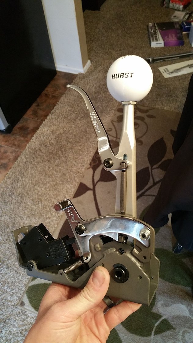

Also ordered all my accessories, manual rack, plugs, wires, hurst quarter stick shifter with backup light switch, trans cooler, 30map fuel pump wire kit, and all the engine sensors today.

Those headers are nice and there only $300 shipped right ?? Do they have a 3.0 collector ?? It seems like the drivers side header could be a little closer to the trans so that the exhaust clears the trans cross member better ??

Yes 300 for the headers. They are a 3" collector with 02 bugs. They could tuck a little better to the trans but it alot better than the pic looks, definitely worth 300.

Made more progress after getting an order of parts. Got a 100 dollar rack from ebay, works great. Got a 35 dollar ujoint and welded it to my stock shaft since the stock upper ujoint was perfect. tie rods were good so i used them, saved a ton of money doing all this and it feels way lighter than i thought it would, totally fine for a daily. Got the quarter stick shifter, all the engine sensors, mass air flow sensor, braided dipsticks, fuel pump wiring and relay for the aeromotive 340 setup. Lots of work to do now. I can install the whole fuel system, and shifter now. Looking at making may own engine harness, not that difficult, just alot of time into it if i go that route.
