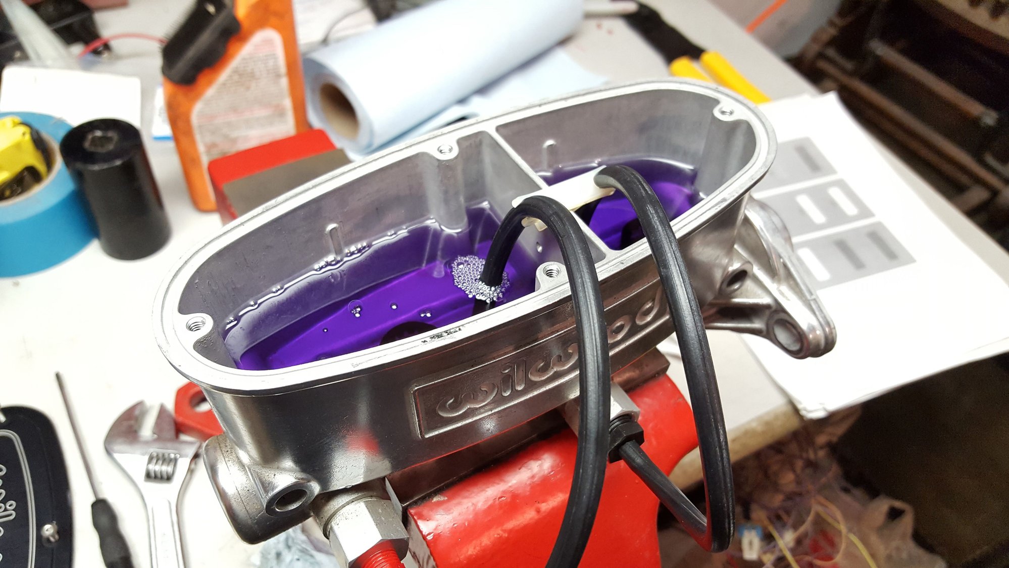

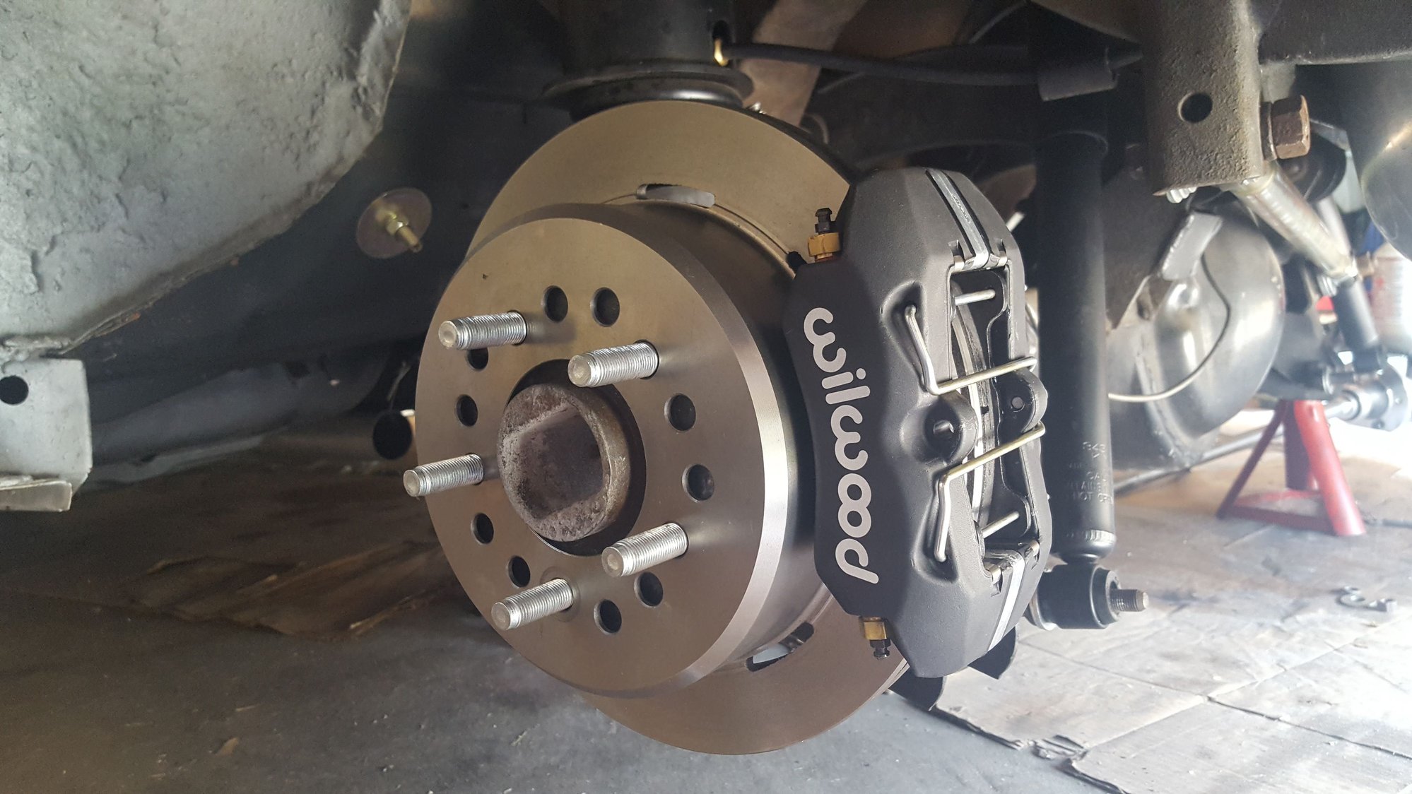

I ended up putting Wilwood disc brakes on all 4 corners. I put a 1" bore master cylinder on the car and it doesn't have enough braking power. I'm assuming I'll need a 7/8". Little brake bleed for fun!
Fun fact. These 4 piston calipers have as much braking power as my drums.

A 1" master is for running a power booster not manual. Do you have a proportioning valve on it?

Those 4-piston calipers have MORE braking power than your drums...

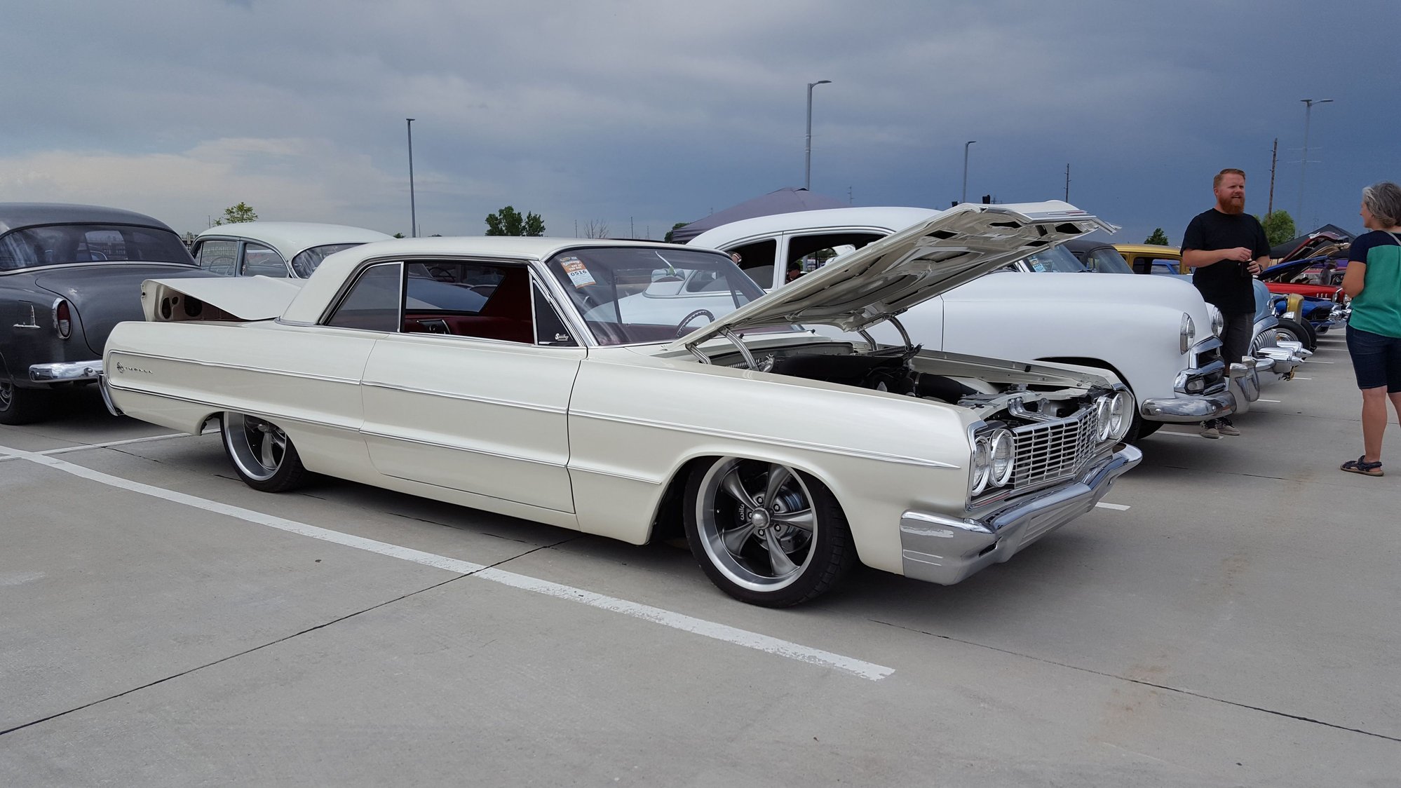

Alright time for some "finished" photos!
Wife picked the plate.
Day At The Hay Goodguyss show 2016.

Nice looking ride

Always liked the '64 for its clean lines. Nice job! AND good choice on the wheels!
