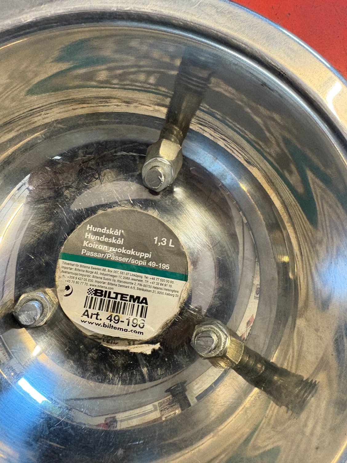

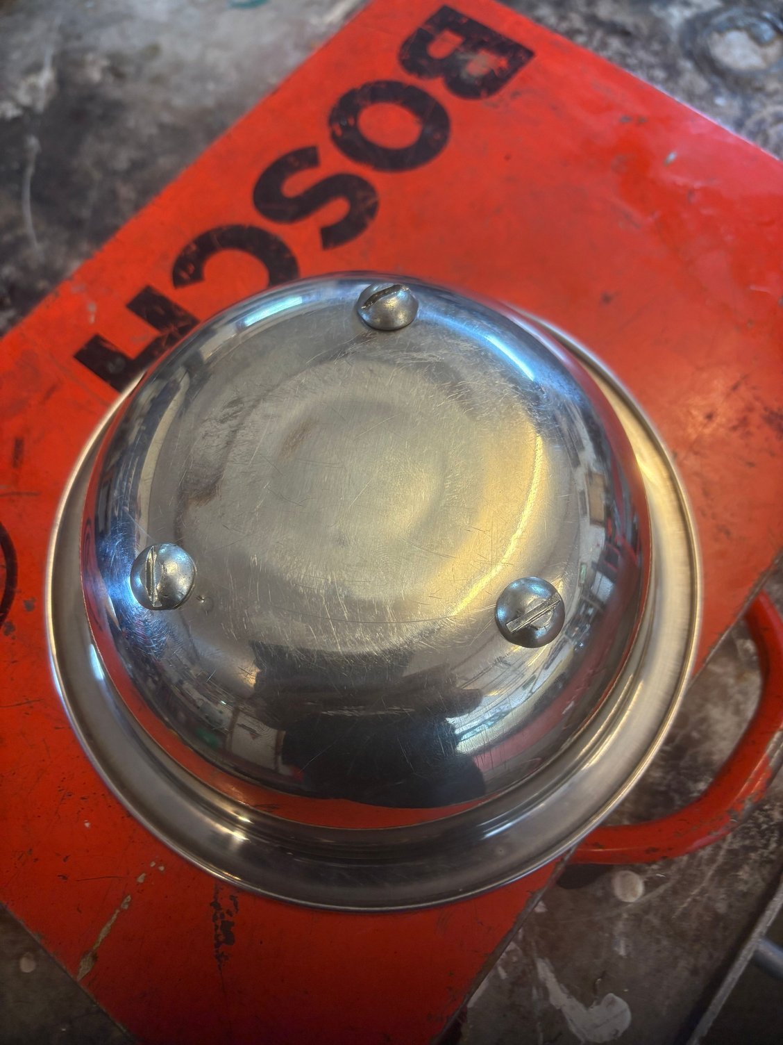

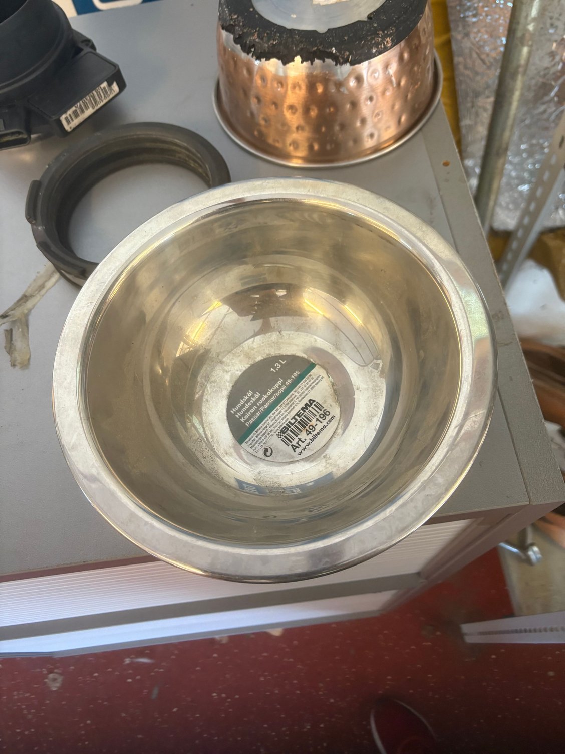

I try to find some garage days occasionally , and now first step for the engine compartment are done.. I found a way to cover the coil on firewall, and i cant say other than it looks much better than before.. but one of my weak point is that i never are 100 %satisfied........... When i start this project, i plan to use this cover, but after a while i changed plans, and put theme on my parts store.. Now i found a plan for using theme... I need to fix the side of the cover, and fill in for the recesses for plug wire... homemade bracket and welding... More work than i first thought.. ,as always.. need some work with glue and padding before paint.. I found an non GM expo tank, but i think it was time for exchanging the plastic coke bottle... Found a discreet nice place for the exp. tanc in the front of inner wheel house.. Try to do a look a like GM 60`S look. This accesorry came in 66 or 67 before or after...i`m never 100 % satisfied, but it looks better
