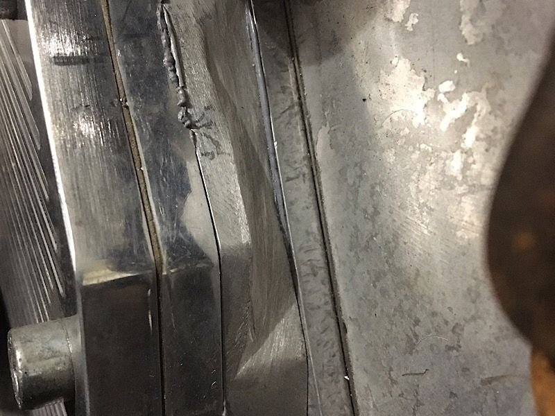

[QUOTE=Romulus22;19736864]Looks exactly like mine which is a Speedmaster. it flows well but the rubber o-rings did not seal well enough for me and I've had hit and miss luck keeping it from leaking. I also had to countersink all the hardware holding the motor on as it's so slimline it wouldn't sit flush too the block. Maybe they've fixed this by now though.
Mine is terrible. It works fine but leaked like crazy. I had to grind the back of it to make it clear the drivers side head. Also the fittings leaked and I had to goop gasket maker everywhere. It is garbage and I cant believe they cost so much. They should be ashamed for even selling them.
Old Oct 1, 2017 | 03:29 PM
  #43
Romulus22's Avatar
Joined: Oct 2016
Posts: 258
Likes: 42
I forgot about the grinding. Had to do the same thing although it doesn't much matter now. But you can see where. You can also see the gasket maker seeping out where I've abandoned and sort of gasket. I definitely wouldn't recommend this pump unless you absolutely have no choice due to space issues.
