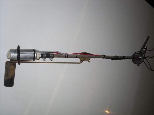

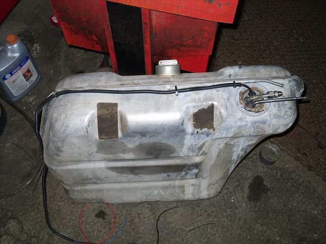

I put a pump on the stock hanger when i did the 5.3 swap in my 72 Chevelle wagon...I used a AC-Delco EP 381 pump on the factory hanger...
It's a little bit of work, but it's cost effective, works very well.

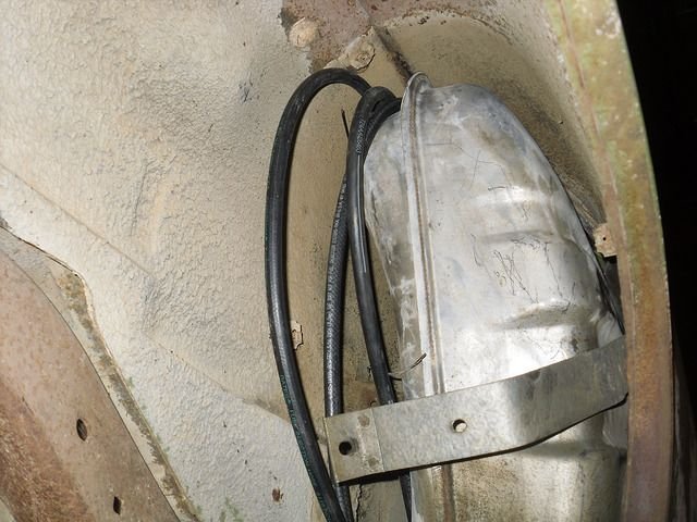

I suppose your tank is flat and underneath, it probably doesn't stand upright behind the left rear wheel well like mine... (I don't need a sump for fuel control)

my gas tank is like your , up right same spot

Well then, with a little work. I think you can make a factory electric pump work without to much drama.
If you want, you can PM me, I have lots of pics of when I did mine...
