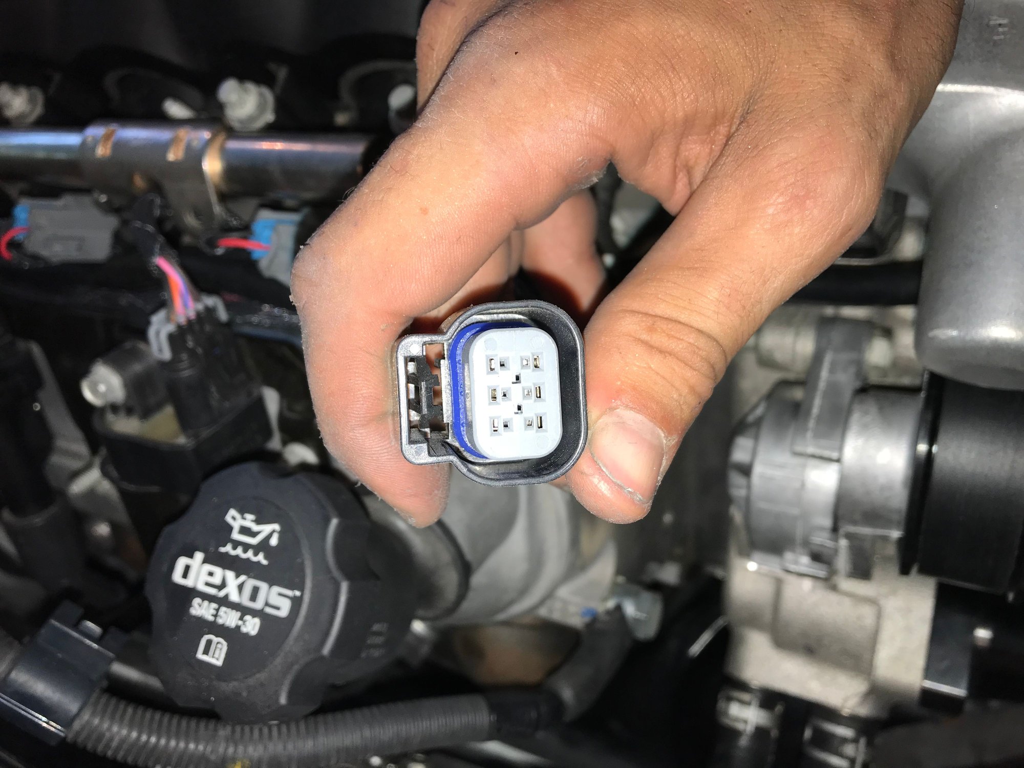

hey guys; I’m gonna keep searching but I got her running, but no throttle input. How should I go about troubleshooting it? I have a meter
Connector to pedal
Connector to throttle bodie. Thanks for any help!

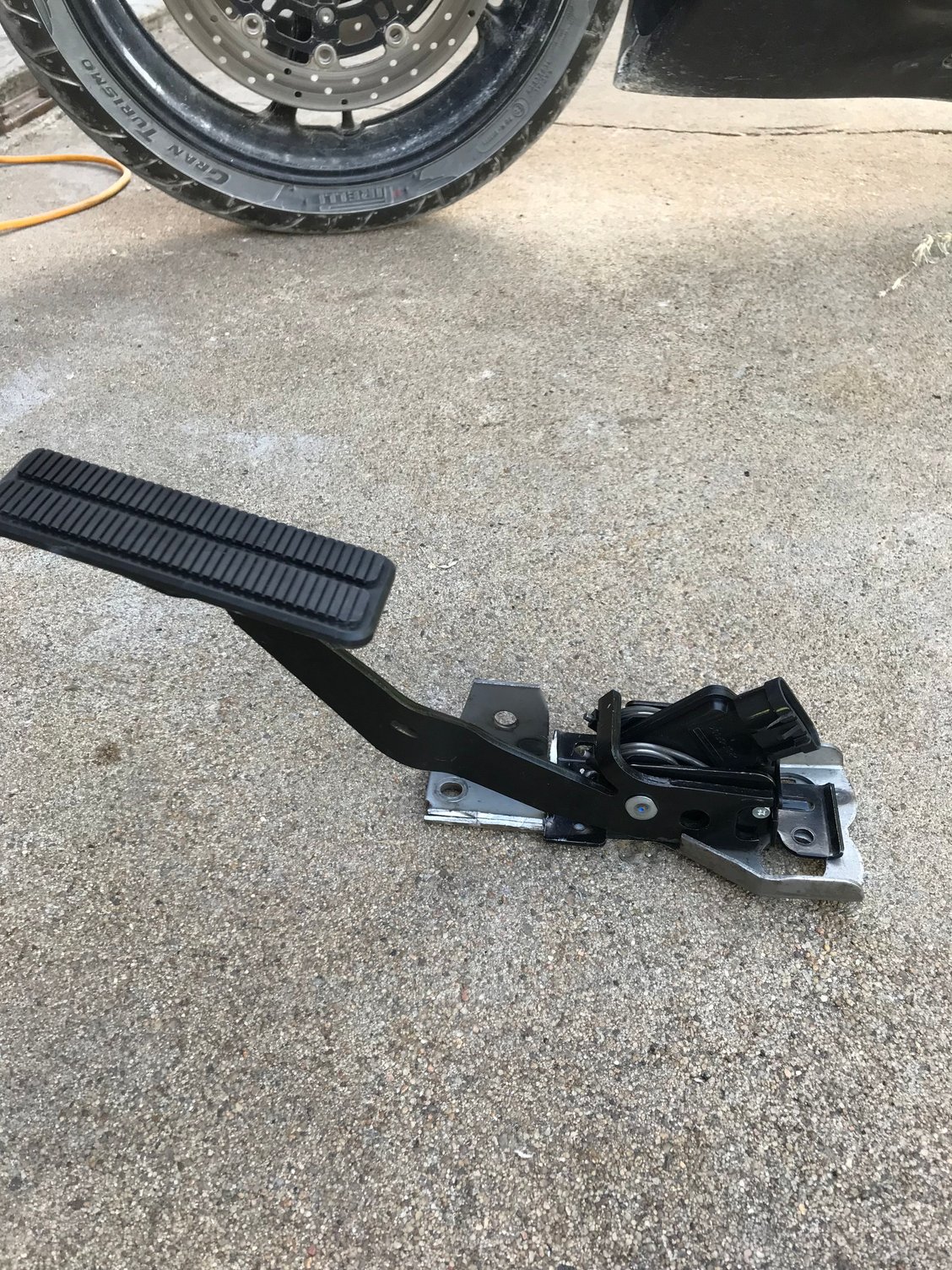

Its a tweaked performance ls -S2000 swap harness. The throttle bodie is holding idle and wont budge during operation; I tried to give it a little budge. So the ECU is controlling but not see’ing my input. How or where would I find a pinout to see if wires are correct.
straight to the pedal
ls3 / PSI E38 PCM / tweaked harness / I beleive corvette pedal got it from psi to

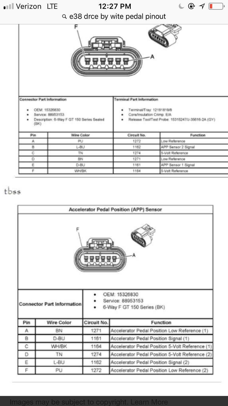

Here is a truck pedal pinout:
A- purple
B- light blue
C- tan
D- white/black
E- dark blue
F- brown
Compare this to yours to see if its wired as a truck setup.
Here is a vette pedal pinout:
A- brown
B- dark blue
C- white/black
D- tan
E- light blue
F- purple
But on most ls swap harness to run either a truck pedal vs. vette pedal u just swap pins D & F around.

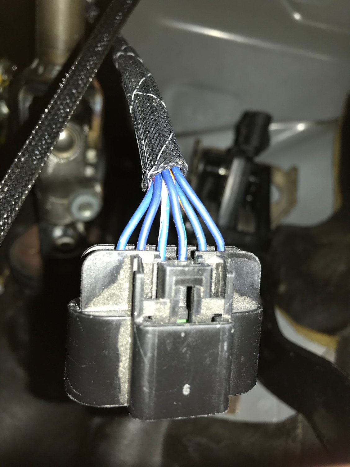

I took a peek at the wires and I think they were ALL blue! :smackmyhead: prolly why they got mixed up! Lol.
I sent an email about everything. Ill check the wires again tomorrow. Go from there. Thanks!
If it is the case (bad pinout) I might have to check continuity from pcm to the Pedal lead :sigh: only way to distinguish which is which.

All u do is swap pin D and F around from the truck orientation.
So if they are all blue just swap those 2 wires and give it a try.

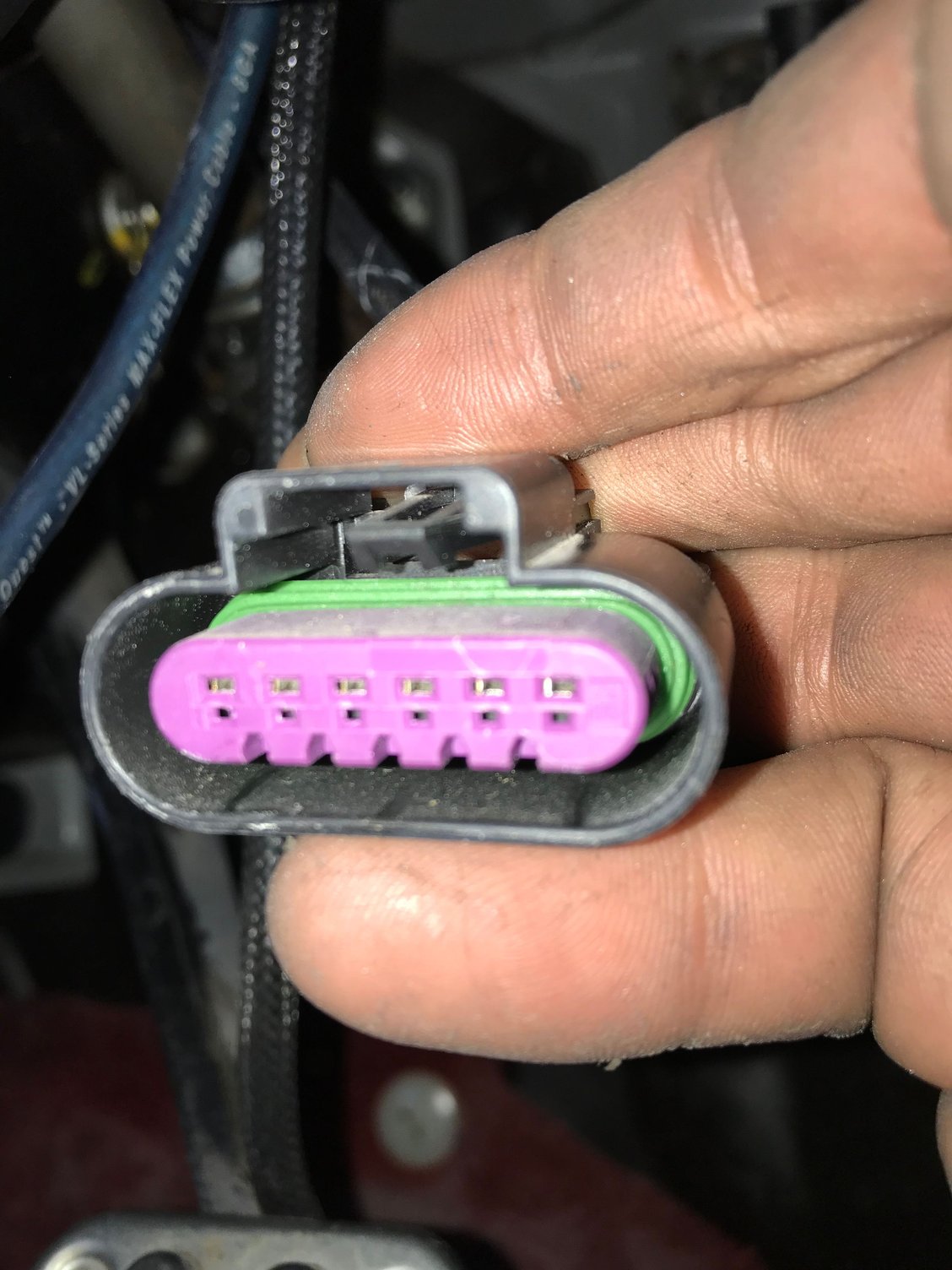

No letters to pins

Going by my last picture if someone knows which side F is I can swap’em.
