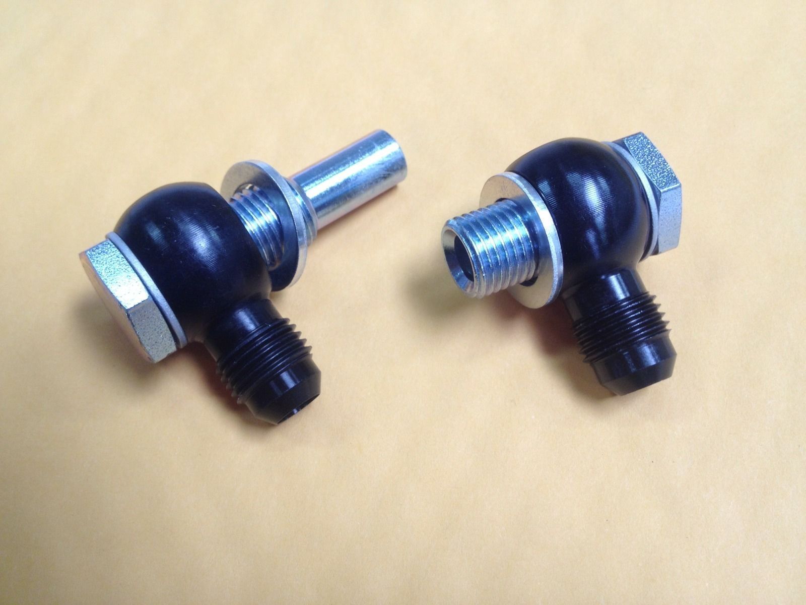

Which will work with a 4L80e and a Chevelle? I am using the forward biased Holley mounts. I don't want to get the ones that extend straight out if they will hit the trans tunnel, or something else. But I don't see any Banjo fittings for a 4L80E. Just interested to see what has worked for other people.

google copy and paste -
sweet performance 4L80E banjo 90 deg

I agree with 350SS Sweet Performance, I'm using them on my 4l85 in my 69 Camaro. Nice to deal with too. He's on E Bay and you can deal direct.

not those specifically. the 80e has one of the cooler fittings that has the extended dingus end on it. the 60/65 are both the short length ones.

In my 71 Nova with 4l80e I was able to use the AN fittings to replace the factory then run AN 90 degree elbows and they just clear the tunnel.

I like those fittings!!!! My friend has a 80e we just did in a 69 Chevelle. We ended up cutting the trans tunnel out of that car though. With where we put the engine at, we were not getting a 80e in it, with a stock tunnel. I bet those fittings work well in my s10 80E swap though.

Yea i like those fittings, simple idea and design. I got a ls swapped 71 impala at the shop right now with a 80e swap. These just might be the ticket! Thanks for sharing.
