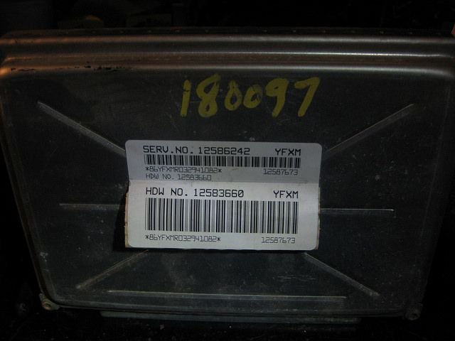

Hello,
Below is the number on my PCM. I'm trying to determine if it is compatible with the IAC drivers drivers. It's from a 2004 Avalanche, but I want to have it reprogrammed to accept the AC request like the Express Van did. I've searched and I can't come up with a definitive way to know if what I have will work. Does anyone know of a website or a way to find out for sure?

No i dont think tht one will work. Needs Serv# 12586243 to work. Yours is one digit off. I may have one that will work if interested pm me.

I can confirm - Service #12586242 is a 2004 Truck PCM which does NOT have the IAC driver in it. For 2004, the PCM which has the IAC driver in it is Service #12586243.

Correct, the 04 Avalanche has a DBW setup, and does not support IAC. You would be better off with a Express van pcm especially if you want the a/c setup. If you need one, pm me, I may be able to help you out.
