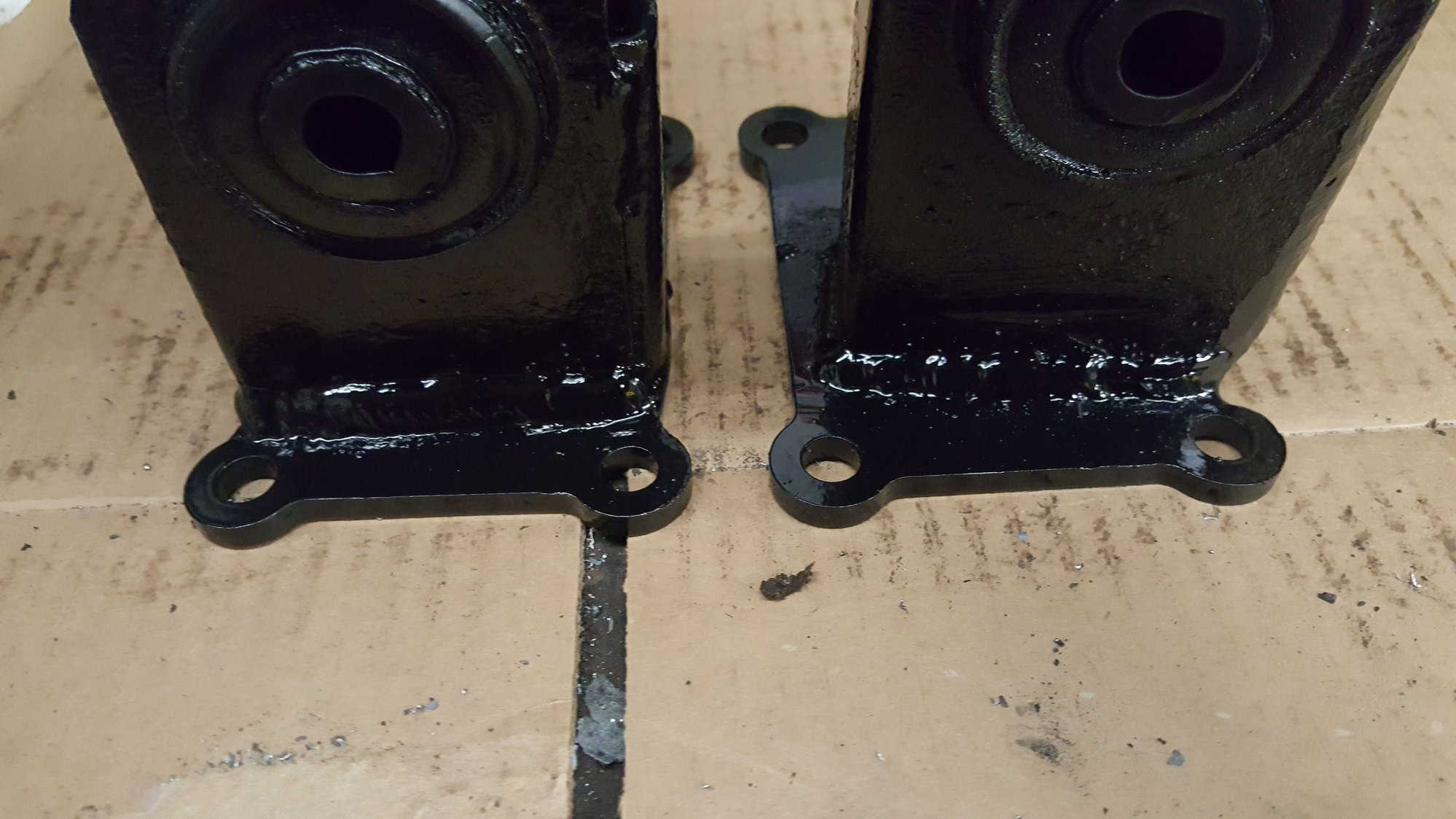

Those motor mounts are ingenious!

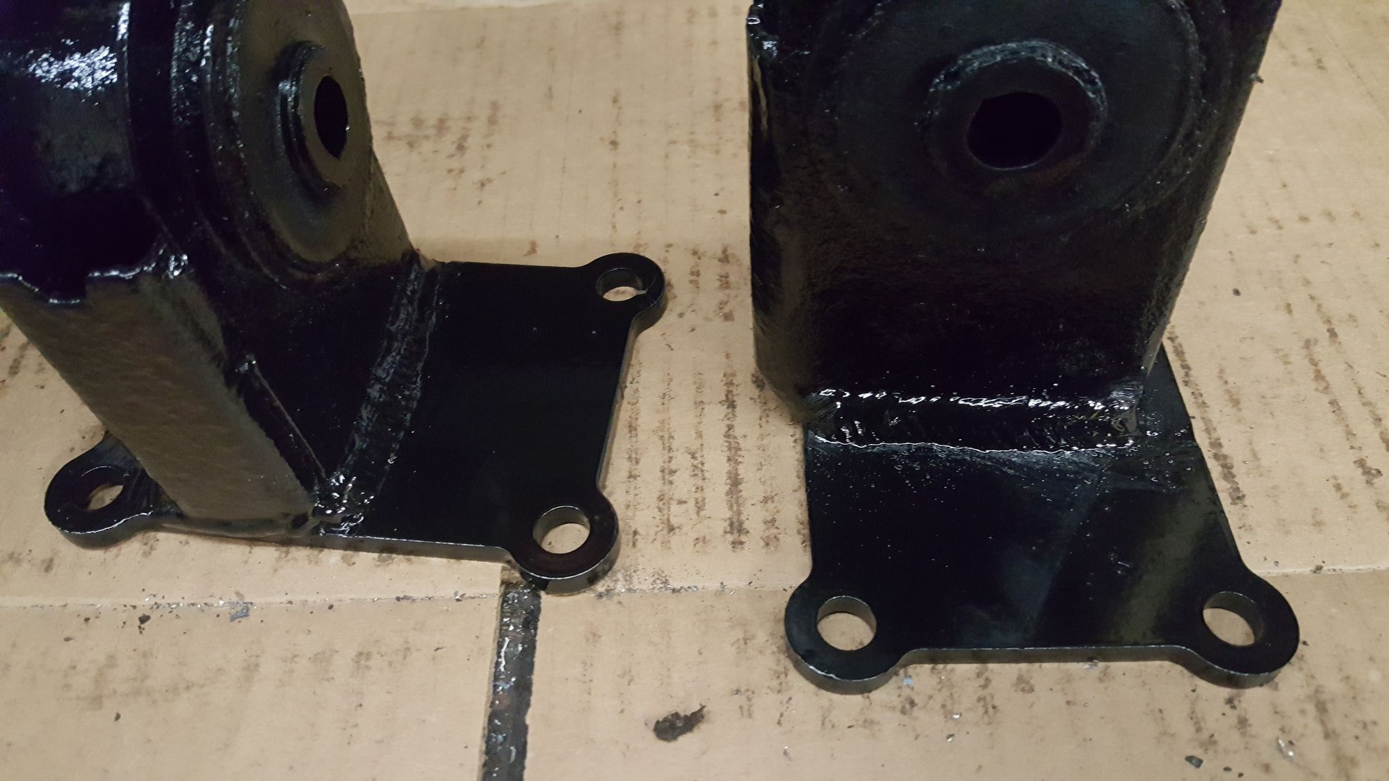

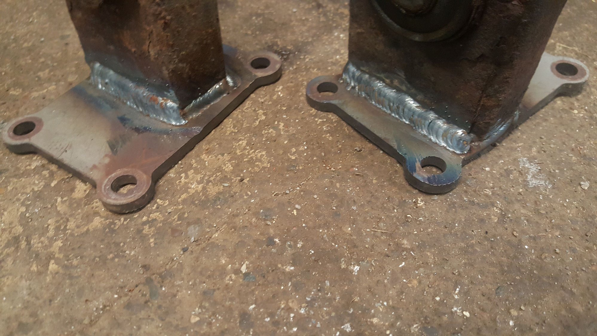

Thanks ! I'm pretty confidant that the rubber will have enough flex to keep it soft but I'll be reporting back to let people know how they work. If I had used new arms the other end the them use's a busing that's a lot closer in design to what the OEM motor mount rubber section would have looked like and would provide a lot more give if the solid rubber end proves to be harsh. They are not quite as wide as the original mounts but for getting the trans mocked up that actually worked out well. I was able to slide the engine forward/backwards about an inch as well as angle it side to side a bit to make sure it all lined up straight in the chassis. I may take the easy way out and just stack washers on either side of the bushing so they fit the frame pocket or I may get some tubing to cut down and make actual spaces.....haven't really decided what direction I want to go with that just yet.
Anyways here are some up close pics or the mounts once I had them on the bench to weld up and get painted.

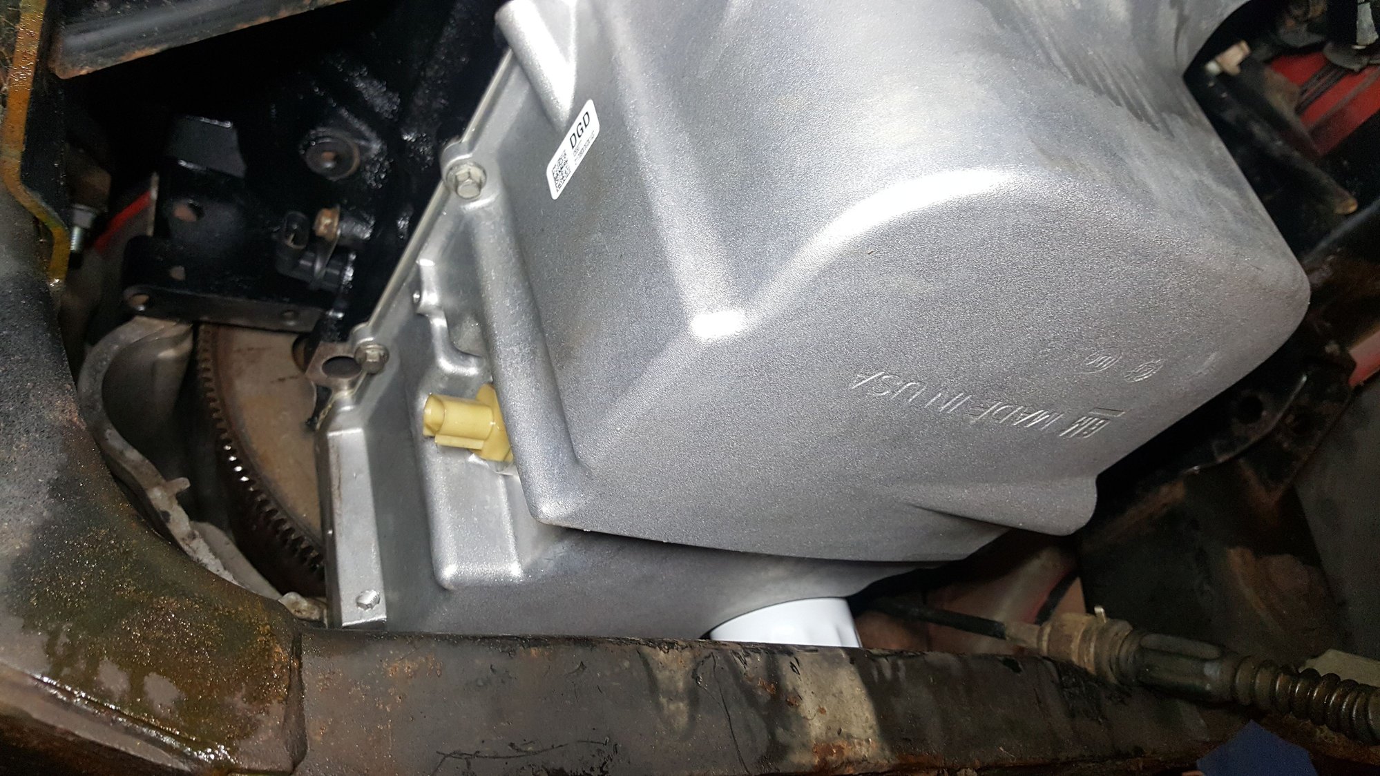

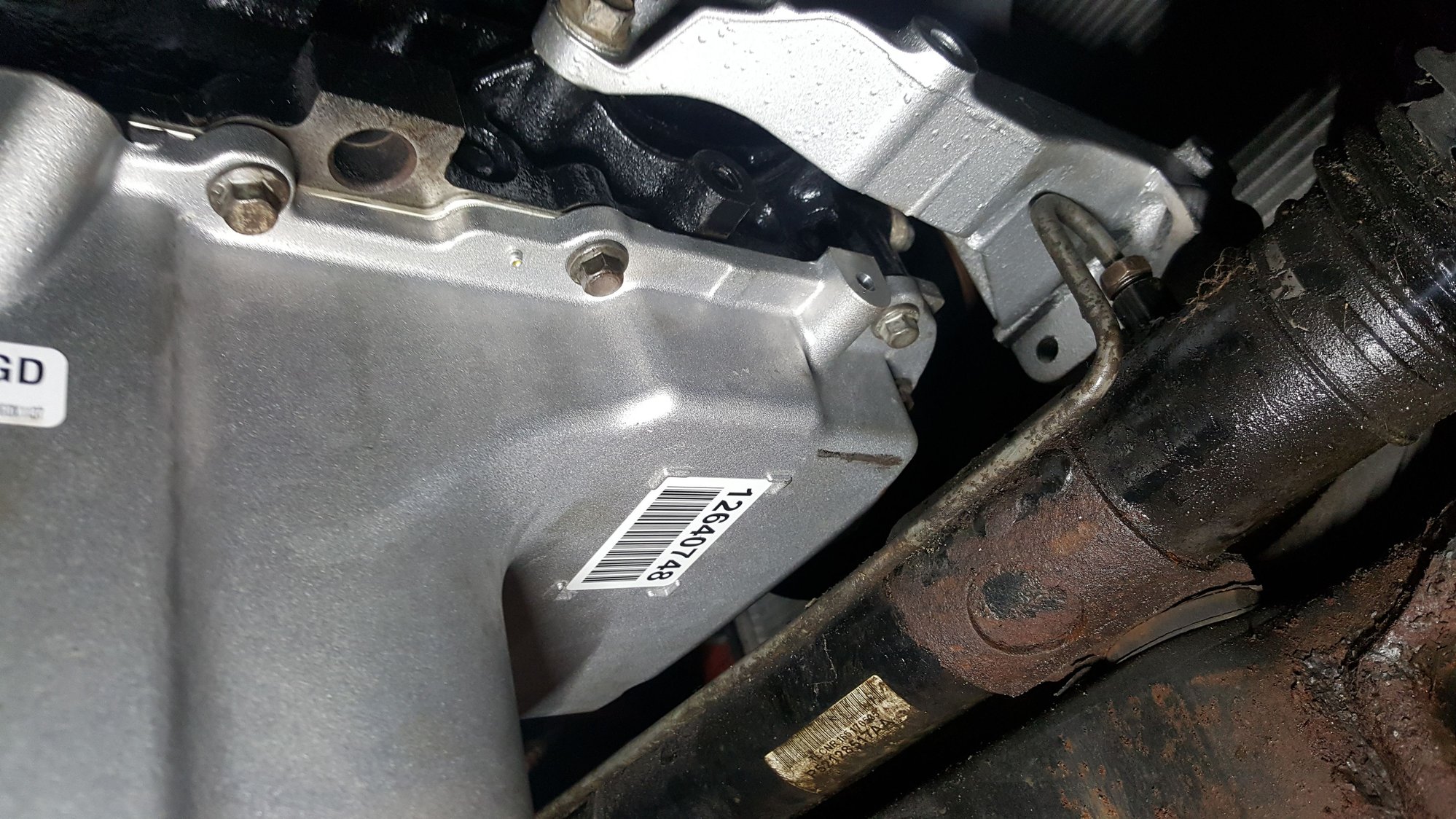

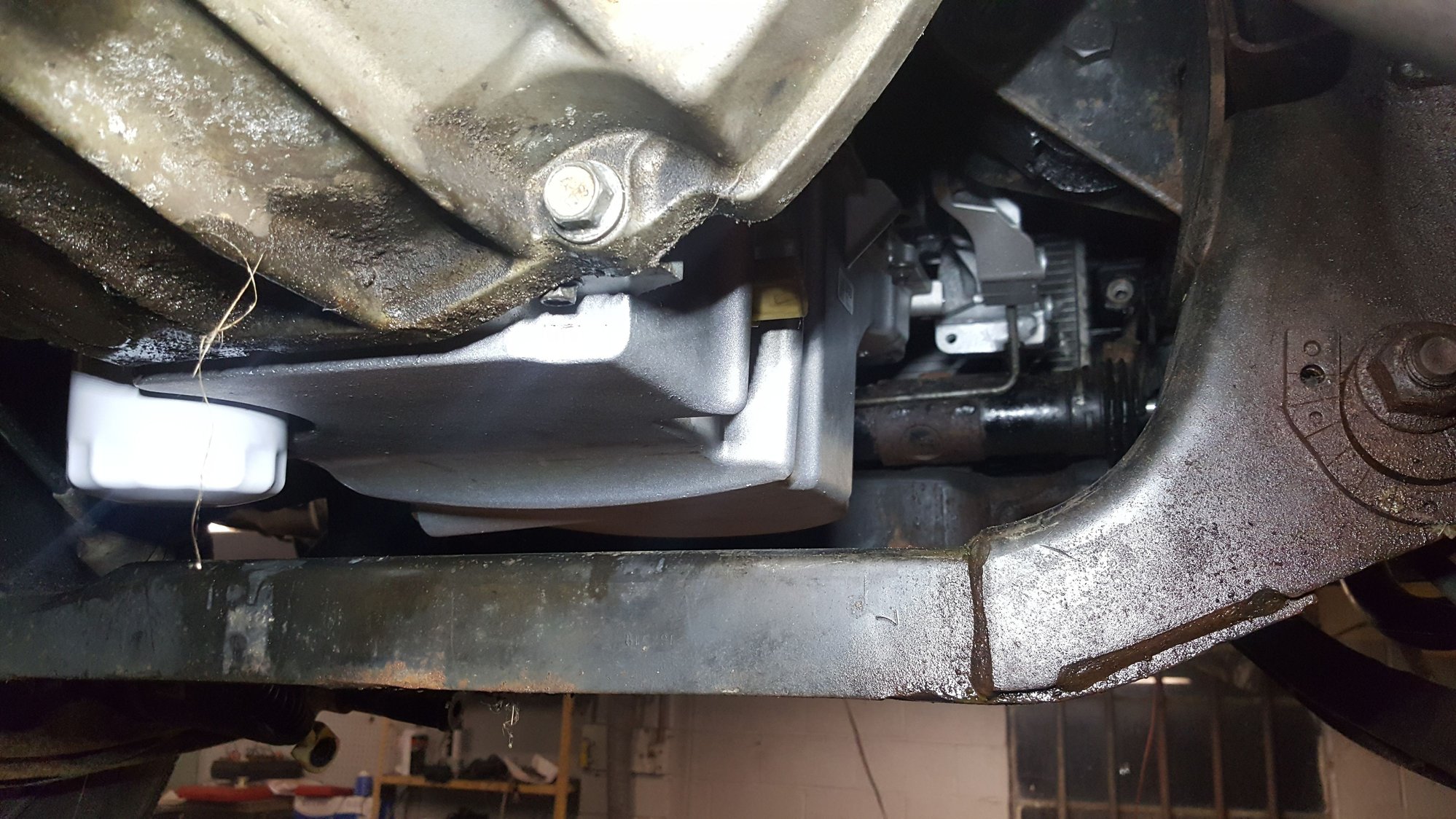

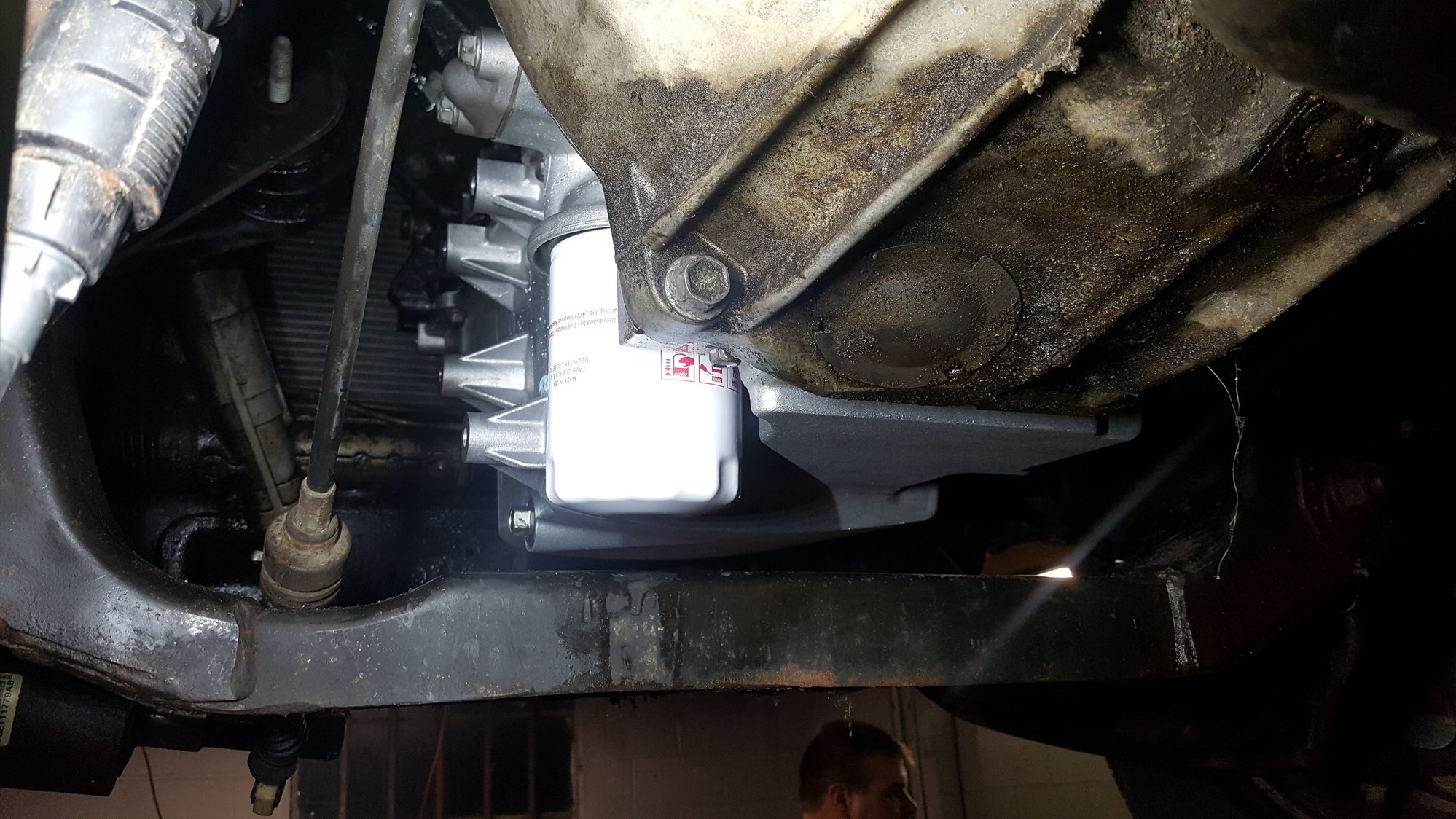

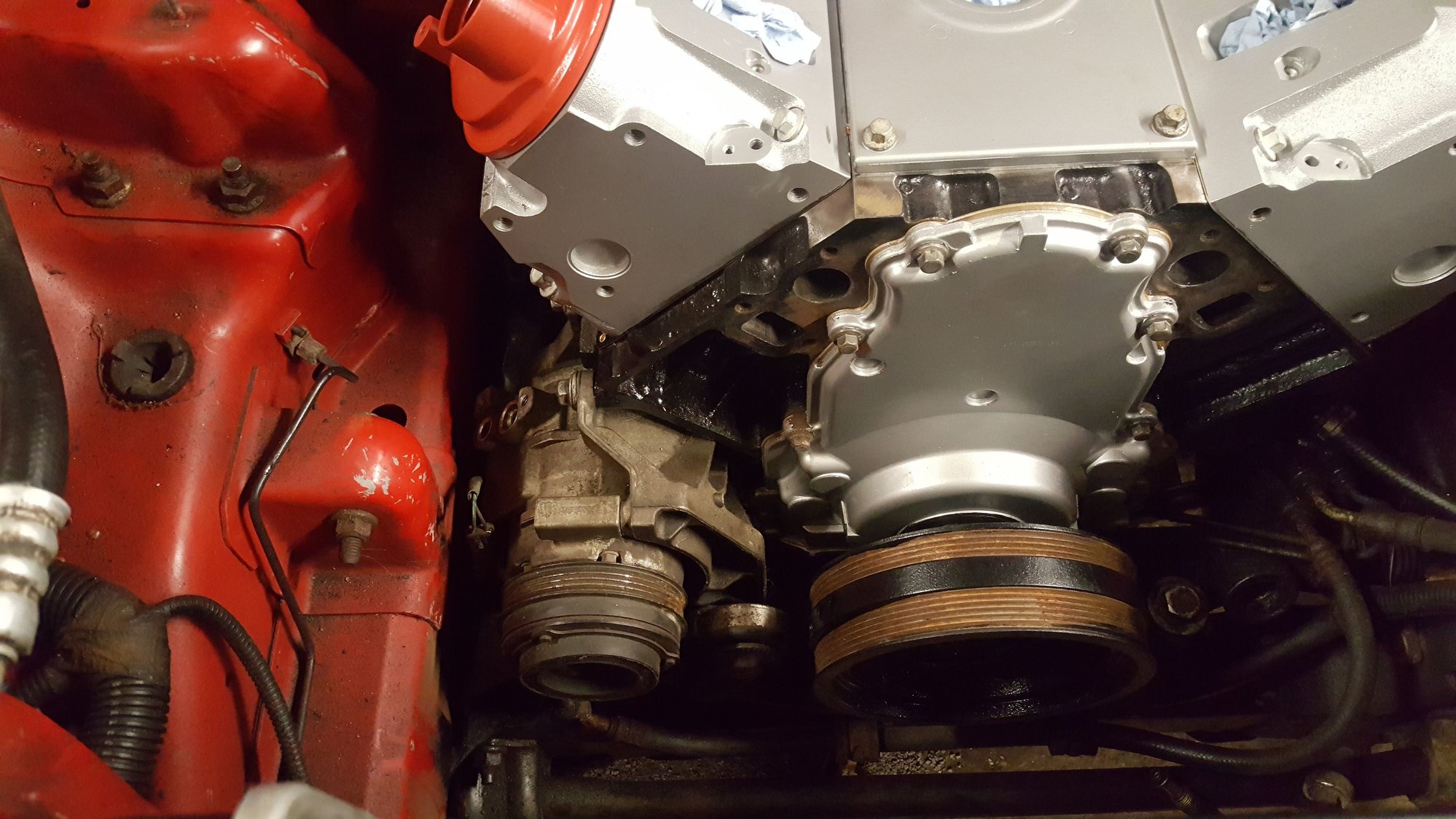

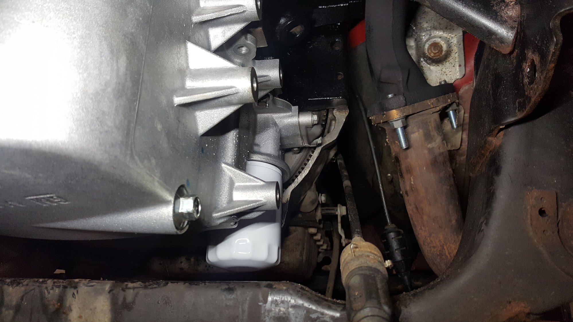

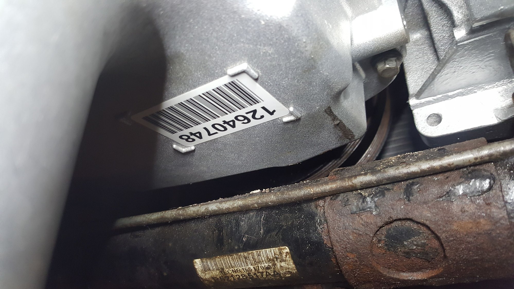

Trying to remember exactly where I left off at......So where gonna start with the oil pan. Once again luck was on my side and I just happen to find the absoulte PERFECT oil pan for this swap and it happens to be about the least desirable pan out there and is plentiful since it's what comes on the GMPP LS3 crate engine.
The pan fits the following applications.....
2010-2015 Camaro SS
2012-2015 Camaro ZL1
2014-2017 Chevy SS
2011-2017 Chevrolet Caprice PPV
2009 Pontiac G8
Pan# 12640748
Pickup tube#12611904
Pickup O-ring#12584922
Windage tray# 12611129
I do not have the matching dipstick since I'm not sure how it would have fit, I'll start with the truck dipstick/tube and go from their. Something I want to point out is this is a VERY large pan in terms of oil quantity holding 8 quarts of oil.
Spoiler!

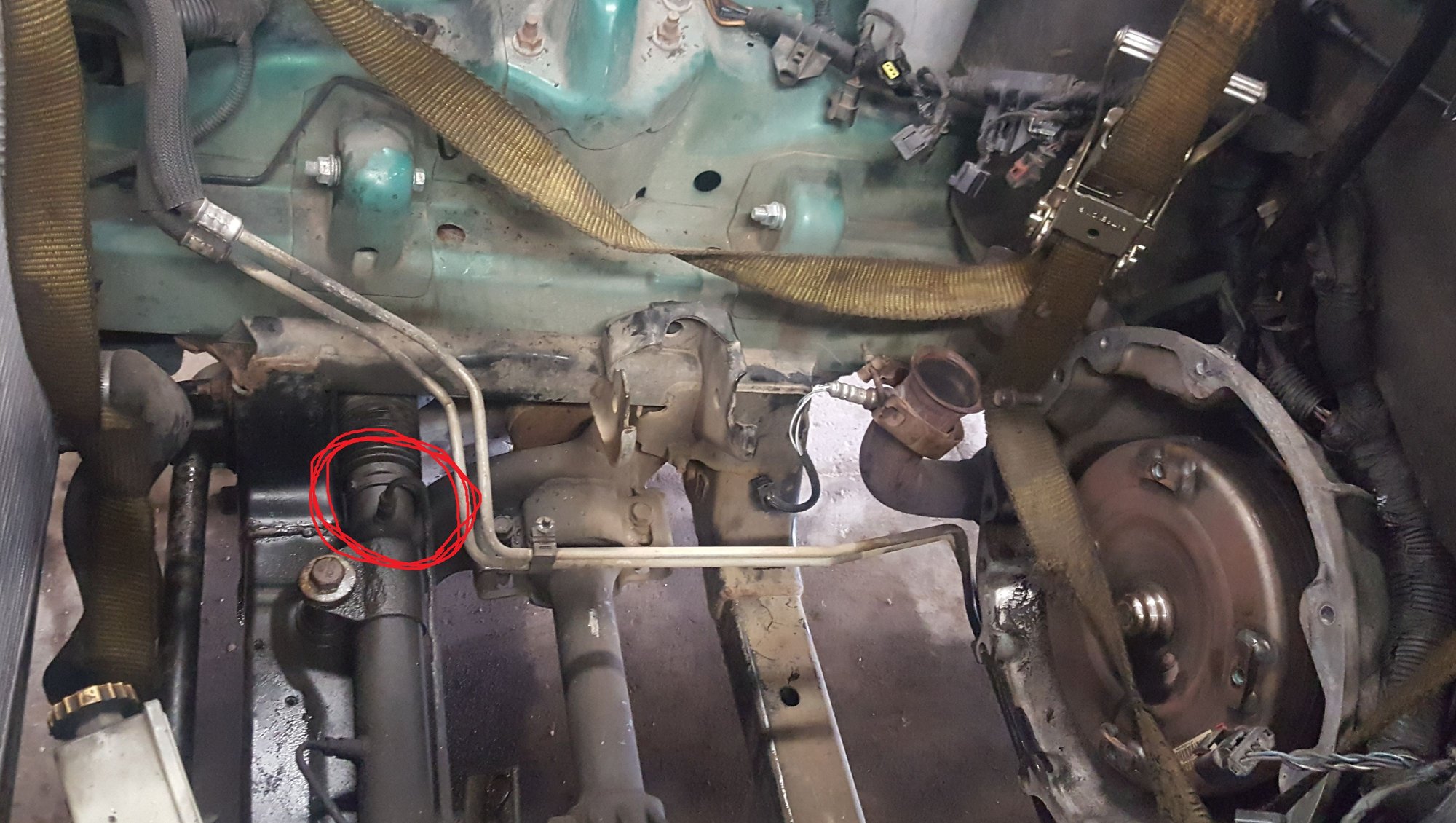

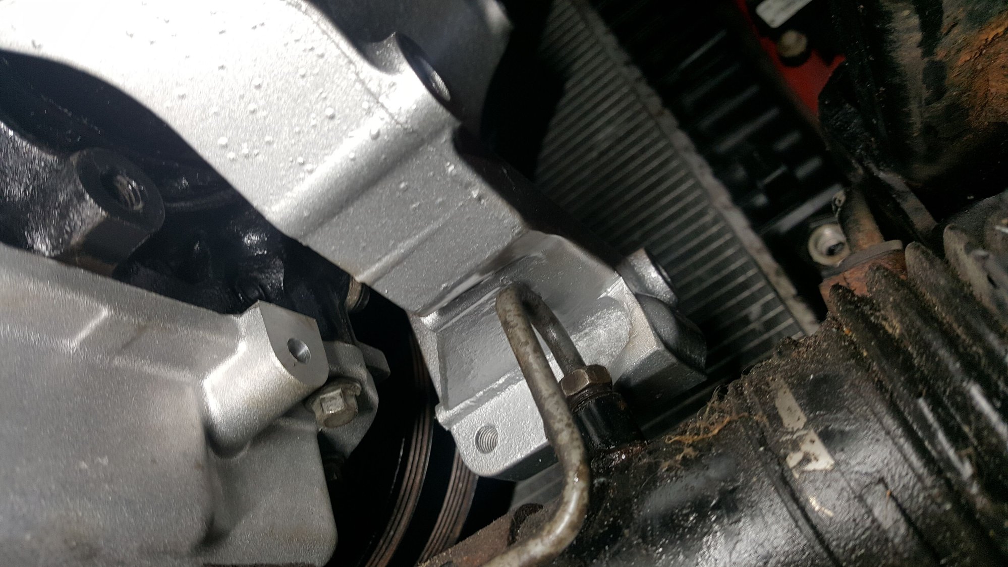

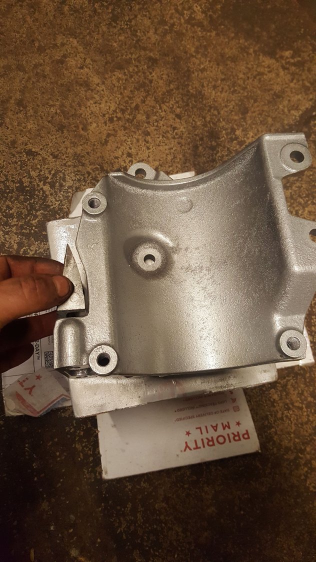

Since you can see part of the AC bracket in a couple of the oil pan pics I'll go over that next.
There is a fitting on the Rack and Pinion that will interfere with the stock truck bracket even after notching the subframe with the engine sitting this low in the chassis.
The Fix this this was actually pretty simple and looks as good if not better then the stock bracket from the bottom as well.
Spoiler!

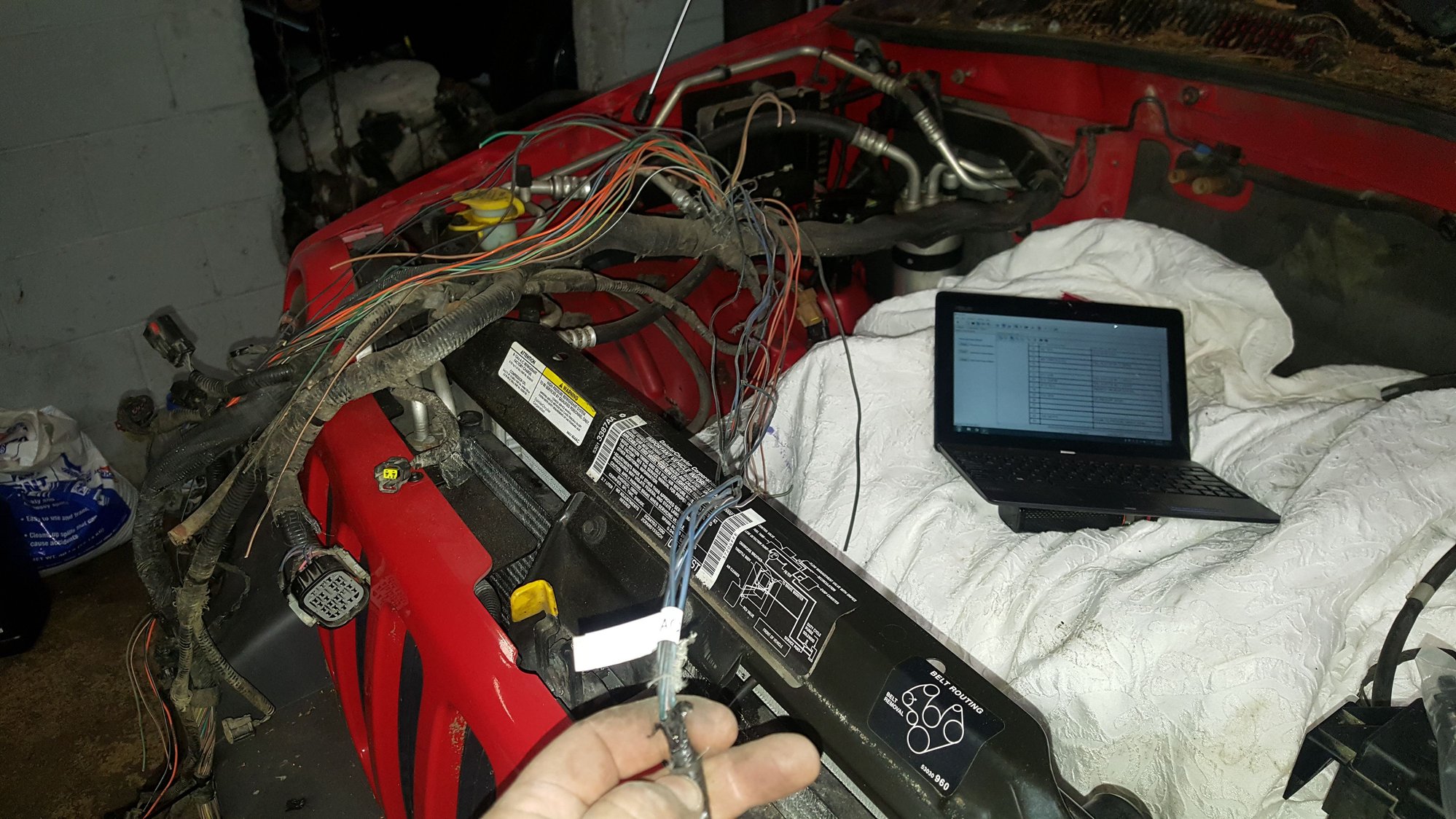

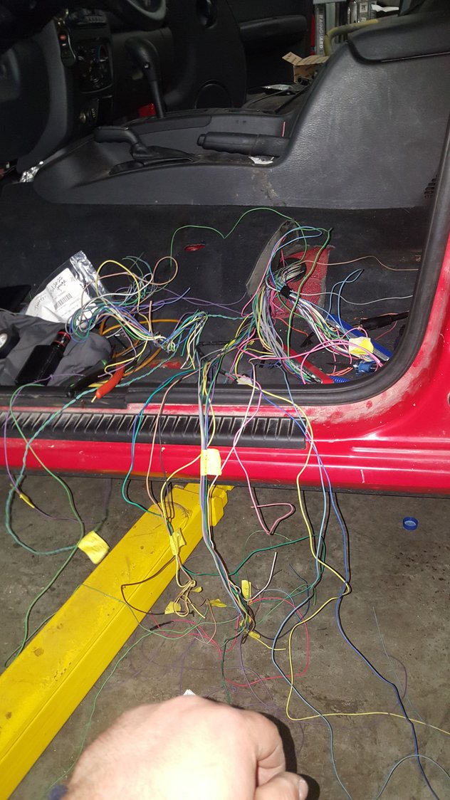

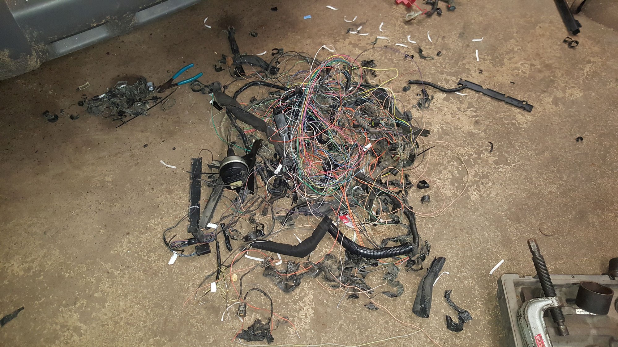

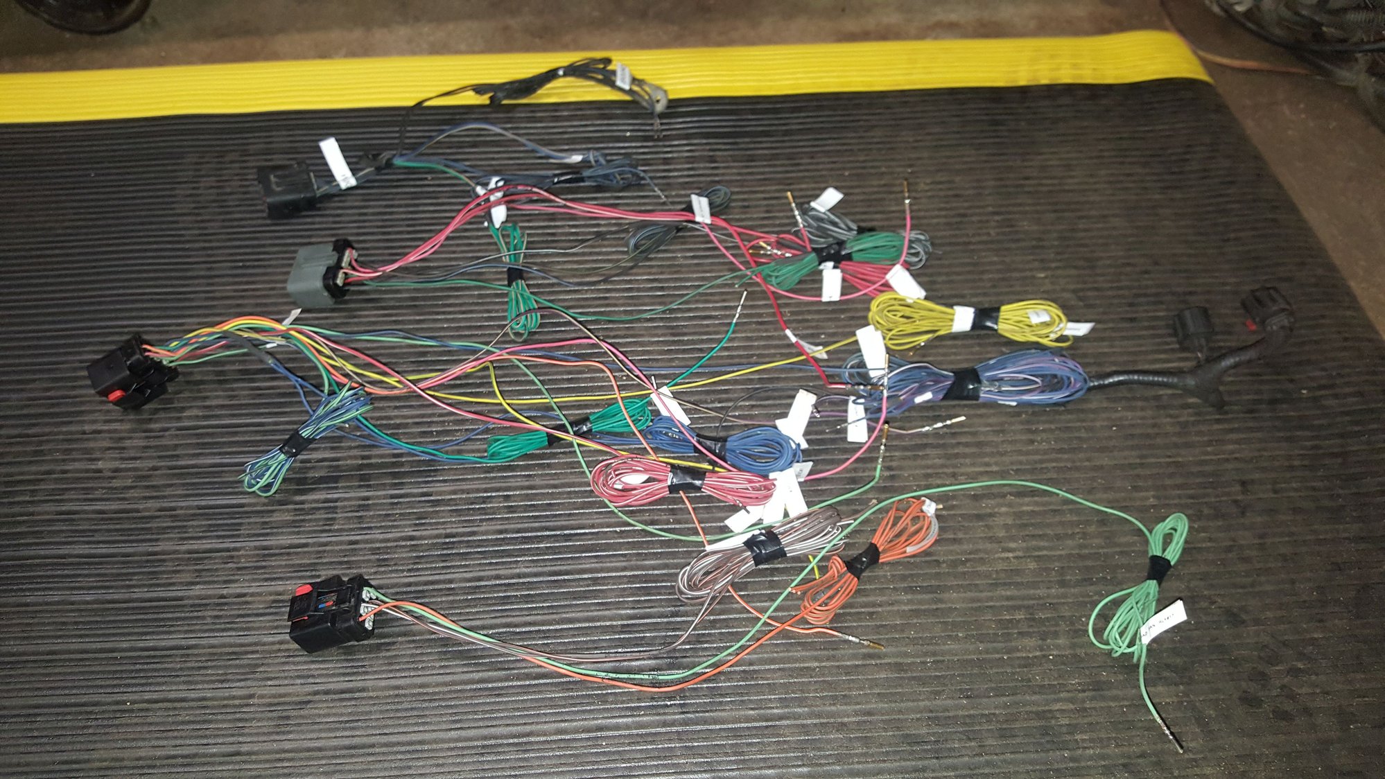

After going over every single wire under under the hood I was able to trim it down to the bare minuim I think I might need. I kept things like Evap for now because I haven't made up my mind on if I'm going to run it or just deal with the gas vapor smell in the summer.....
Some of the more notable things I've kept are the power steering high pressure switch, may run it.....will see how well the computer reacts once it's running.
All of the AC system wiring is still there
Evap vent valve and NVLD pump, NVLD is Chrysler's way of over thinking an evap system. I should shoot myself for even thinking about keeping it but for now at least it's wires to the back I can use if I need them.
The SCI and PCI data lines
ASD Relay control
Cooling fan wiring, may not use electric but I'm not sure yet so for now it can stay.
Pcm/Tcm constant and switched powers for obvious reasons lol
So here's what's left and what was removed.

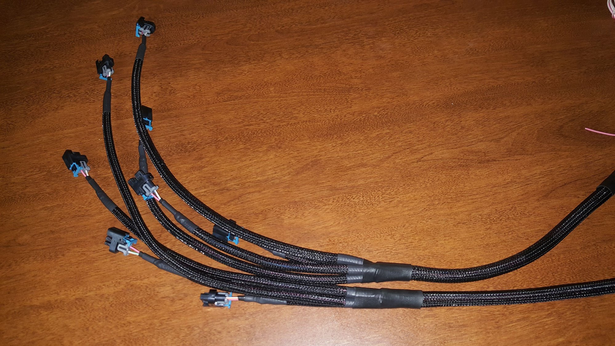

Prior to designing my own wiring harness something I saw done and even ran into a few issues on one's people did them selves or had "mail order" converted was that is a lot of cases the wire gauge used from the factory was questionable at best on a stock length harness. Now add 3-6 feet and your overloading the "rated" current for many of the wires or the voltage drop on signal wires starts becoming noticeable. Many people think that because the factory did something a certain way it's fine. Well what they forget is that once the engineer designs it a team of penny pinches will comb over the design and cut out or alter anything not absolutely necessary if they feel they can save money. For example the wire gauge is one of the first things that often takes a hit, larger wire costs more money, every thing has a ranges of values that are considered acceptable. Engineers will almost always stay on the conservative side to be safe while those looking to cut costs will look for the absolute minimum necessary to stay in the unacceptable range.
The other major fault found in every vehicle on the road can also be attributed to cutting costs plain and simple..... multiple grounding points. On the off chance your not familiar with the issues that arise from multiple grounds then take a quick look at this page to see what a ground loop is and what they do to an electrical circuit.
https://en.wikipedia.org/wiki/Ground_loop_(electricity)
In an ideal environment every ground would come back to one point. There are a multitude of reasons why this isn't practical in reality when a car is designed but that doesn't mean that the issue can't be addressed when designing a new engine/transmission harness.
So the 2 major issues I address are wire gauge and grounding. To address the wire gauge it was pretty straight forward, increase the gauge on all the wiring used. While that seems simple enough you also need to remember that most of the wire terminals used are designed for a specific gauge of wire so those will also need to be increased accordingly. That is where the real headache starts....but it's the type of thing you only need to do once and will last you a life time once you have all the correct terminal and seal numbers as long as they don't discontinue the part or supersede the part number. Grounding is also simple, I use the bolt hole on the back of the block by the intake for every ground. So even when I'm mounting a pcm in the trunk I'm still going to ground it in the same place, voltage drop isn't an issue even on long runs because that has also been addressed.
You can see that GM learned from their mistakes of under sizing wiring if you look at diagrams. Take an 2002 Silverado and an 03 Silverado, wire sizes were increased in a number of areas. Now before saying that's just from the change of the 512K to the 1mb pcm's then take a look at 03 to say 06 and you'll see that wire sizes also changed again. The same thing can be seen when looking at Express van diagrams, the van harness is several feet longer then the truck harness and the wire size does reflect the longer harness. There are some things that you just can't go much larger on like the Multitec truck injector plugs, 20 gauge wire is the biggest they will take, terminals for larger wire just don't exist and this can also be seen in factory diagrams. This is where common sense and experience will give you the best idea of what's going to work and then is that going to be acceptable.
Ok...enough with the rant......lets look at something pretty now.

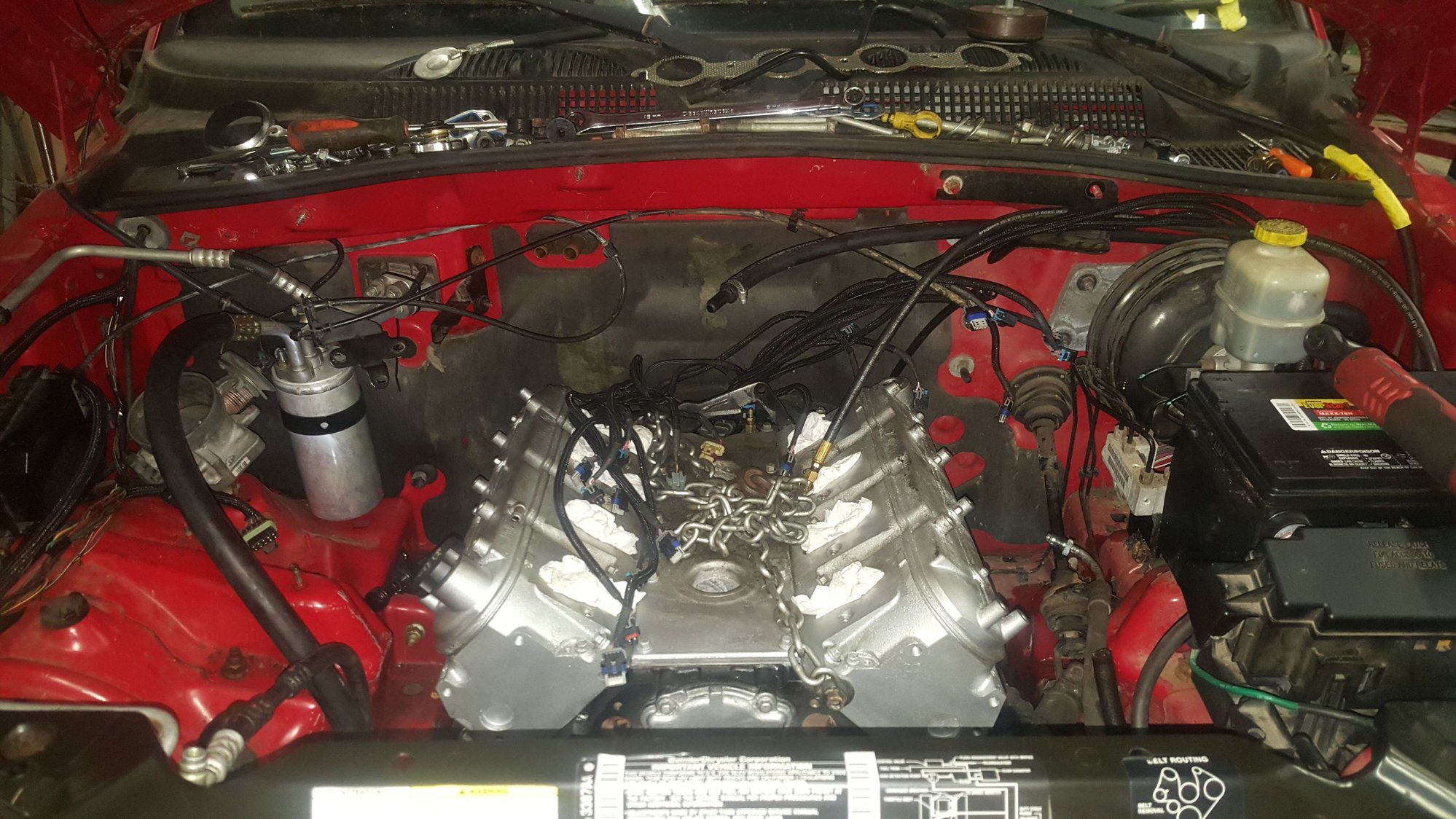

It's been a while since I was able to get much done on this, I've been slowly separating out all the unused jeep wiring under the hood for the last month or two. I also had a bad luck streak with 2 defective crank sensors and a bad cam sensor that had me chasing myself in circles for a while as well. But things are looking better and I was able to test the conversion module I've been working on in the jeep for the first time last night.
Gas gauge and speedo were set to 50% so I could see how long the module took to come online after being powered up.
Most warning lights are working correctly, the Airbag light is on so the SRS module isn't happy so I need to dig into that a bit more but otherwise it looks like this is gonna work just fine.
Engine is running a Sloppy Stage 2 cam and the pcm is untuned. Its also missing both O2 sensors and the MAF sensors still so the pcm isn't a happy camper but its enough to get it running for now.

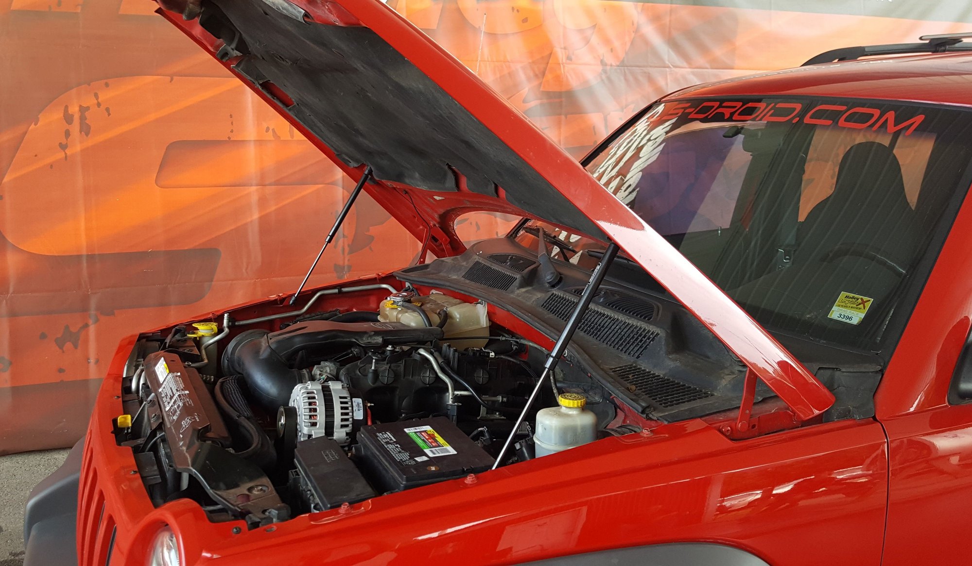

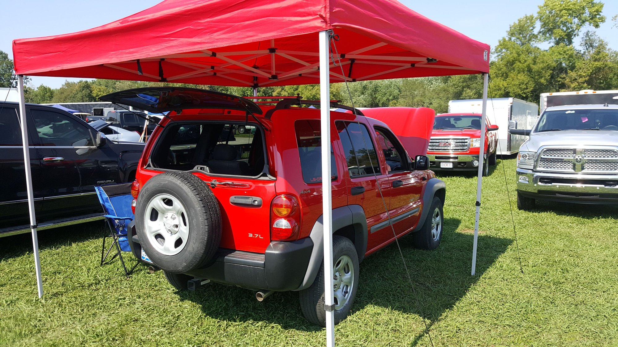

It's been quite a while since I updated this thread and it was mostly done intentionally. I had a lot of unfinished things I needed to take care of and have spent a great deal of time working on the conversion module that was the entire point behind this project. Rather then sharing bits and pieces dragging this on over the last 8 months I decided to get everything wrapped up first.

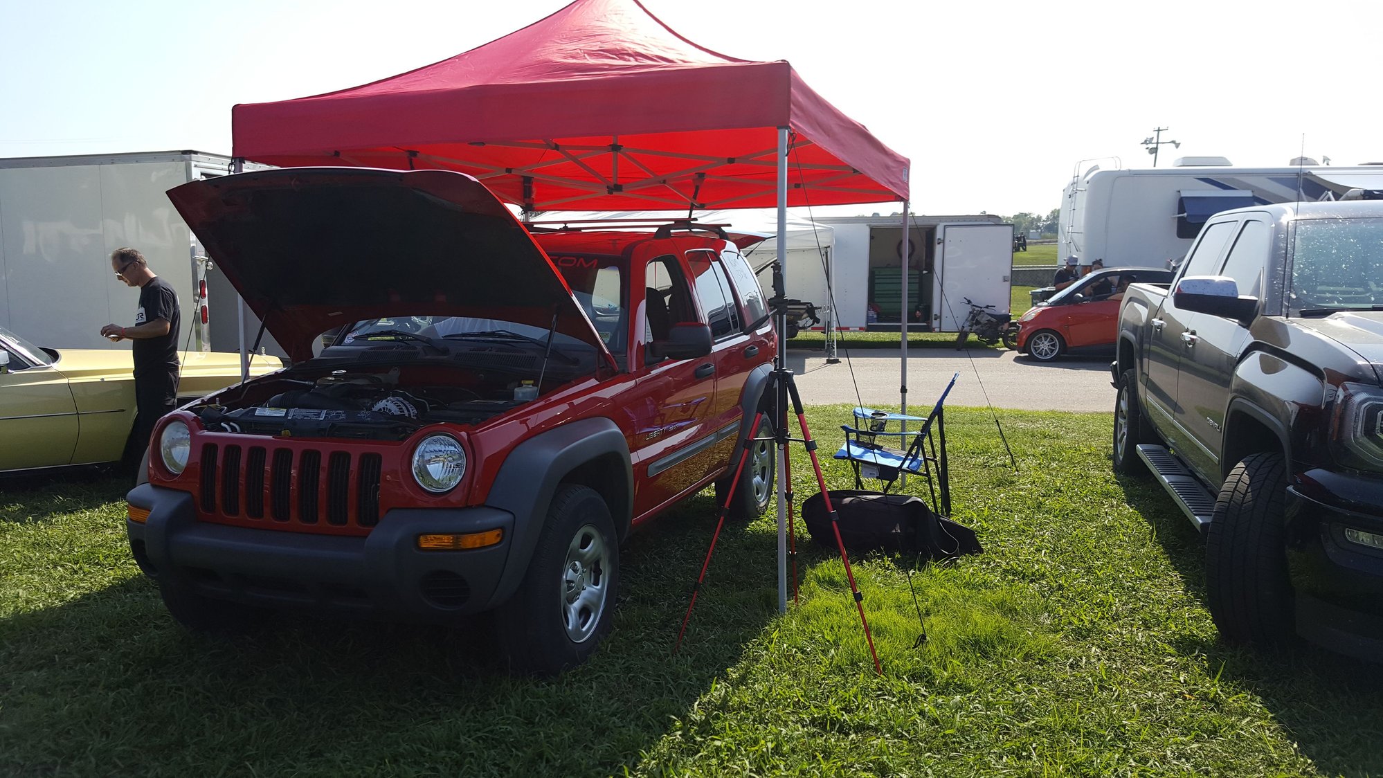

So....if you went to LS Fest East 2019 there's a good chance you saw my Jeep there
I've had more then a couple of setbacks along the way including a broken rod in the first engine.....and I ended up putting a stock 300K engine back in it's place so performance wise it's taken a MASSIVE step backwards but overall I'm very happy with how the entire swap turned out.

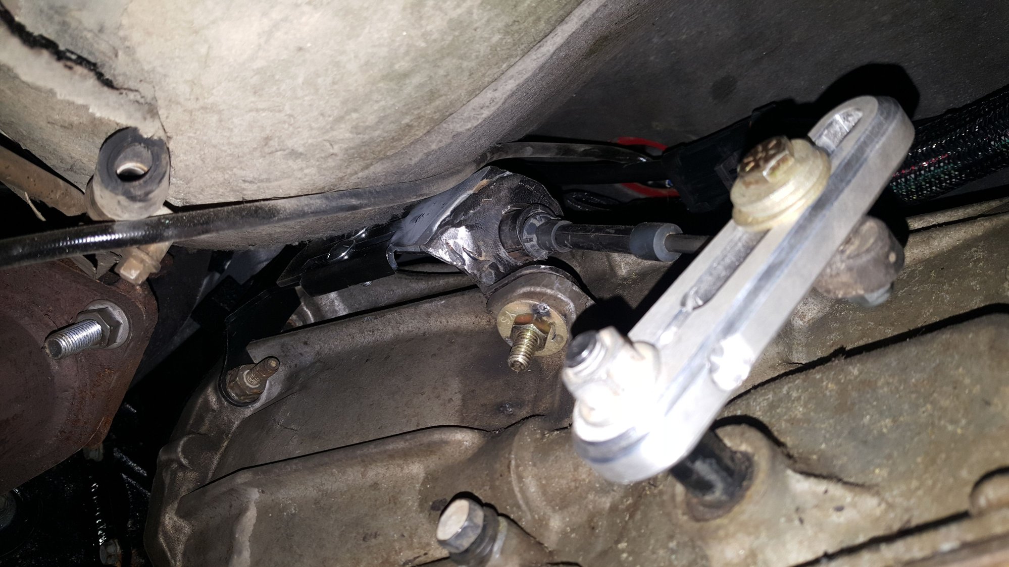

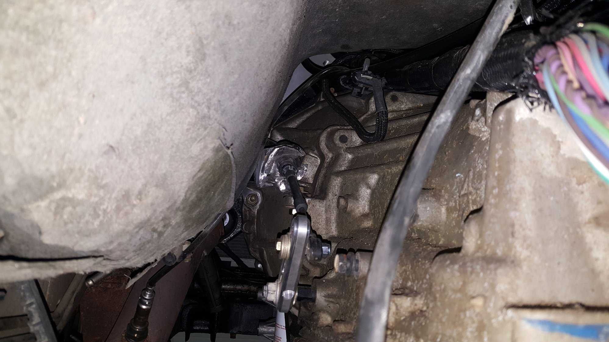

Getting the oil and trans dipstick tubes fitted
Transmission shift cable bracket. Cut up a Novak shiftier bracket for a Jeep Wrangler
bracket uses 2 bell housing bolts and 1 bolt on the ear of the transmission.
Since the Jeeps shifter was originally a 3 speed with push button over drive I can't get low gear manually but I knew that would happen going into this.

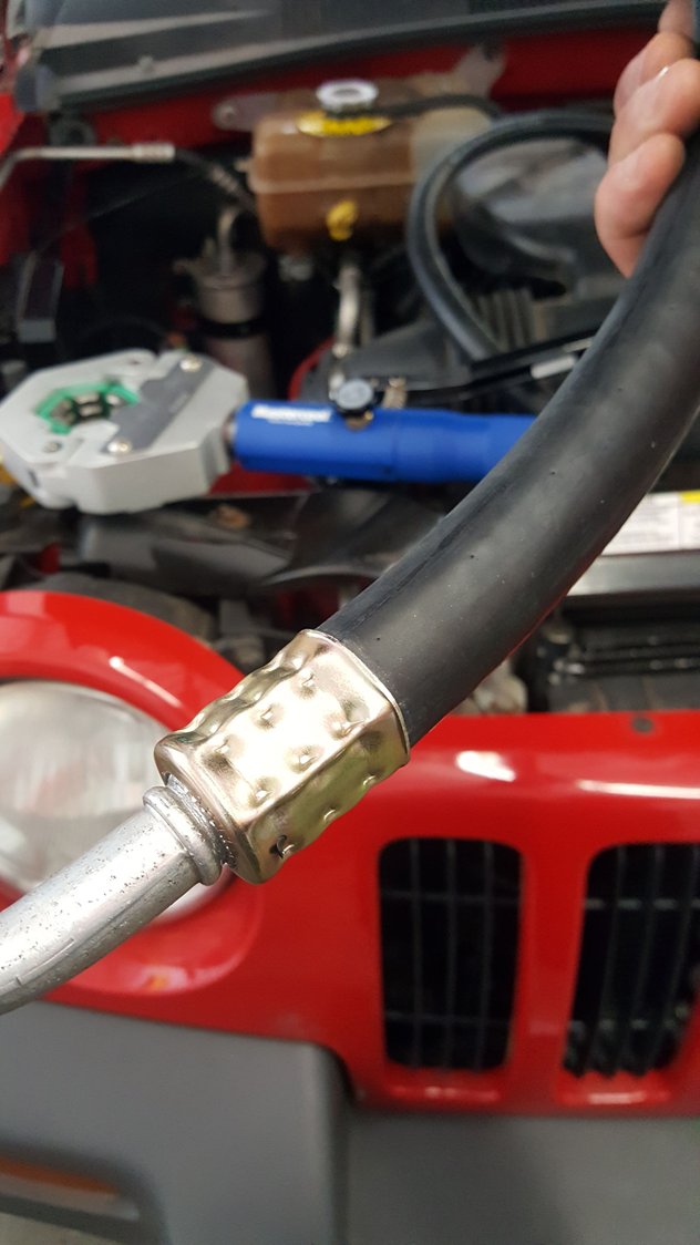

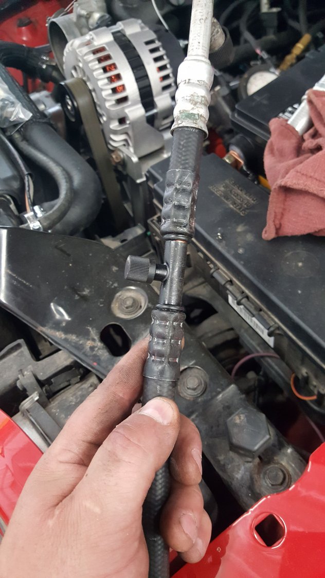

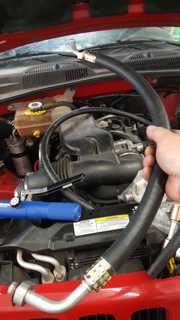

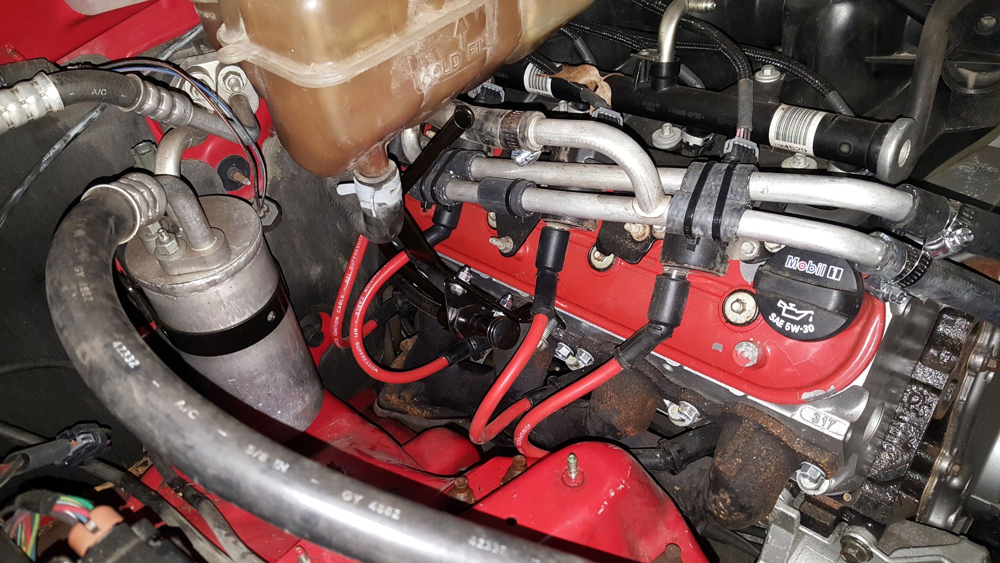

After searching for nearly a month and not being able to find anyone local that was able to make my Ac lines I decided to buy the tools and make them myself.
It's a bit nerve wracking when your dealing with stuff that's 15 bucks a crimp and the tool tells you to expect there to be a learning curve on proper use....
All the lines came out pretty good and have been holding now for the last couple of months with out any issues
The nice part about making the Ac lines myself was being able to make 100% sure they were all clocked exactly how I wanted them...and they ended up fitting exactly how I wanted them too.

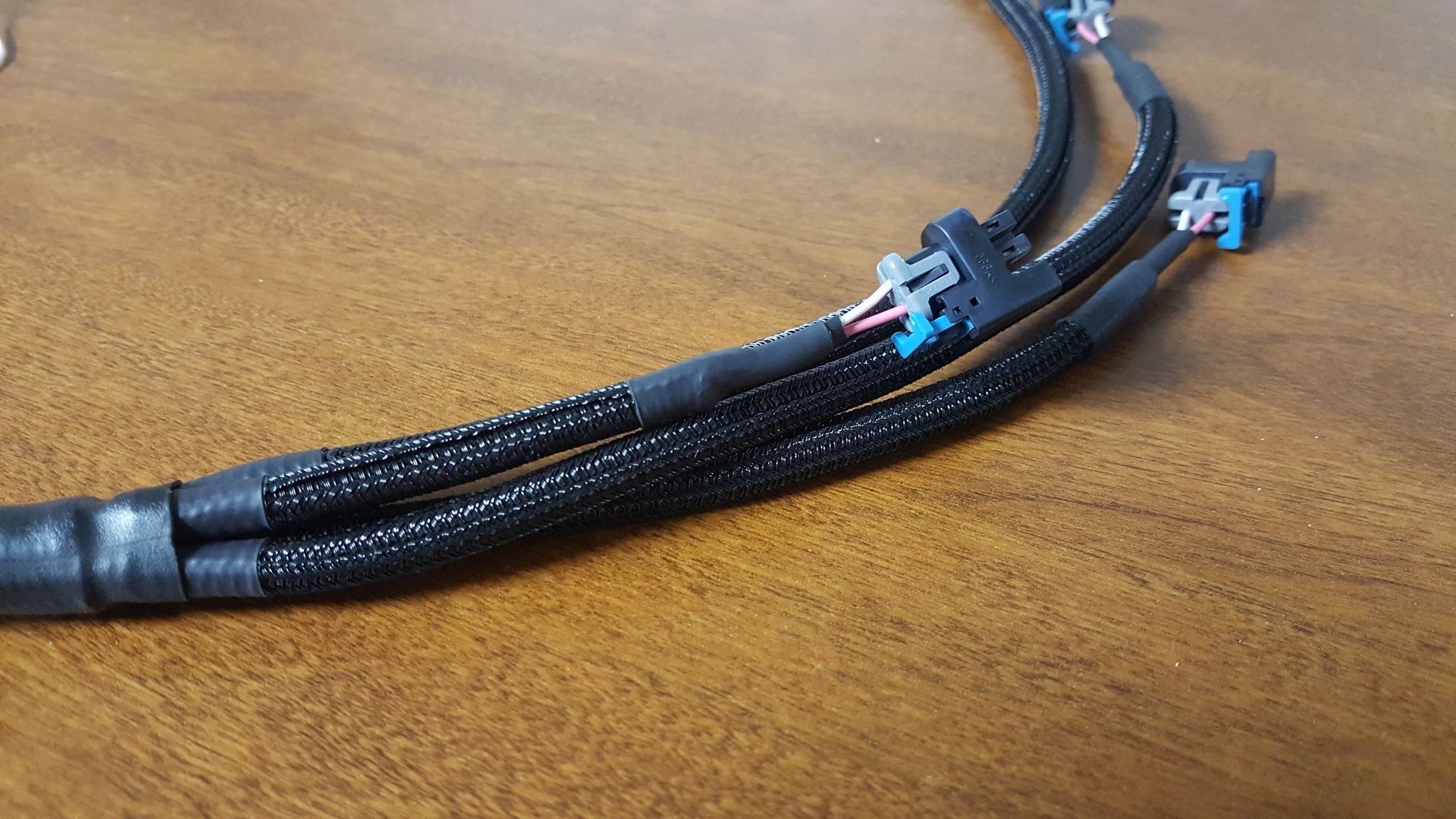

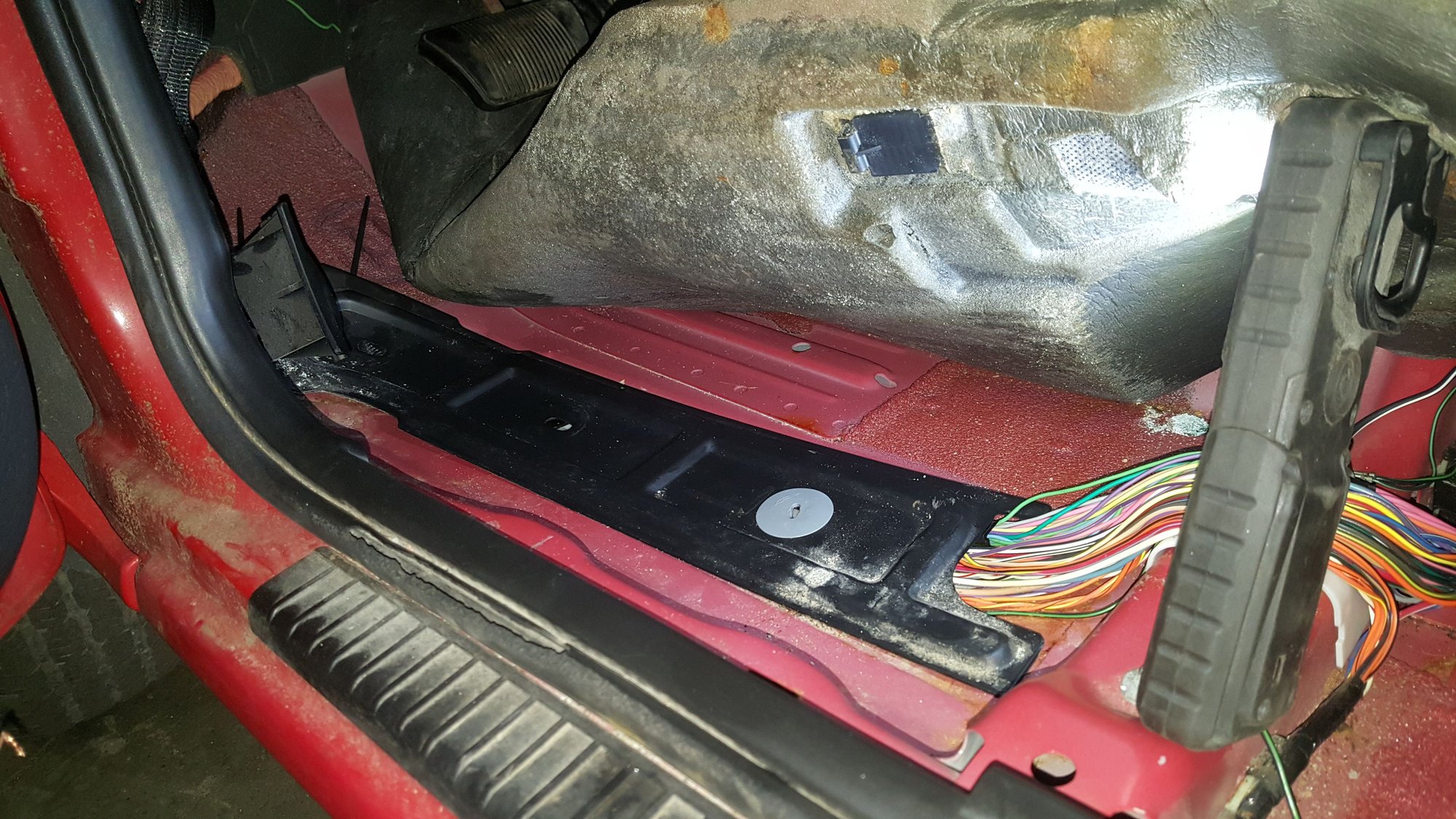

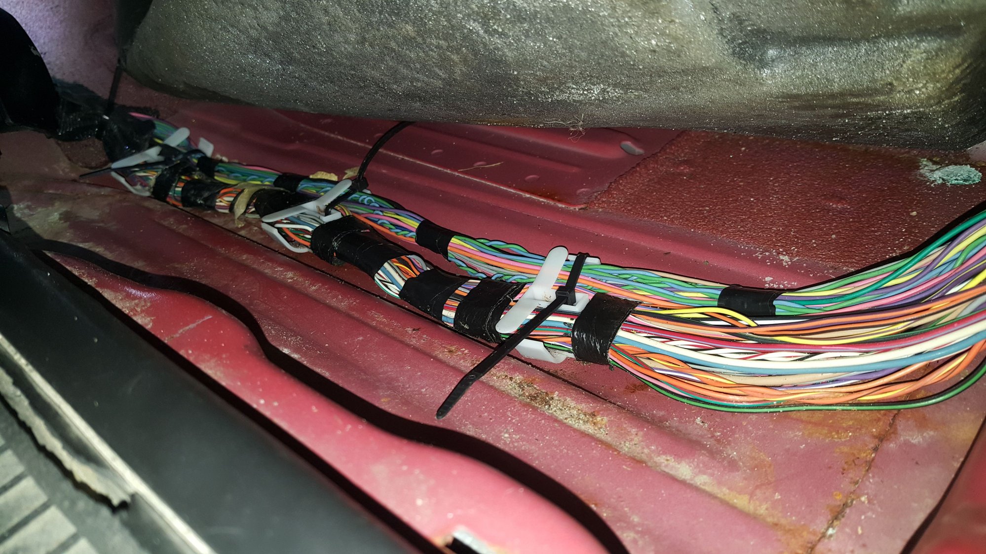

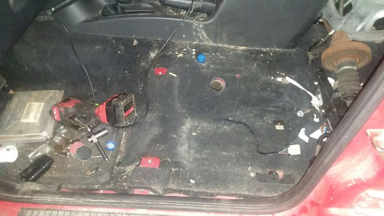

While I was in the middle of building the engine and vehicle harness the hard driver on my laptop decided to take a crap so I was left with a whole lot of wires that I had no idea what they went to. It was interesting to say the least....
Once I had eveyrthing sorted out it was time to get things cleaned up and put the carpet back down....
Was able to still fit the factory channels cover even with all the added wires for the engine.
And the carpet went back down and things really started to look like this might turn out half way decent after all

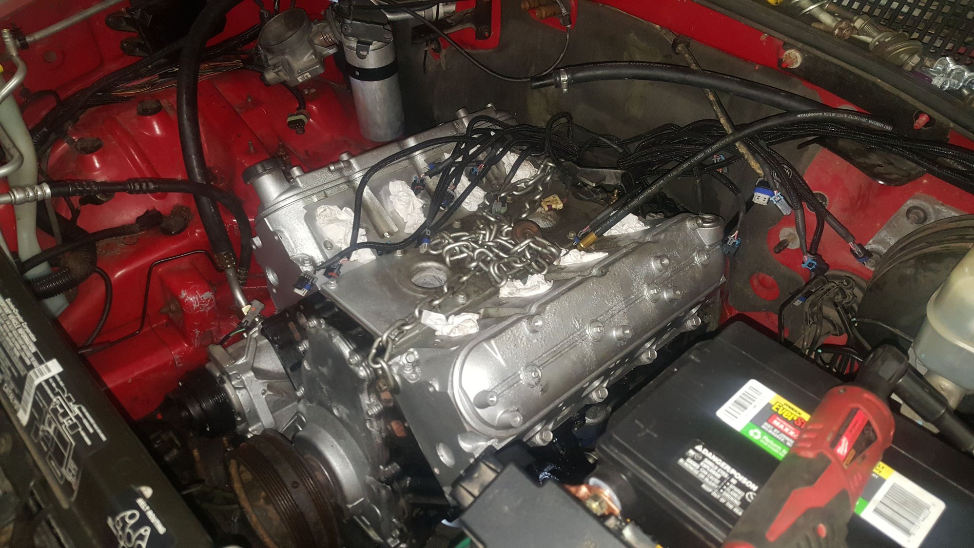

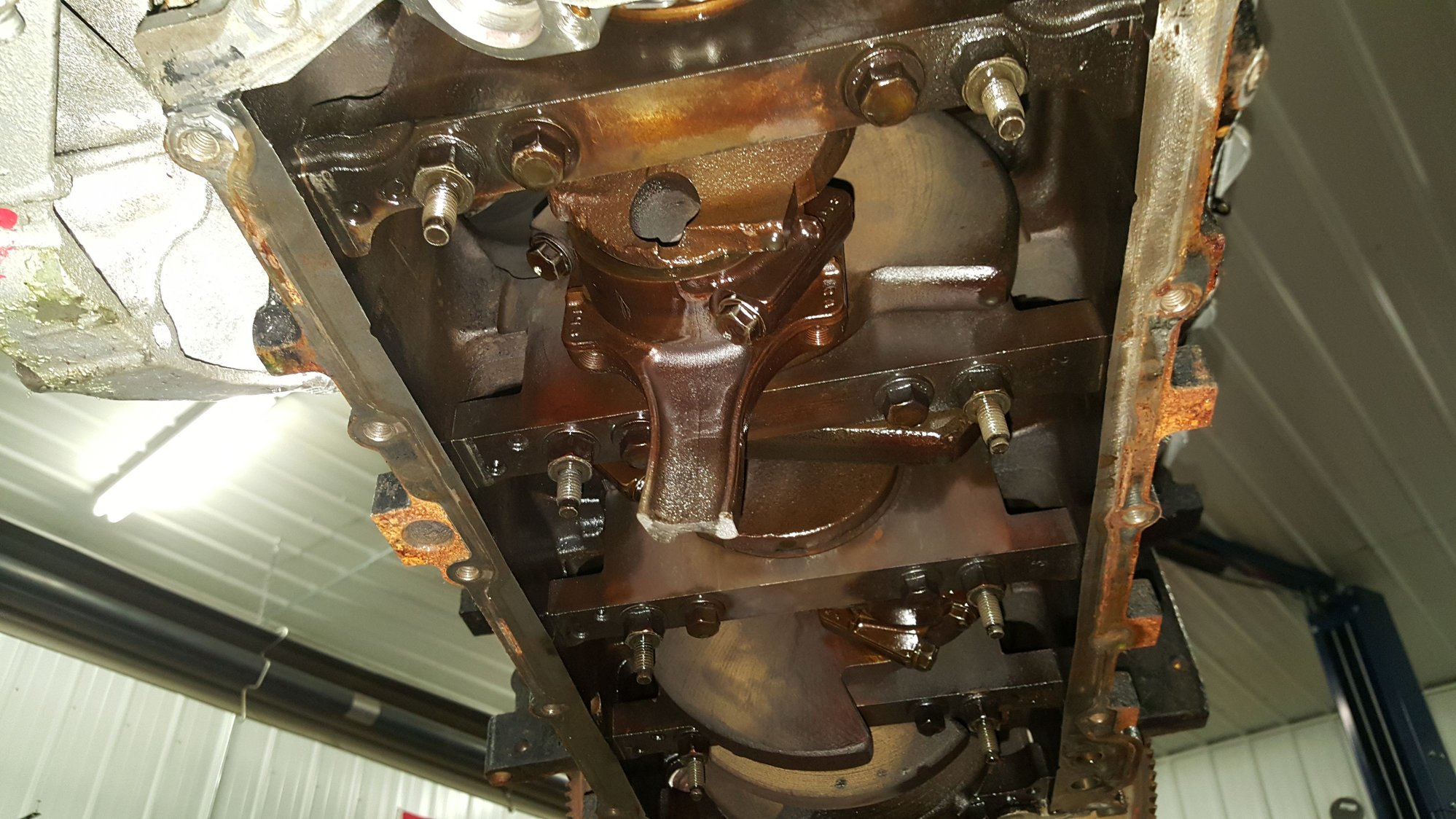

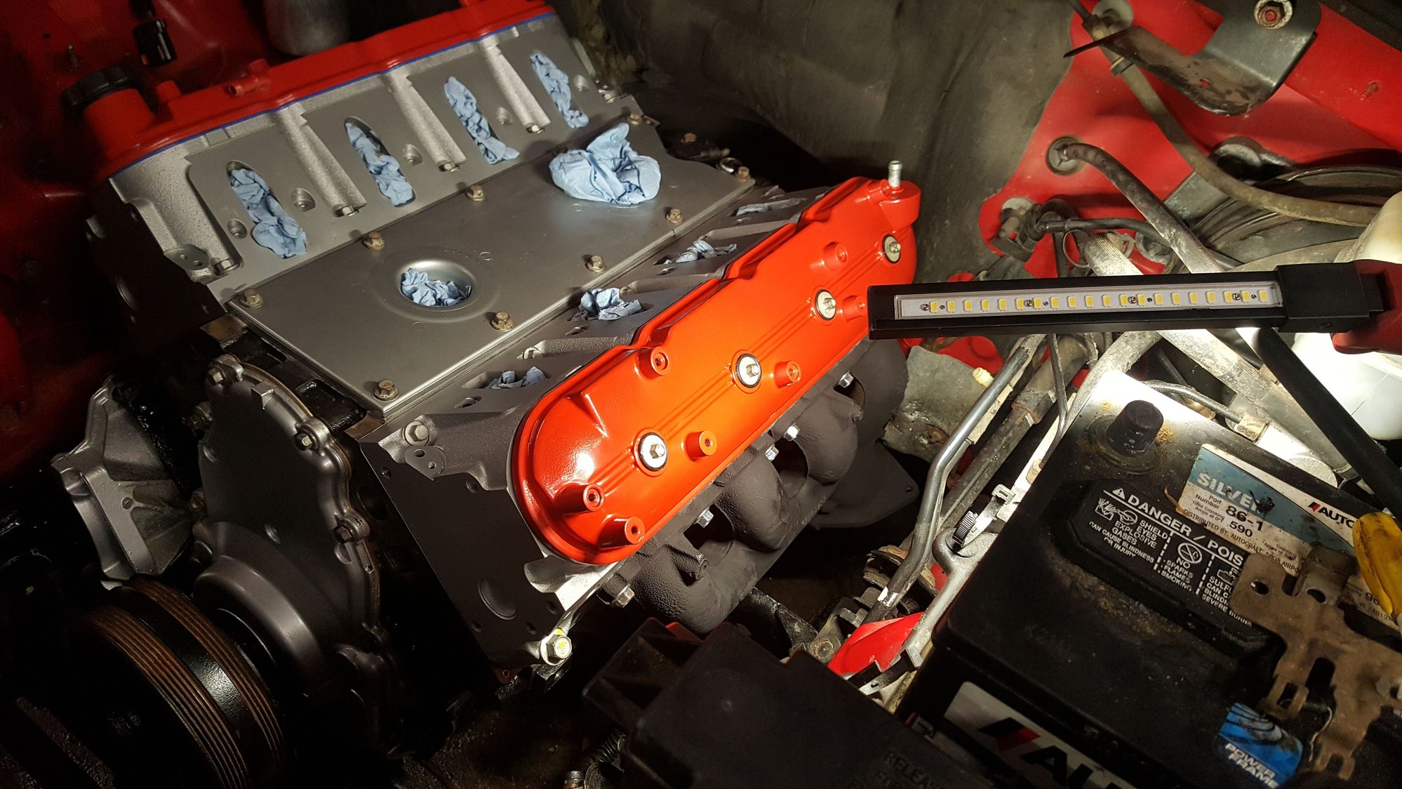

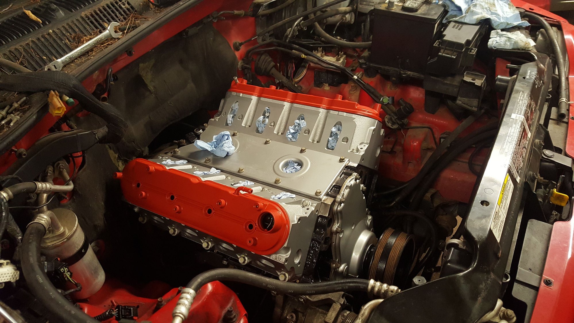

And then something like this happens.... I had maybe 50 miles on the engine and it had not even come close to being abused. This was just more bad luck and the Jeep attempting to resist the transplant....
So as they say....out with the old

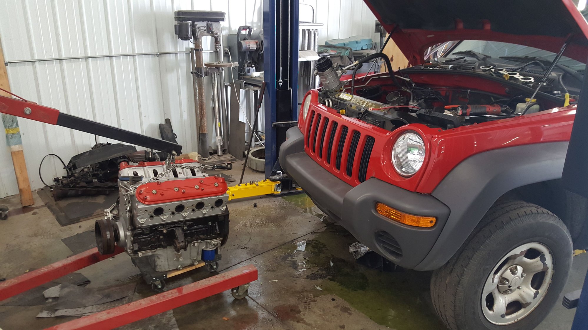

Yes......I was able to pull the engine with out taking off the hood and I didn't even need to pull the truck balancer. Or pull the radiator/condenser for that matter.There is a LOT more room under the hood then people give these things credit for.
Despite the Jeeps attempts at rejecting the transplant another engine was sourced ad reinstalled the next day.

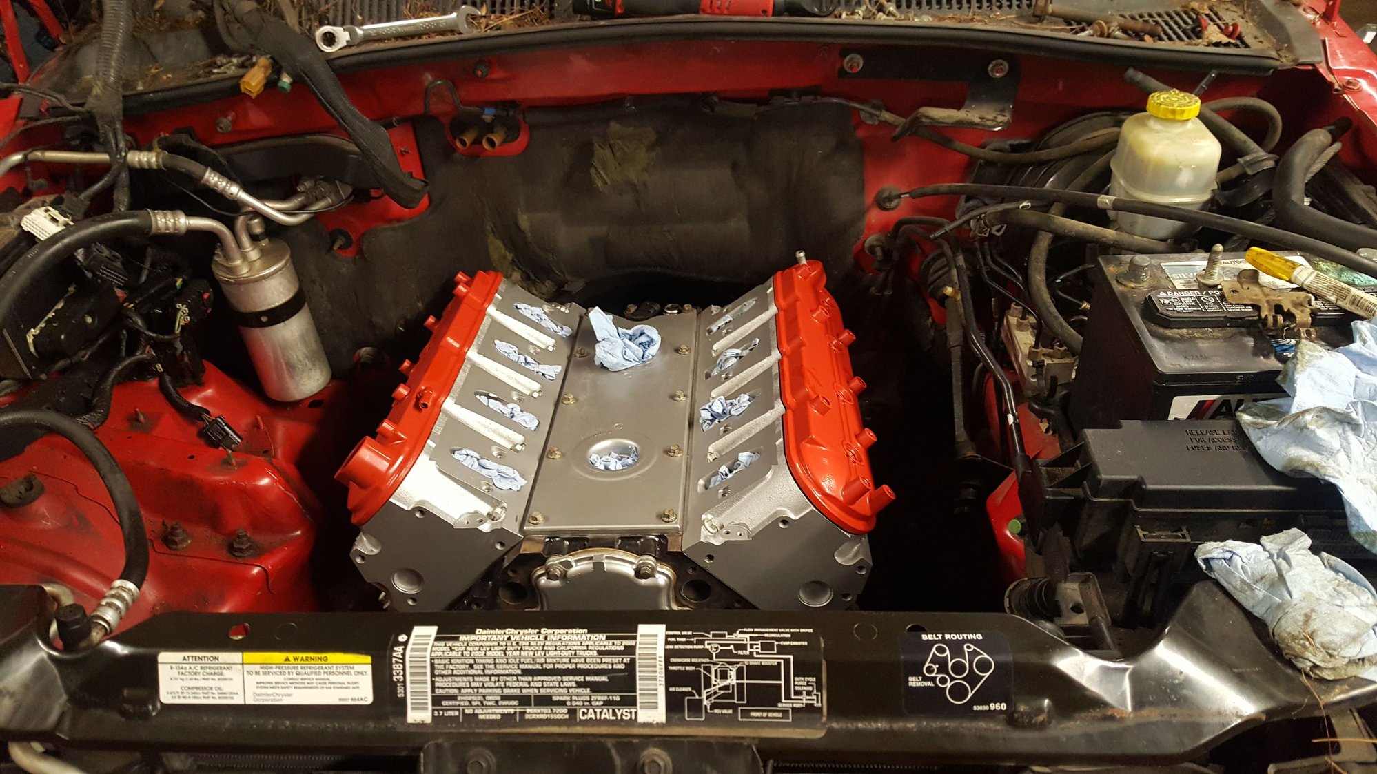

A couple hours with a pressure washer and some engine paint cleaned up this high mileage engine pretty good. It was just under 300K miles and came from an express van. In case anyone is wondering.....nope...still didn;t have 4th gen rods.

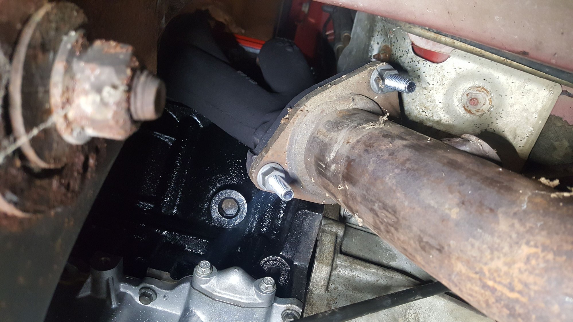

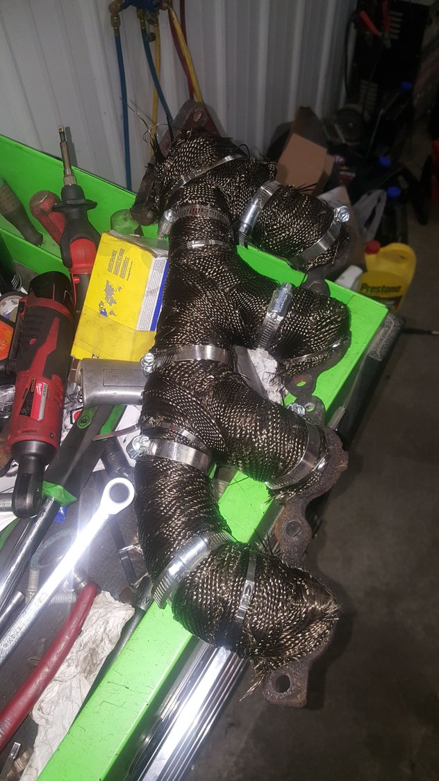

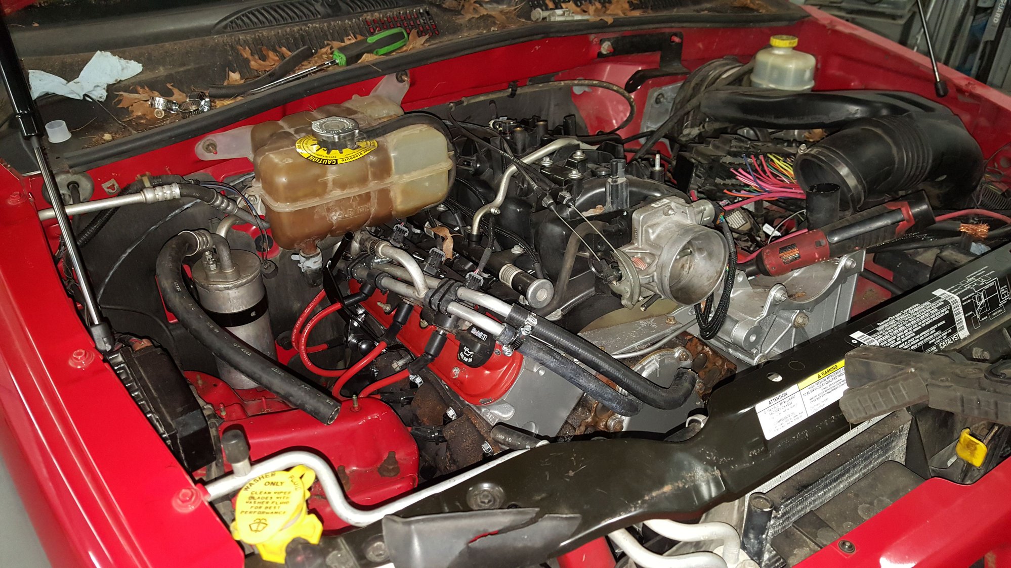

After having at least driven the jeep a little bit with the last engine I deiced to add some heat wrap on the pass side manifold. It was RIGHT under the coolant tank and that side undder the hood was pretty warm. I'm sure the AC also being right there wasn't helping either.
Other then the 1 ear at the back of the manifold these really do fit pretty good.

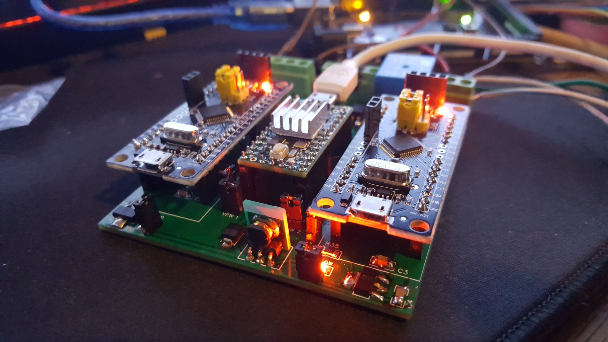

The entire time I've been working on the Jeep i was also working on perfecting the data bus conversion module. I've made this in like 5 or 6 different versions using various processors trying to get things working as close to OEM as possible and I'm not going to lie......there were a few times I didn't think it was going to be possible to get the data conversion working fast enough.
So I decided to move to the ARM CORTEX processor and just start throwing raw speed at this issue until it went away. It turned out that with enough processor power it doesn't matter how good or how poorly optimized your program is...because it will just flat out work.
So.....Say Hello to my little friend sporting over 800mhz of collective processing power.

After almost 2 years of blood,sweat and many...many tears my vision had become reality....
The swap in it self was never what was going to be impressive about this build. People have fit engines into much smaller vehicles, its not fast compared to what most street vehicles are capable of these days with a turbo and it's not a vehicle that a lot of people would even be interested in driving.
It is however the first of its kind and it's going to change the way people look at engine swaps.
I really should have recorded what took place when I drove into the track at Ls Fest Friday morning, every single gate attendant mistook the Jeep for a spectators vehicle and kept trying to redirect me into the public area. If it had happened once it may not have stood out....but that fact that it happened 3 times in less then 10 minutes at a show that has primarily Ls swapped vehicles tells me it turned out to be one hell of a sleeper.
