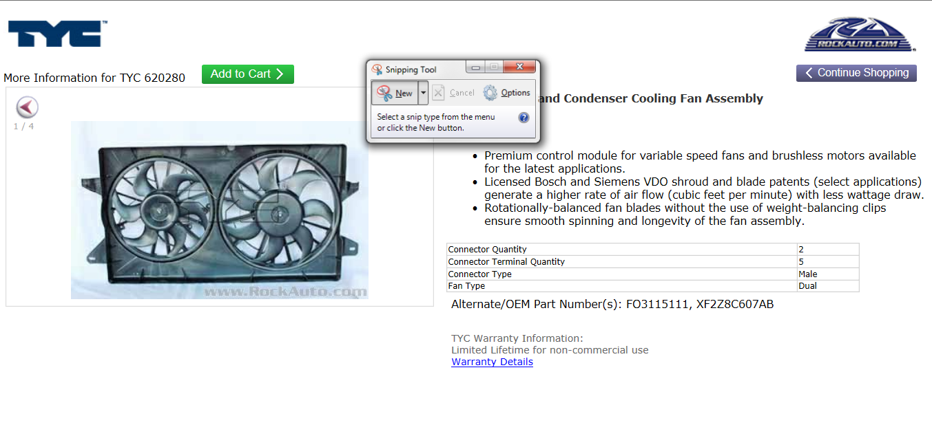

I have the fans wired up with the Volvo relay, and when grounding out the wires where the temp sensor would be wired to, the smaller of the two fans, is only pushing, and looking at the blades they are angled to do just that. Even when re checking the wiring and reversing the wires I grounded from the fans, and exchanging them for the wires headed to the relay, it was the same.

I swapped the wires, mine are actually off a Ford Freestar, same thing, the fans look identical. But the blades are definitely turned to push air on one of them. I have just never heard anyone say anything about it before.

https://www.rockauto.com/en/catalog/...+assembly,2181
The blades look just like these, which makes one a puller and one a pusher. The blade angle would be very ineffective at pulling air, as it would not be able to "grab" the air.

I looked at the Rock Auto pics and they both look the same to me. No way Ford would design the fan to pull air with one and push it with the other.....

Did you look at the link he posted? Don't see how one fan could go on the front???

yeah that looks just like my fan. the different blade pitch is for hi/low controlled by a thermostatic switch. I just have em both hot. I'll grab a pic brb.

I had the polarity wrong, even though I thought I had swapped the wires, I must have only swapped one of the fans wiring. I could clearly see when I powered up one of the fans it was spinning backwards and not "grabbing" air like it was intended for. These fans do spin towards each other, which is why the blade angle is different on each one. one spins counter clockwise, the other clockwise. They are now both pulling air.
I used the Volvo fan relay set up, with all the original 10 gauge wiring, along with the factory pigtails and 10 gauge wiring going to the fans, and a 40 amp breaker.
