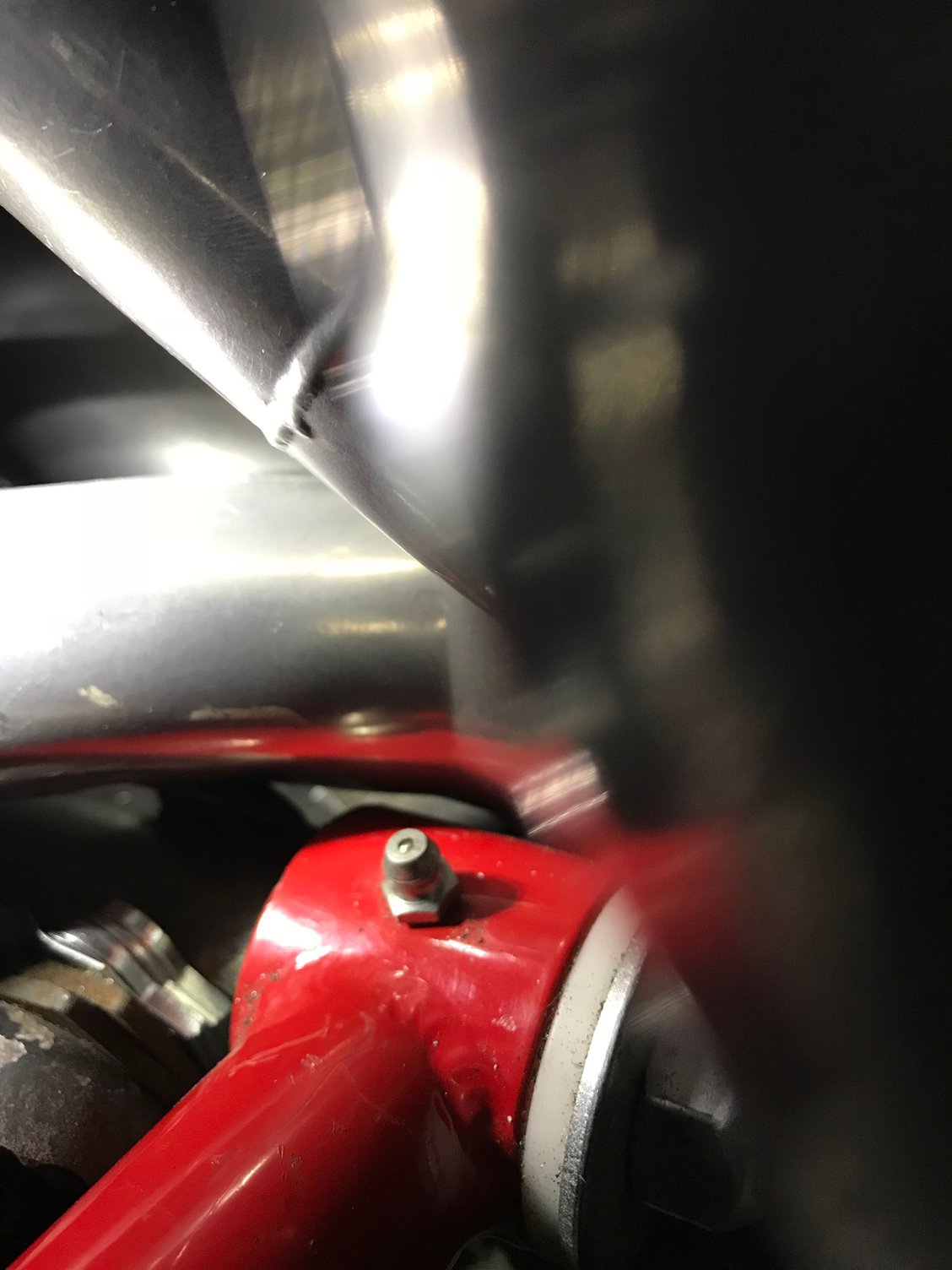

Anybody have any thoughts for this issue I'm trying to avoid, headers right next to control arm bushings.
I'm concerned about the bushings melting. Header material is 304 stainless, I've had them ceramic coated.
Bushing material is Delrin, I do not know exactly what Delrin is so I don't know how much heat
they will tolerate, I'm going to call UMI when I get a chance and ask them how much heat they can
tolerate.
So does anybody know of any very thin heat reflective material that they know works.
I have a heat sleeve that I can try, and I have some heat tape both Summit Racing products.
I have not driven vehicle yet, still in the finishing up stages.

I’ve made lots of heat shields using aluminum gutter flashing. It’s easy to cut and shape. It has low mass - a big plus for reducing radiant heat.

Thanks for that!! It's in a S10 pick up, and everything is very tight.
The next concern was the clutch hydraulic line and o2 sensor wire, it is about an inch over the front part of the header collector
and the flashing will probably work there as well.

Just be sure you have an air gap

You're not melting bushings like that. This is fine the way it is. The ceramic coating was even overkill. Big time overkill.

Yeah, Delrin is pretty tough. Excellent bushing material, pretty heat resistant.

Delrin or Neoprene? One bad side of delrin is it doesn't recover if over stressed, But its highly self lubricating , better than Neoprene in that respect.. I use sintered bronze when it absolutely,,,positively needs to stay put.. (Road racing cars in my case. )

Have you ever actually ran uncoated stainless headers before? Stainless is not the same as mild steel. I do run stainless long tubes on my car - and I guarantee I make way more heat than you do - and the heat under my hood is just fine. You also seem to be one of those people that thinks because the heat is too much for YOU to take, that it somehow means it’s too hot for all the parts under the hood that are specifically designed for that 300+ degree heat.
