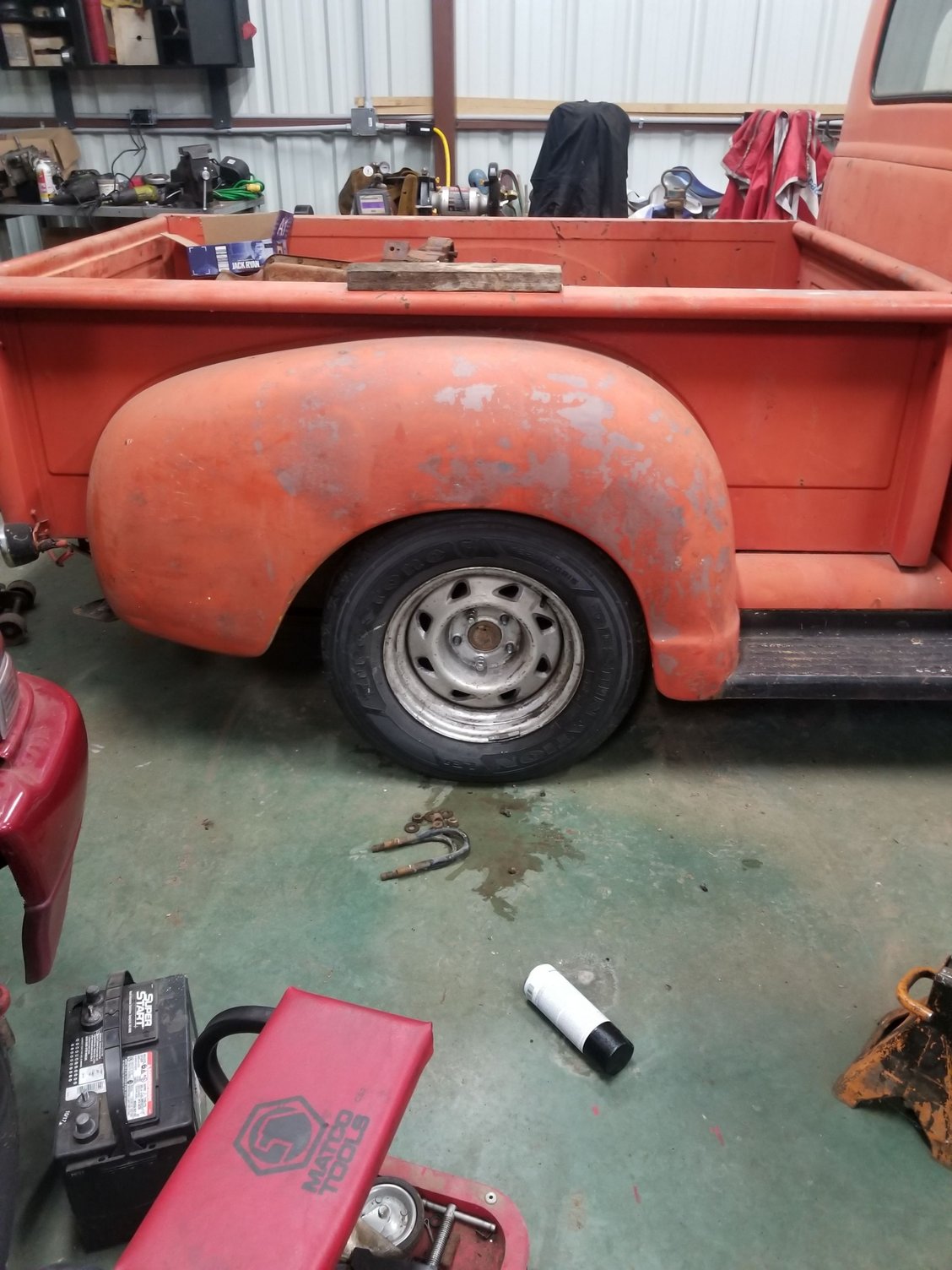

This is a cool one. 1954 GMC originally bought by this customer's dad. After his father passed away he wasn't sure what he wanted to do with it. I'm honored he came to me to have the work done.
it will be completed in stages as this guy isn't rich and he's not using any kind of credit to do the build.
Hope ya'll enjoy the progress
Hauling iy to the shop

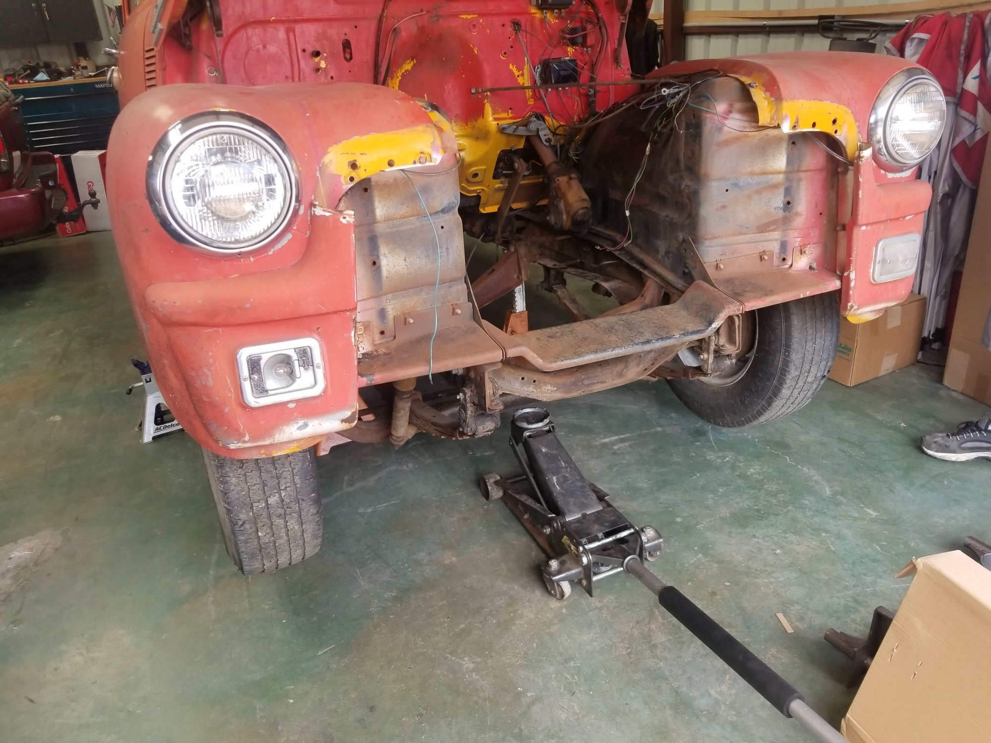

Getting a look and making plans
Out with the old straight axle
l

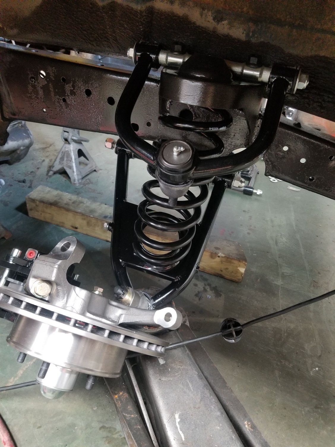

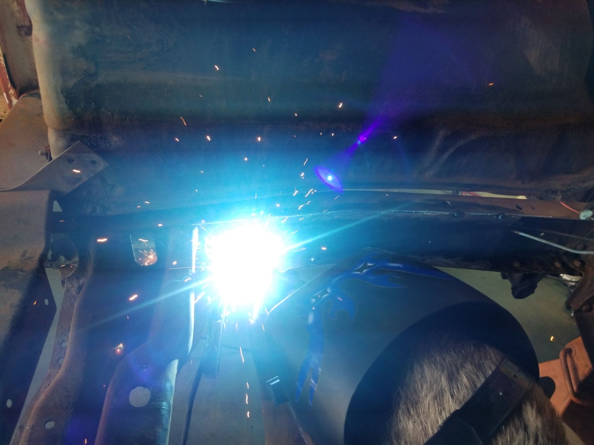

New cross member and spring perches going in
Everything welded up
Crosse member
Suspension assembly
Mustang II goodness
I like the way it sits. Ugly wheels are just for now so we can move it around.

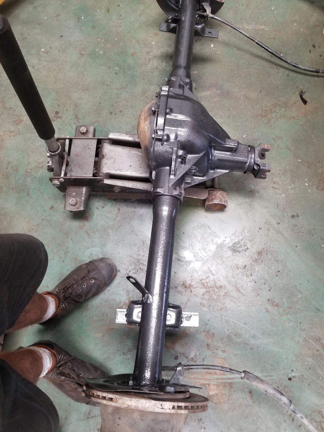

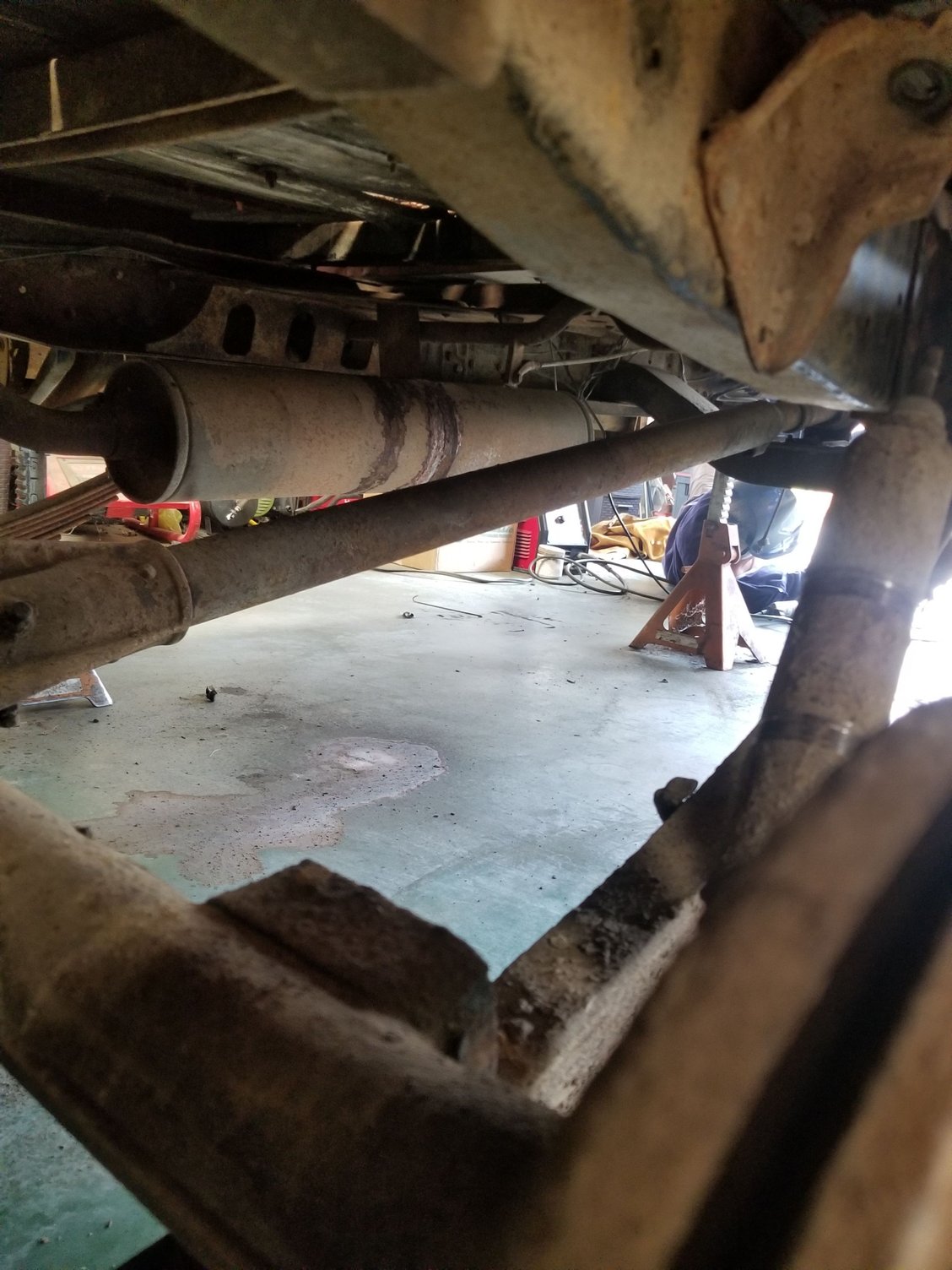

Old torque tube differential. I forgot how heavy these things are!
Blazer wide ridet 4x4 diff, 3.73 posi 8.5. Should work nice
Mock up. Using the stock springs for now. Pulled 6 leafs from an 11 leaf pack and used a 2 inch block for the final set up.
This should be the ride height. No schocks on it yet. The stock inline six and hydramatic transmission are in the bed so the ride height might come up a bit
Moved it outside to make room for other not so fun work(gotta pay the bills) I think its gonna shape up to be a nice ride when its finished.

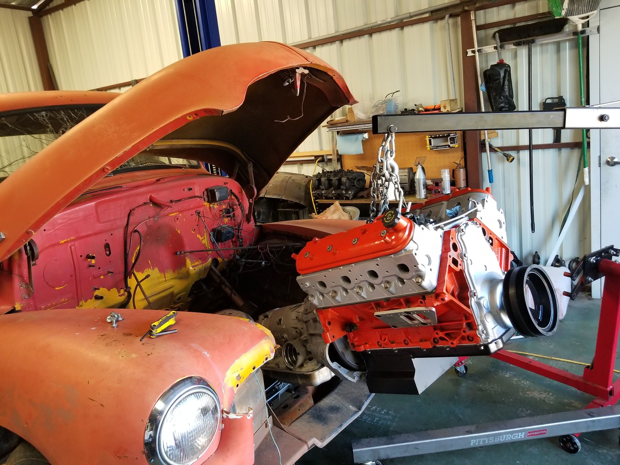

Engine mock up
engine mock up

Did you massage the firewall on this? It looks like the engine is sitting back pretty far compared to some I have seen.
Firewall is stock. I used a kick out sump sheet metal pan that allowed me to drop it way down. This allowed it to also move back quite a way.
I really wanted to do this to keep weight as much behind the front axle as possible.

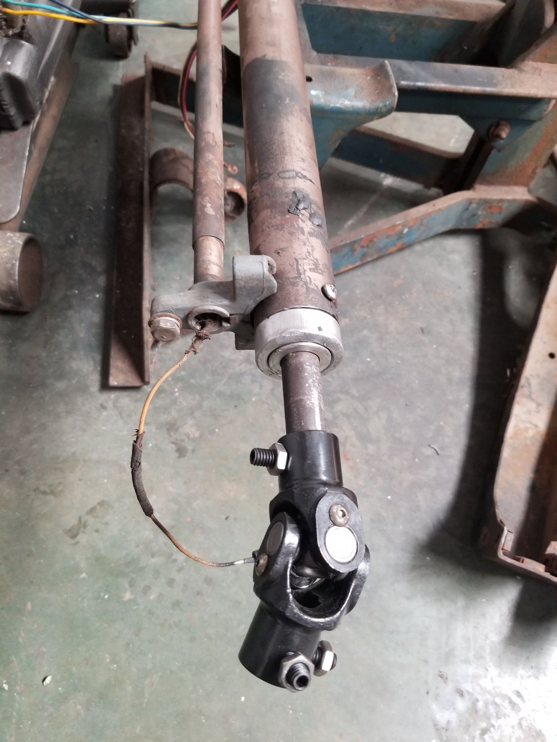

Steering column modified for a double d shaft and u joints

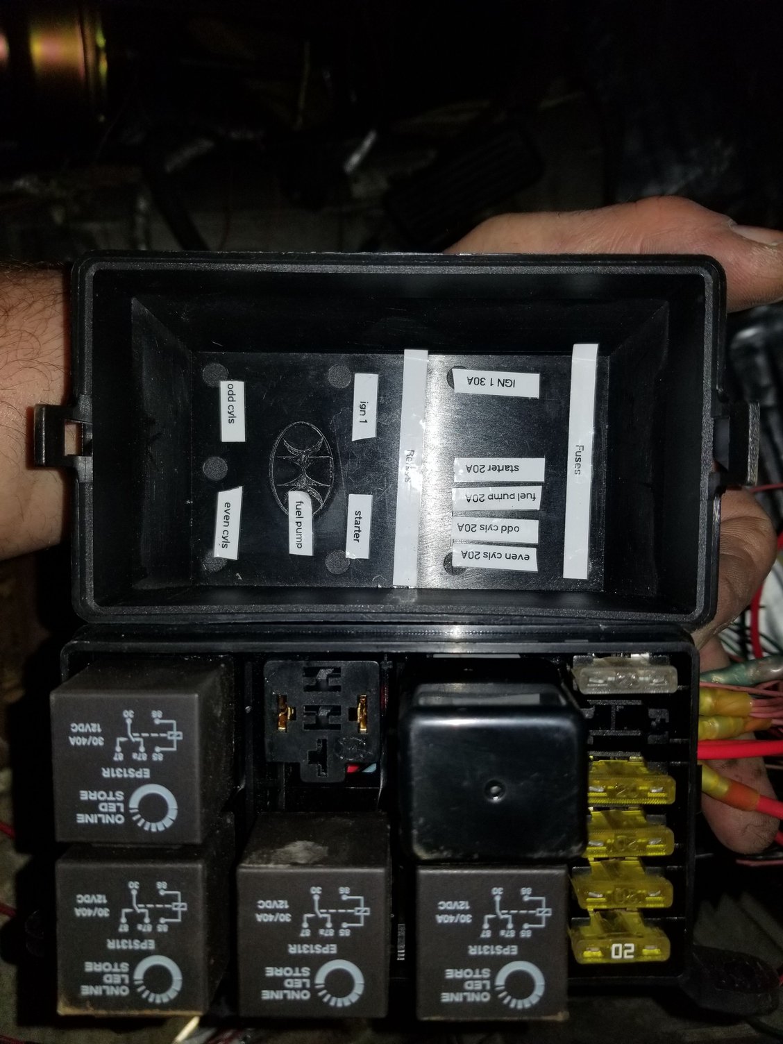

Engine fuse and relay panel. This is tied to the main fuse panel only through one ignition fuse and the brake lamp fuse(for the TCC brake feed) This was a little more work but makes it clean and aimplifies the wiring by isolating the engine harness.
