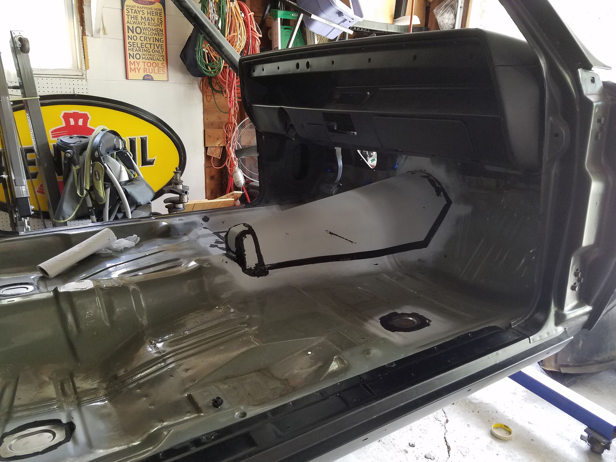

Just wondering if anyone has experience or thoughts on this. I would love to drop a t56 in the chevelle, but I am trying to save money any way I can, budgets can be difficult. I have already modded my trans tunnel on the 66 chevelle. I am using the holley mounts that bring the engine and trans 1 inch forward. I am just not sure of the size comparison between the two and shifter location. Do the shifters sit in roughly the same place or does the CD009 sit back further? I see the cd009 is 31 inches long before you have to make the cut for the adapter. Is it as wide as the t56? Sorry for all the questions. Here is a pic of the trans tunnel.

OP I see your transmission tunnel is fairly tall at the rear, yet you haven't done anything in the way of driveshaft clearance. Did you actually have a transmission mounted to the engine installed in the frame and mocked up at the proper angle before you built the tunnel or is that a guess on where you think things should be?
This is a guess on where it would be. I have seen many chevelles with the T56 put in them. Almost everyone I have seen done doesn't touch the floor brace going from driver to passenger side. I am also using the holley 1" forward mounts and will be putting a CV driveshaft in the car. Im also still debating if I need to go with the t56 versus tko600.
