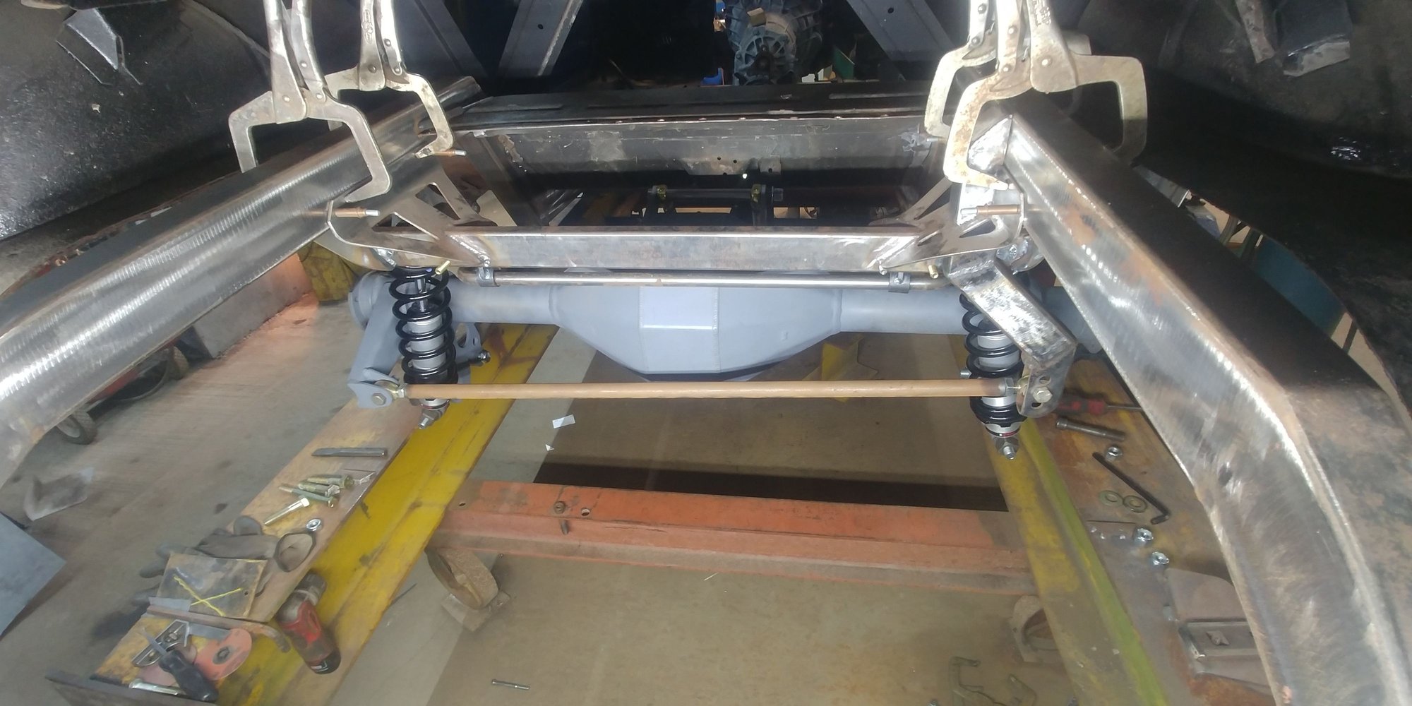

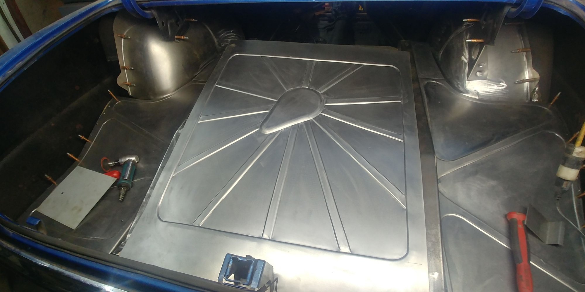

Default Trunk and Rear suspension Pictures
To bring the thread up to date on progress we are making on the Build!

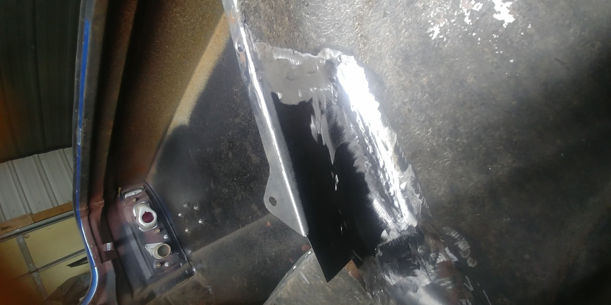

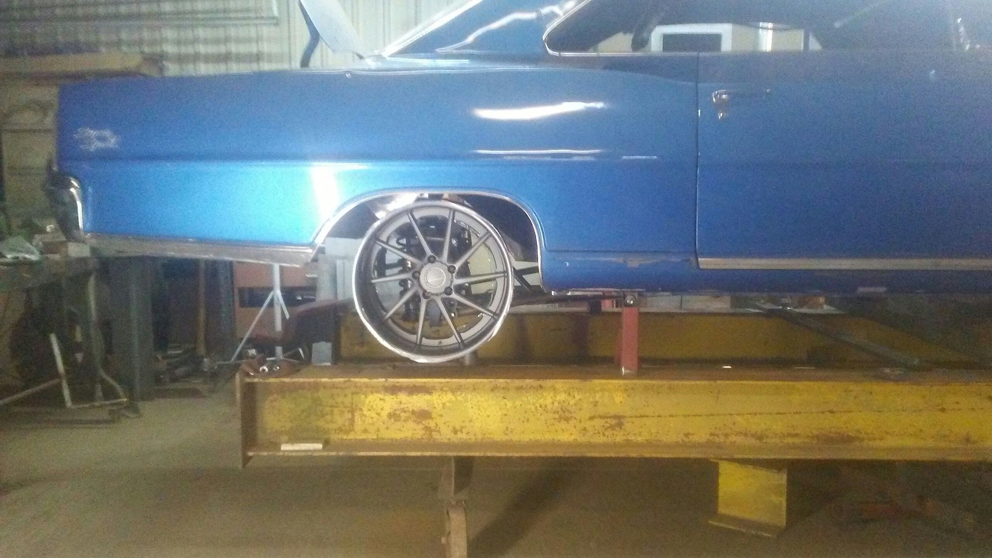

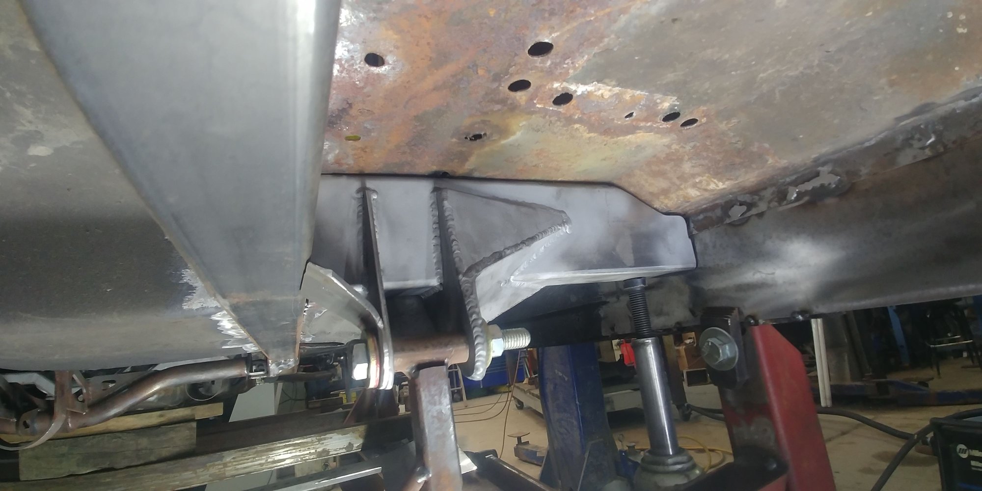

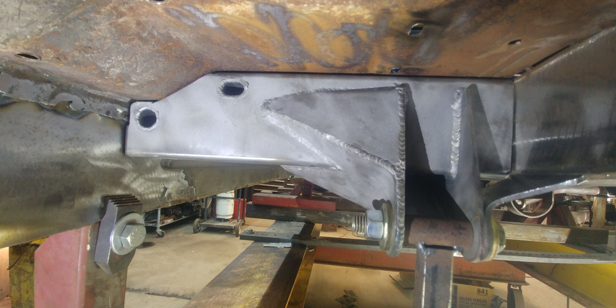

Repaired the mounting surface for suspension stubs to attach to. At a later date when in body work and painting phase of build, we can replace rockers and these inner panels. we want to get car driving, rolling,
A sneak peak at the wheels! 315/30 x 18 Michelin Pilot sport tires for the rear!

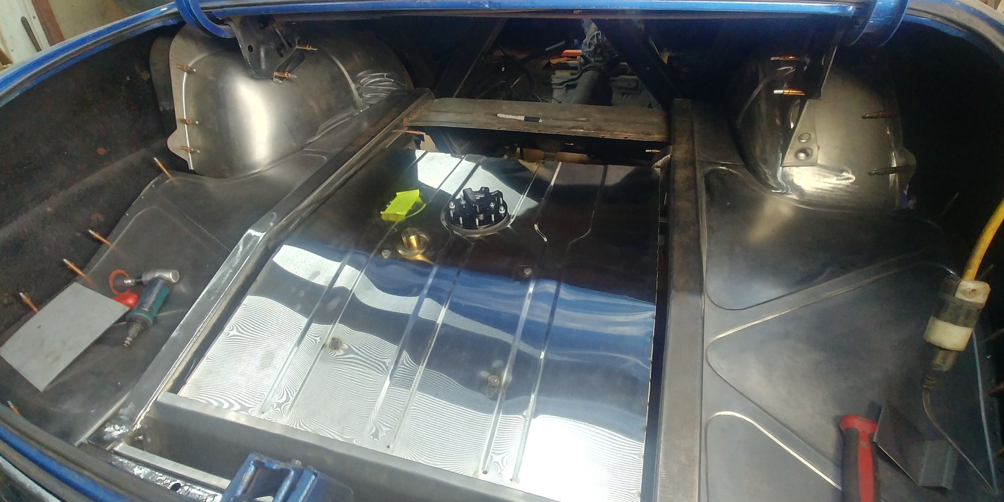

Default Da Junk In The Trunk

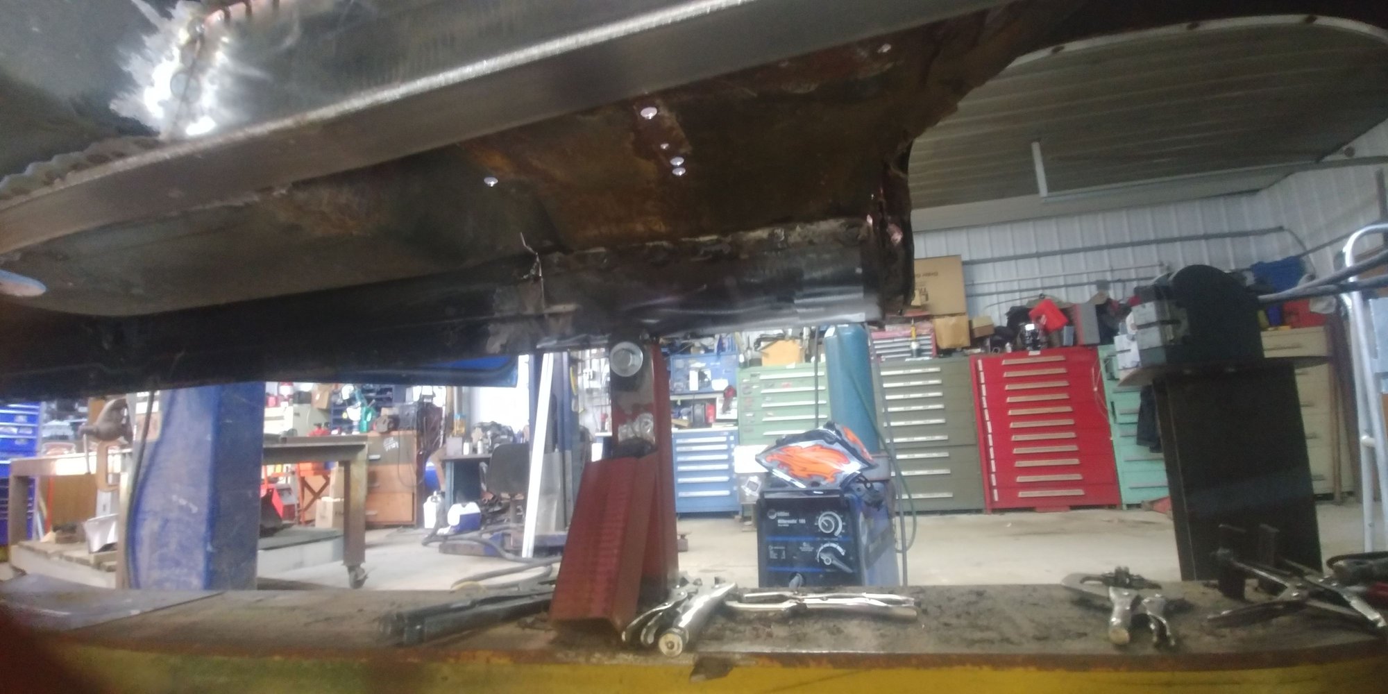

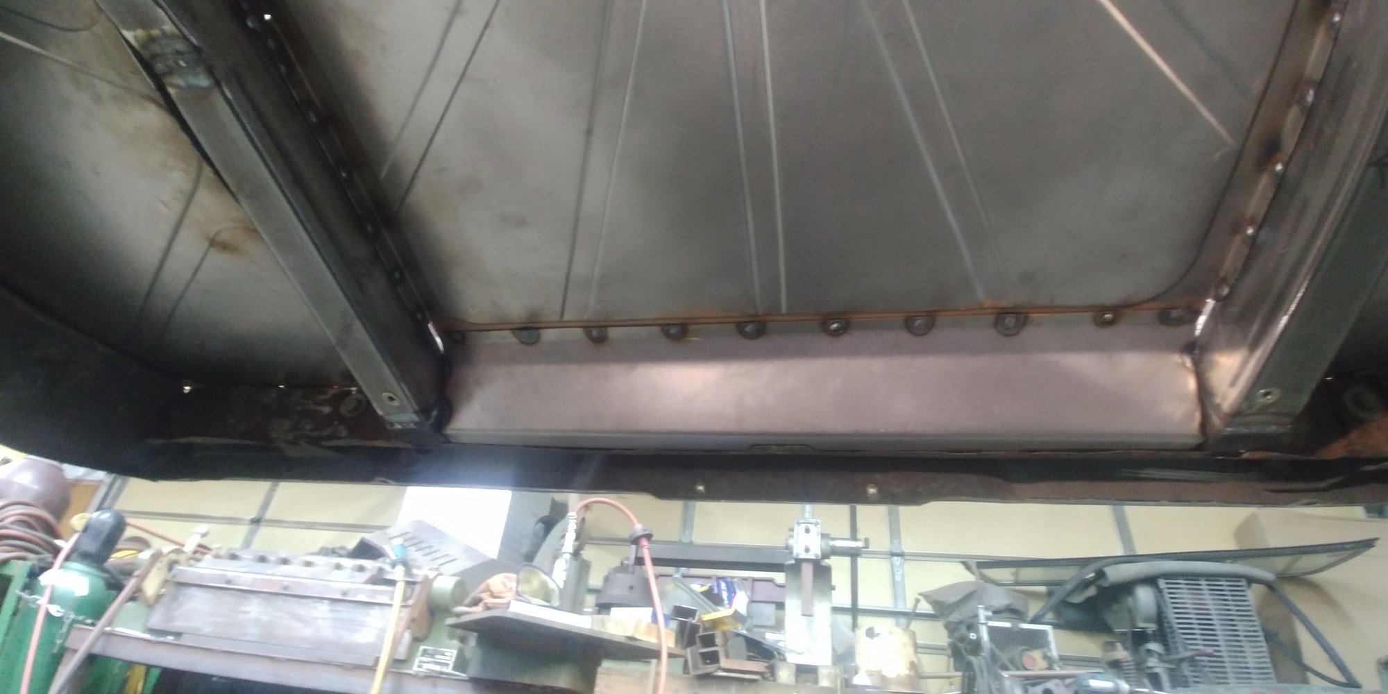

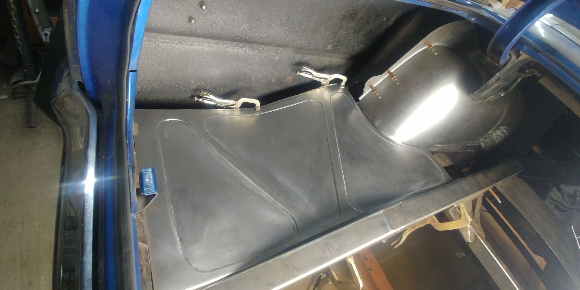

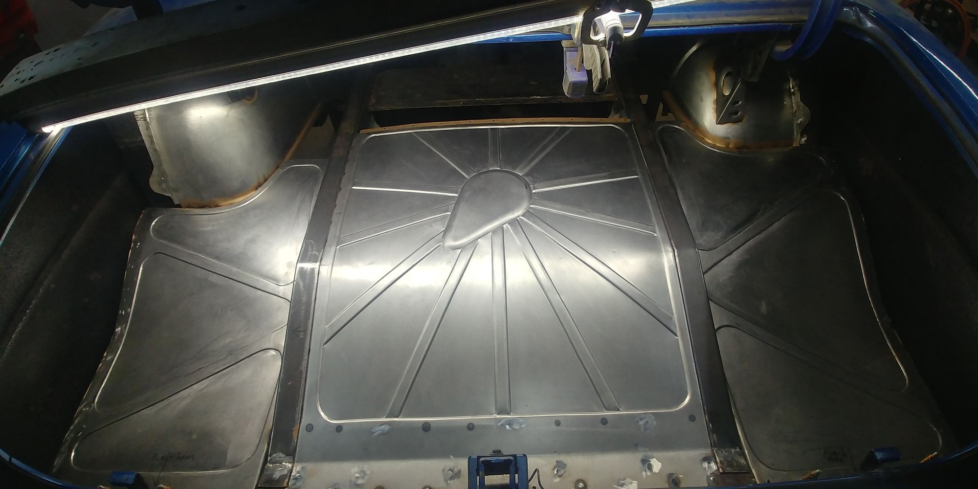

Here's what's gone on under the trunk panel and around the rear suspension. Here
Completed and welded trunk! Mike does nice work!!
Underneath view.

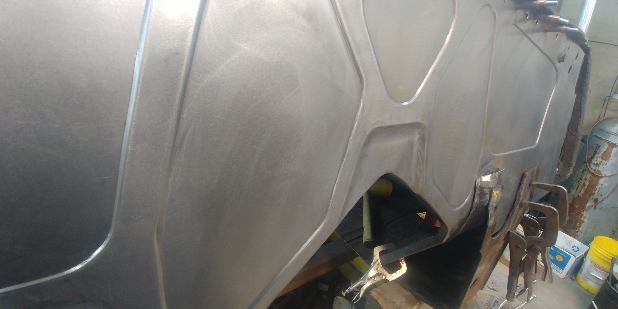

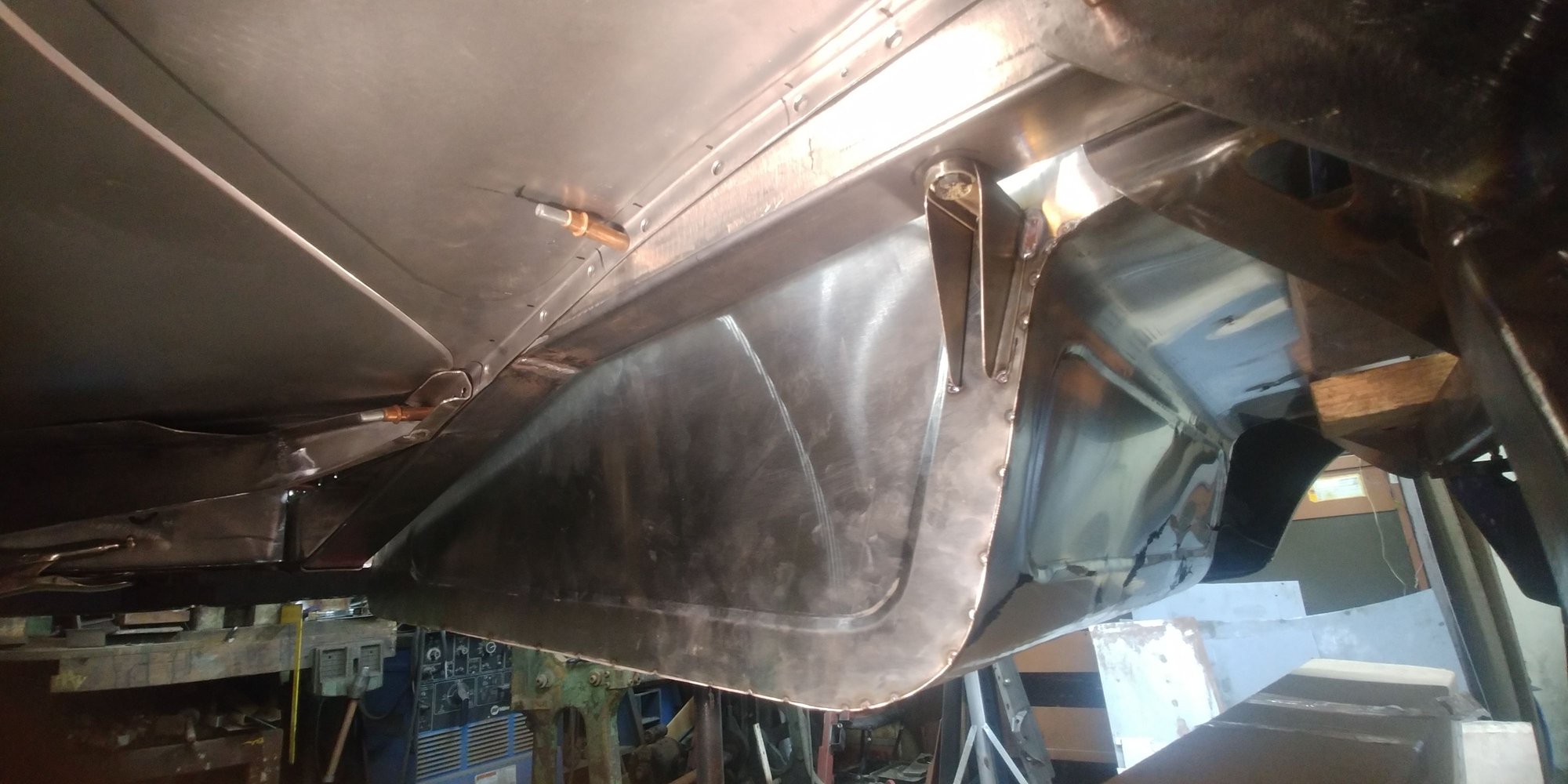

Fabbed panels above lower control arm rear suspension mounts. All panel joints got weld through primer treatment.
Patching the outer wheel house. We can replace the outer wheel house in the future when the car goes into the body work and paint phase.
The layout of the design.
fitting the panel.
How Mike Rolled and formed all the flat work.
Fitting the panel.
Completed Panel

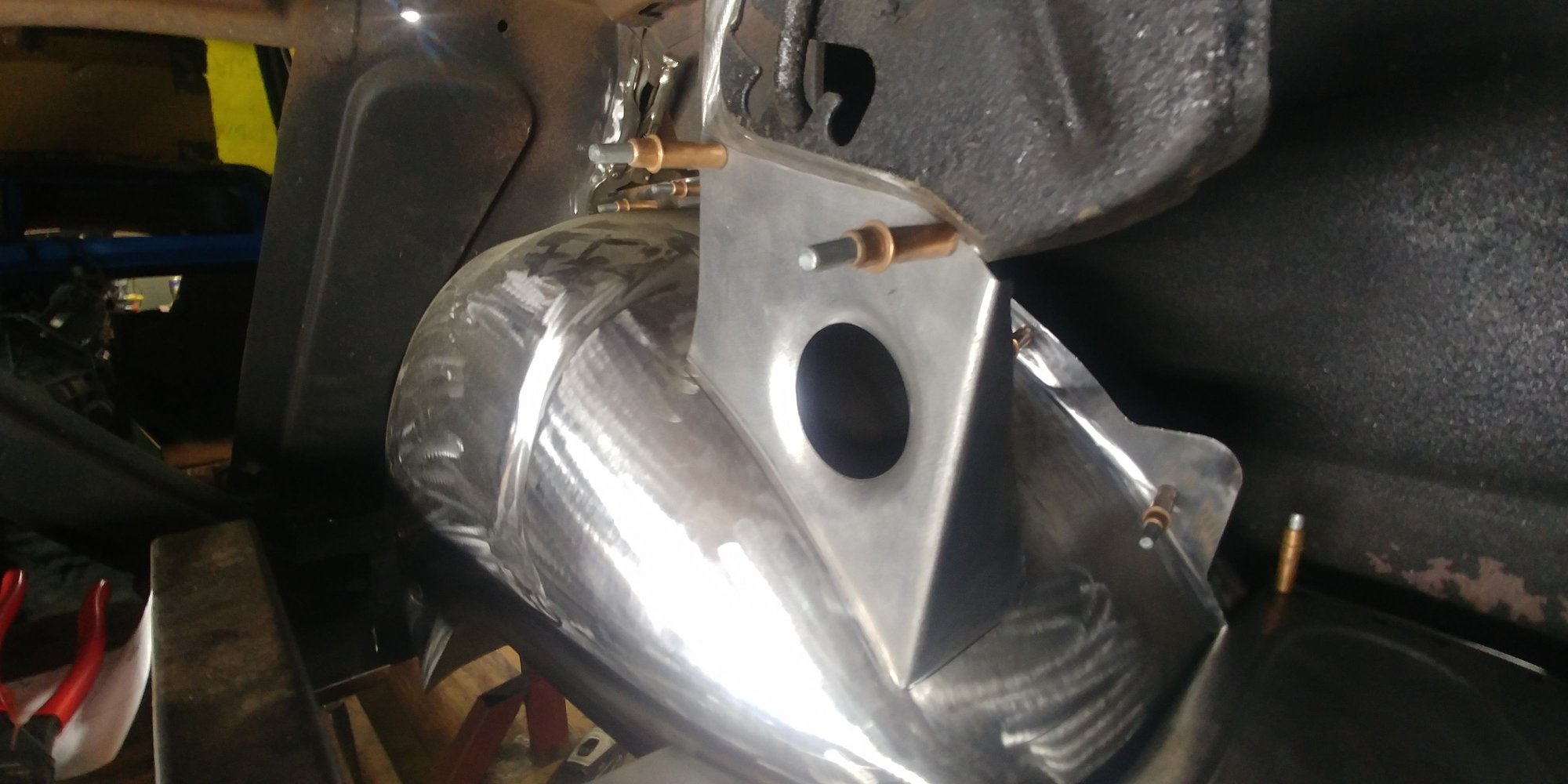

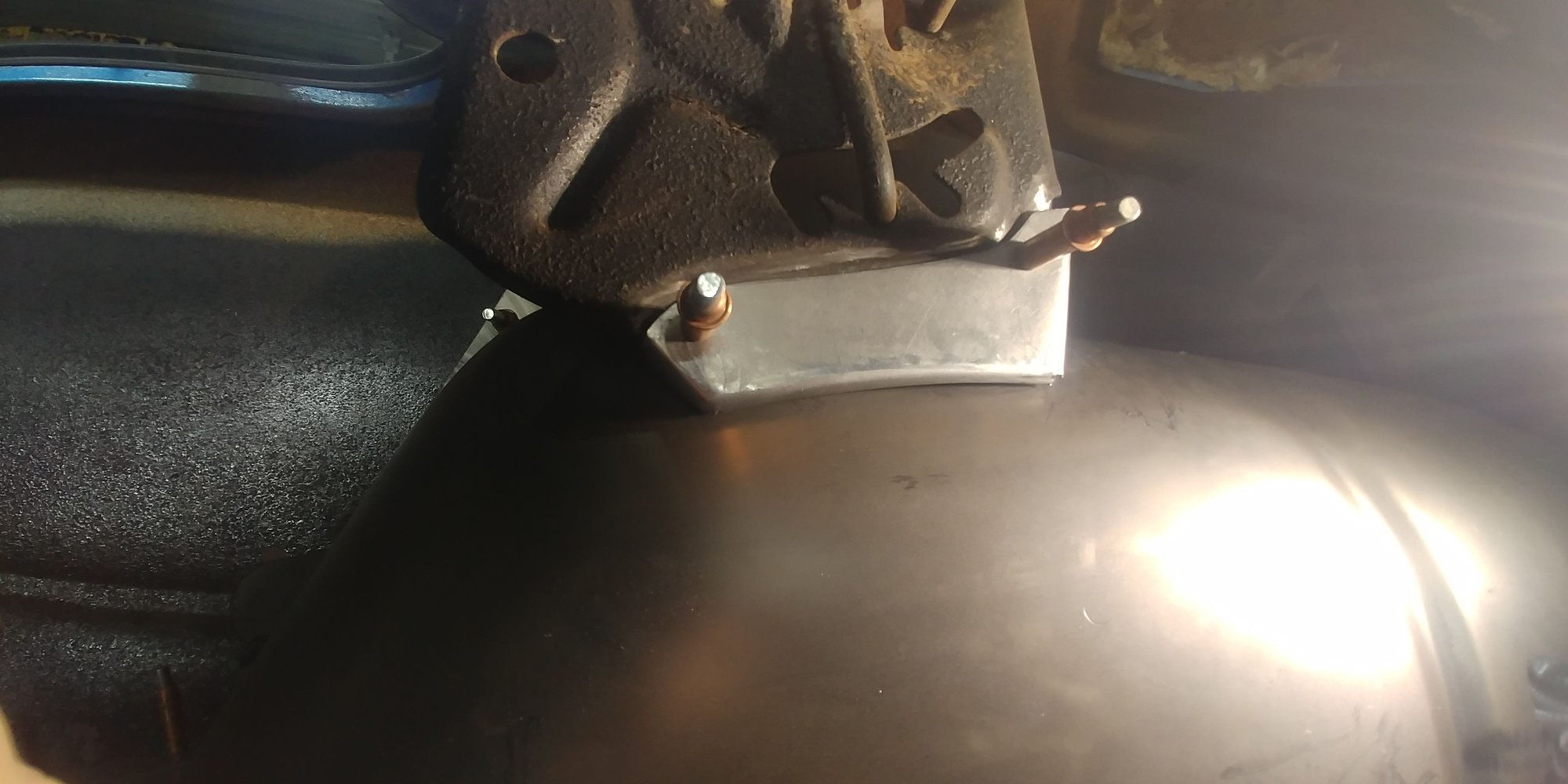

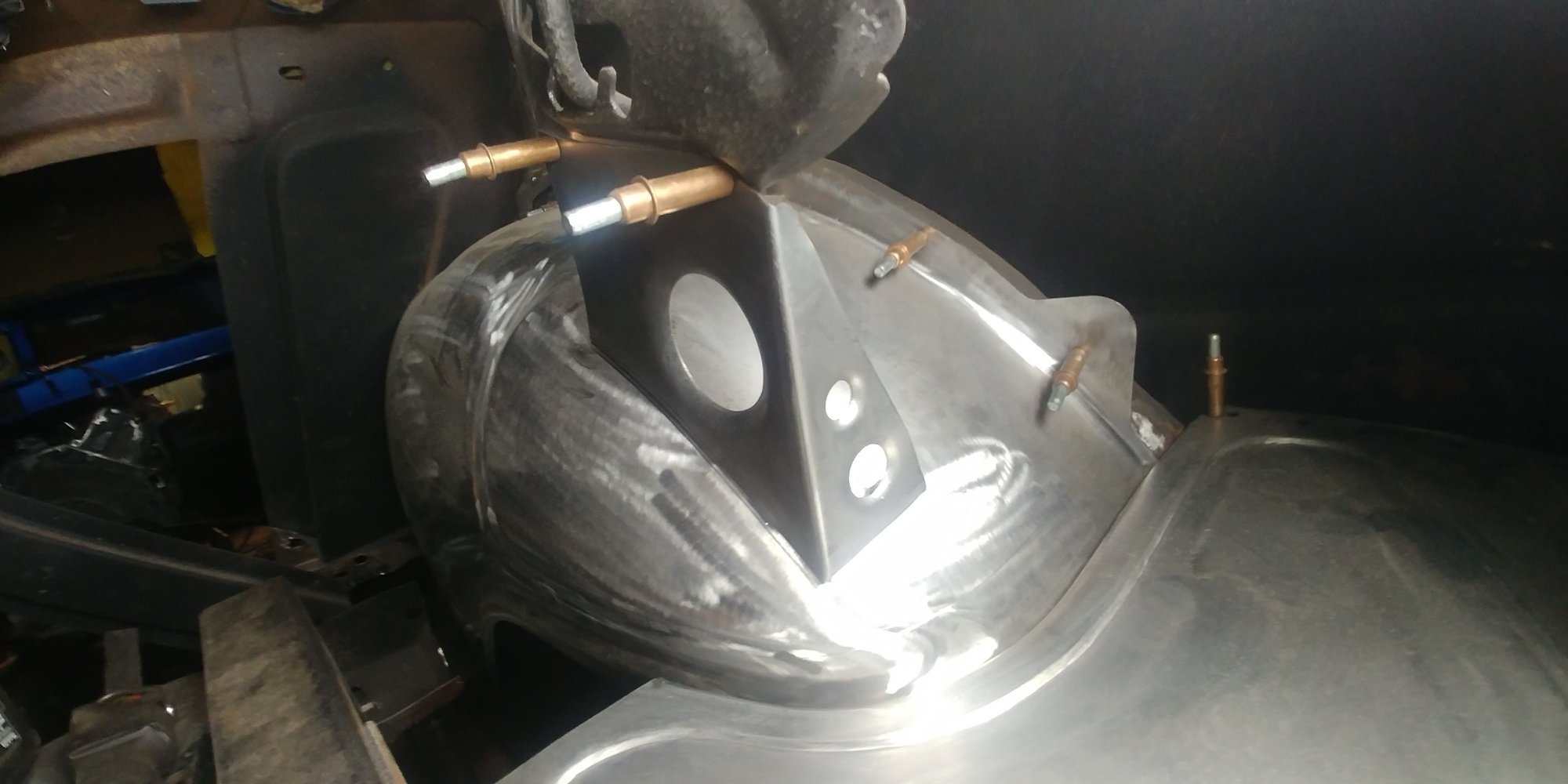

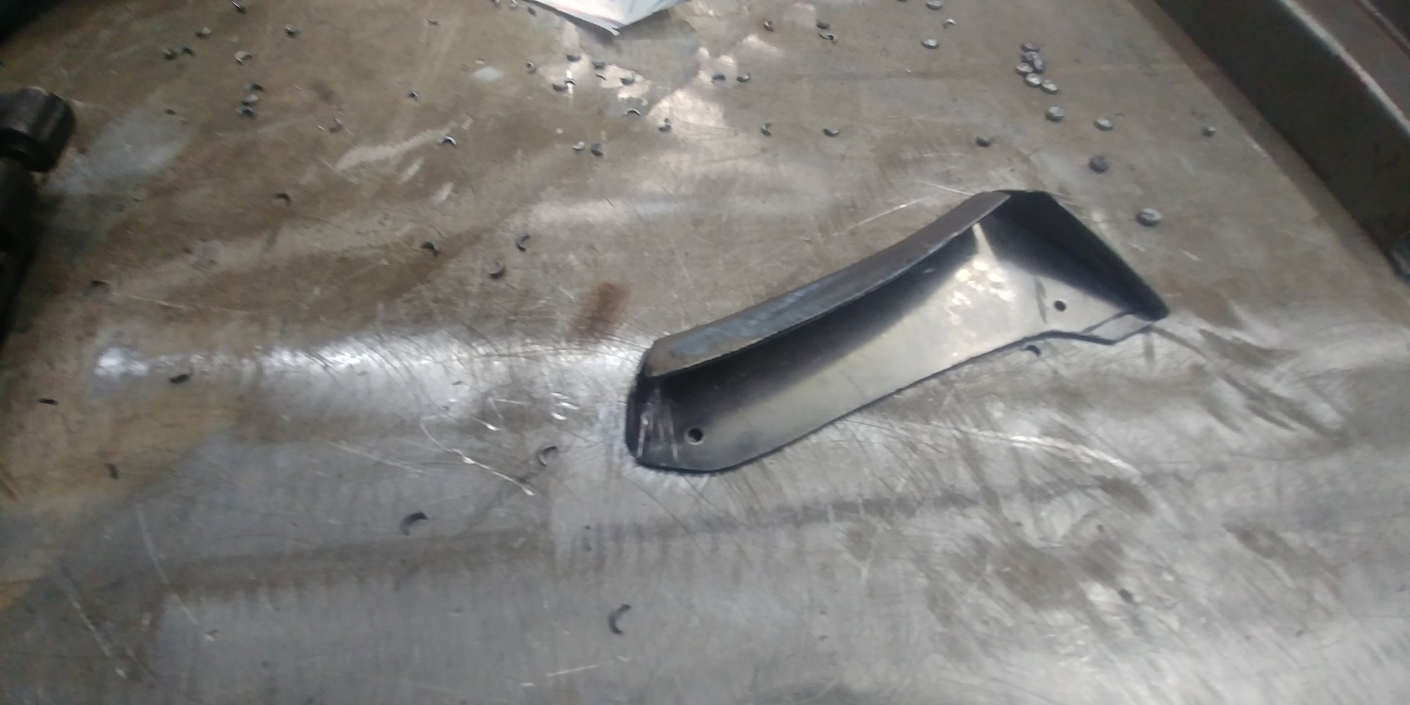

fitting the trunk hinge bracket.
completed trunk hinge bracket.
What the bracket started out as.
Drivers side panel.
Completed Trunk hinge bracket
Completed trunk hinge bracket.
is the completed trunk view. all the metal is 16 gauge.

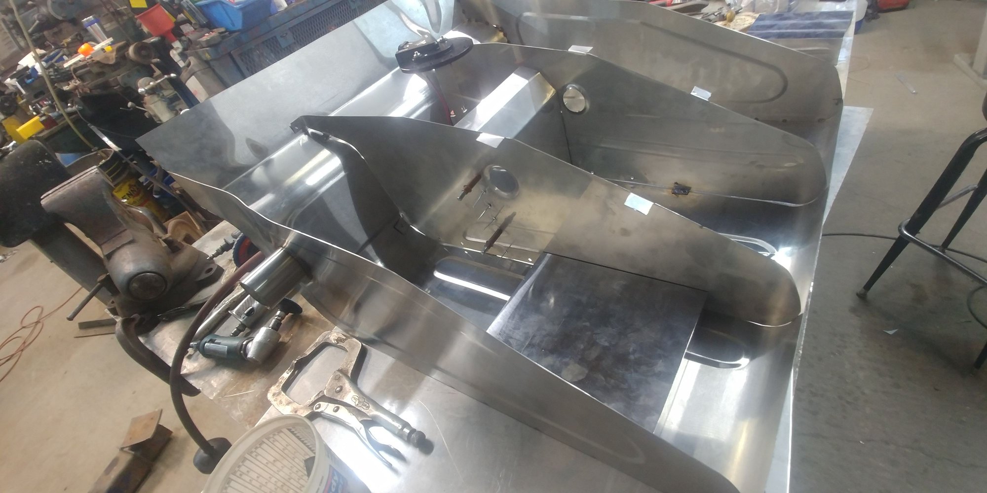

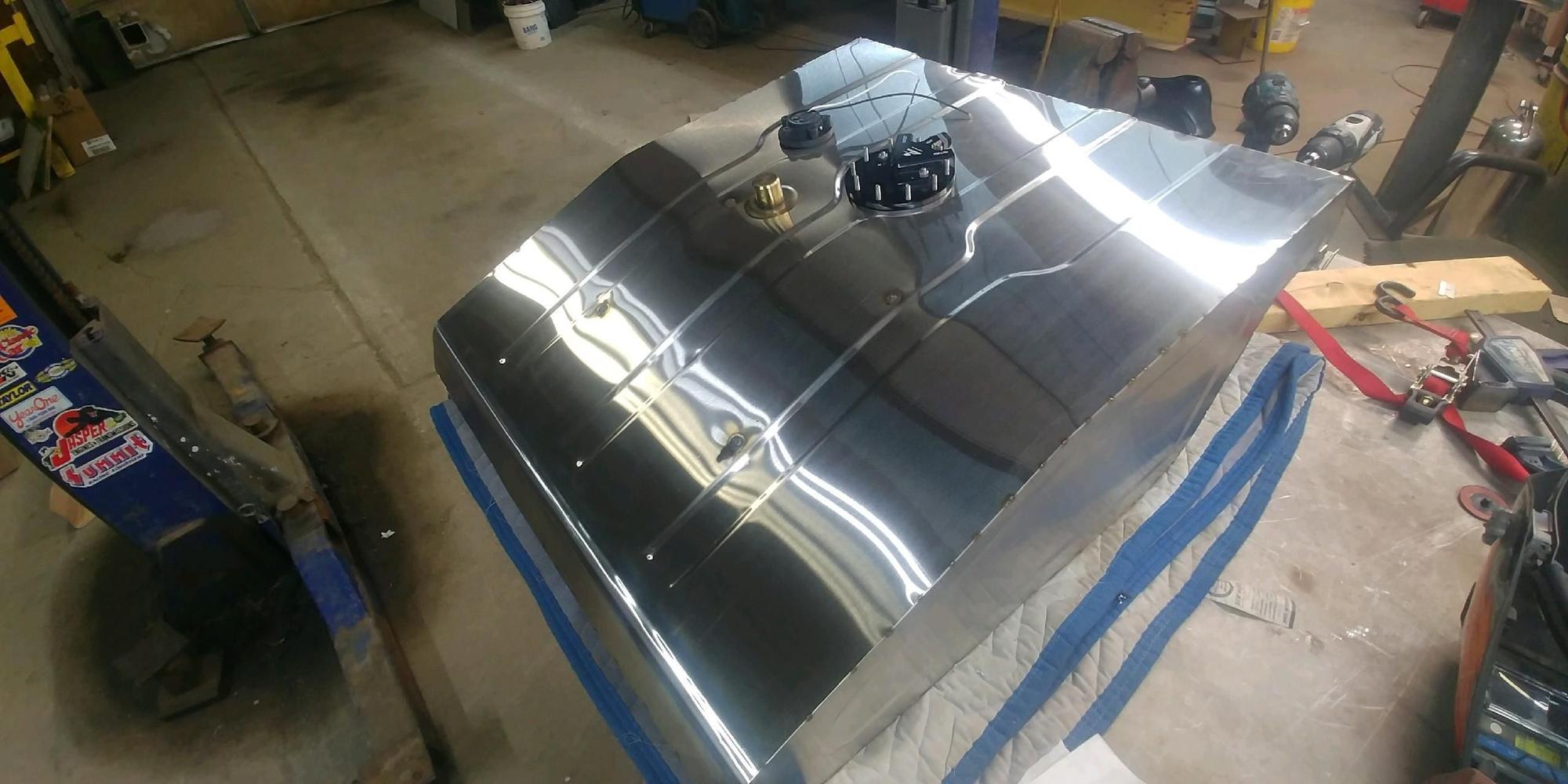

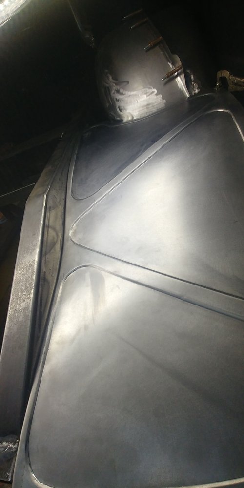

Default fuel tank fabrication

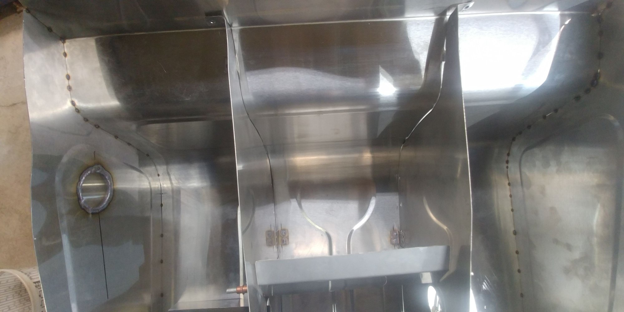

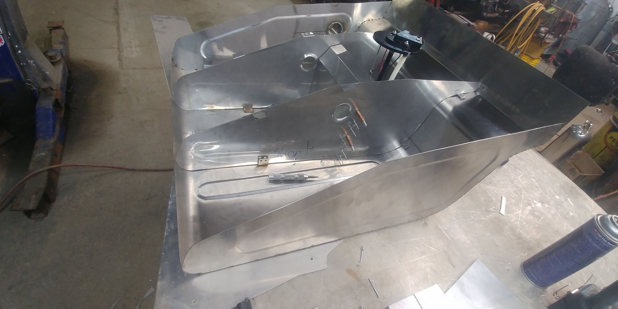

Fabbing up the fuel tank:
Fuel tank being fabbed up.
Another view
topp of tank brought onto tank.
A check between the rails.
the sending unit being fitted.
All tacked up
Fuel filler welded in.
fuel tank check fit
Fuel tank bolted in place.

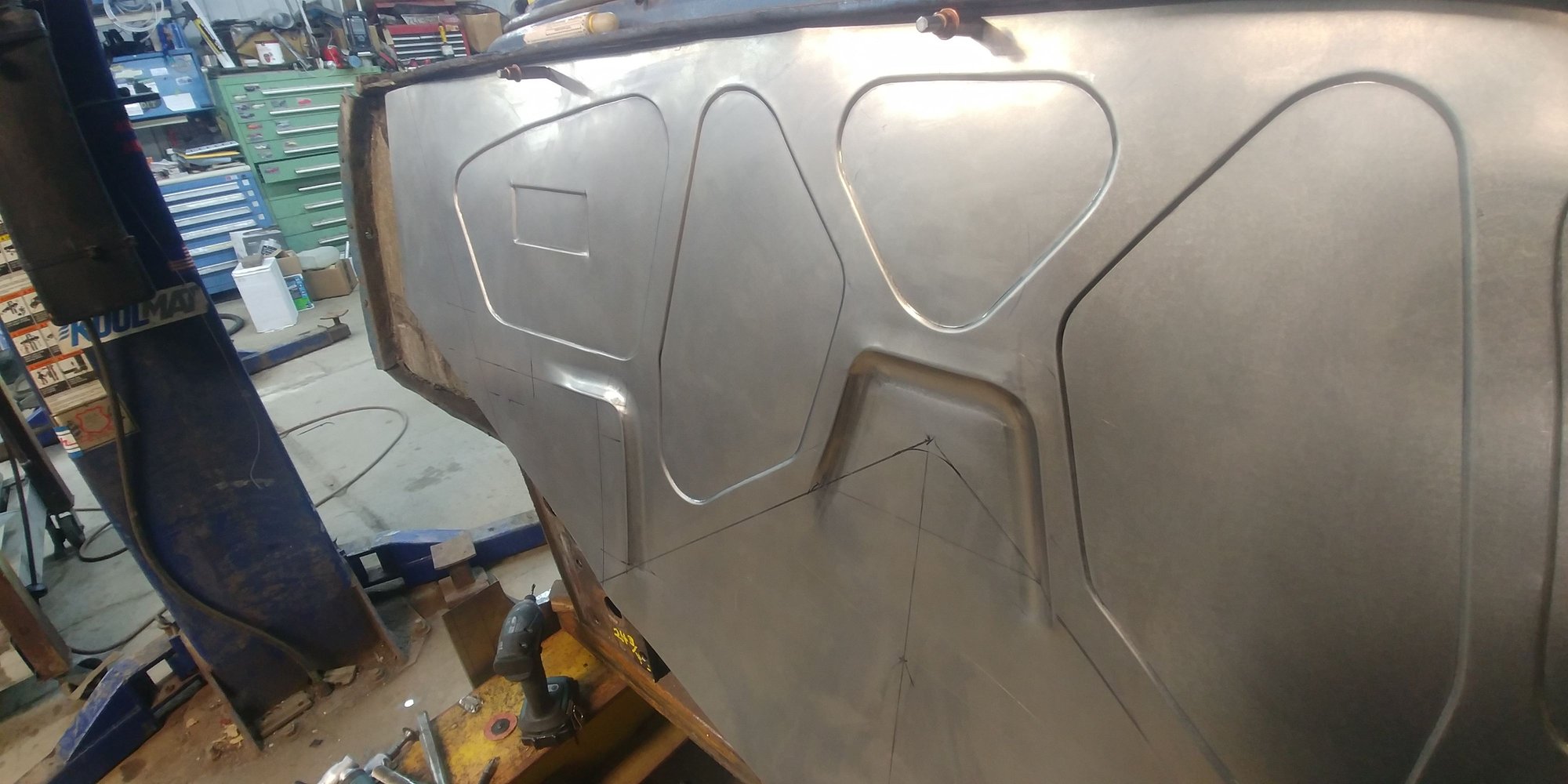

Default working on the front end.

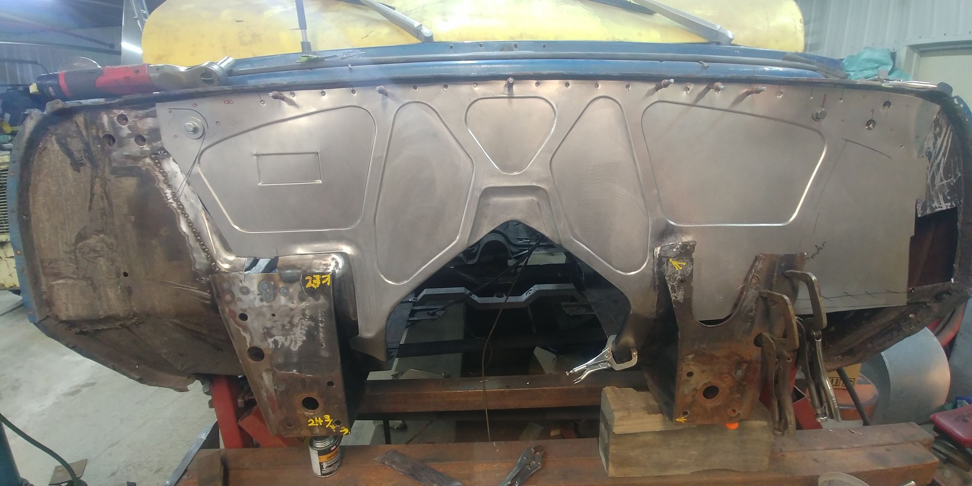

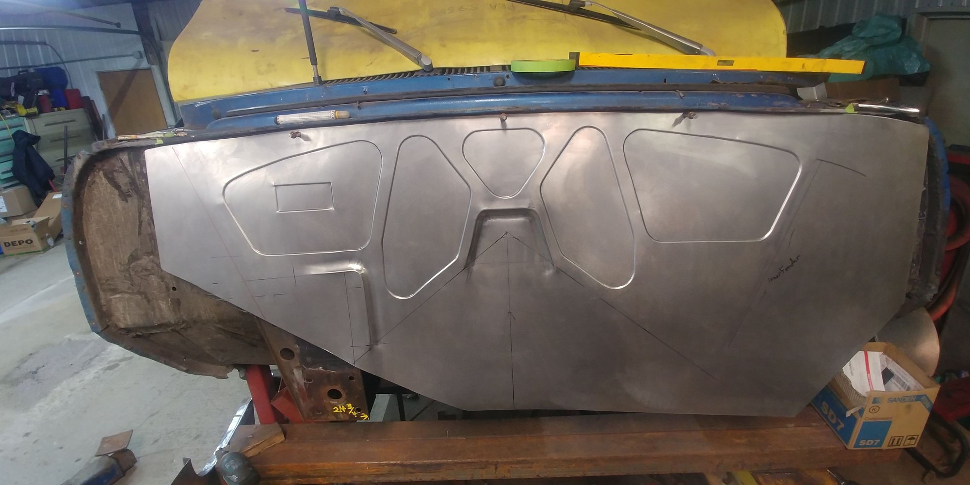

Fabbing up the firewall.
The design laid out.
Fitting and trimming.
checking the layout.
another check
Getting closer!

Default Fire Wall Installed
Firewall installed:

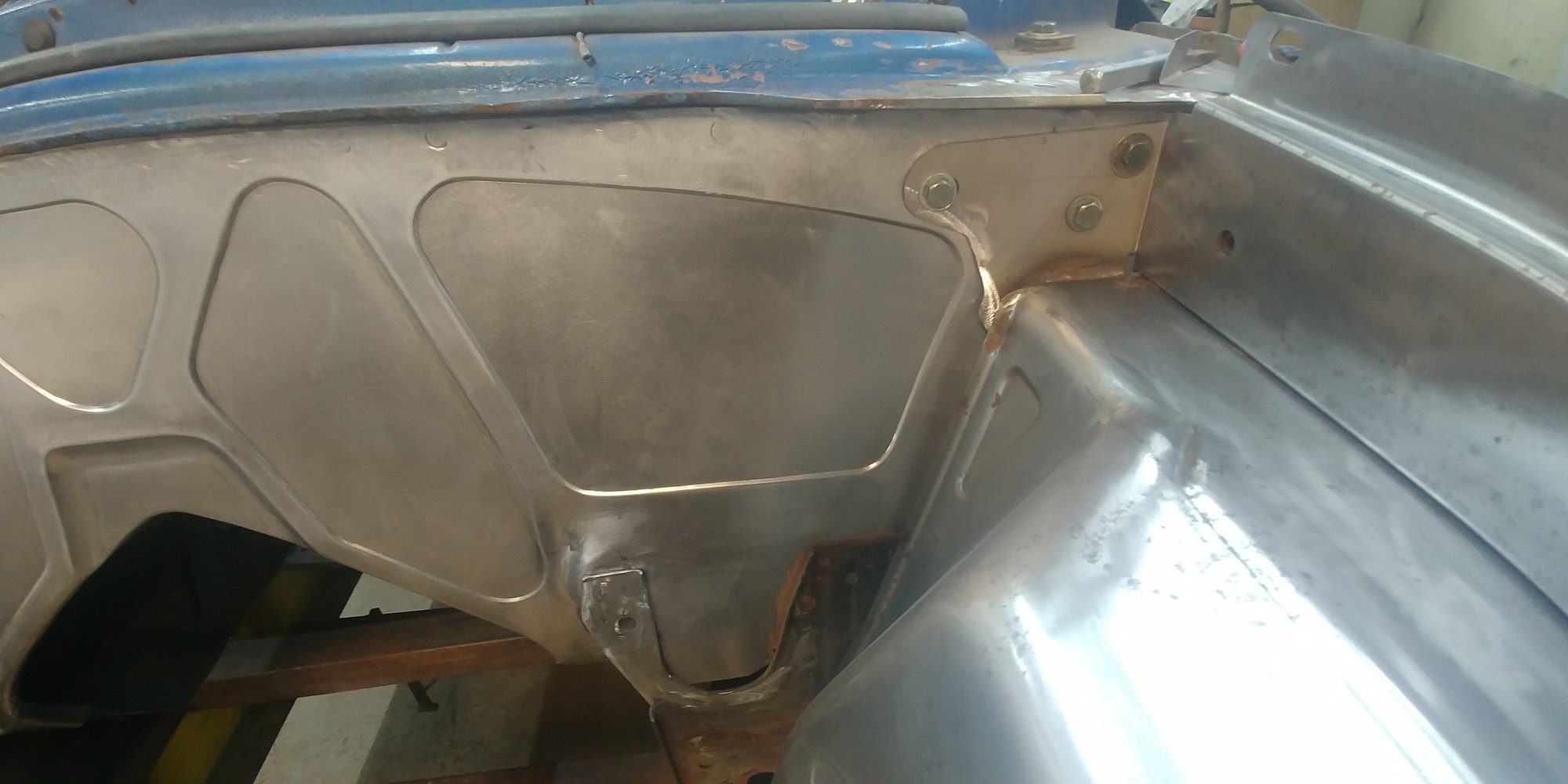

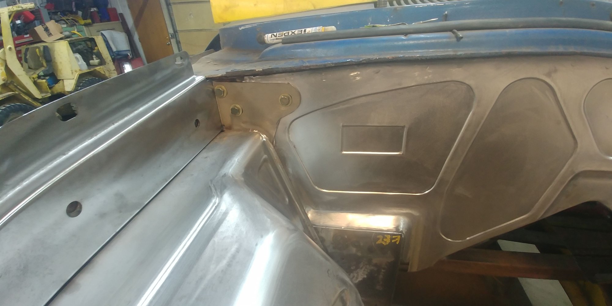

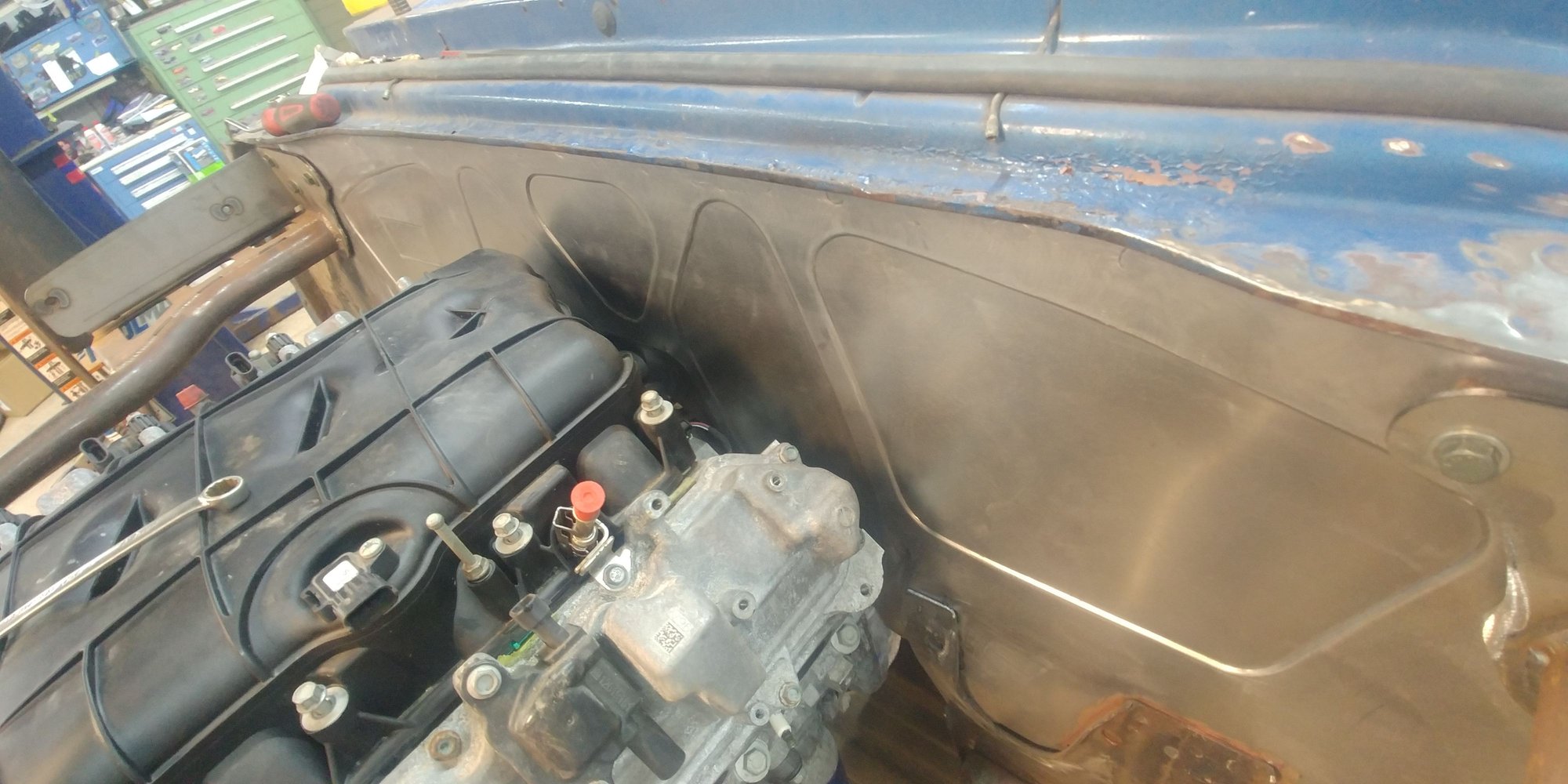

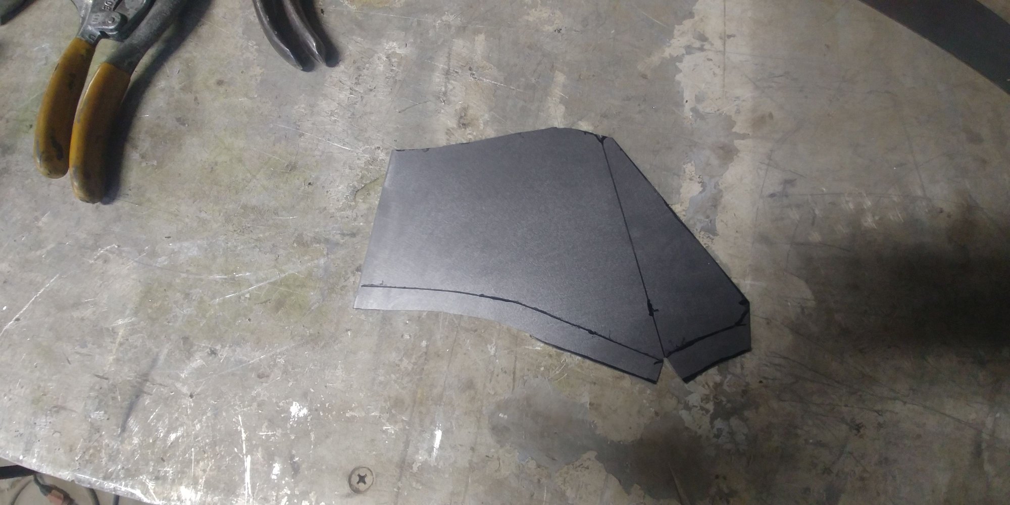

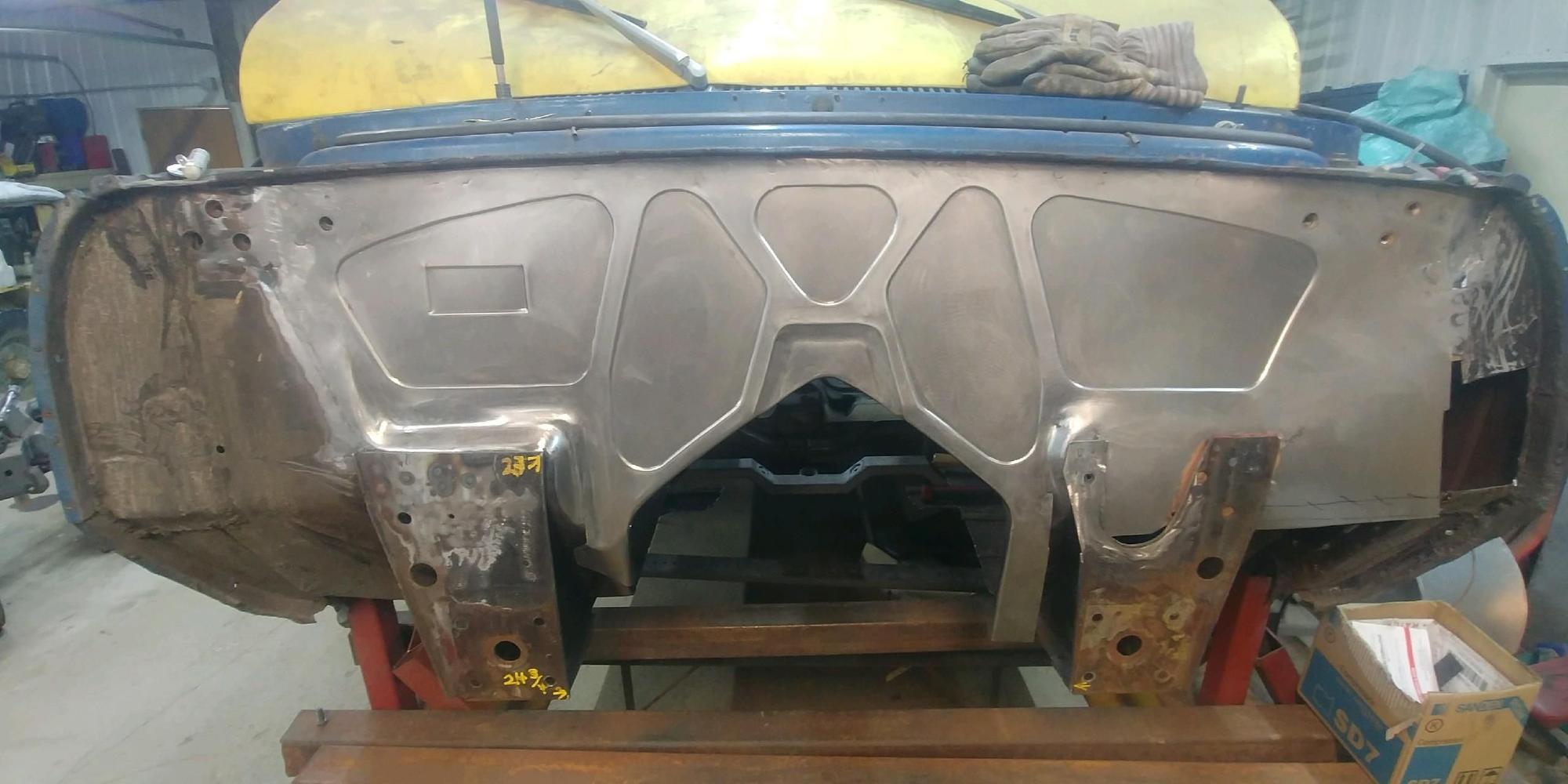

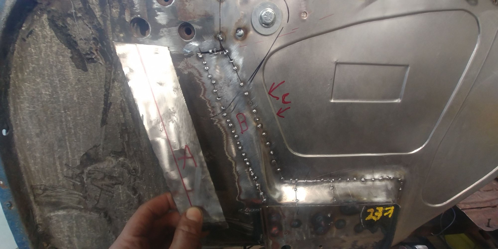

Default Firewall to Engine Clearance and Some sheet Metal

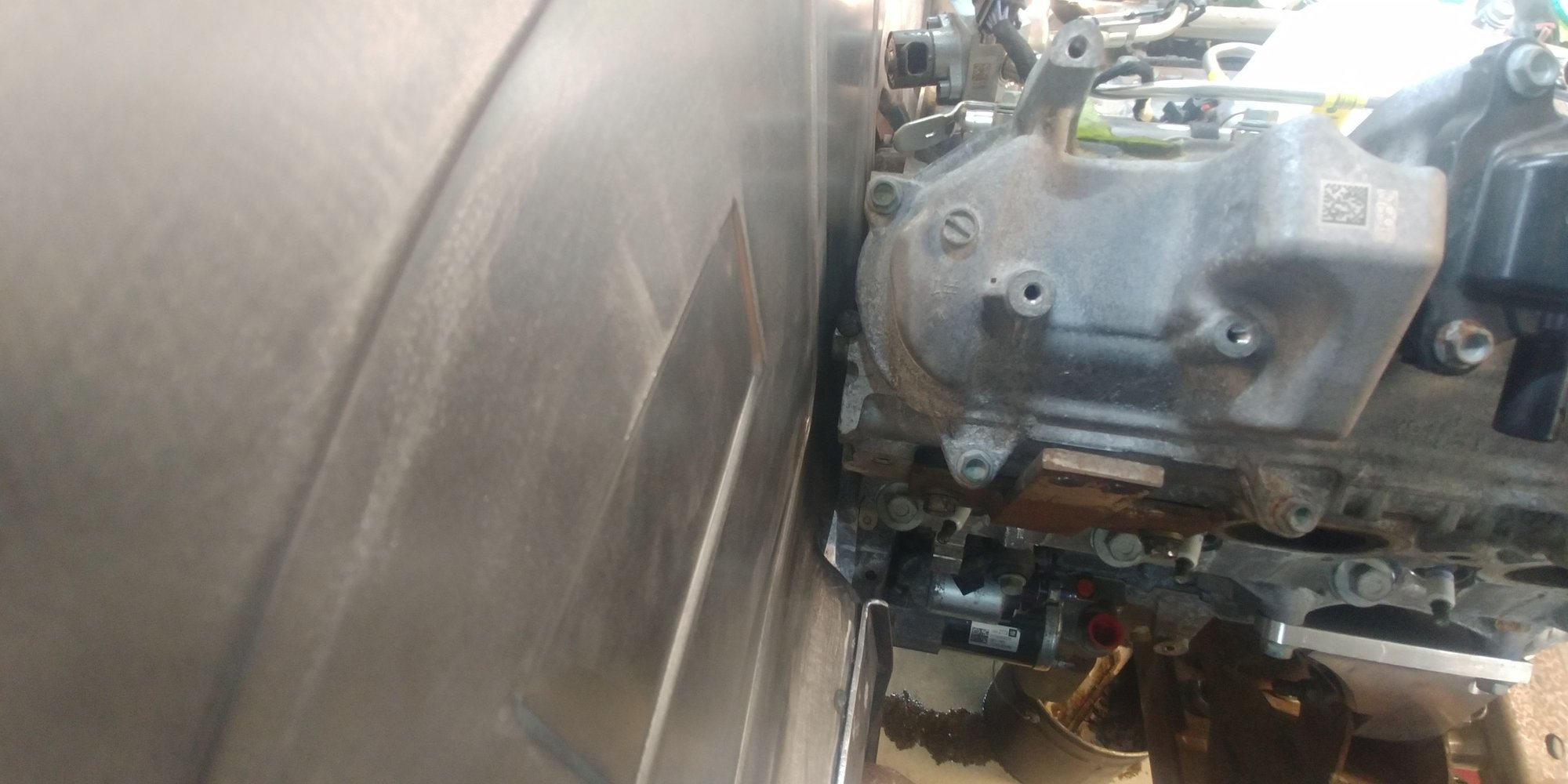

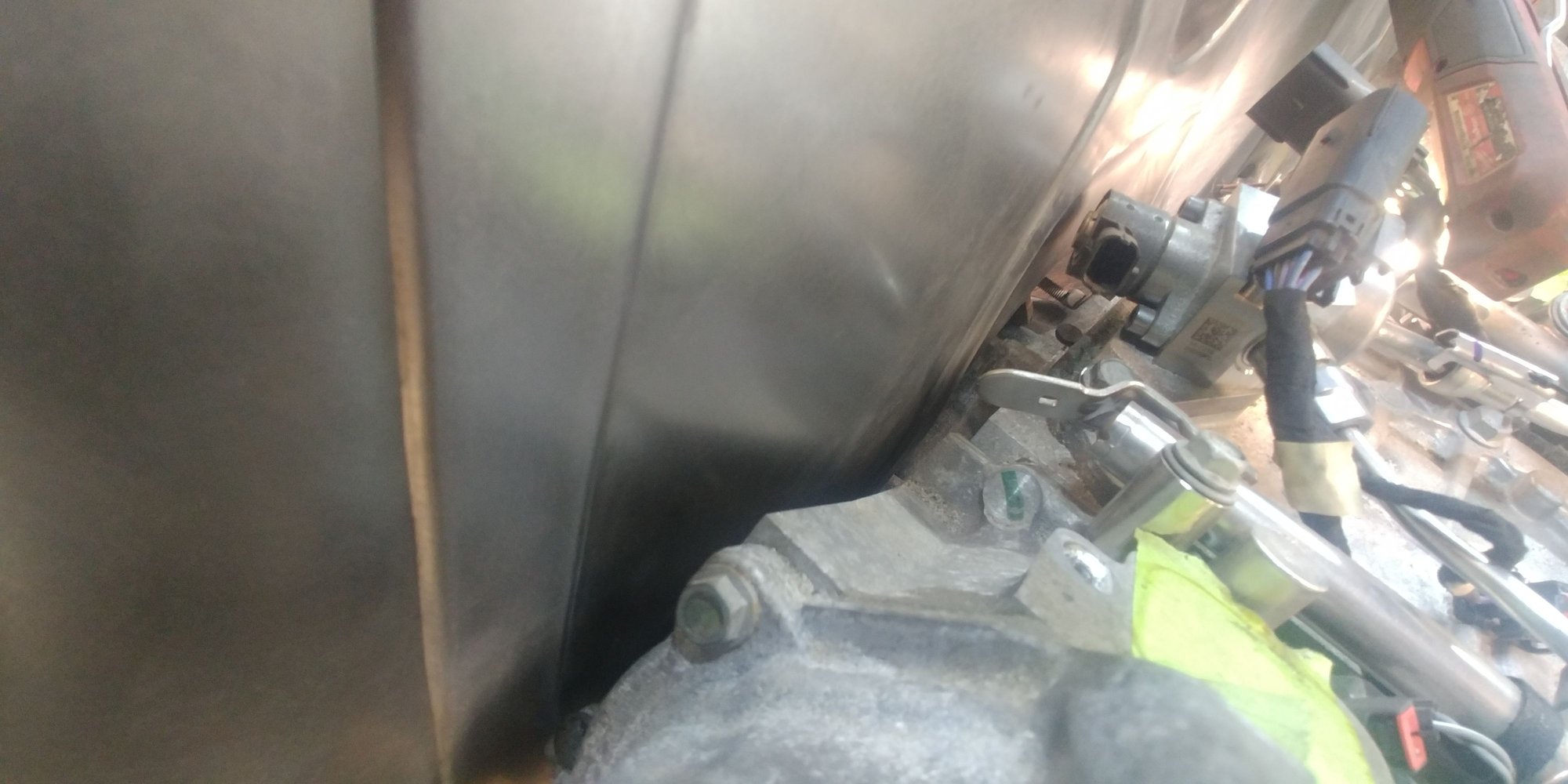

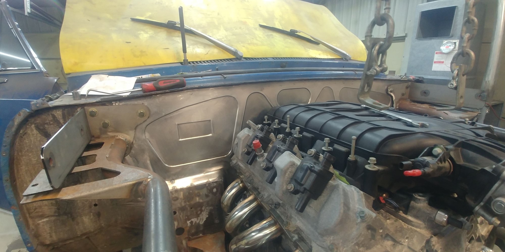

How the engine fits and some DSE sheet metal for your viewing pleasure:
Section A was cut out of the firewall. Section B was moved over to where section A was because it had an indentation to it that matched the rest of the firewall. This section was moved over to make panel C come all the way over to the inner fender panel. This makes the firewall more "symmetrical". It would look odd to me if this step wasn't performed. Study the pics with the inner fenders in place for a better understanding

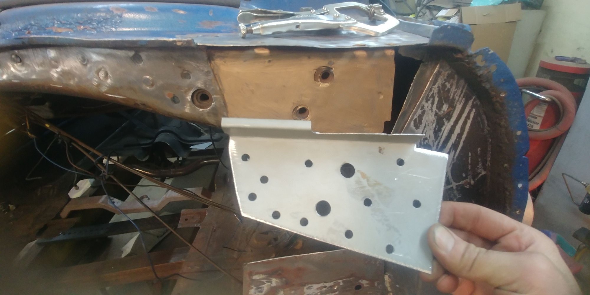

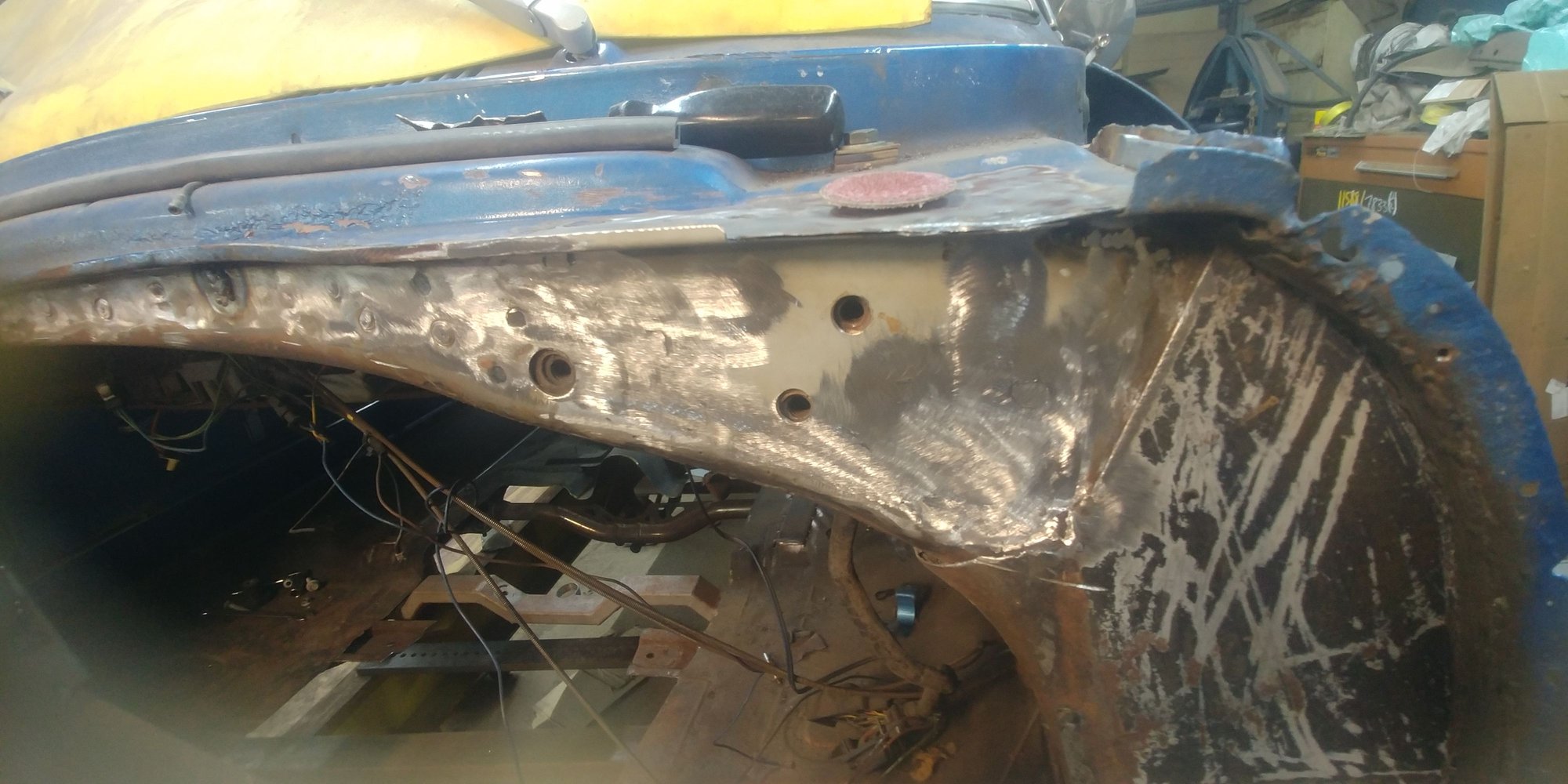

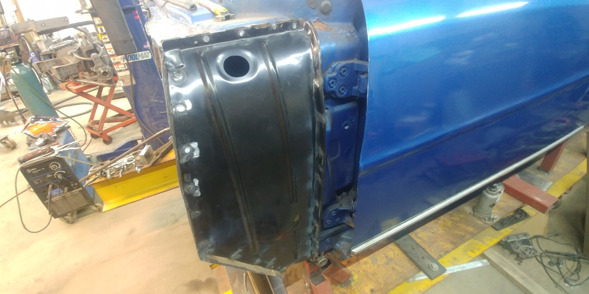

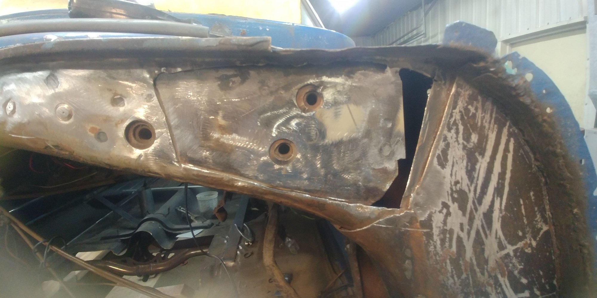

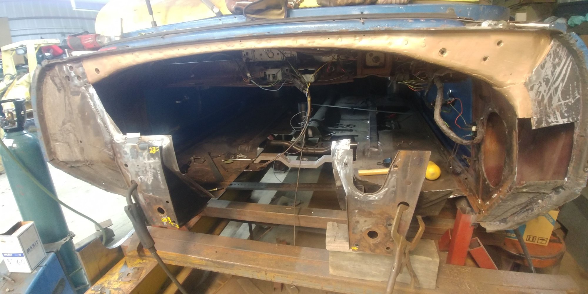

Default Cowl Repair Prior To The Firewall Instalation
A bit of cowl repair prior to the firewall installation.
The cowl rot.
Cutting out the cowl rot.
First patch installed.
Previous area of rot removed, patched and weld-through primed. Repair patch created.
Repair patch installed.
Weld-through primer applied and ready for the firewall.

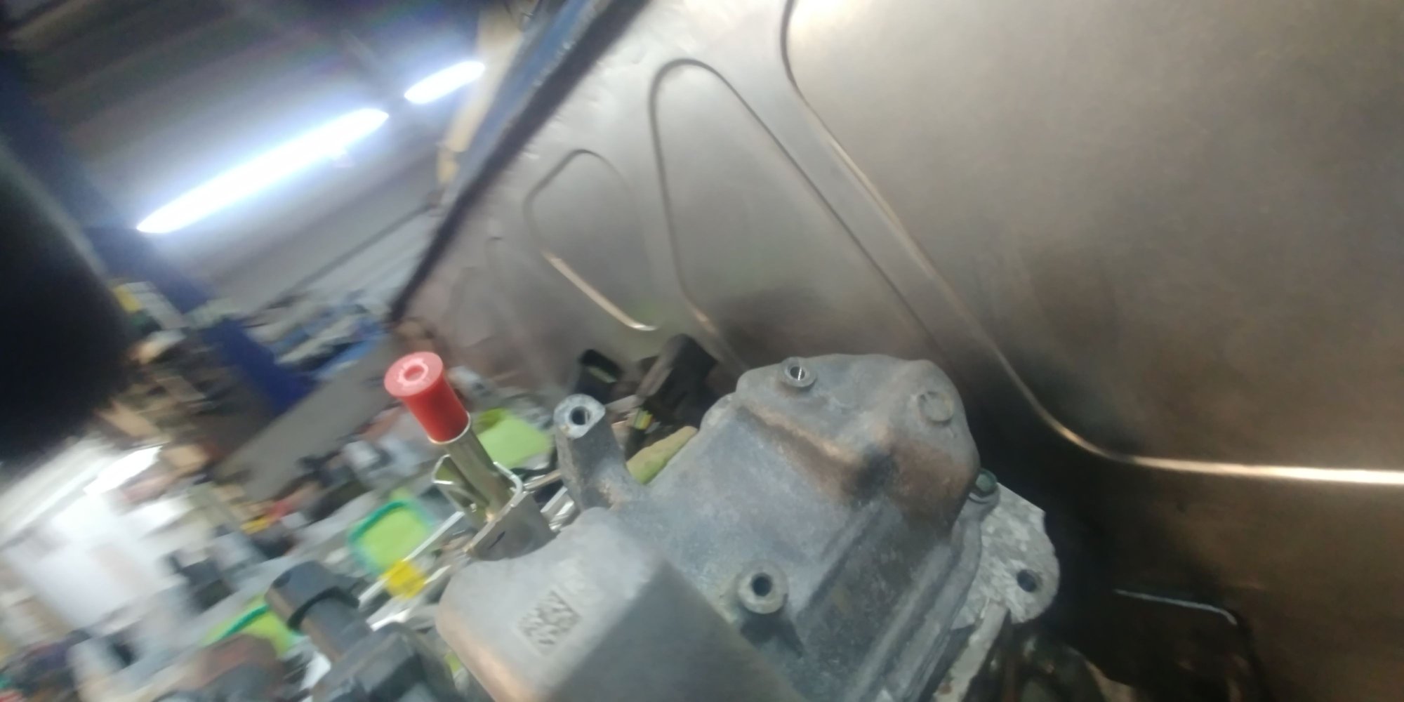

Default The Engine Fit
A sexy shot.
Another view.
Tight snug fit.

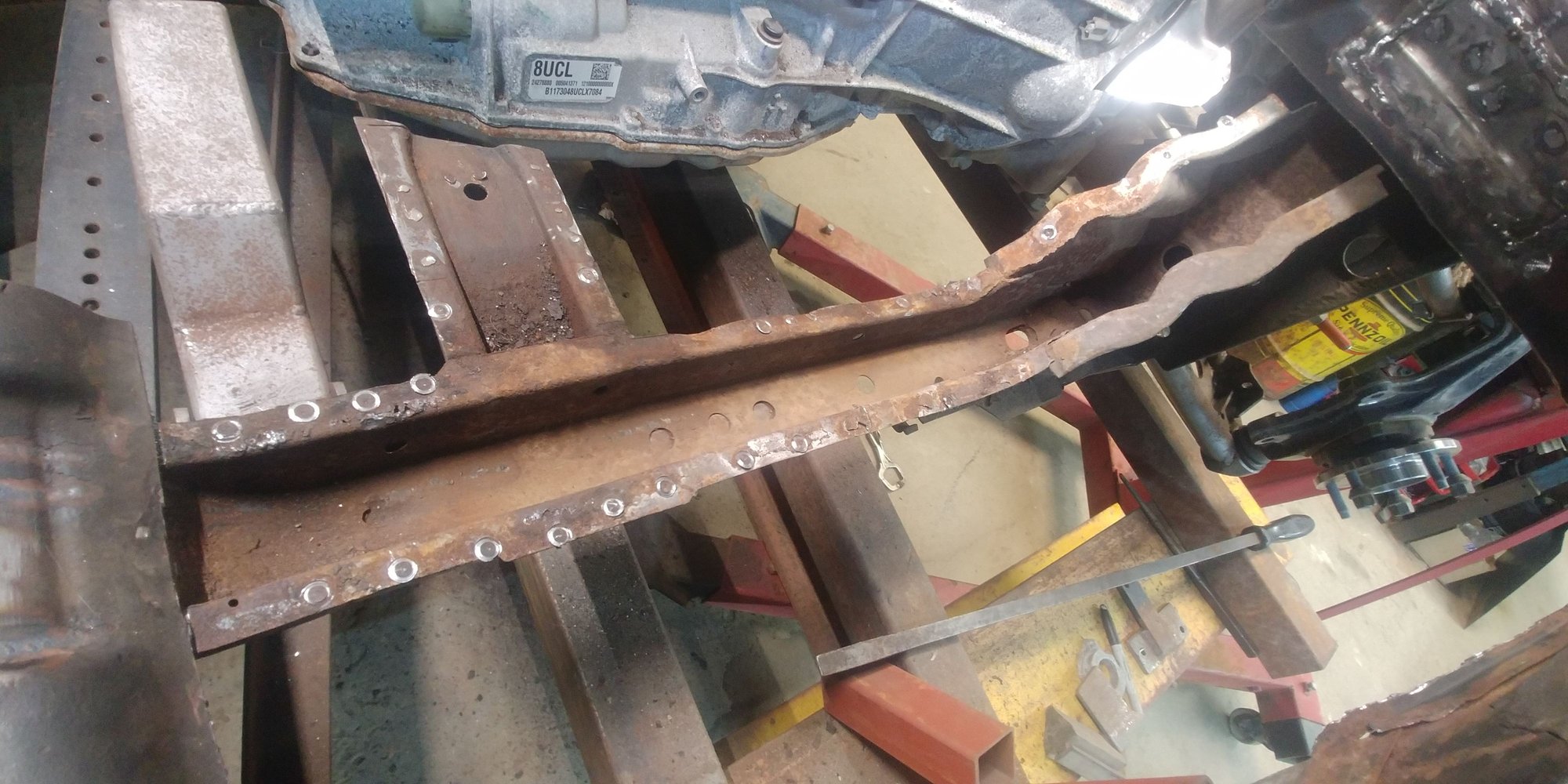

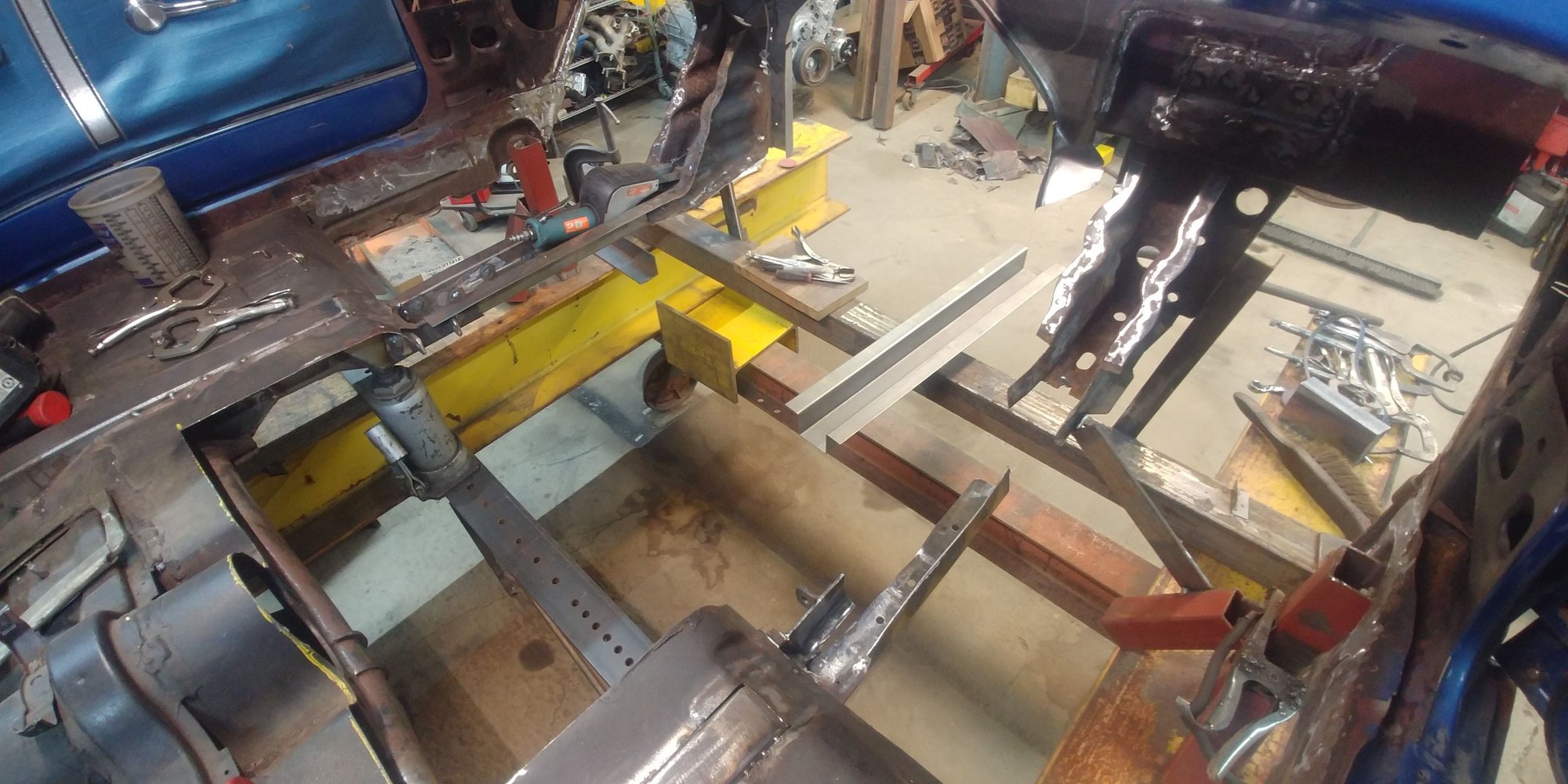

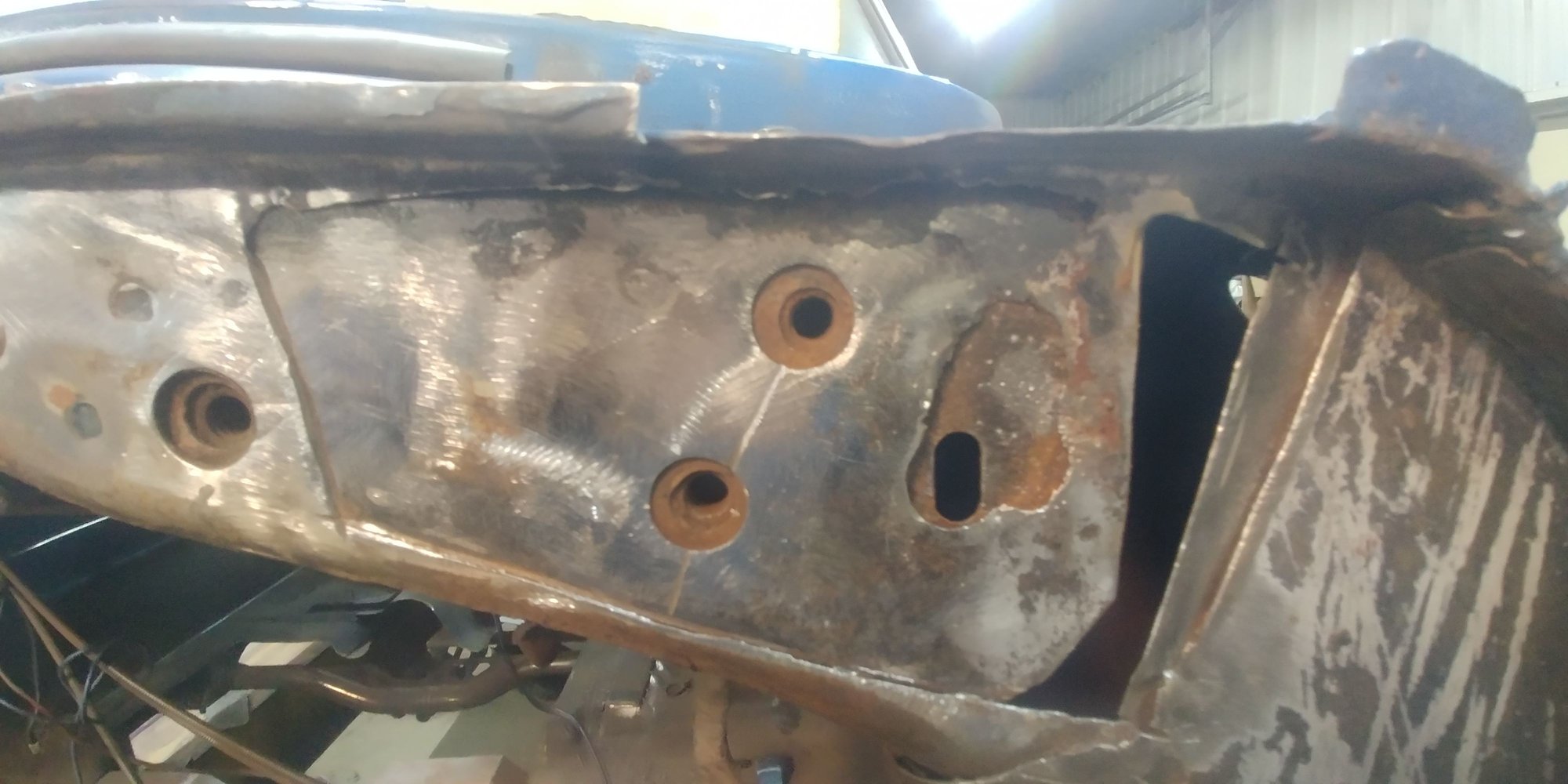

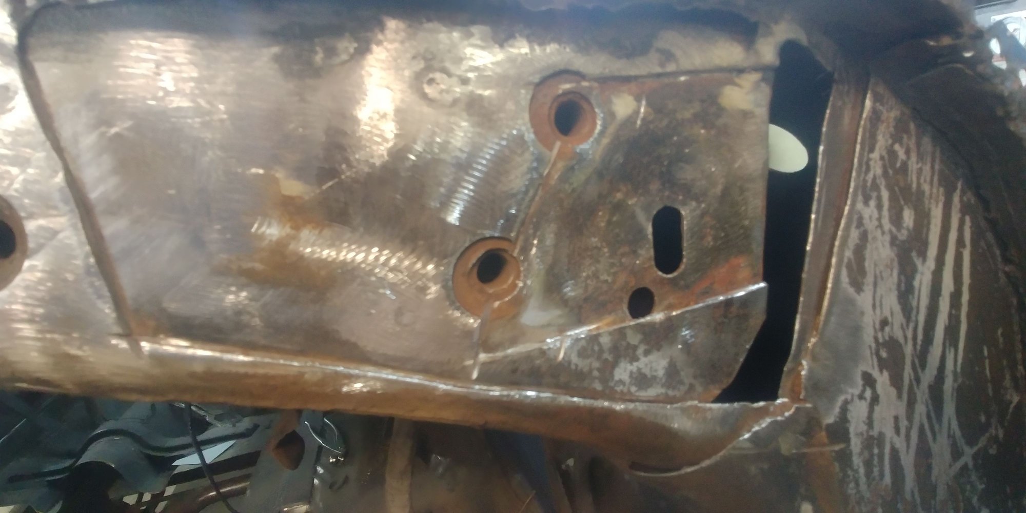

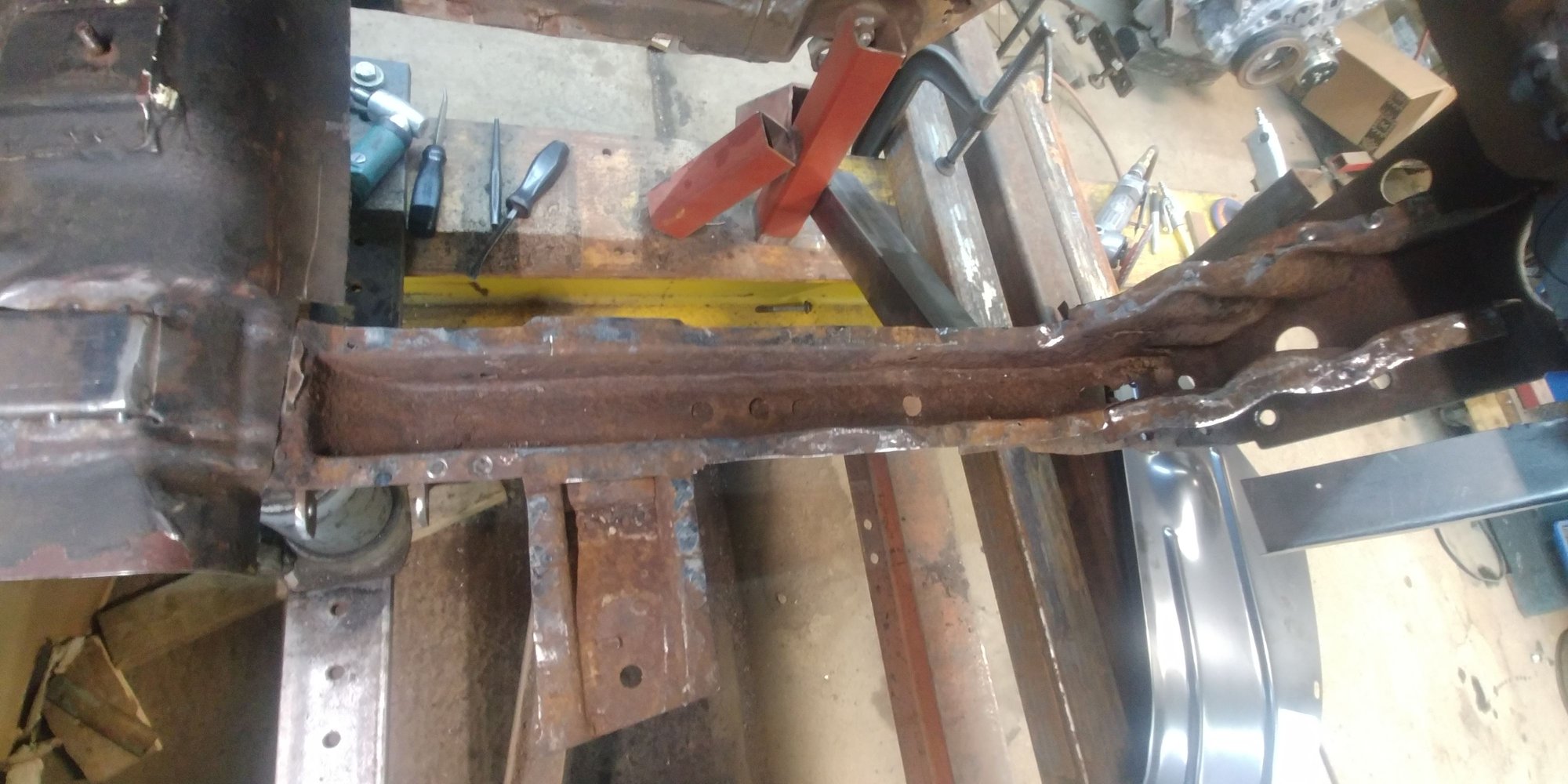

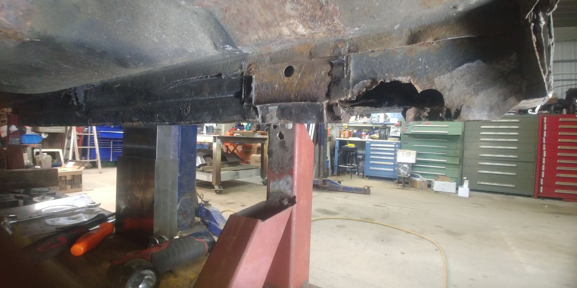

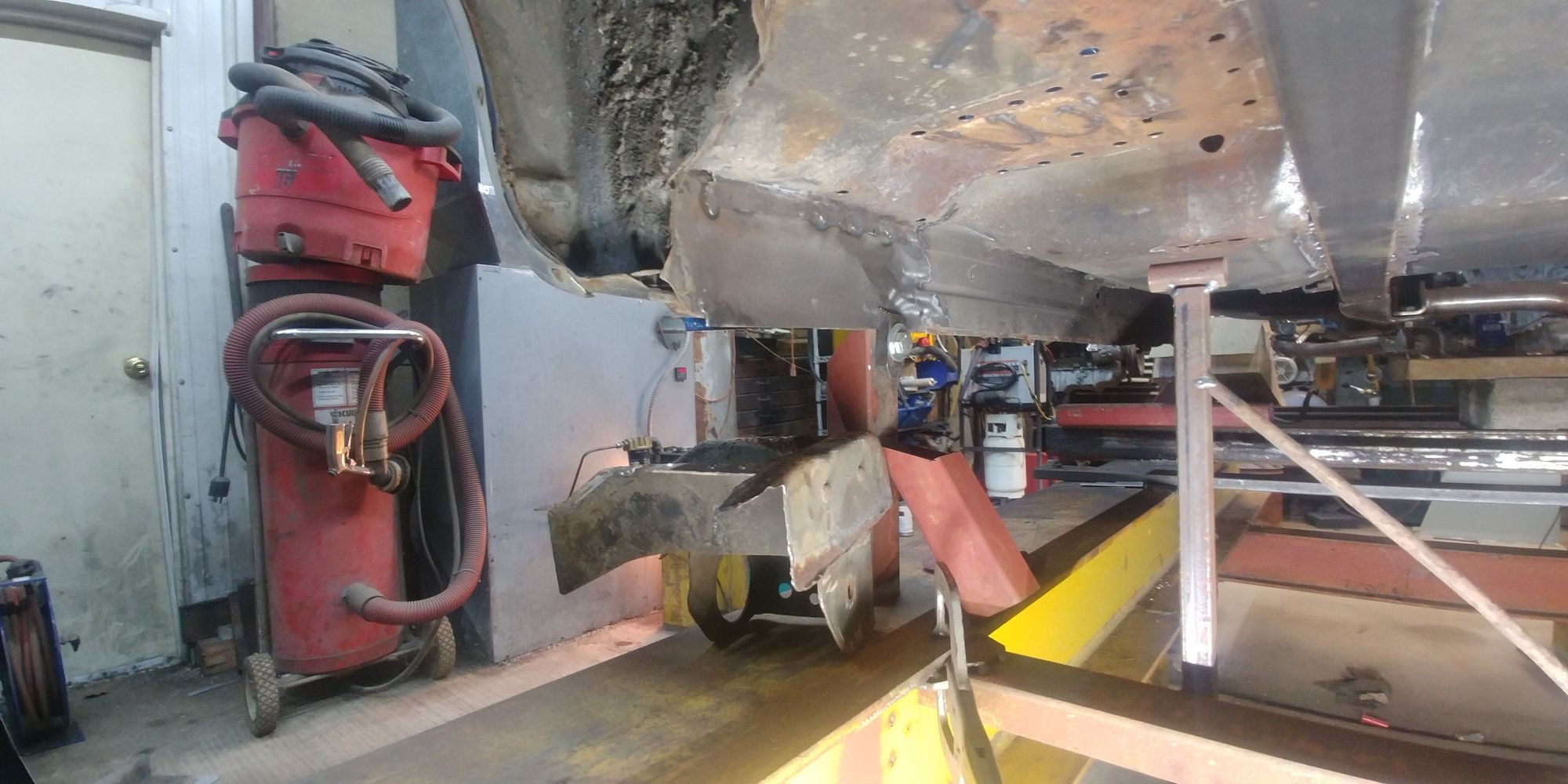

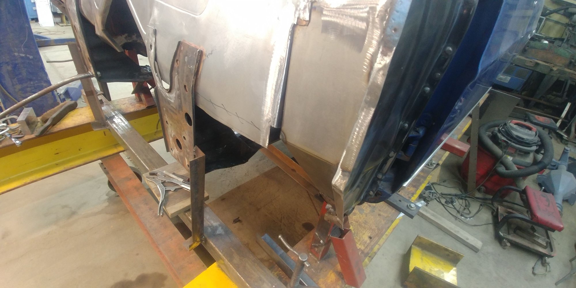

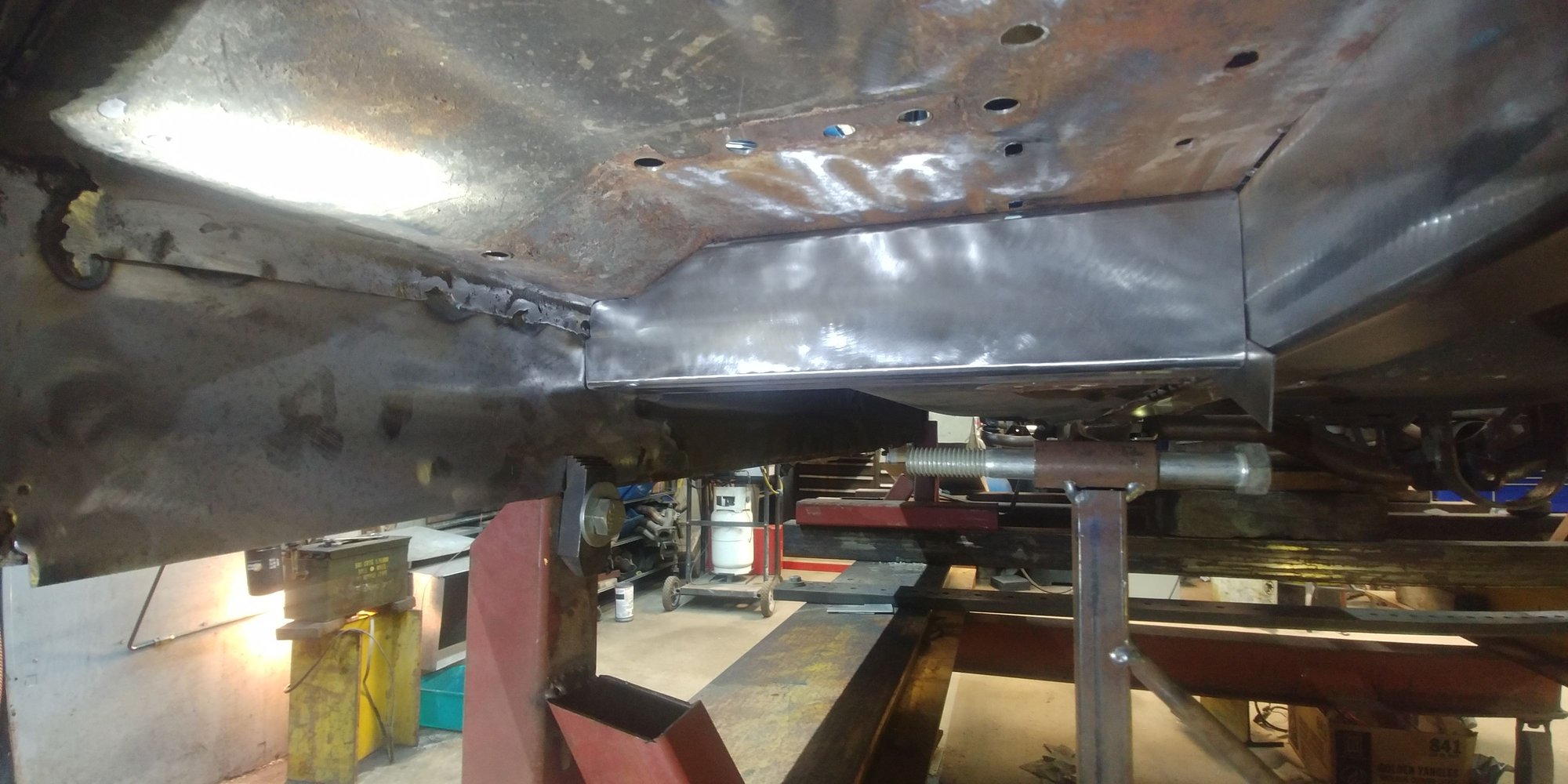

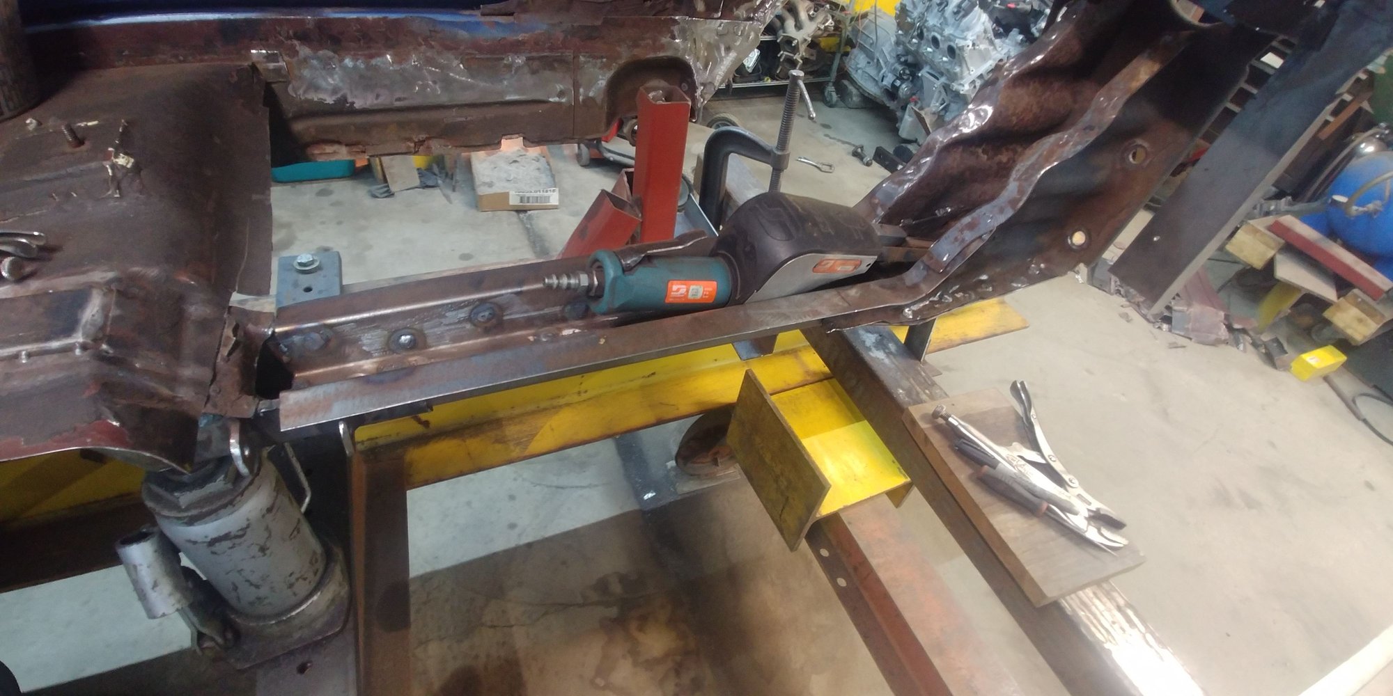

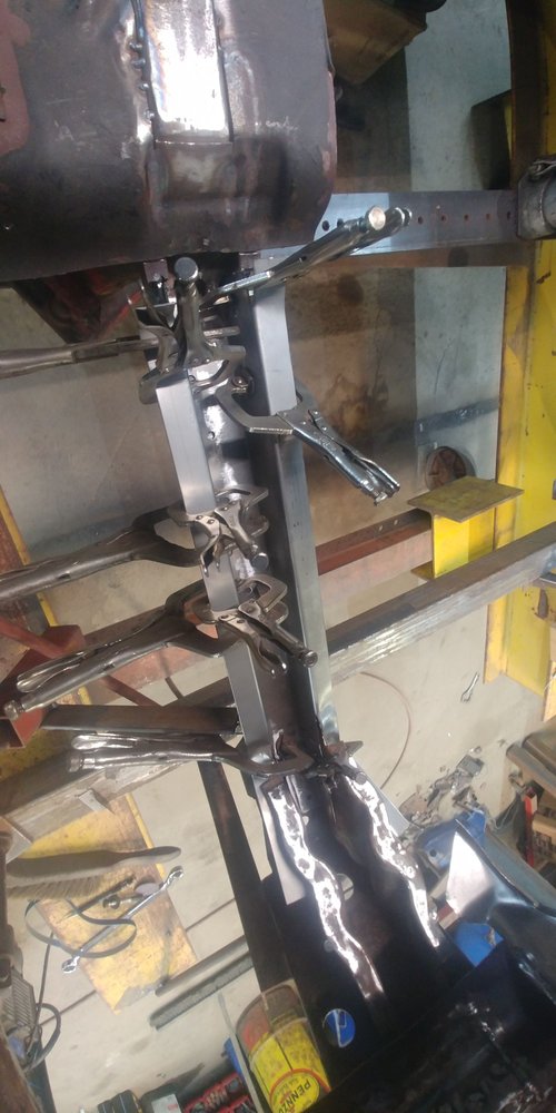

Repairs of the front frame rails.
Old Frame Rails. Look closely and see all the spotwelds that were not holding
Passenger side frame rail.
At least the front of the frame rails are in good shape.Repairing The Frame Rails.
Left side is in. Right side is cut out. New frame piece for right side can be seen in center of first pic sitting on the square tube.
Closer look at repaired drivers side lower frame rail.
Clamping the passenger side frame rail.
The repaired passenger side frame rail.

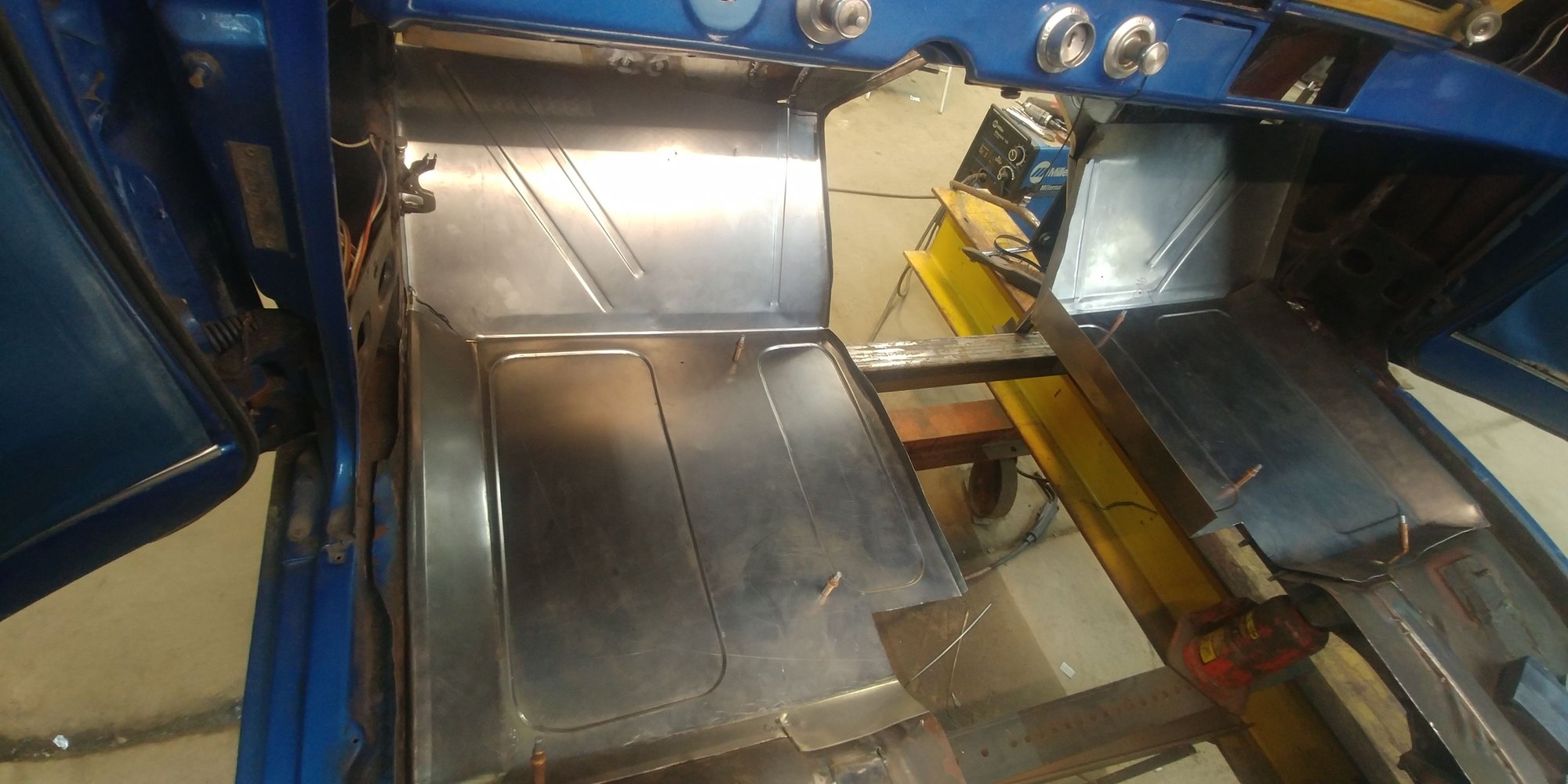

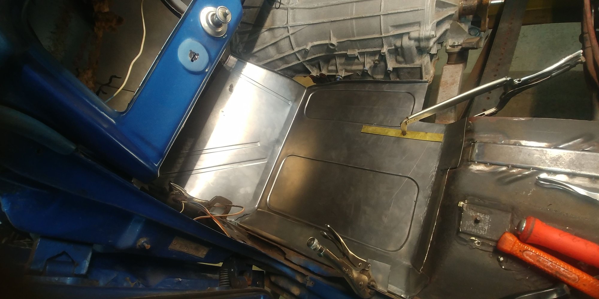

Cabin floor pan fabbing and fitting.
Drivers side floor pan.
Both pans fabbed.
A place for the footsies!
