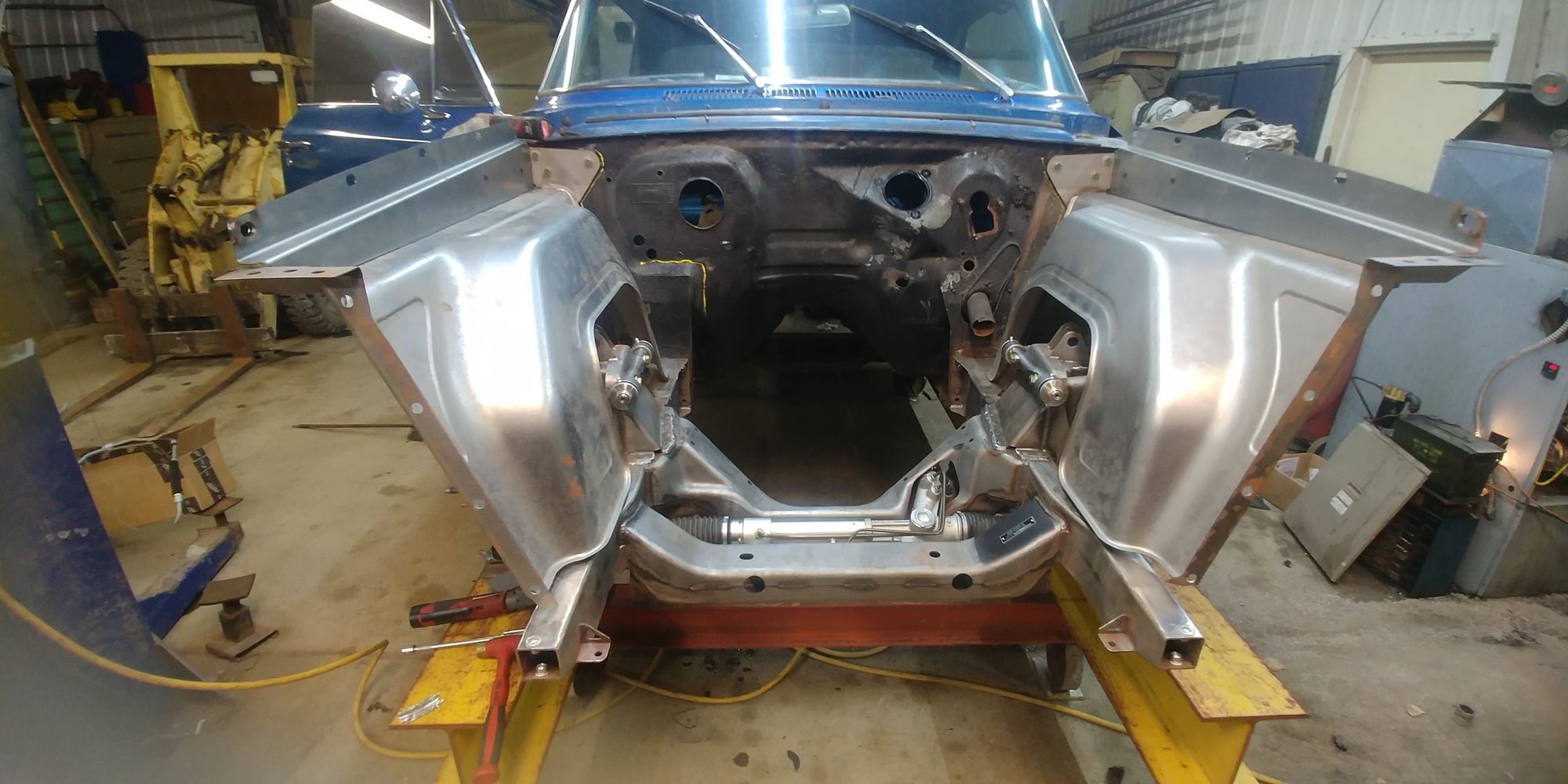

Guttin n' skinnin!

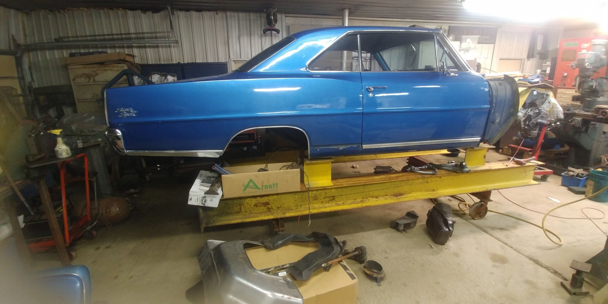

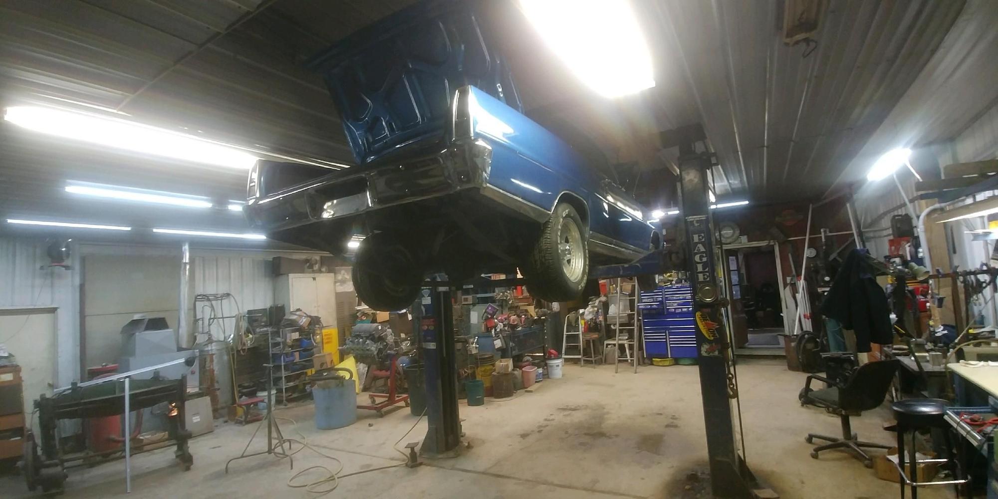

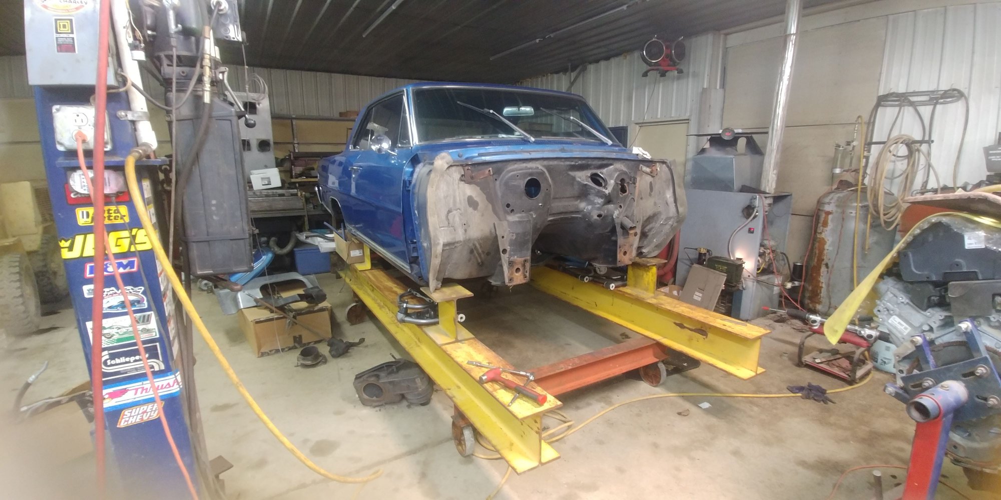

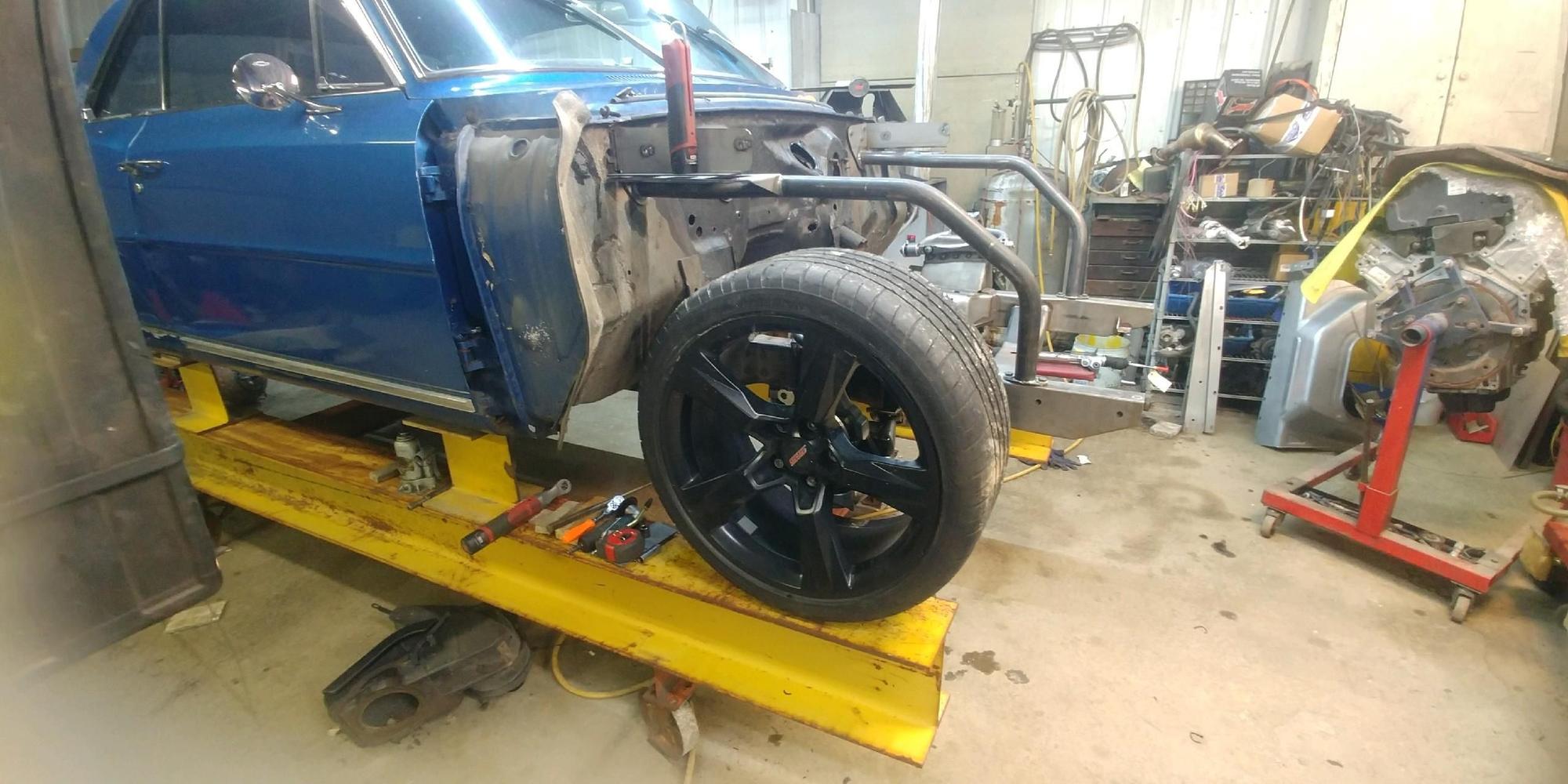

Squared up table and chassis.
Peek-a-boo!
Opened up some boxes Santa Claus brought by!
DSE stuff sure is pretty!
Little more side boob!
Boo Hoo, Camaro wheels don't fit!
The Cut, Hold onto your *******!
Heart of the beast!
Sittin and fitten!
Heavy Metal!

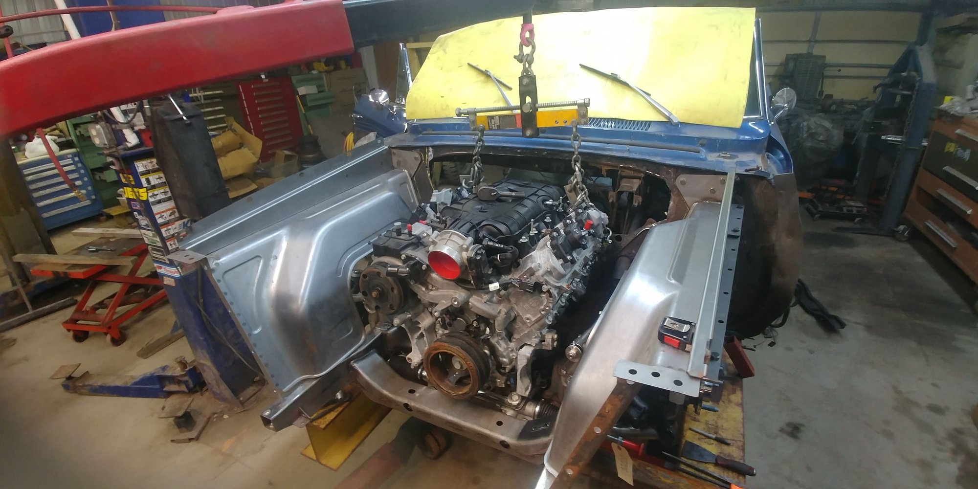

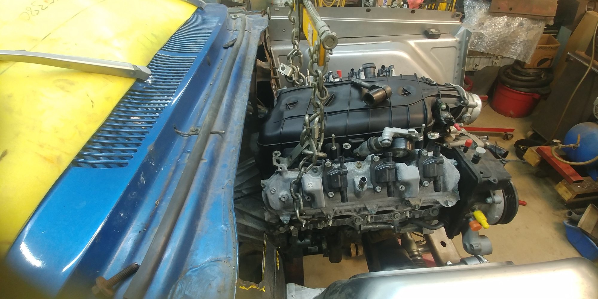

Proportioned 2018 Lt1!
Whew Dat's a Tranny!
How low can you go?

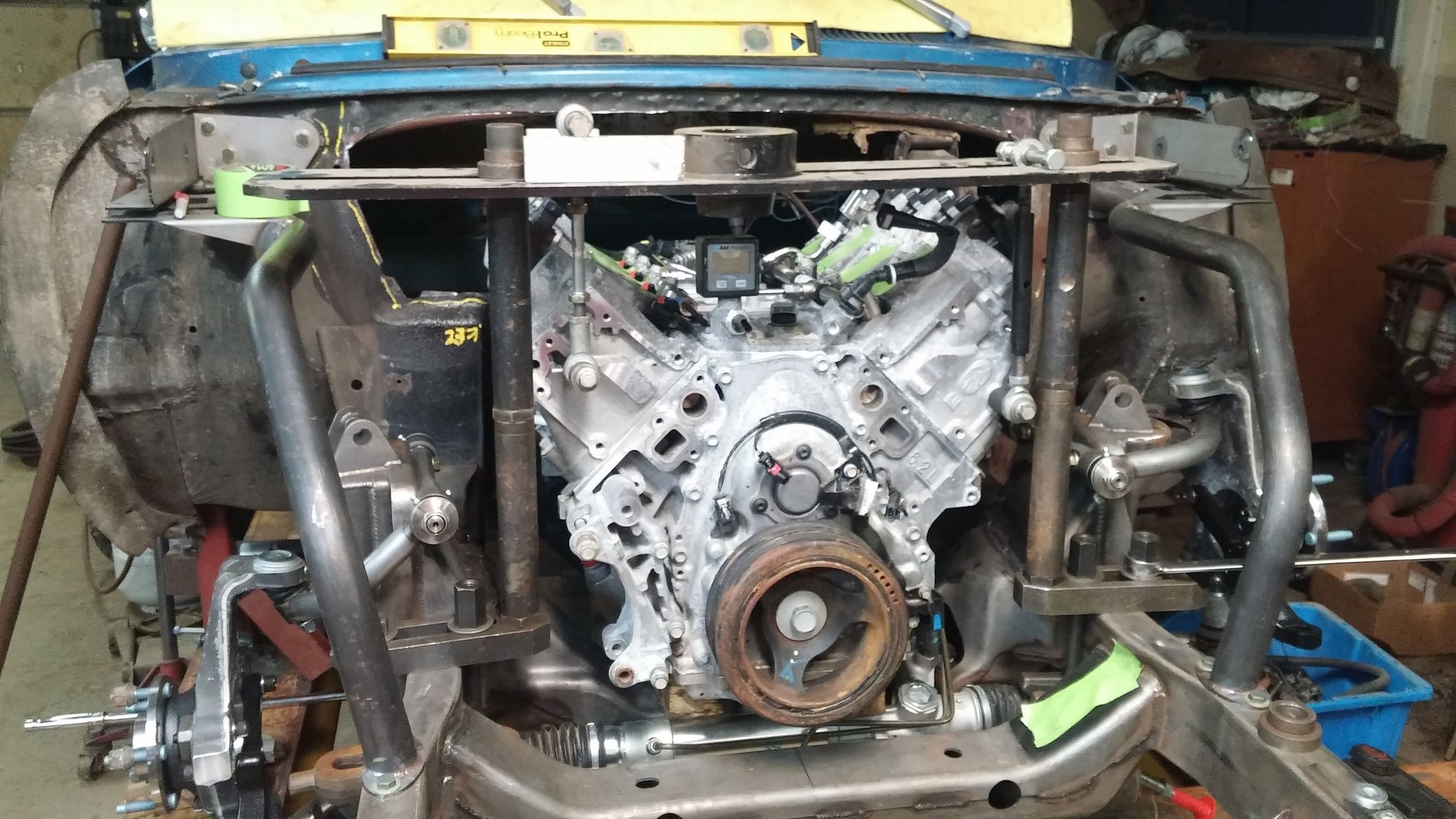

Squared and trammed!
Little box on top of engine is dead nuts on square!

i wanted to buy Mikes' Bada$$ 1966 Nova SS but he didn't want to sell so we looked ans I almost bought a real Turd ans then by absolute Lightning strike luck He found this tasty little Morsel! And I got it for half the price!!

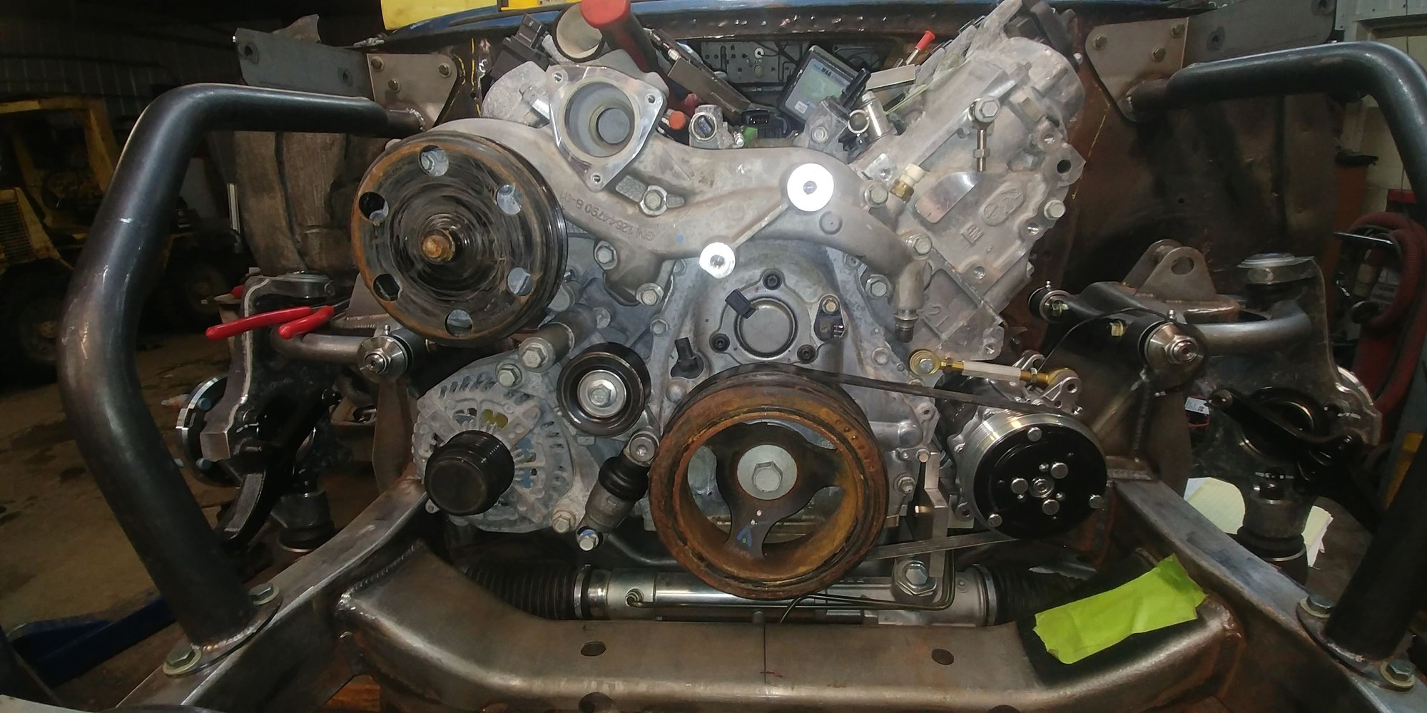

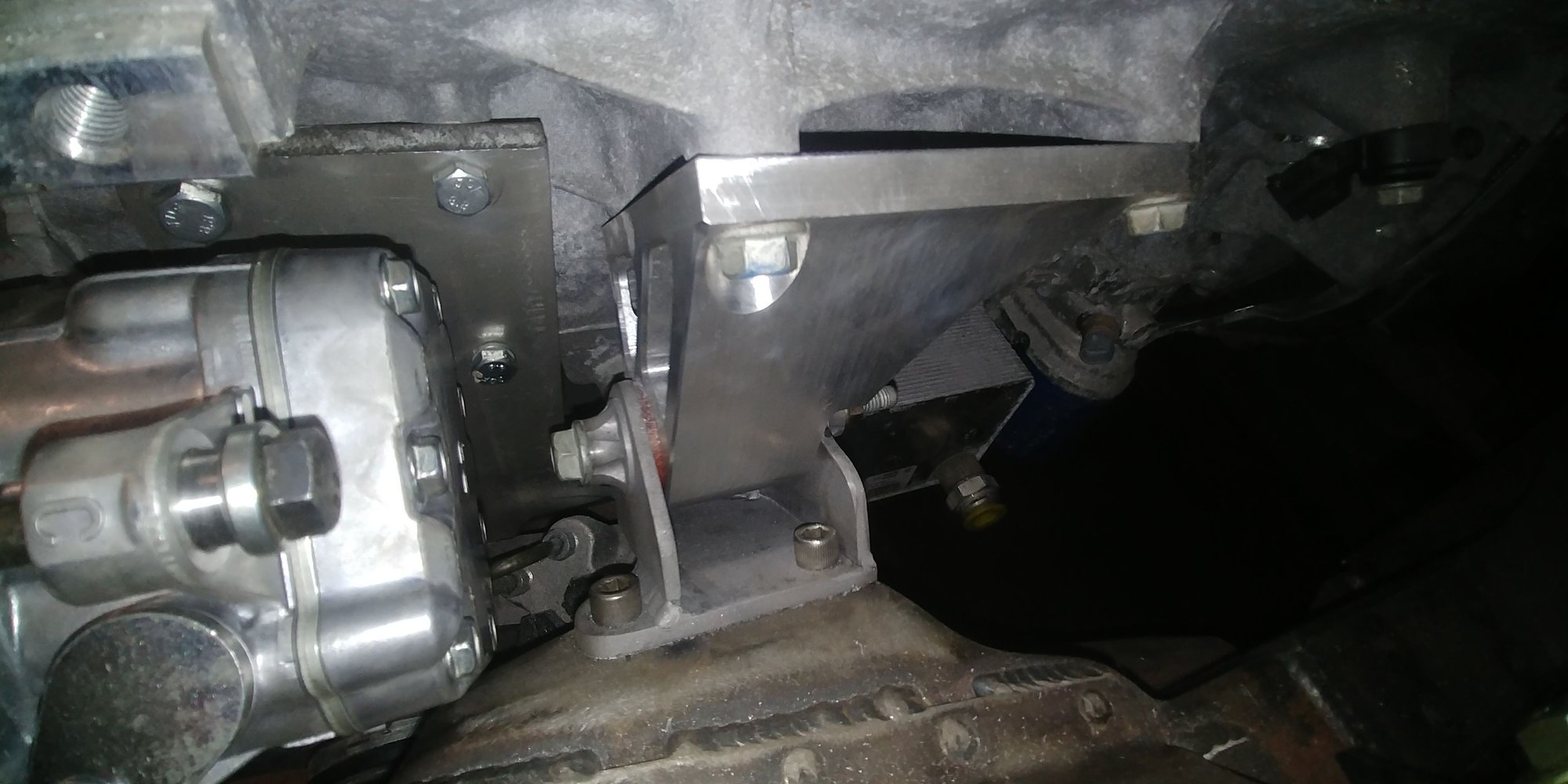

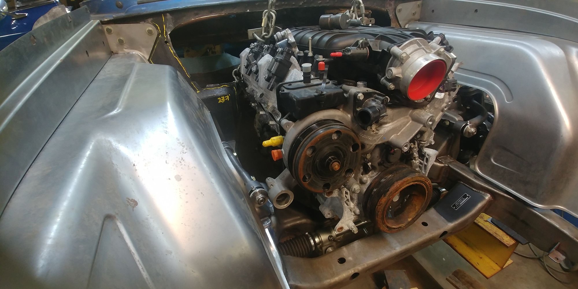

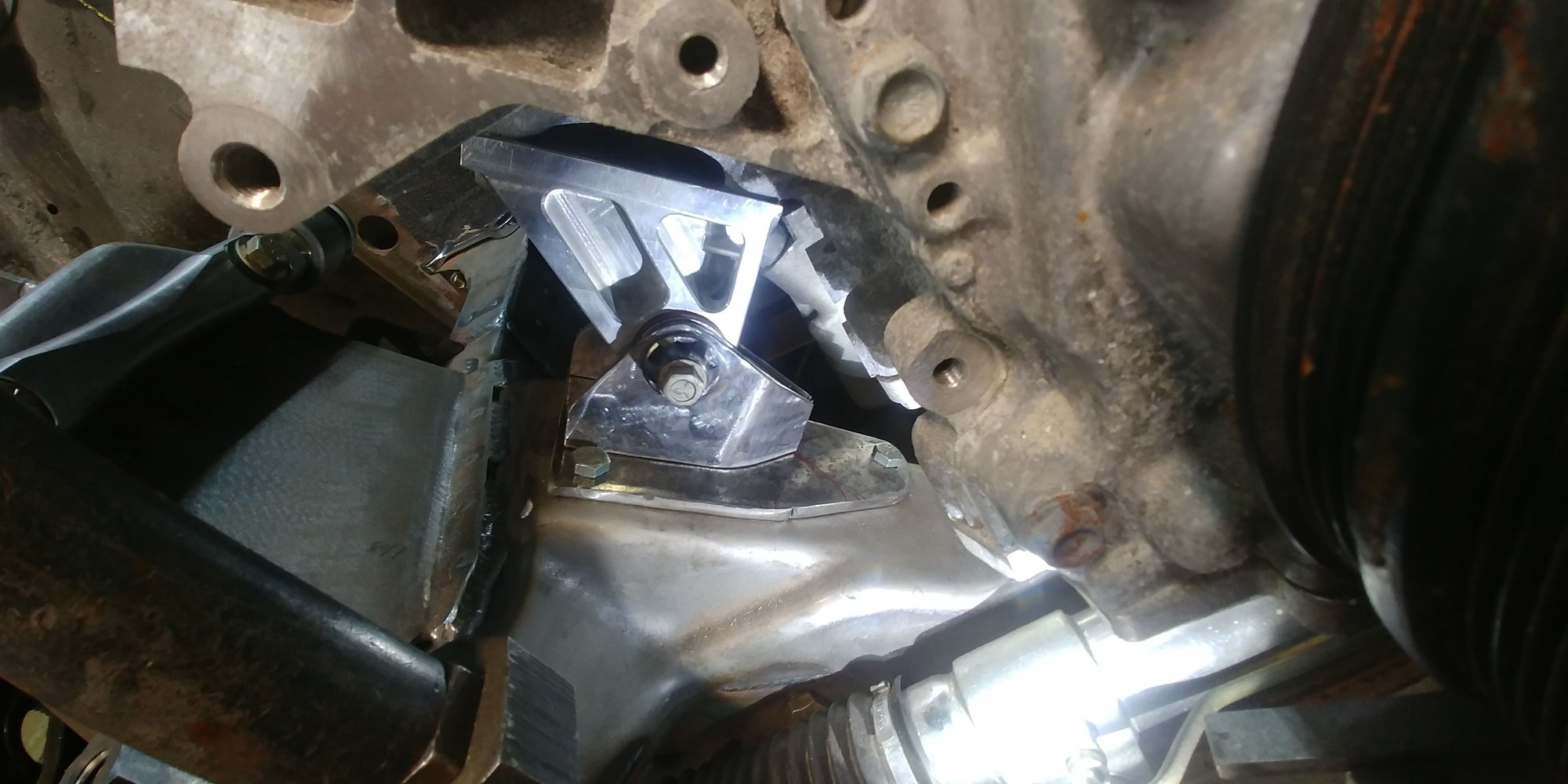

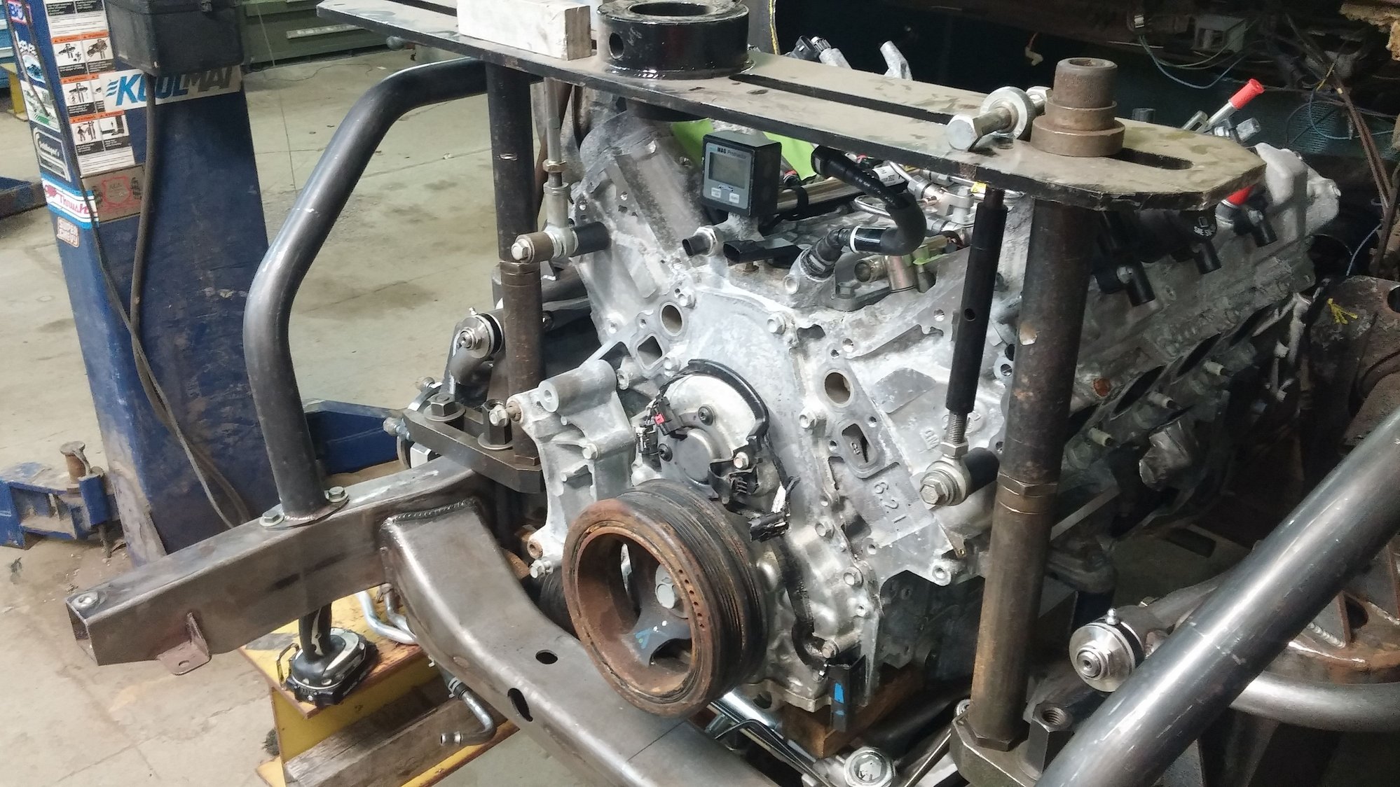

Starboard side bolted in place for a look-see
Top View:
Altitude of engine and tranny in relation to ride height and DSE front cross member:
Mike will machine port side mount this week.

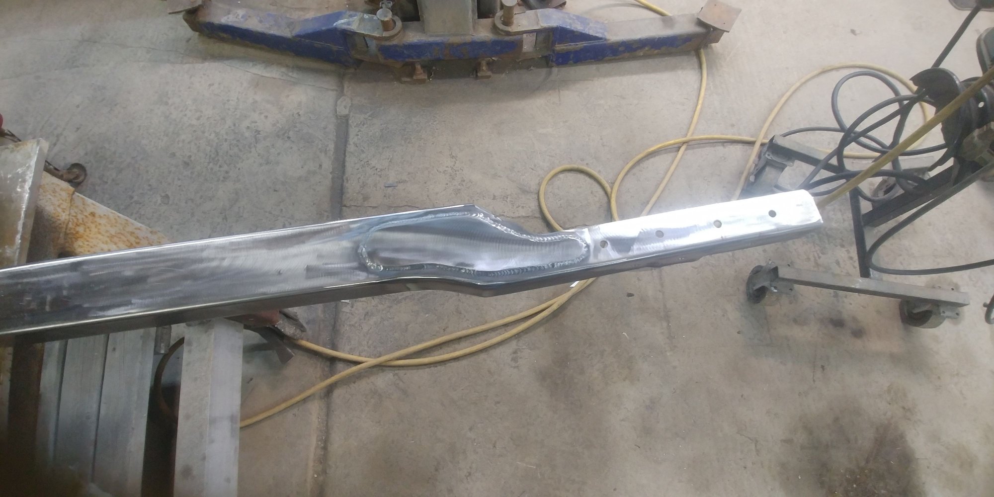

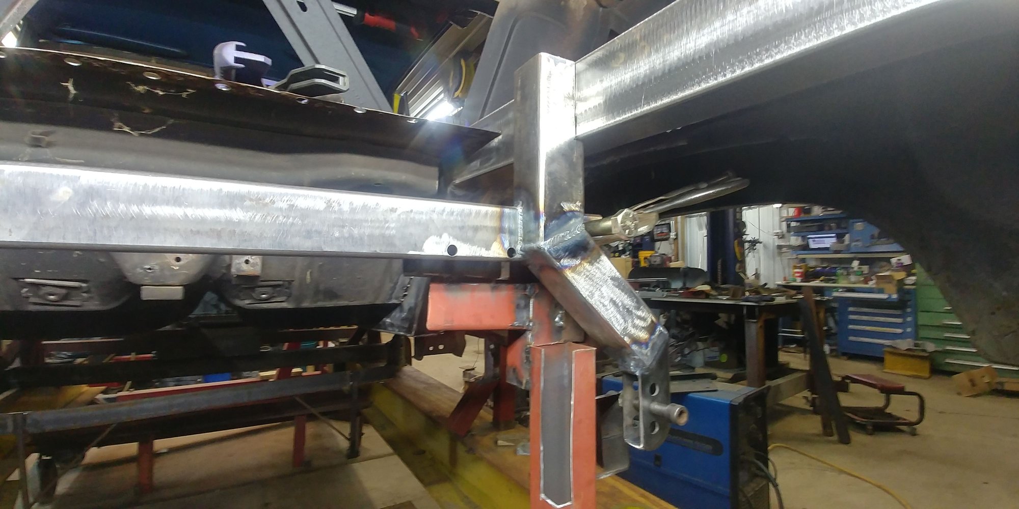

Mike put a few hours in on the port side engine mount Monday and Tuesday. Pictures to come soon.

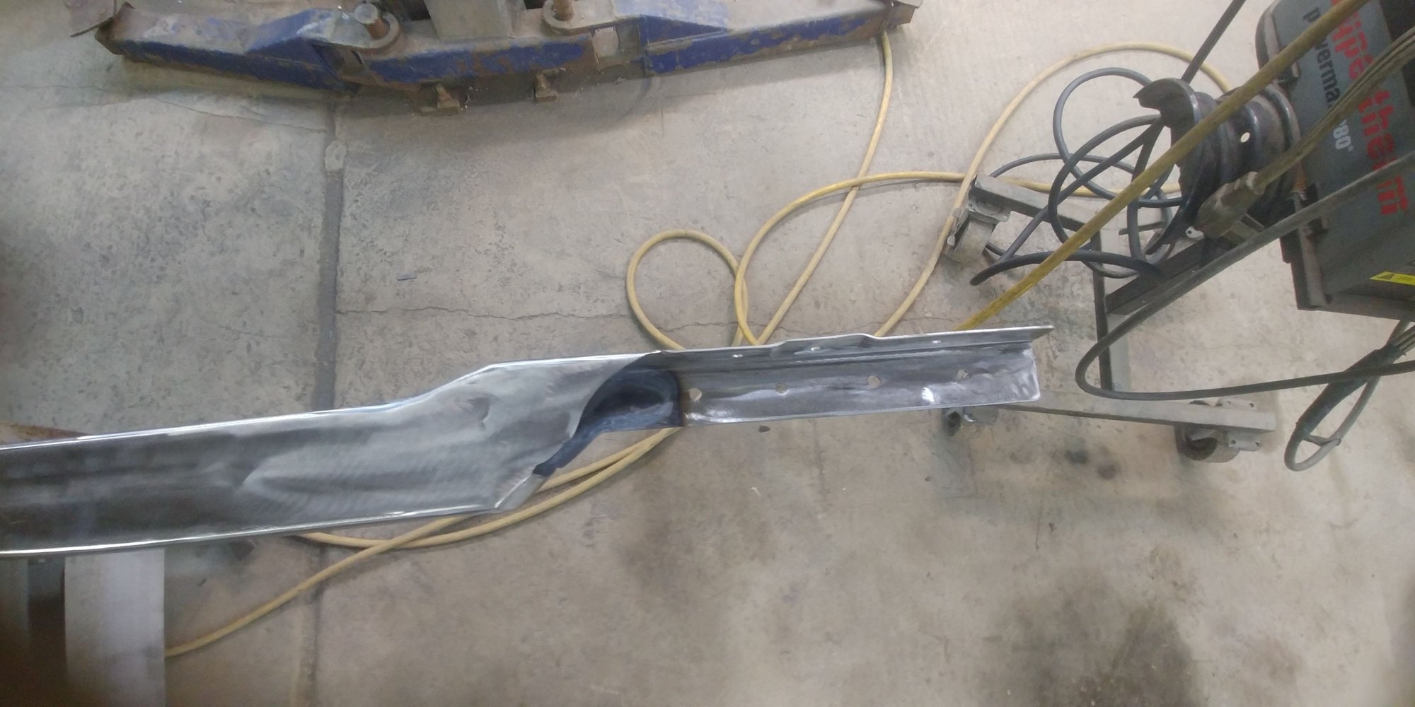

Progress on the frame rails Monday and Tuesday.
The frame rails get tied into the front stub mounts, perimeter welded and rail heads that extend into the stubs get plug welded.
The rails at the rear extend straight to the rear frame member and near the end pickle fork of to the remnants of the factory bumper mount-frame rail.
These rails should really stiffen up the chassis.
Goal is to have cross member in with tabs for coil overs and panhard bar in by end of week.
The finished , fitted frame rail. Mike has exact duplicate rail on bench just to the left to be finished and welded.
The front fitment of the frame rail.
Fitting the rear of the rail and tacking it.

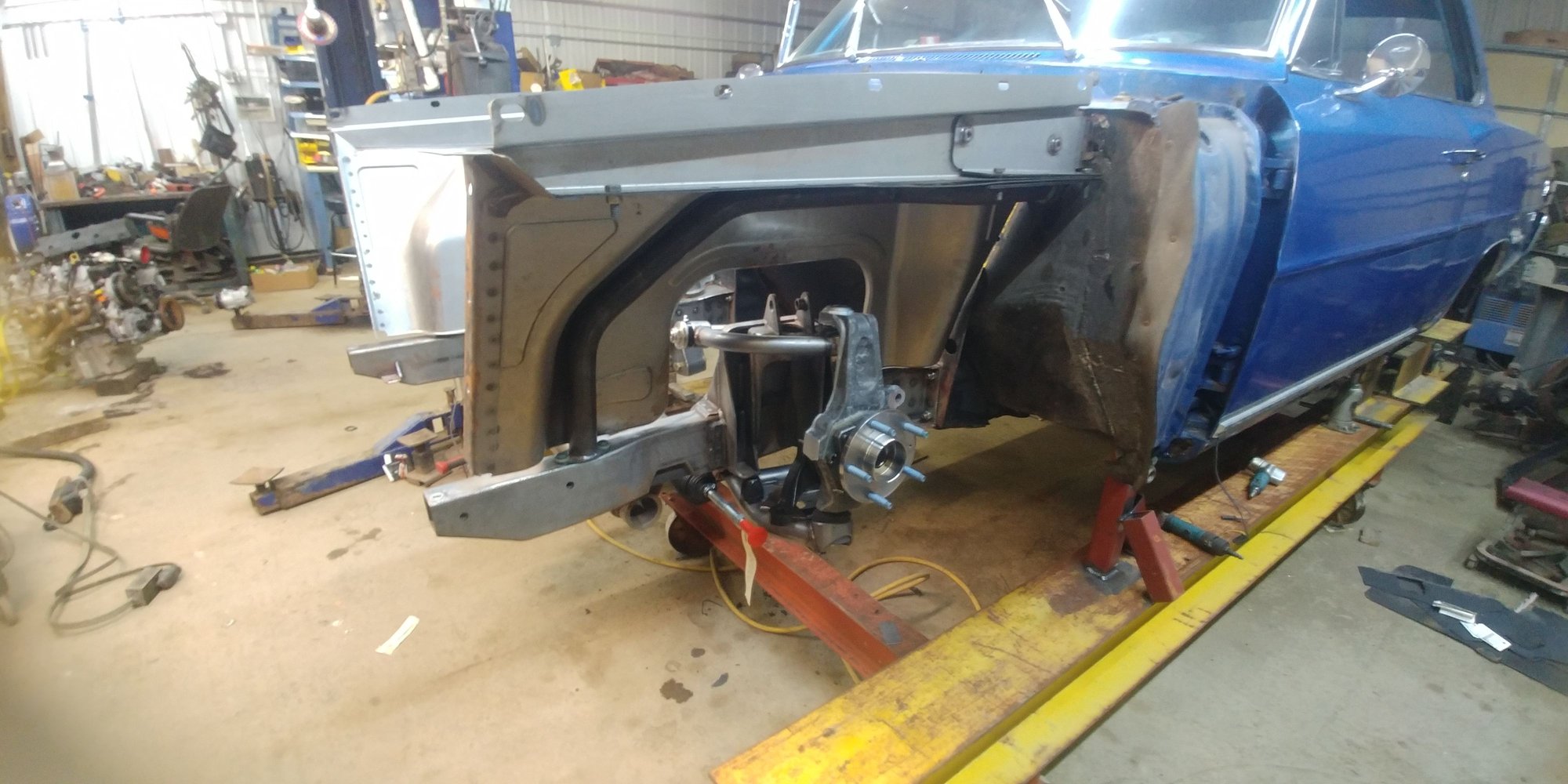

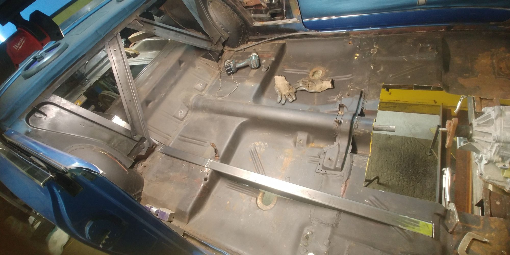

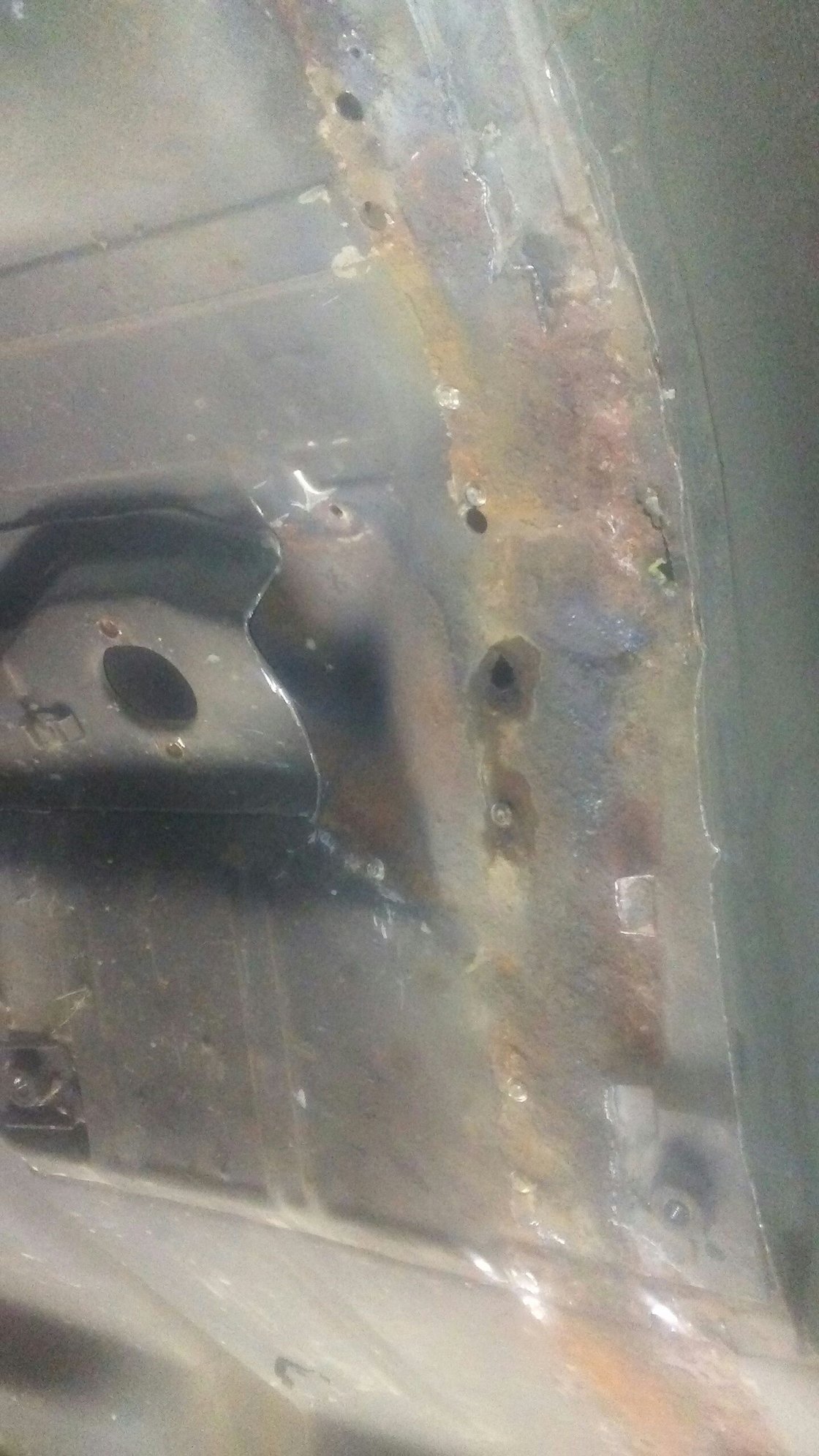

Default Floor Metal we are working with.
Metal under factory frame rails that have been removed.
Clean metal in the cabin.

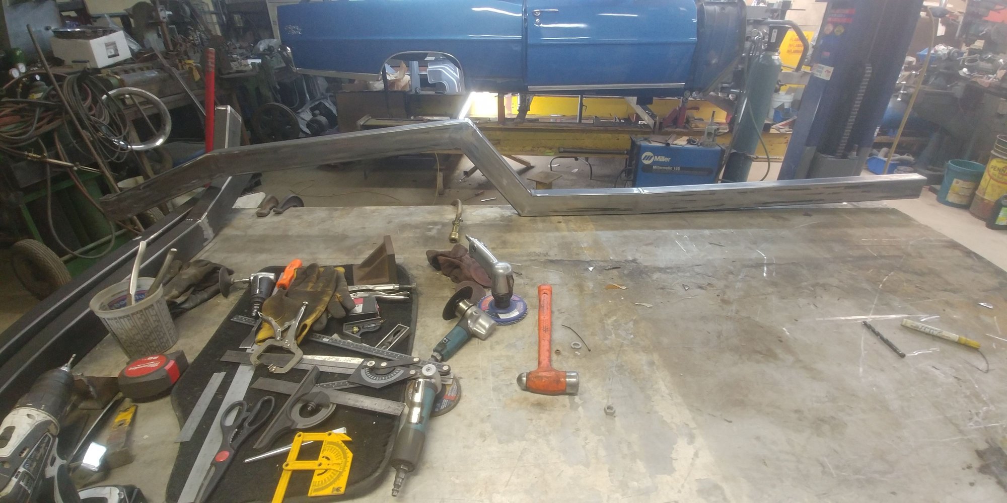

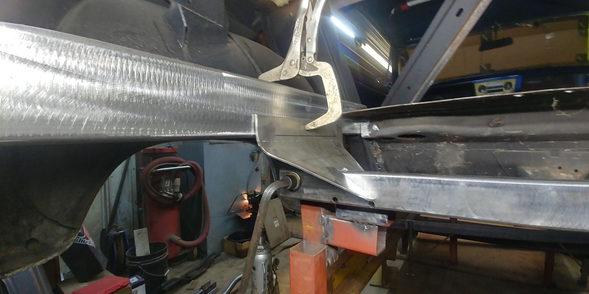

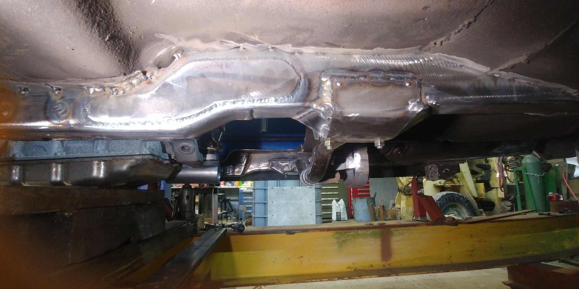

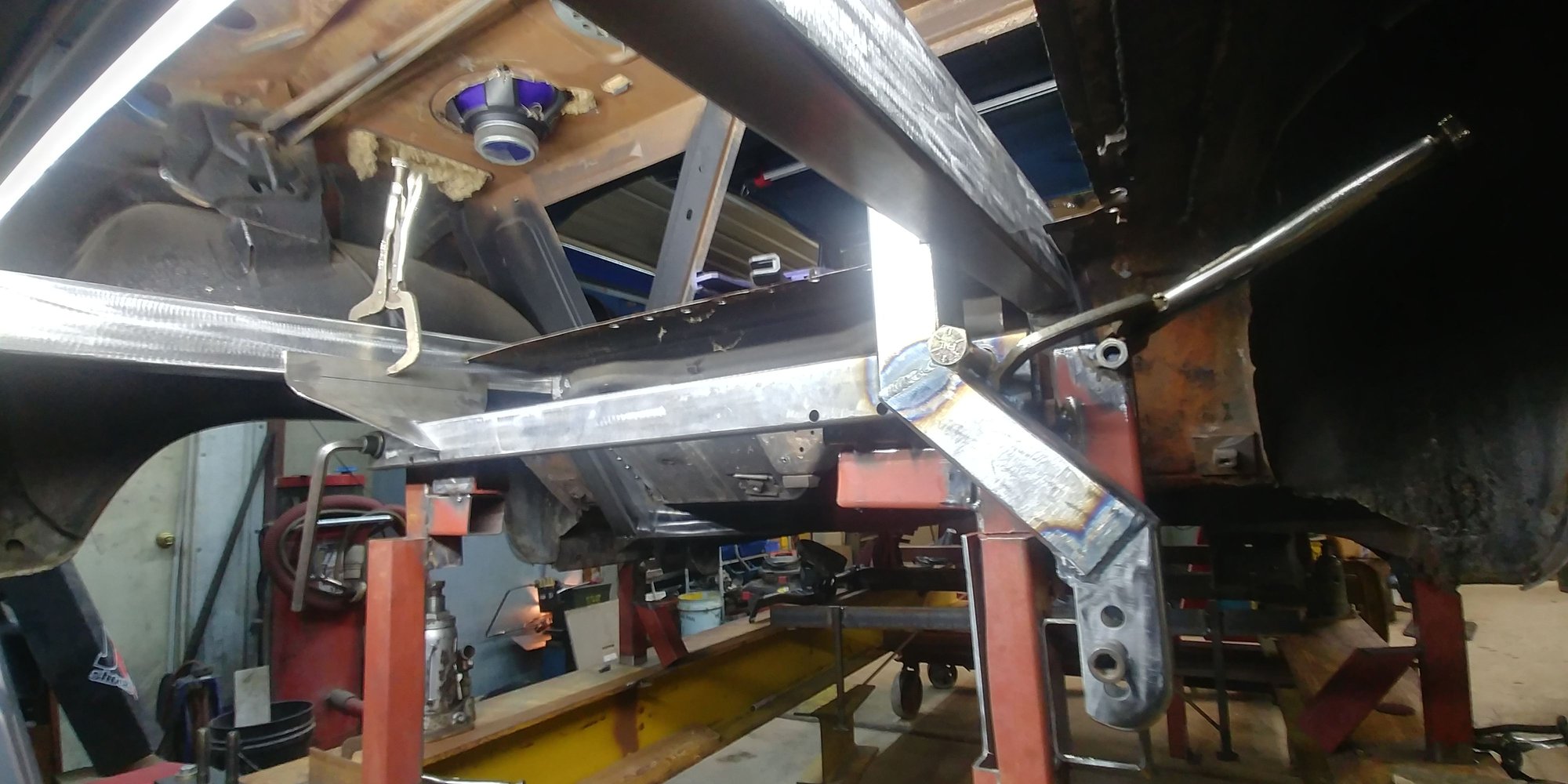

Default Creating Rear Frame Rails
Mike and I decided to create frame rails that tie into the front stub struts to continue to the rear of the car.
Creating and fitting and fabricating the frame rail.
Creating and fabbing and tacking the rear of the frame rail.
The altitude of the bottom of the frame rail will be higher than the factory front stub strut. The flange for plug and perimeter welding the frame rail to the strut.
the area where the front stub strut will nest.
One rail done and the start of the next one.

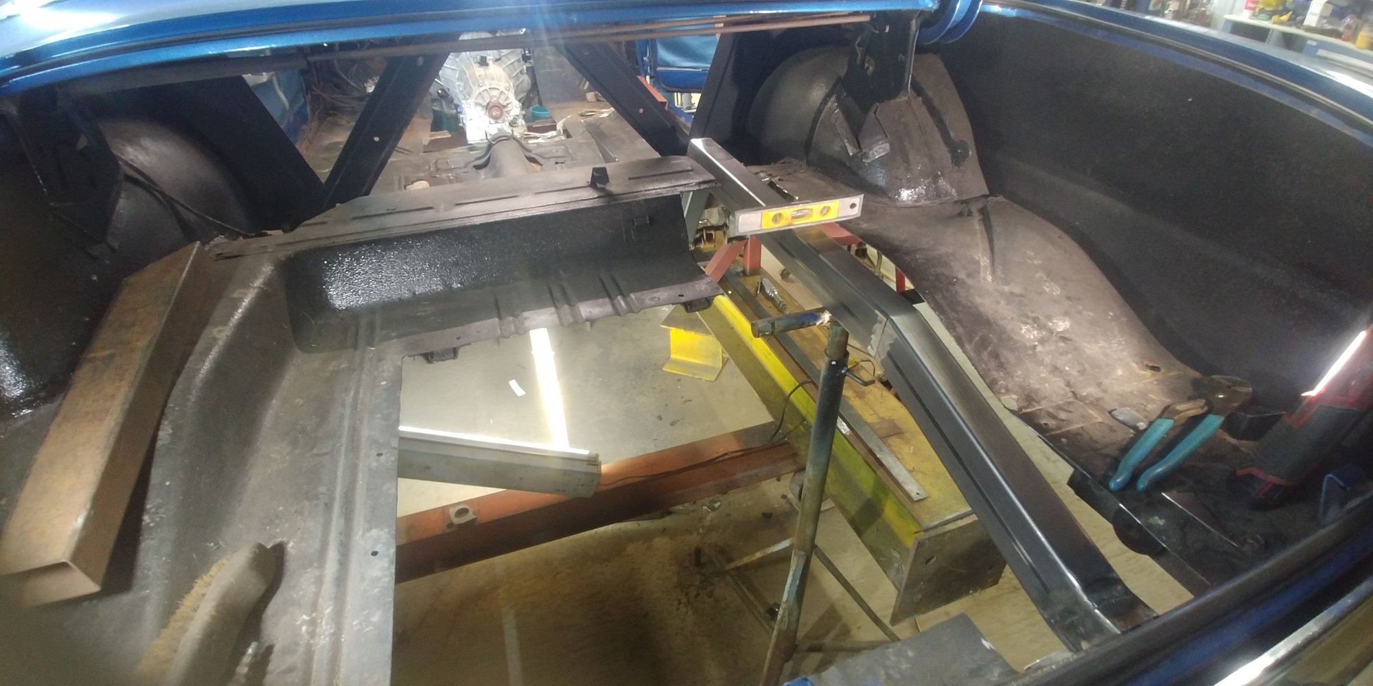

Default Welded Up Rear Cross Member
Starboard side of cross member and Panhard mount
Port side of rear cross member and factory supplied piece leaning against tank

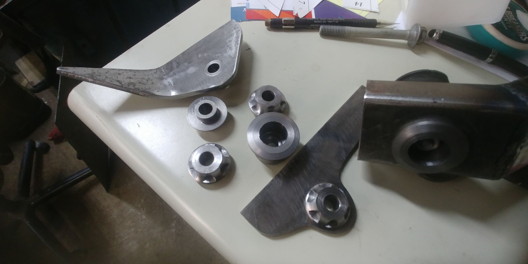

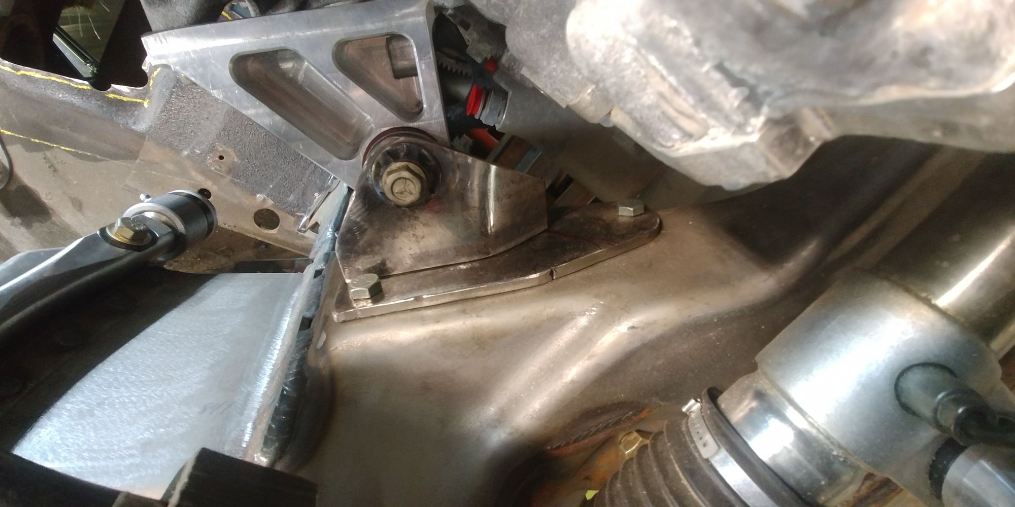

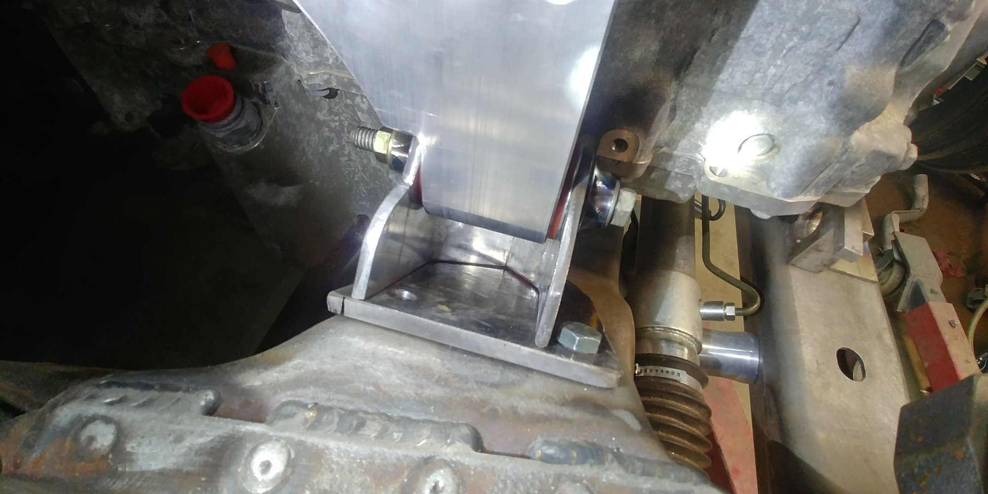

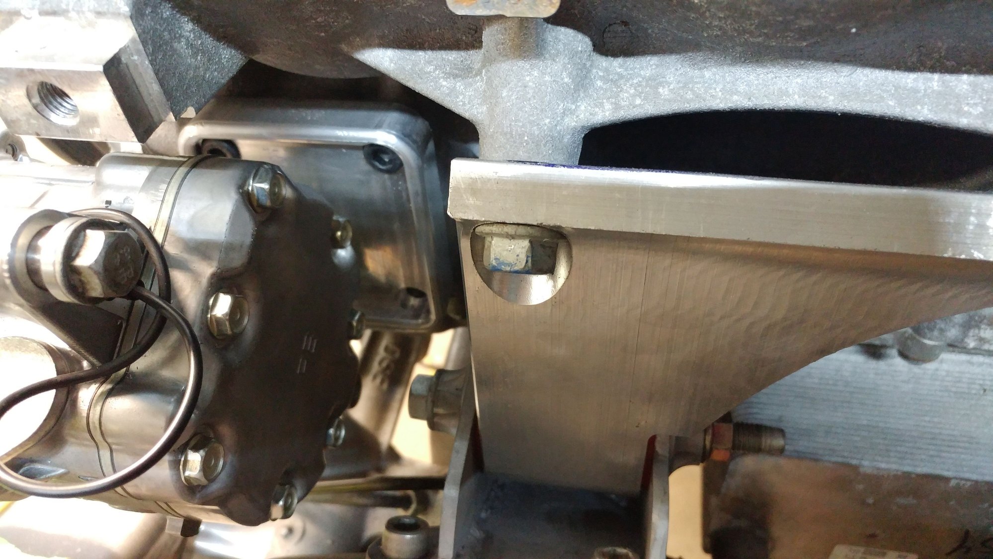

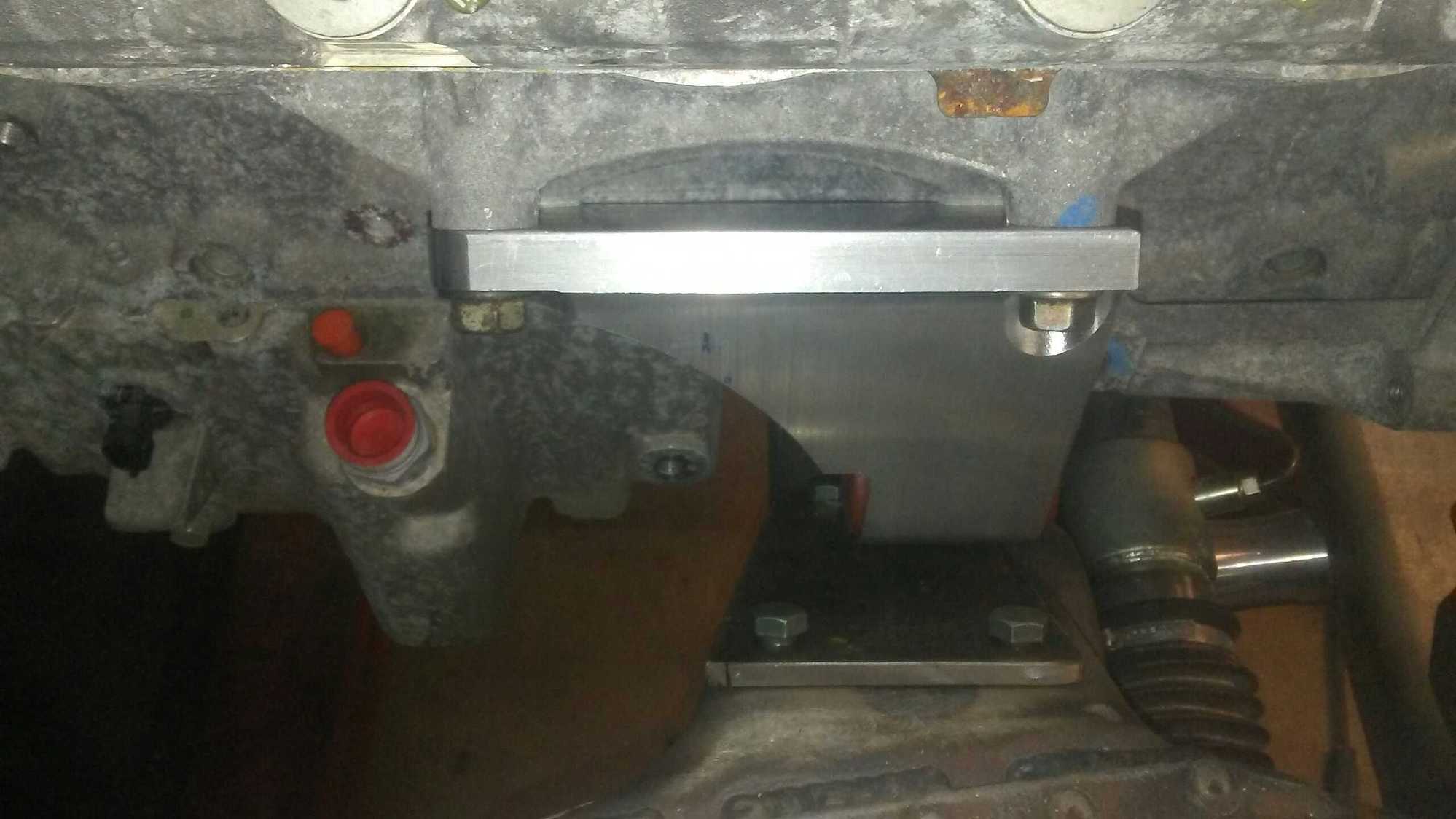

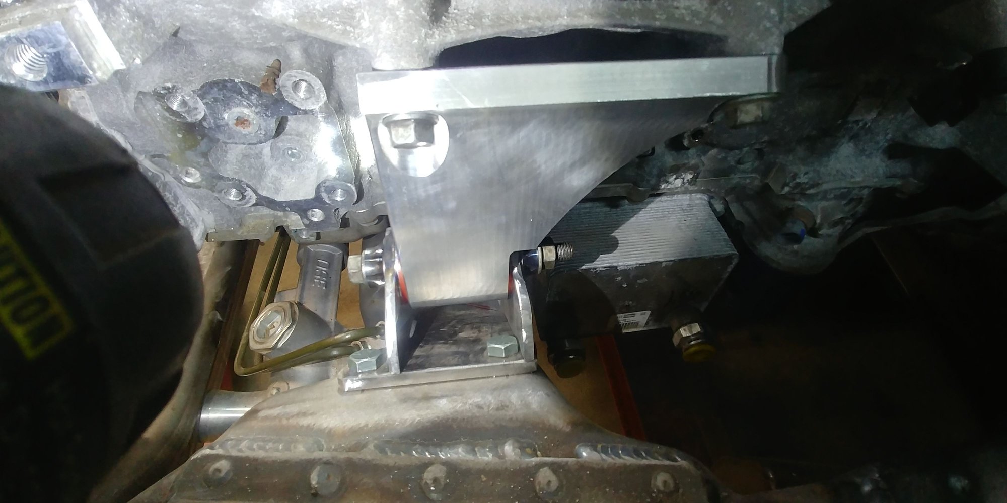

Default Motor Mounts Ready For Assembly And Tig Welding

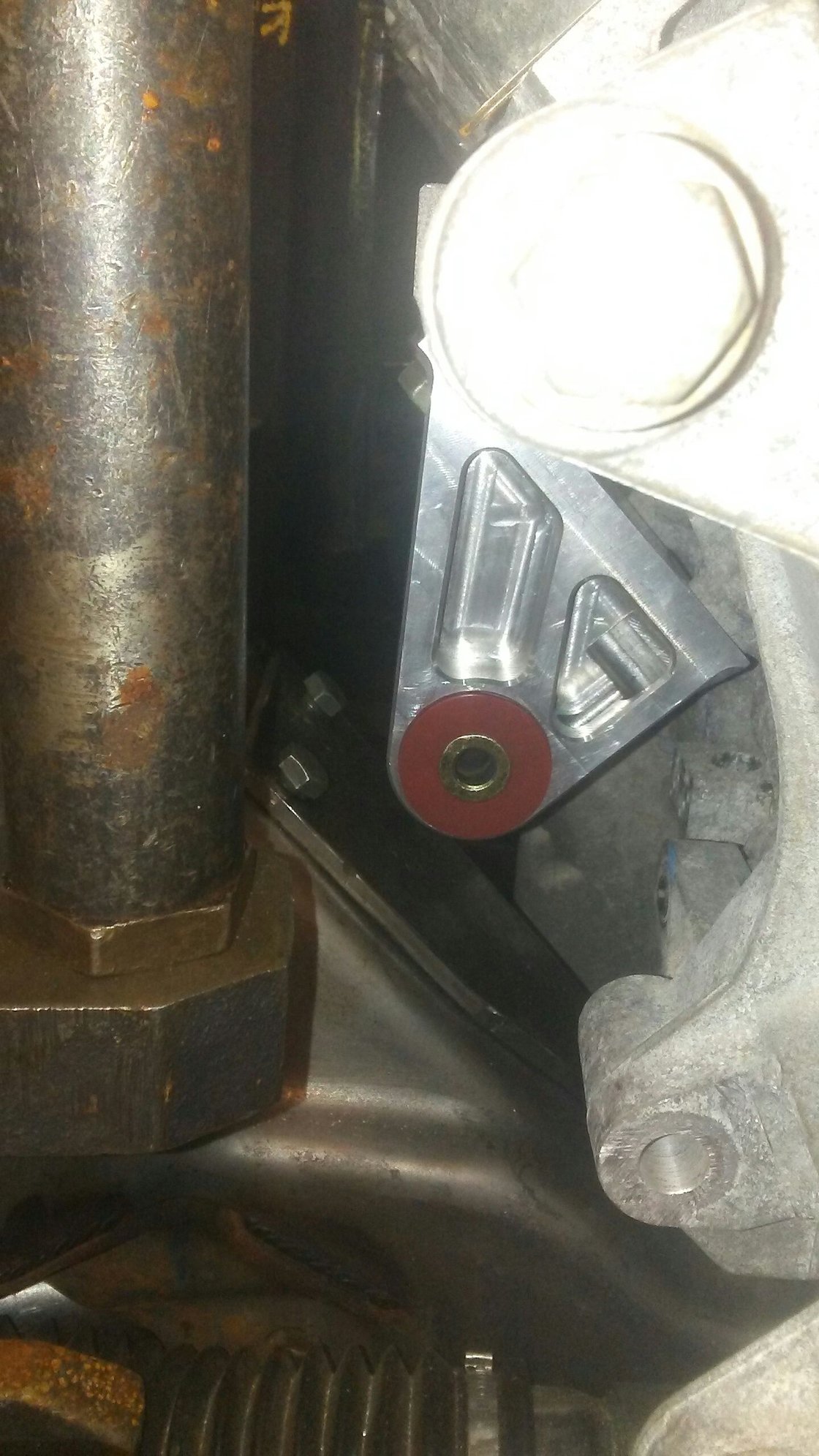

Bushings and brackets for the motor mount bases
Top View passenger side
Front view passenger side
Top view drivers side
Note the bushing bling
Going to finalize engine location and then tac weld the bases

Default Welded Motor Mountd and Accesory Drive Mock Up
The welded motor mount doing what it does best and mocking up the AC compressor bracket
Mocking up and creating the AC compressor bracket for a "hold-in-your-hand" model for measuring for whittlin out of billet. Also thinkulating on the power steering pump and reservoir.

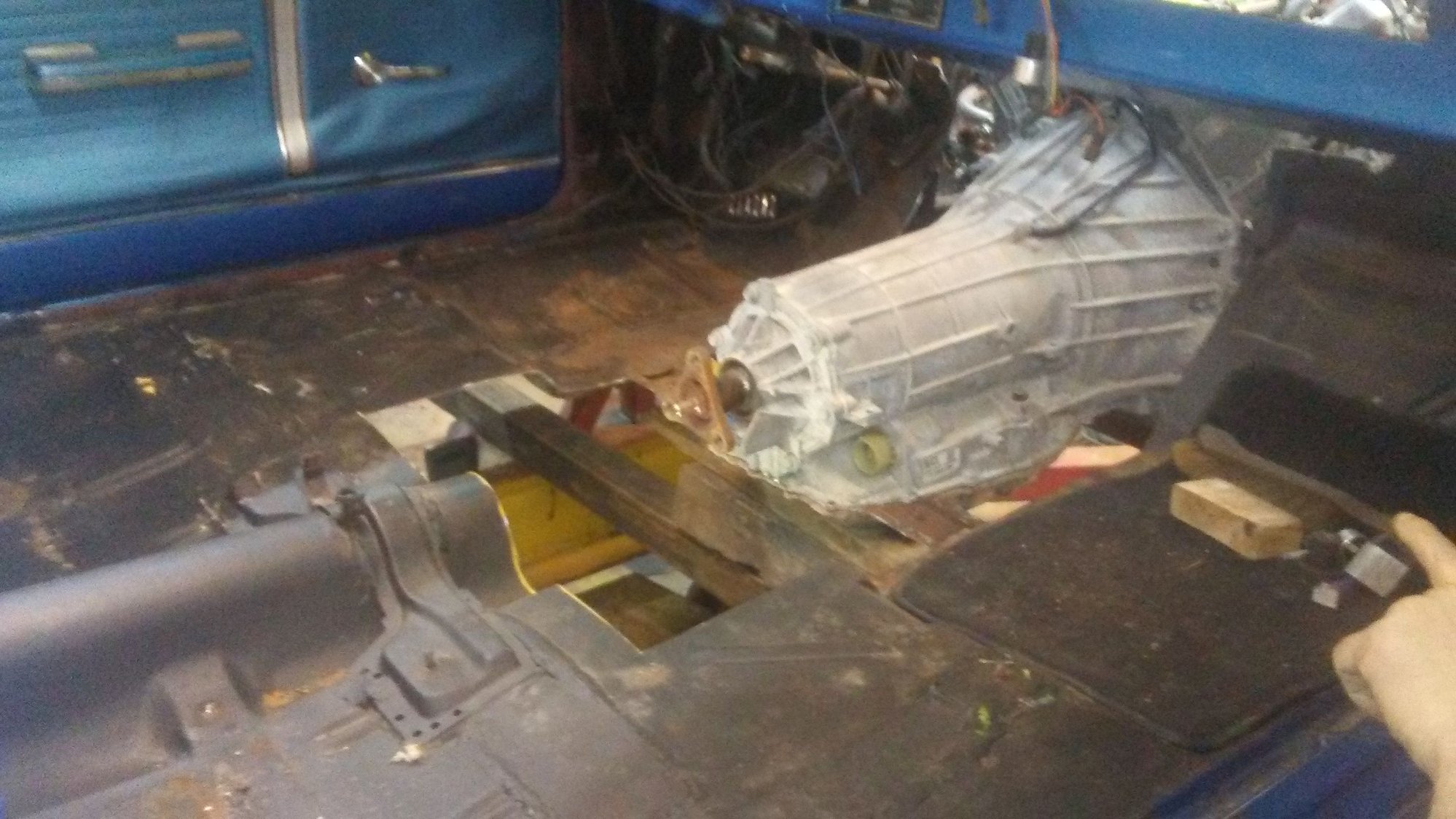

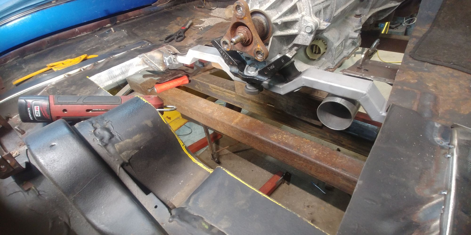

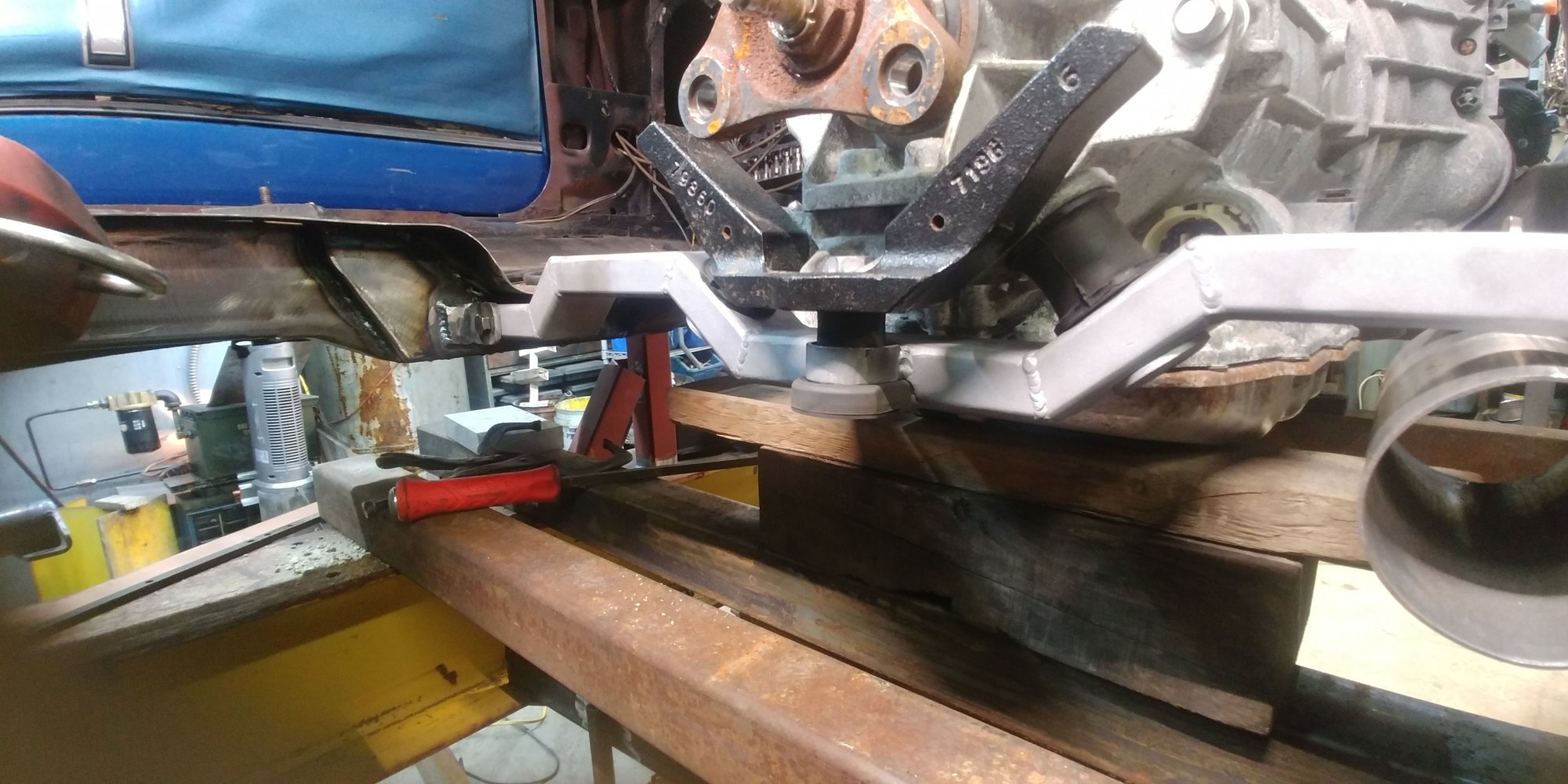

Default Transmission Crossmember Completed and Installed
The transmission cross member and brackets fabricated, welded and installed.

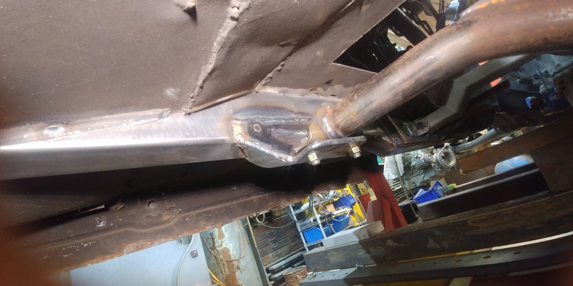

Transmission cross member welded and related brackets fabricated and installed.
Cross member with a mock up exhaust pipe.

66-67 novas are top 5 favorite for me but all the work to fit a decent sized rear tire and front end work moving shock towers steers me away every time. You’re a better man then me! Lol is that trans crossmember welded to the frame? Do you have to remove engine and trans together like that or is there a way to remove trans another way?
Old Feb 2, 2019 | 08:46 AM
HotWheeelz's Avatar
Joined: Jan 2019
Posts: 39
The tabs are welded to the frame rails. If you look closely on the tab you will see a through bolt head. The tranny and engine can be split and removed individually.

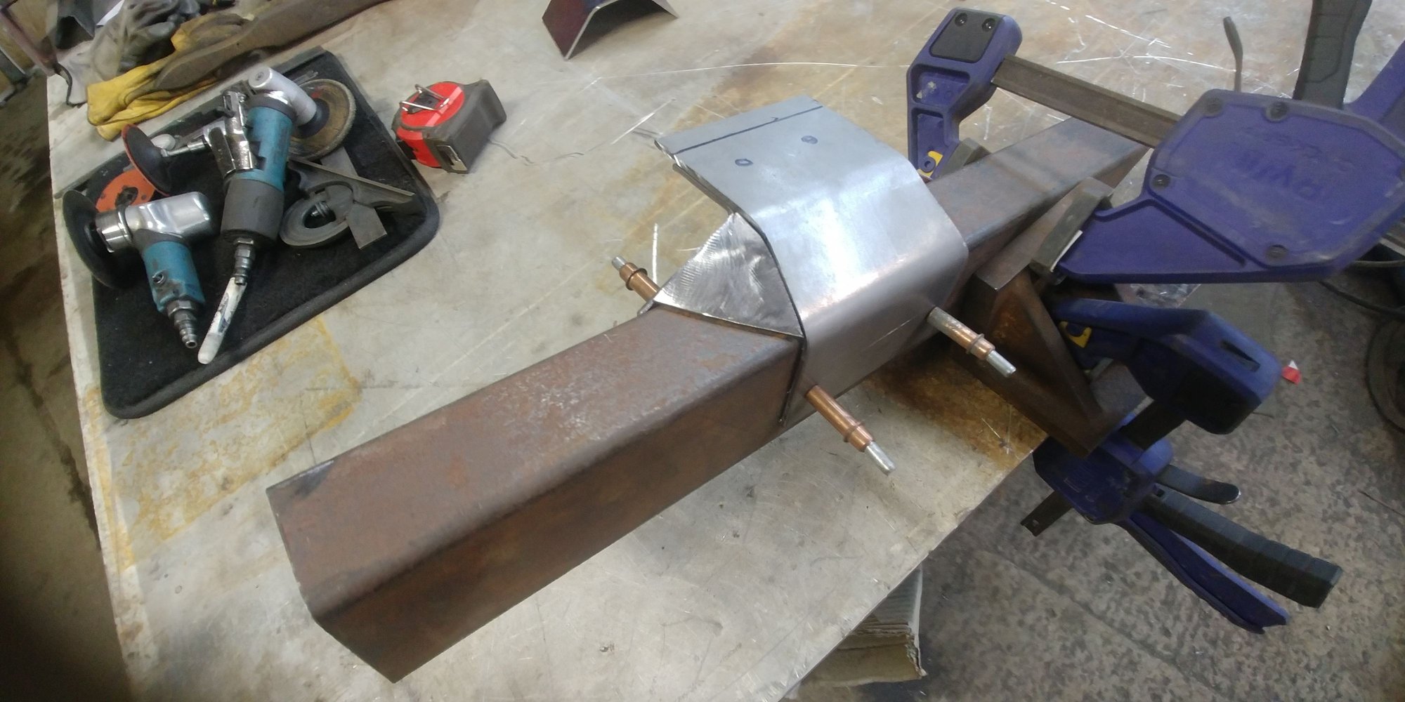

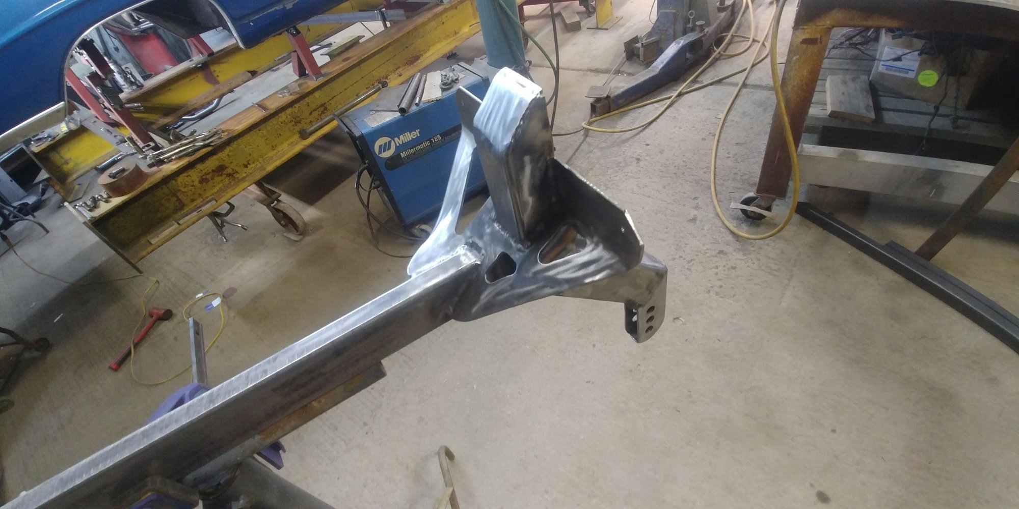

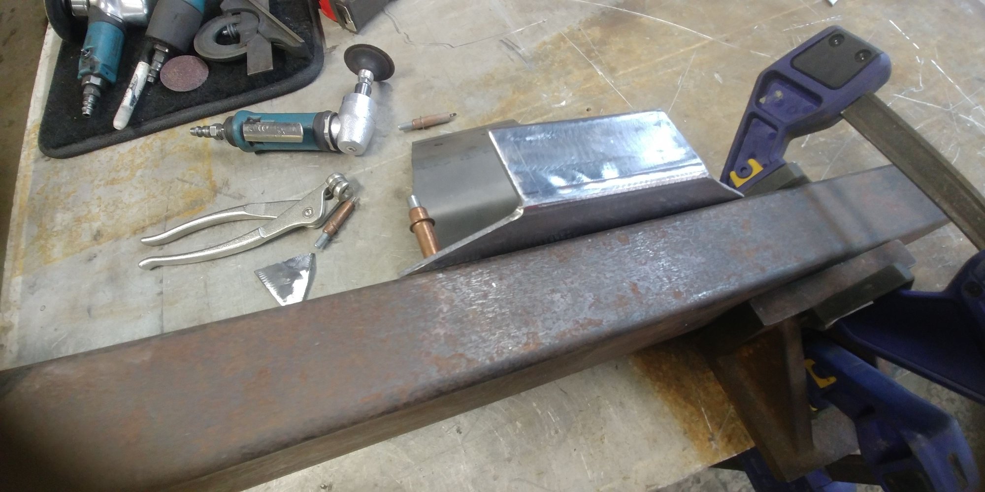

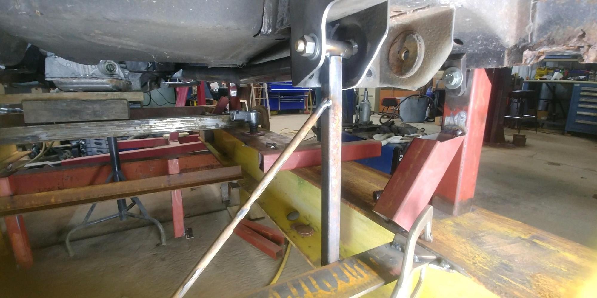

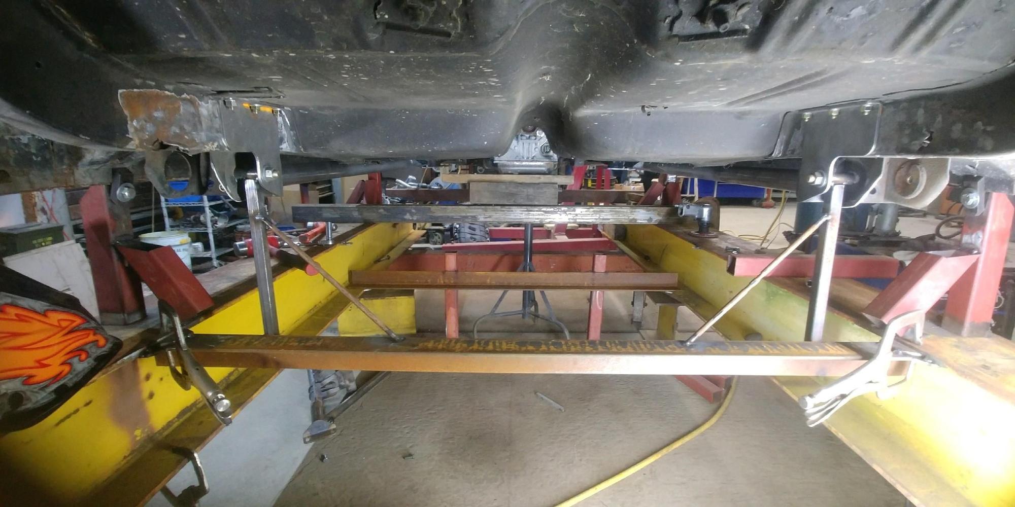

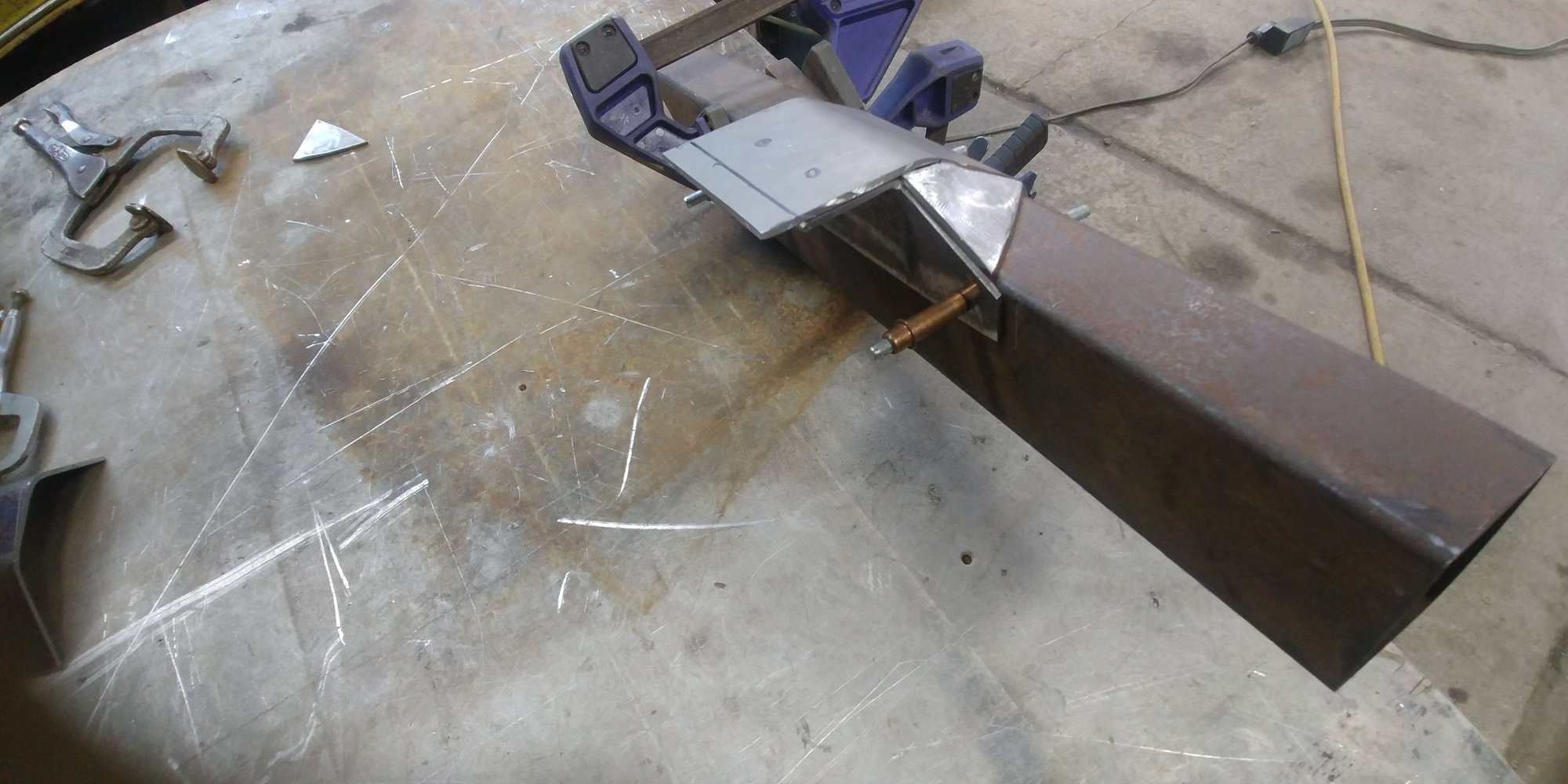

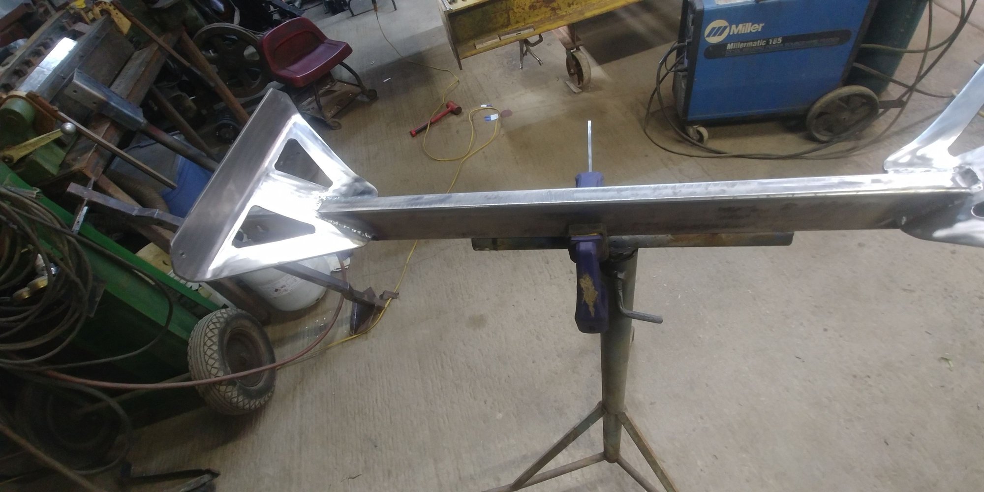

Default Brackets For Torque Arm Crossmember
Mike Said "Here is one side of the torque arm crossmember mounting brackets. I used a piece of tubing on the bench so i didnt have to crawl under the car to do this. They will be welded together here then slipped on the frame rail and welded in place where the jig is at under the car. They might look a little funny but they will get the job done. And then some."
I think the brackets will look great!
Fabbing the bracket.
More Bracket fabbing.
Ta Da, Bracket goodness! Welder up and create one for the other side!
These brackets will hold the bolt in crossmember for the pivot point of the TCI 2 arm torque link suspension. We are going with all weld-in suspension stiffening and hard points from which the TCI bolt in suspension will mount.

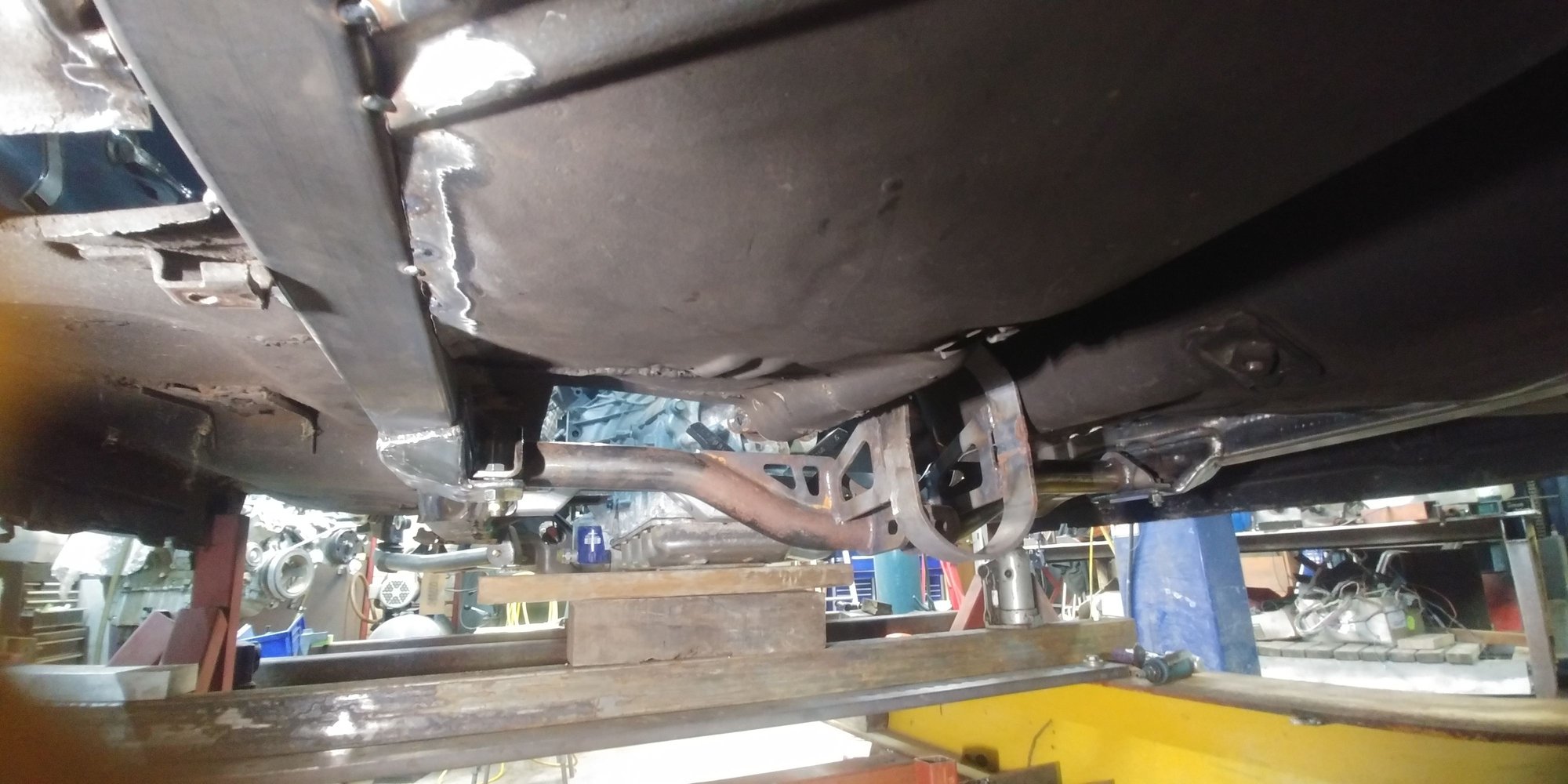

Old Feb 4, 2019 | 10:22 AM
HotWheeelz's Avatar
Joined: Jan 2019
Posts: 39
Default For Your Viewing Pleasure TCI Torque Arm Crossmember Brackets Welded in and Installed
Drivers side
Rear view
Side view
Ain't these pretty!
Floor pans and tunnel will be addressed when suspension is hung and we see the parameters to build around.

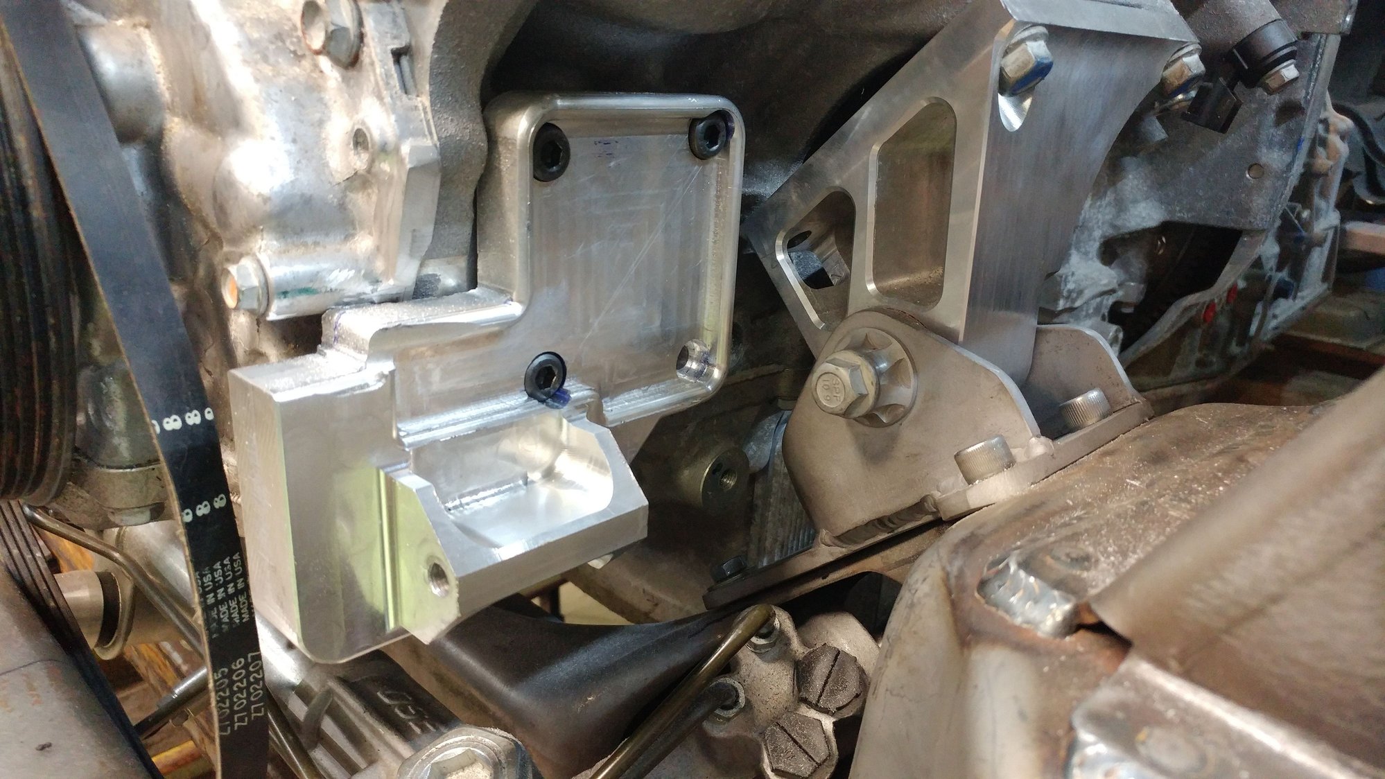

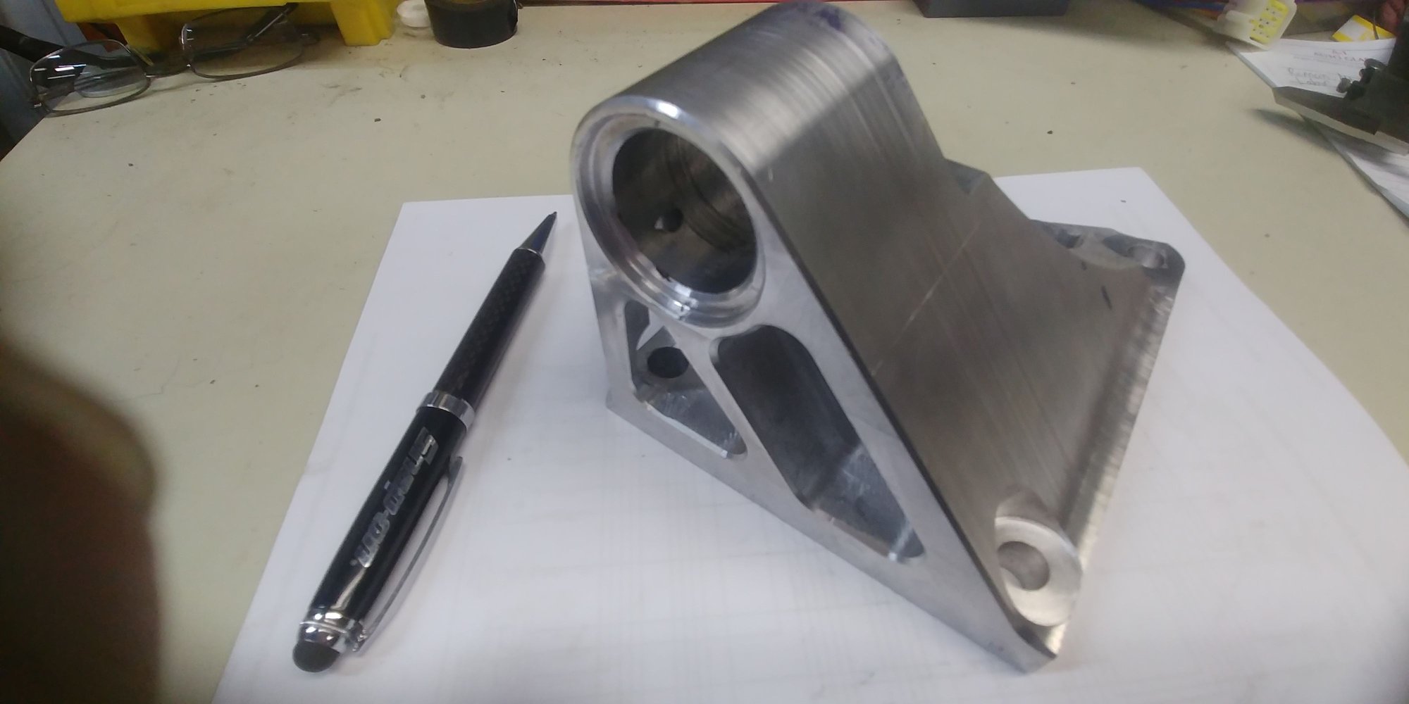

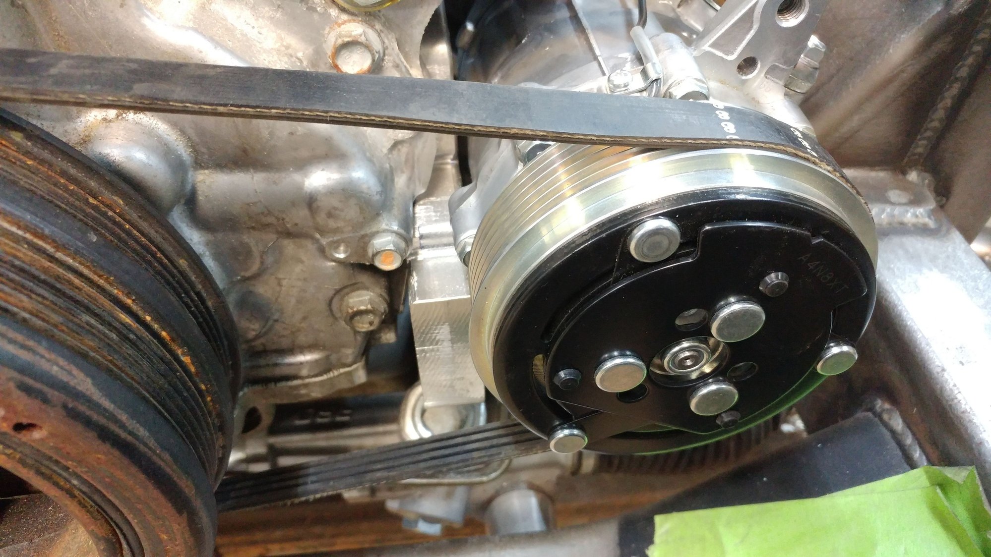

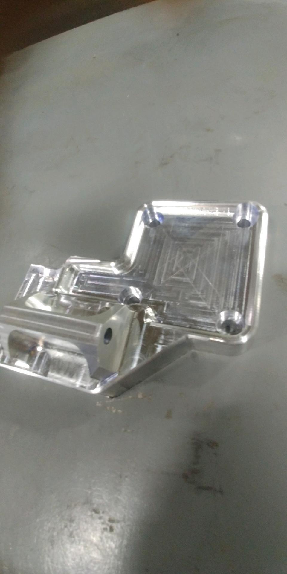

Default More Billet Whittlin, The A/C Bracket For The Sanden SD7B10 Mini A/C Compressor
The bracket:
The Bracket temporarily installed on the engine:
The bracket temporarily mounted on engine. The front of the bracket is not finished in case we need to install an idler pulley.
Front view.
Rear view.
The lower A/C bracket to mount the Sanden SD7B10 Mini A/C compressor to the engine.
Old Feb 7, 2019 | 11:00 PM
jasonz28camaro's Avatar
Joined: Sep 2006
Posts: 593
Likes: 7
From: Houston
Hard to tell in the pics but will you also need to alter the tunnel in the back seat to make room for the driveshaft?
