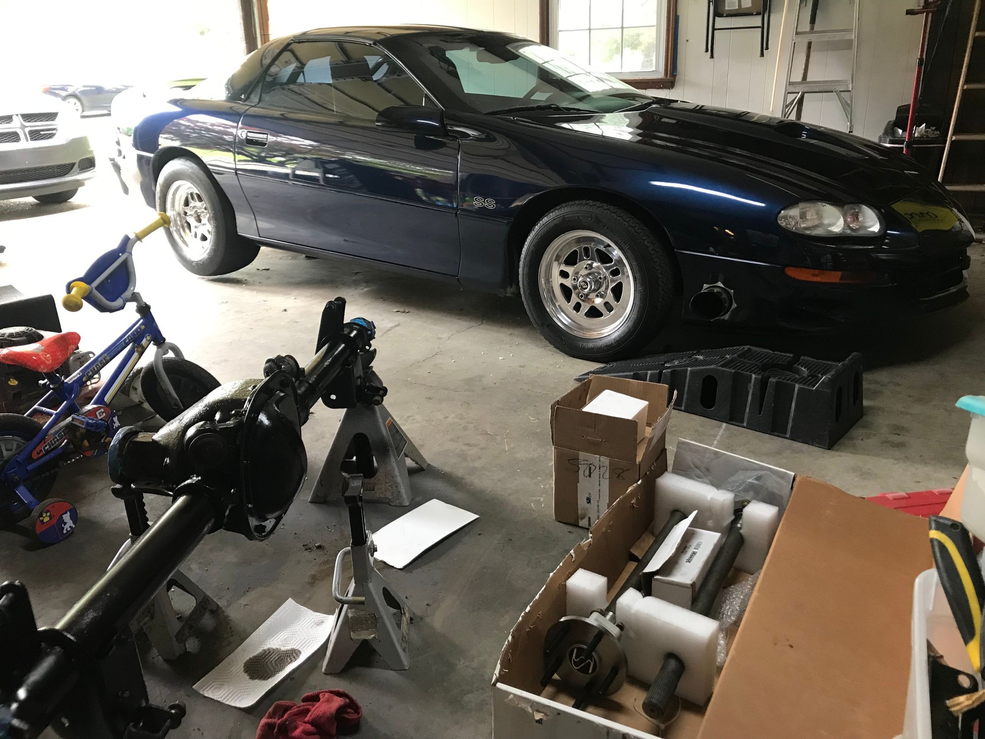

Picked up a th400 for the car. Tci street fighter with rmvb. Hopefully we get a chance to install soon and look at what we want to do for the trans crossmember.
Couple of things right now stock motor mounts will not work with my speed engineering long tube headers. They make contact so I need to find some mounts that hug the block and mount to stock ls1 style pedestals. Also having a hell of a time getting the axle bearings out of the 8.8 so I can wrap up the new cc eliminator, axle, and spool install. I have tried a pully puller but ended up breaking a wrench and all but breaking the puller. I may have to add heat to the equation. . .

Got the strange spool bearings in so pressed them on and c clips on the 35 spline axles. Got everything installed and the housing primed then painted. Needing to source some disk brakes and backing plates to complete the rear.

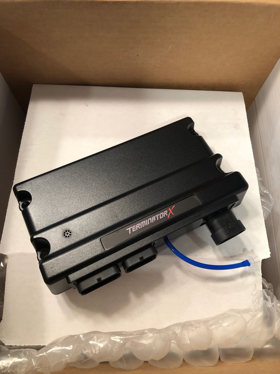

Termin
terminator x is here so progress should start happening. Need a converter and driveshaft to button up the drivetrain. Goal is for the car to be driving this summer.
