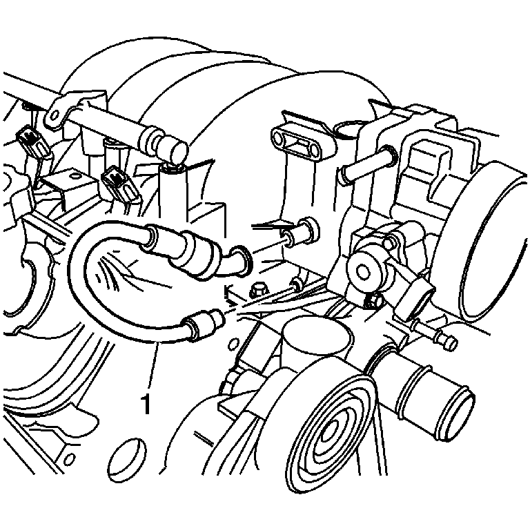

some early ported valley plates do not have pcv built into them and still require the external pcv valve. you should verify this since you did not buy the plate yourself.
see this gm image of the valley port and an external pcv valve on some year cars
Attachment 594993
a test would be to remove your oil cap and hook hose to the valley plate, blow into it
if it is extremely difficult to blow into, it has the built in restriction, if it is similar to blowing through the tube itself then you should keep your original valve in-line
Attachment 594993

Well, looks like I answered my own question. There is a new and old style LS6 valley cover and I have the old style without a PCV valve. I found a like to LS1howto.com and they have the old style tube with a build in PCV valve listed, but it is very expensive and not sure it's made any longer. I'll probably just end up swapping to the new style for simplicity.
