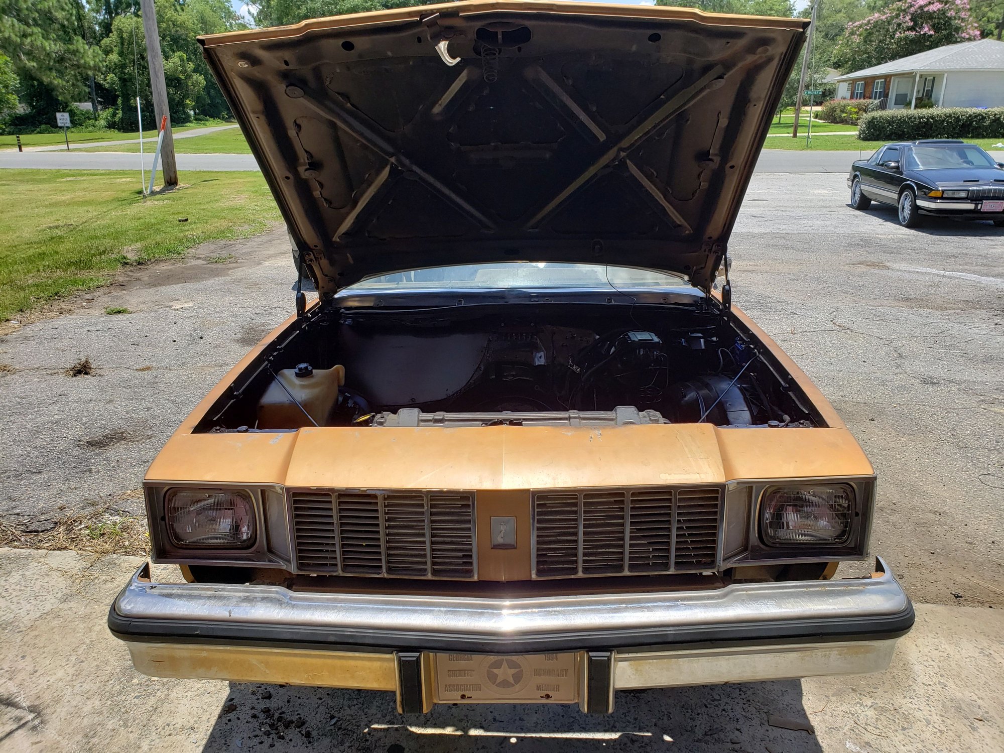

Original 260 V8 that ran until the day I pulled it out.
Bay cleaned up and heater/AC box removed.

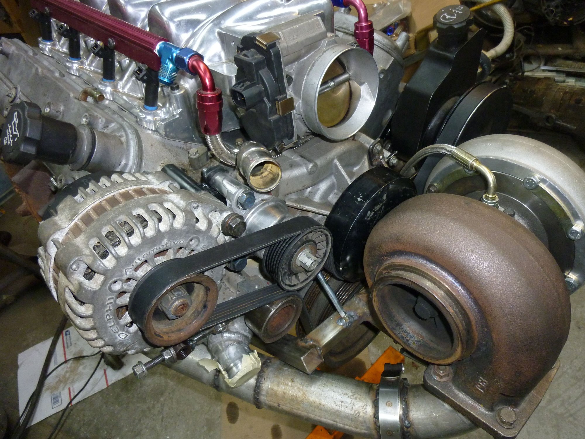

https://www.motionraceworks.com/prod...-mounting-ears
I bought a Motion Raceworks T4 Flange to build a support off of. It will need to be supported by the motor itself. I have no flex in my Crossover so if I support the turbo on the frame it will cause even more stress issues on the piping. I plan to do something similar to this.
See attached for Mount ideas
Mine will be similar
Only brace off of frame IF you have flex joints or slip joints.
Here's one braced off the passenger head but this setup has the turbo mounted on the passenger side.
Here's a underneath view of a center mount where ours will be. Gives you a rough idea of where people are mounting them off of.
Someone's crossover pipe and mount in one piece. I want my support to bolt onto the flange or at least be able to remove the turbo then the Motion flange and supports as one piece without removing my crossover all together.
Something like this will work.
Again, this is great if your engine is either mounted SOLID and CANNOT move at all or you have flex joints, or both.
Very similar to what Im doing.
Hard to see but there's some bracing in this pics somewhere.

I built my turbo support to attach to the engine at 4 points. 2 on the waterpump bolts and 2 more to the block. It was a pain in the ***, but I don't want the pipes to crack with the first bump in the road. I found an old picture that has part of the support in it.

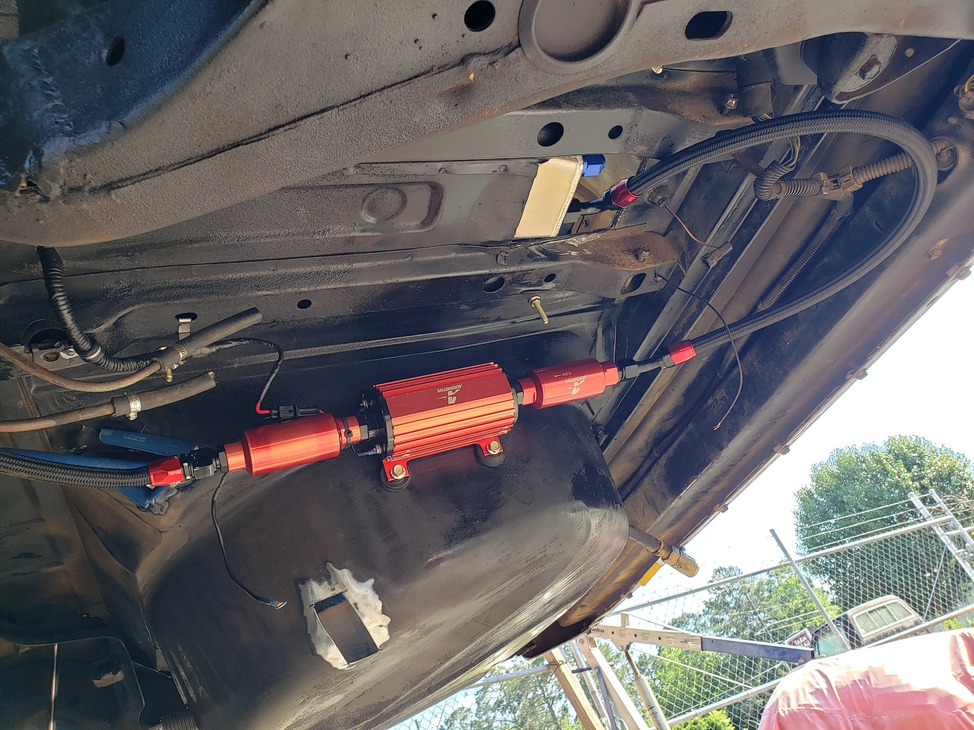

More pictures showing pump mounting, bulkheads for supply and return
Attached Thumbnails Cutlass Cruiser getting a 4.8L and boost-20190727_162722.jpg   Cutlass Cruiser getting a 4.8L and boost-20190727_162726.jpg   Cutlass Cruiser getting a 4.8L and boost-20190727_162732.jpg

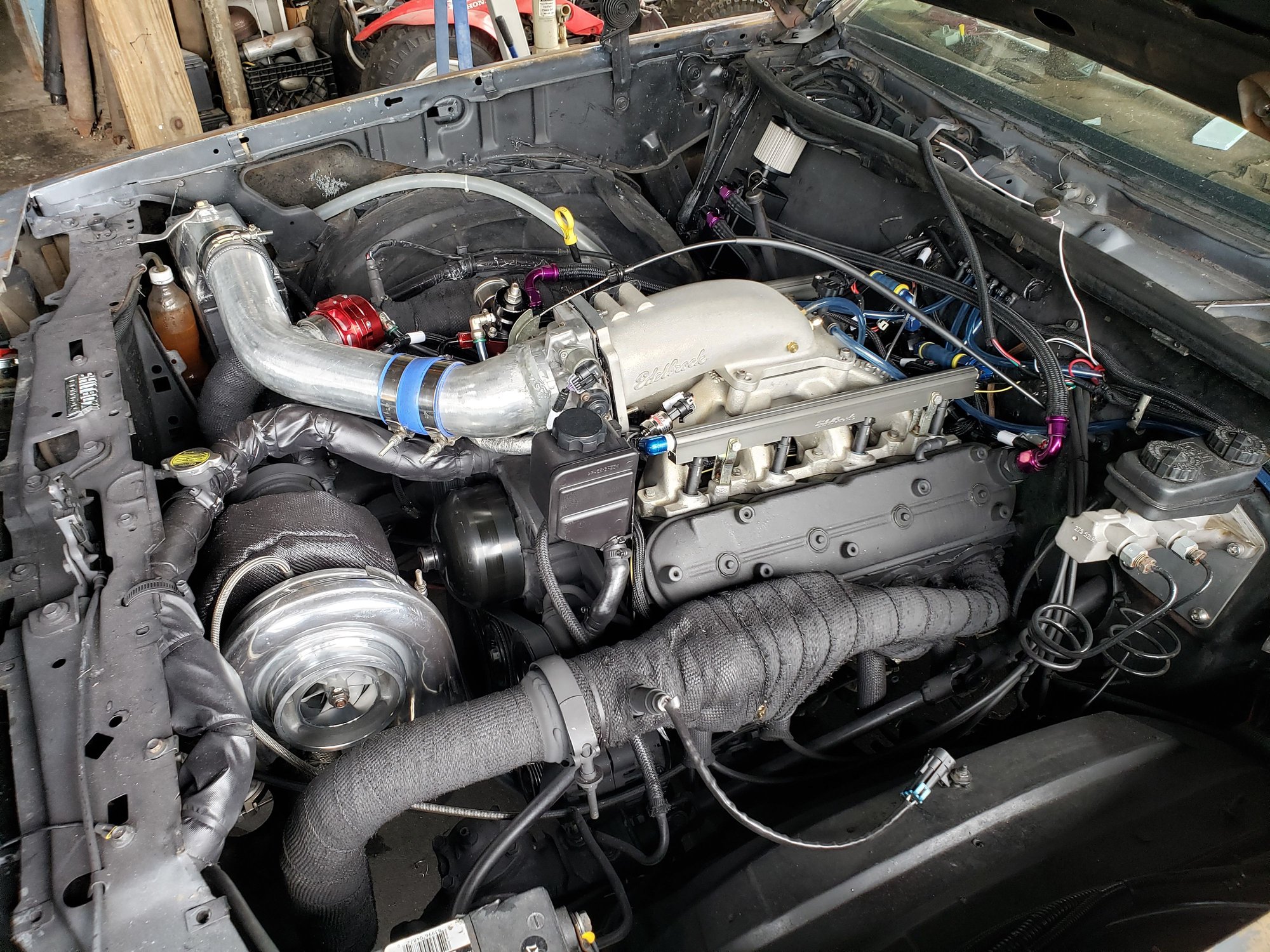

Okay, I have taken a long time on this project due to me upgrading a ton of stuff before I ever put it on the road. I have still yet to drive this car after 1.5 years. Yeah I know.
Here is the list of upgrades

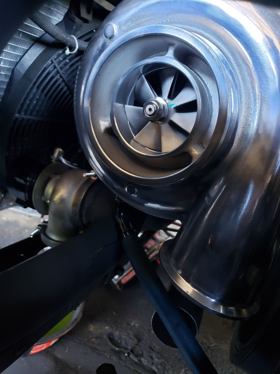

VS racing 75mm turbo with 83x75 turbine 1.10AR - I polished that turd too
VS Racing 60mm Wastegate
Victor Jr intake setup
Genuine SD 80lb Injectors
FTI Level 4 TH400 with transbrake
Jegs XD Stall
Vision Sport Mag drag wheels 17/15
Aeromotive A1000 pump and pre/post filters
-10AN Fuel feed and -10AN Return
Holley Terminator X EFI System
GM 2.5 Bar Map sensor
