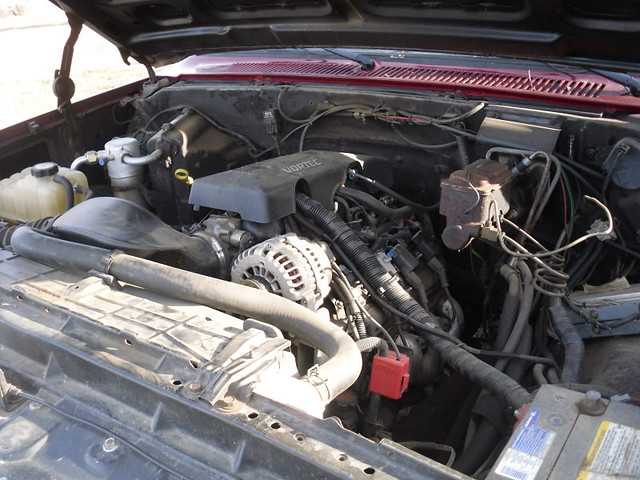

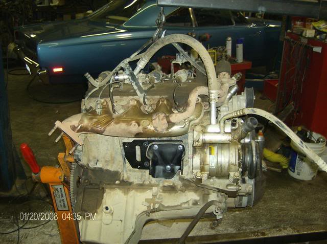

AND finally Id someone has done this exact swap in similar truck maybe they have some stuff they could point out to save me some time.
I've done a couple of these...I have a 1986 C-30 crew cab dually with a 6.0L LQ4/4l80e combo that I drive every day.
I just use cheap trans dapt plates part# 4572, factory motor mounts, the stock GM clam shell mounts with the right side slightly modified to be able to use the factory LS AC comp.
Factory LQ4 oil pan fits perfect.
I used 1987 GM F.I. pump hangers and senders inside my 1986 tanks with dual AC Delco EP-381 pumps running through the factory tank switcher. VERY quiet.
Factory trans crossmember moved back to match the 4l80e mount, redrilled holes in the frame.
Early F-body exhaust manifolds fit very well.
You can PM me with any questions.
Not the cleanest anymore, but I use it every week...
