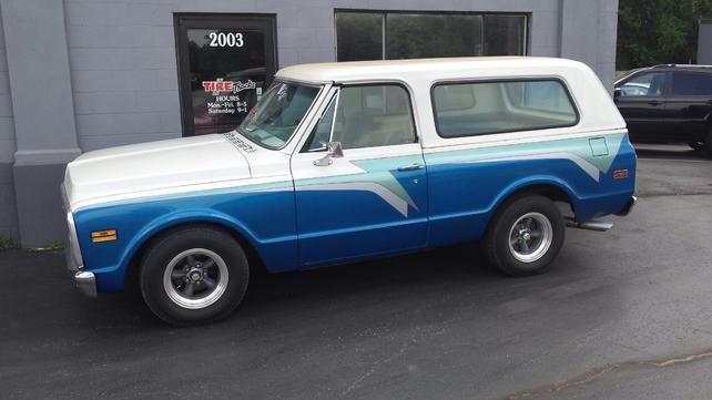

Looking for info swapping a vehicle onto a complete C6 Chassis. I have seen a couple, there is the camaro with a Z06 swap.
Z06 Camaro swap
And this duster
Duster C6 chassis swap.
Please don't give me too hard a time I am just throwing ideas around. I have a 1972 two wheel drive Blazer I plan on LS swapping anyway. I have contacted some chassis builders and none seem to be interested. I would love to find a way to swap my 1972 Blazer onto a C5/C6 chassis. LS2 and LS3 engines used are going for $3000-7500 for just an engine, belt driven assecories, pedal and ECM. Still need transmission etc?
I am seeing C6 rolling Chassis with everything from engine, suspension, wheels, all electronics, brakes, ABS, wheels for under $10,000 delivered. The Blazer wheelbase is 104" and the C6 is 105.7 so I know the torque tube and propeller shaft would need to be shortened by that much. So what do you guys think? Dumb idea? Is it doable? I have a decent budget for the Blazer so I am just trying to get my ducks in a row. I am not a fan of the paint job so it will get painted, new interior, and a repower of some kind.
