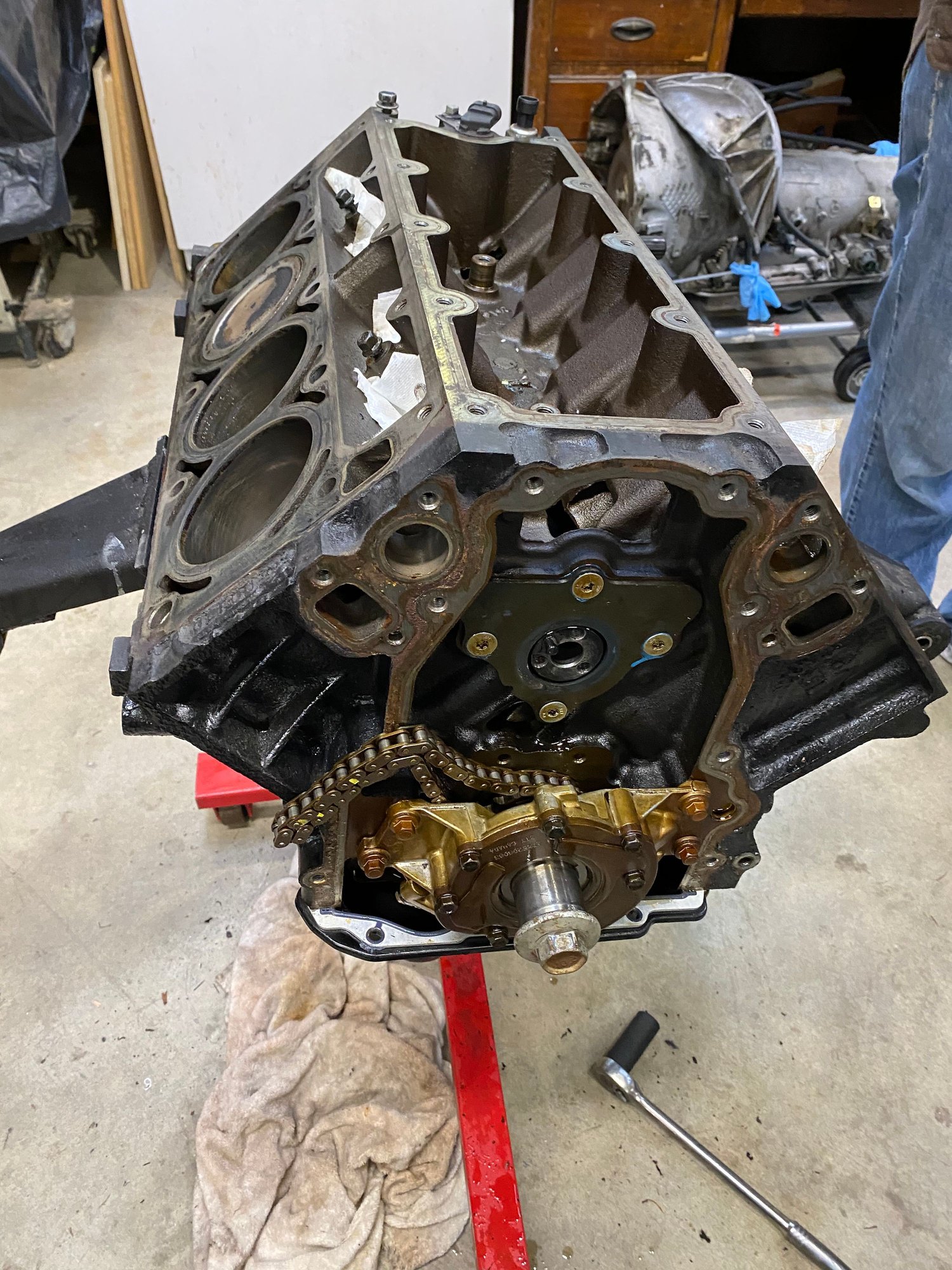

Picked up a 5.3 for cheap off craigslist, it included all the accessories, computer and harness. The engine was sold as a "core" but thought I would take the gamble.

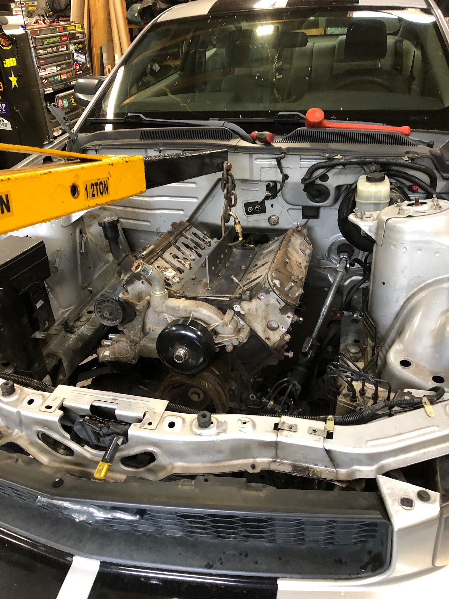

Tore it down.....
The cylinder wall had some good sized gouges in it. It will make a good mock up & spare parts engine.

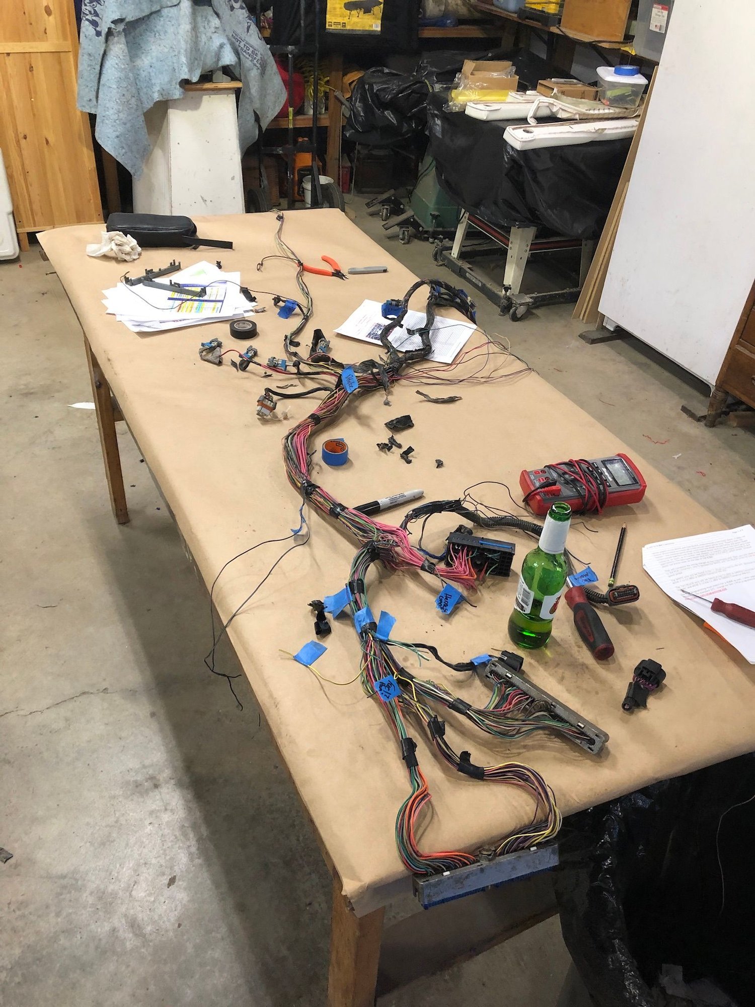

Started to rework the harness.

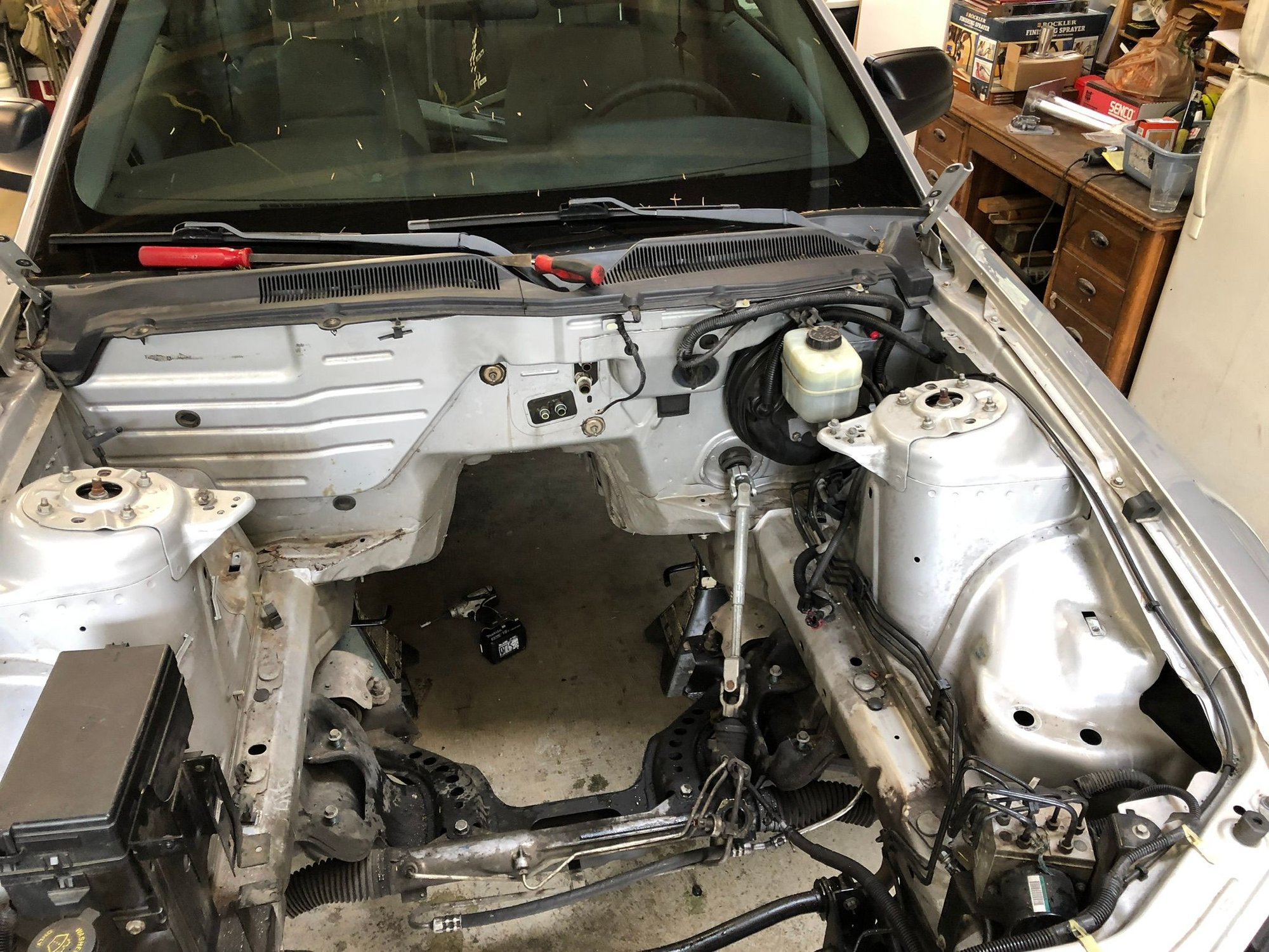

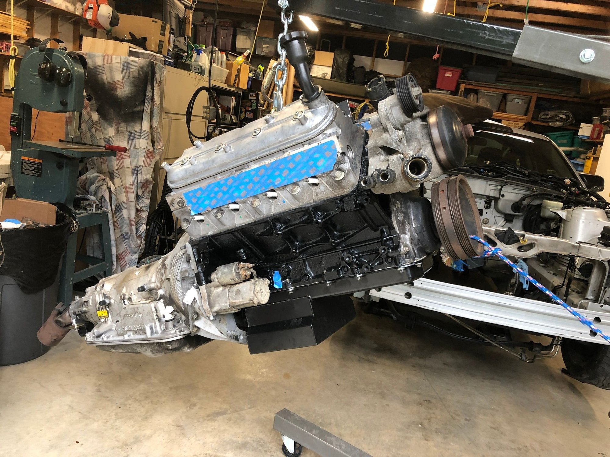

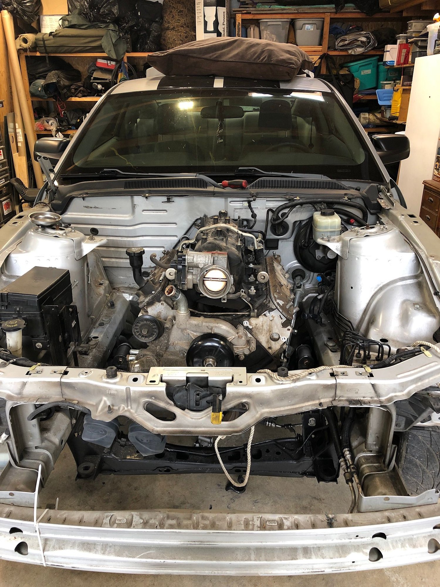

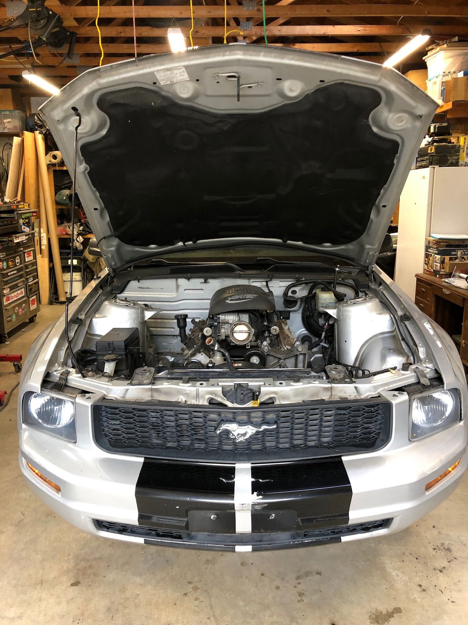

Pulled out the blown up V6 from the mustang.

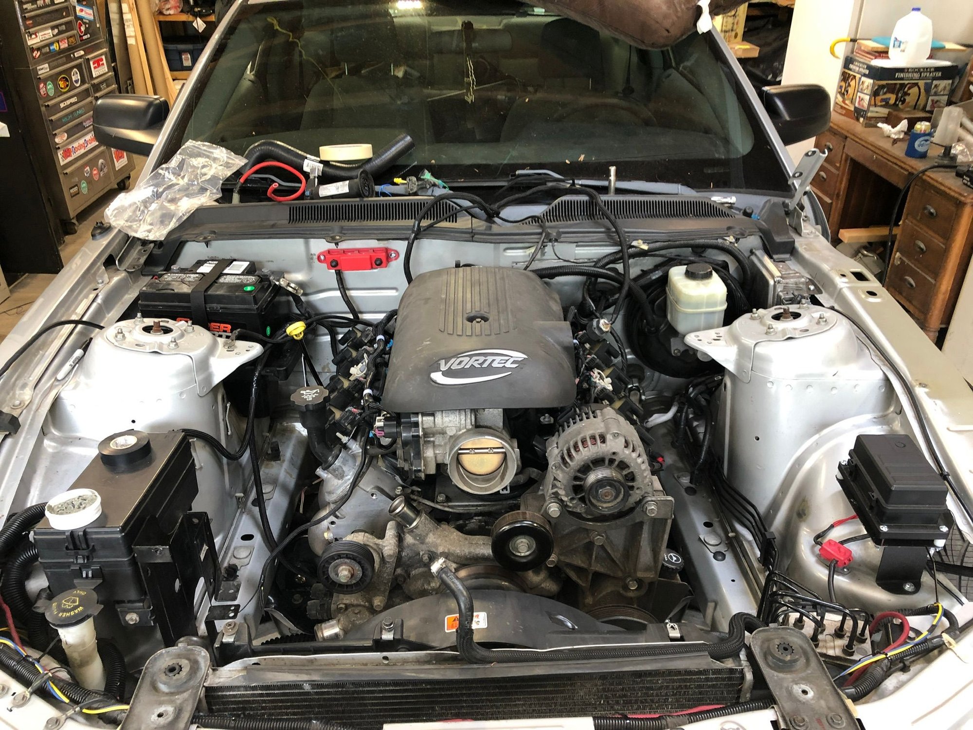

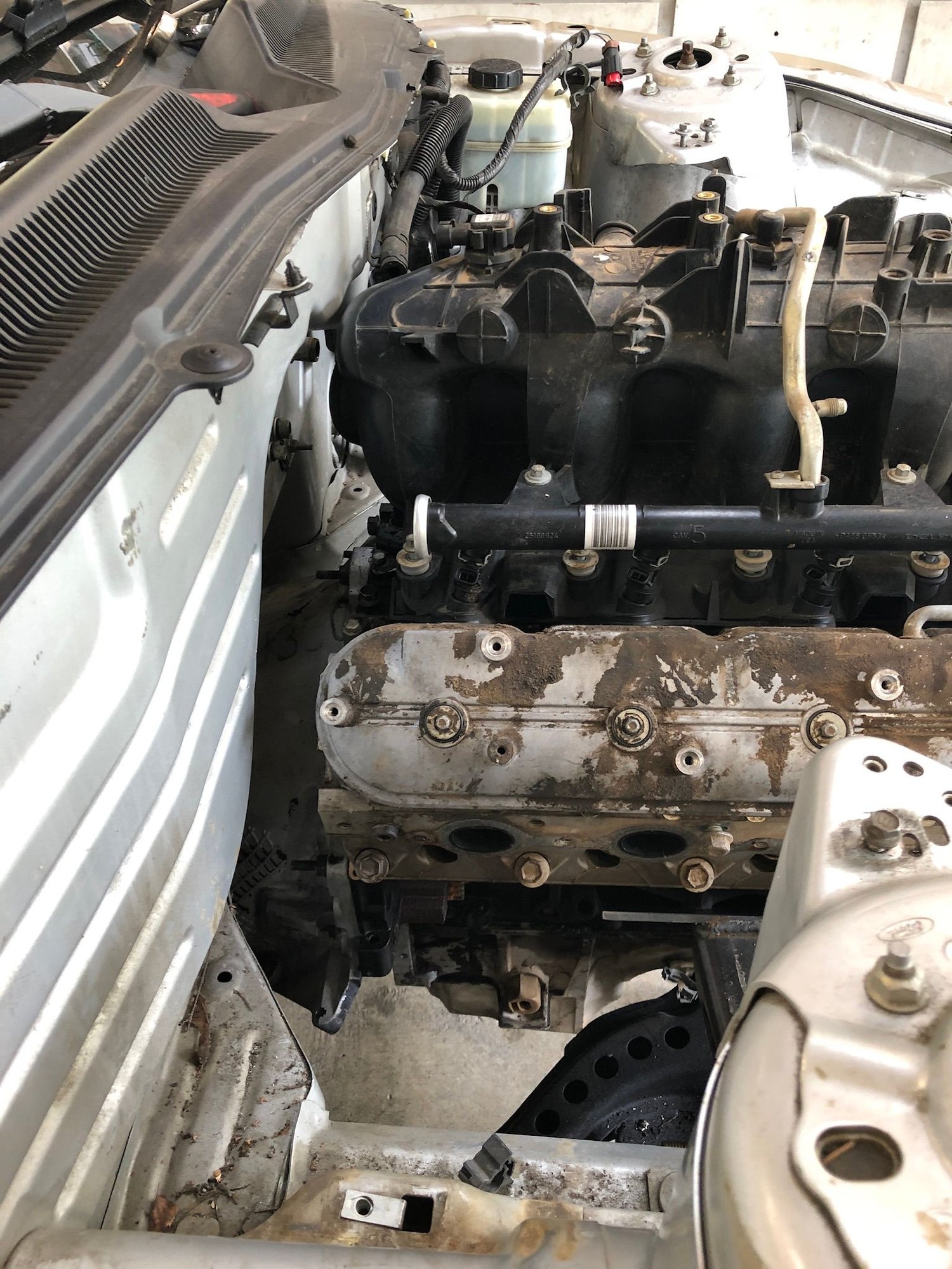

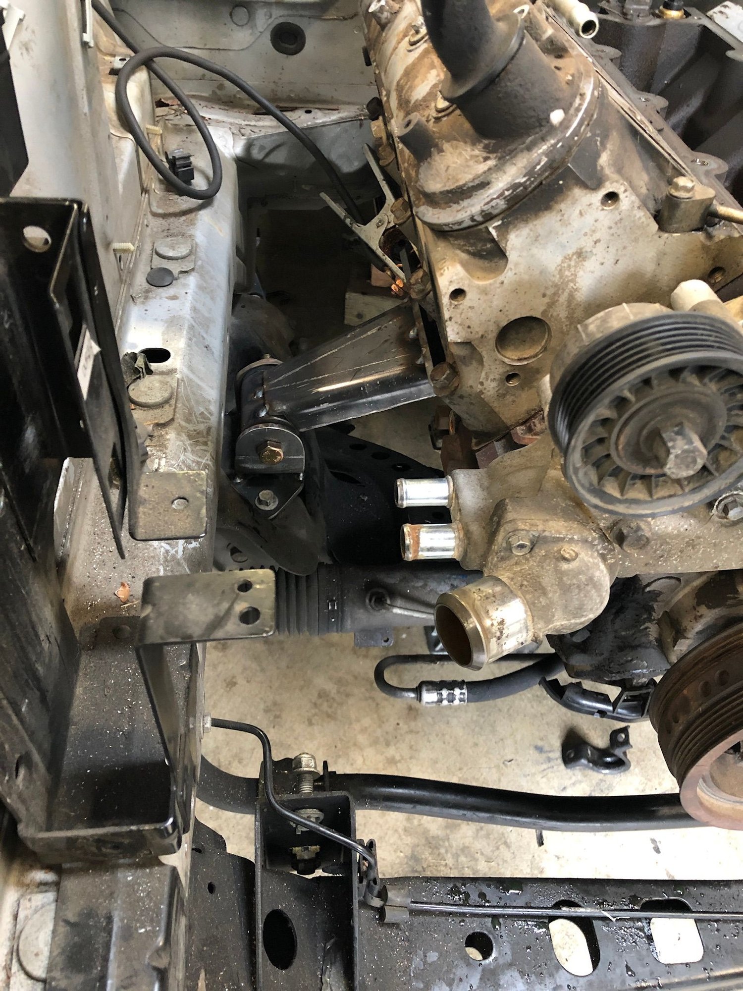

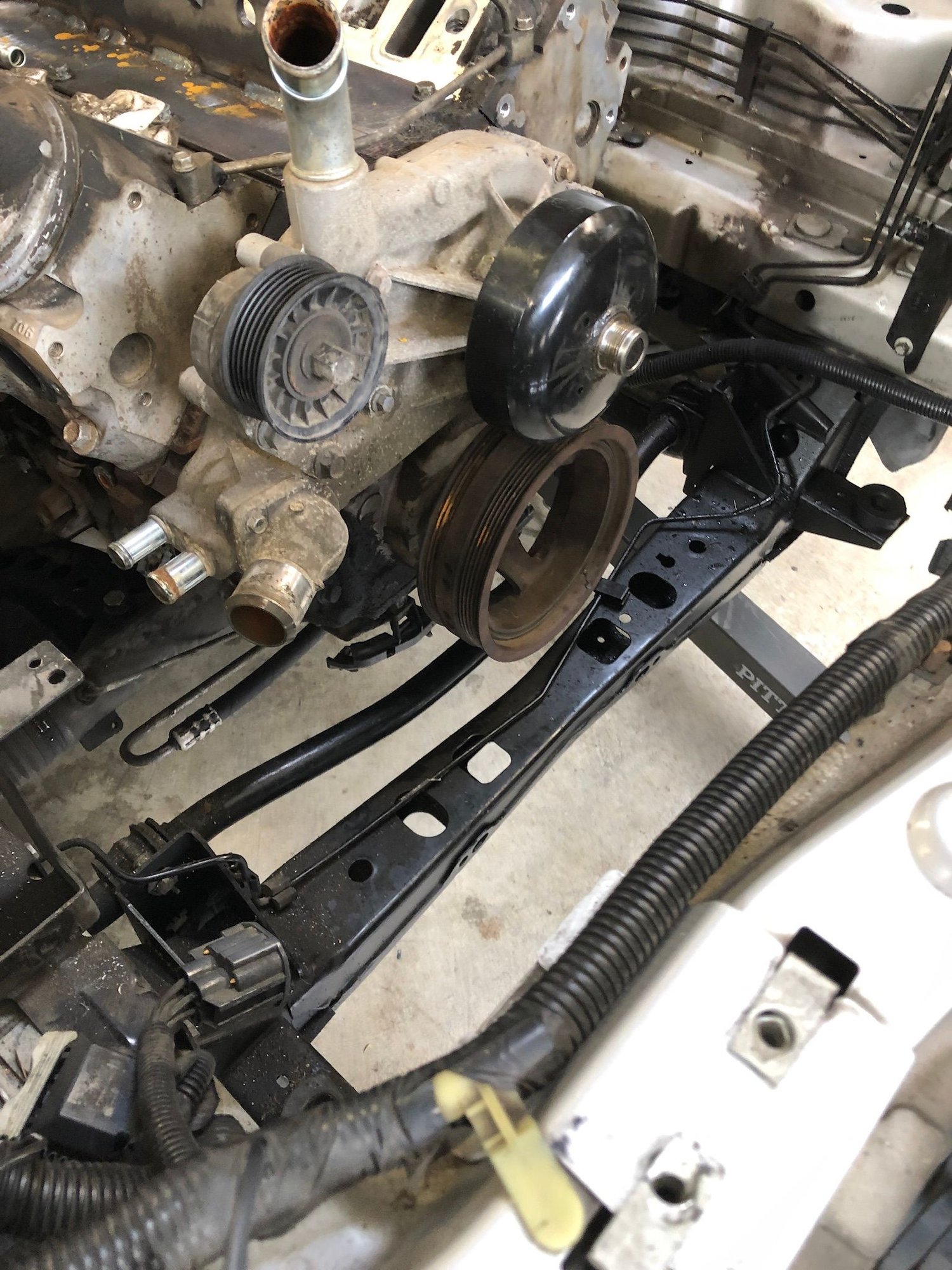

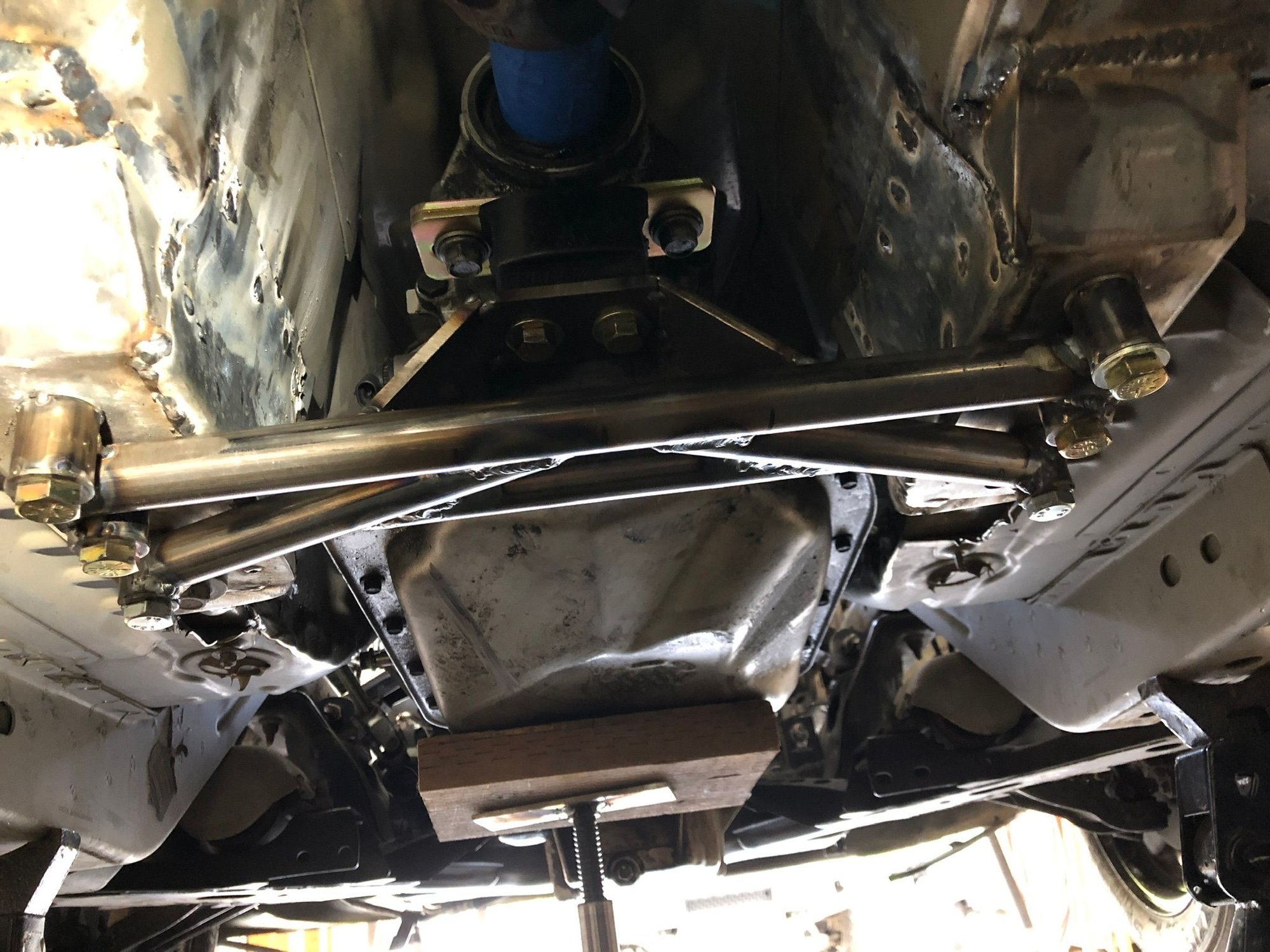

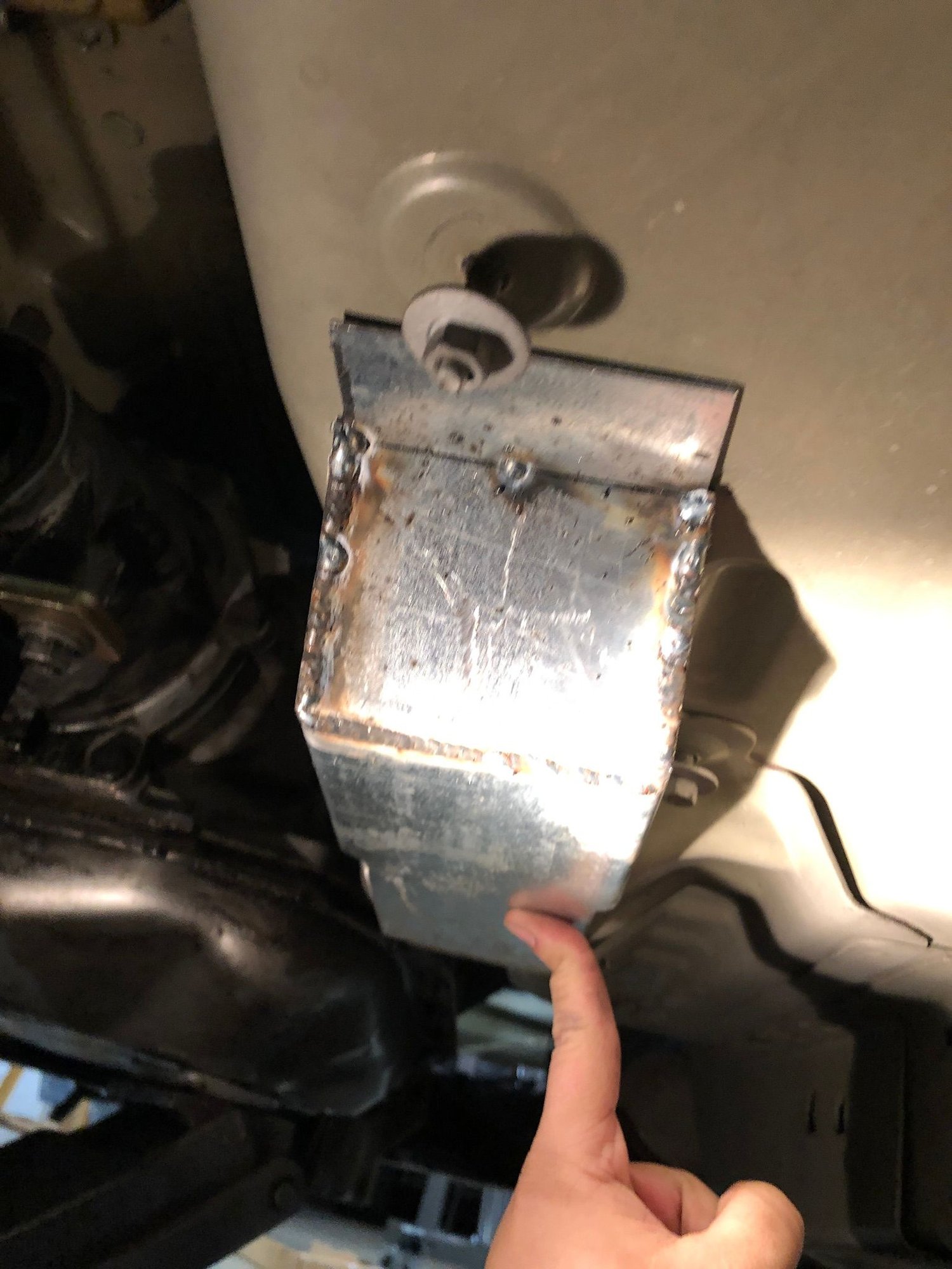

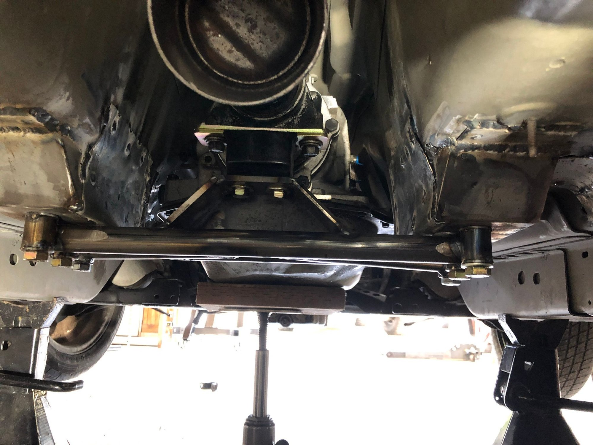

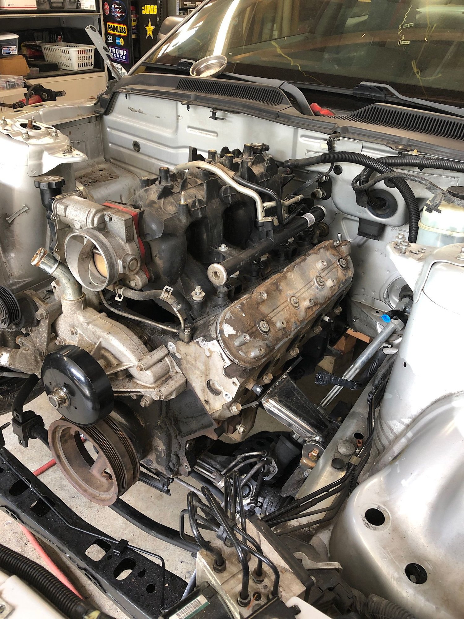

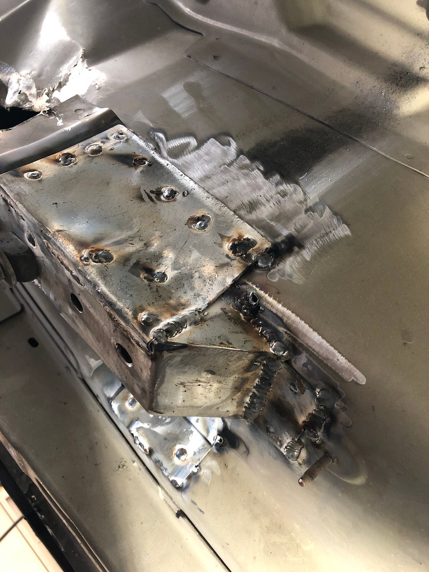

The engine fit great. I had to build mounts for it and attached them to the factory subframe. The truck pan had clearance issues with the power steering rack and hung far to low. I went with a aftermarket pan from Jegs.

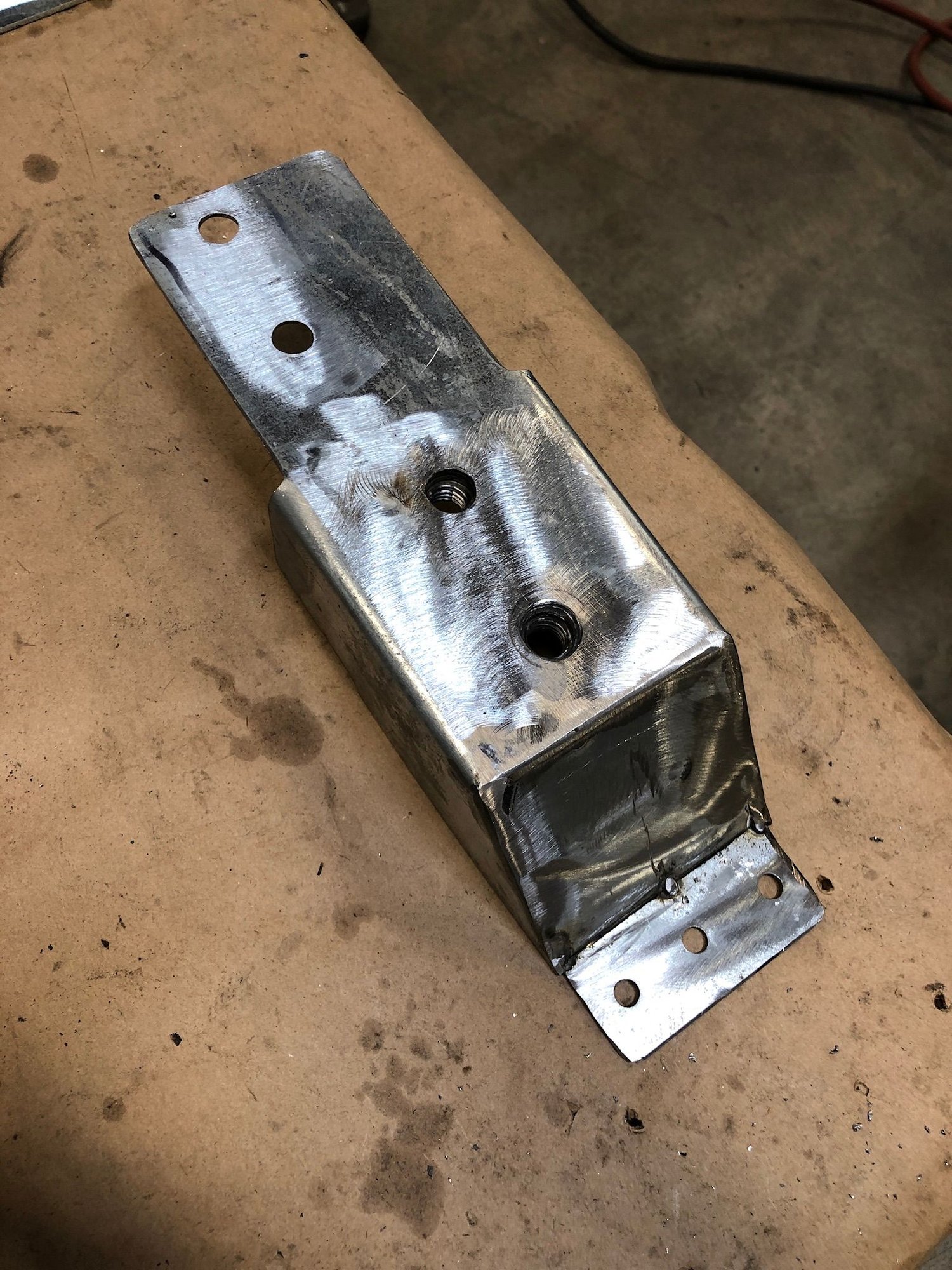

Getting the transmission to fit was a challenge. I had to heavily massage the transmission tunnel and cut off about half of the factory crossmember mount. I then extended the crossmember mounts further back and built a tube cross member.

Engine mounted up

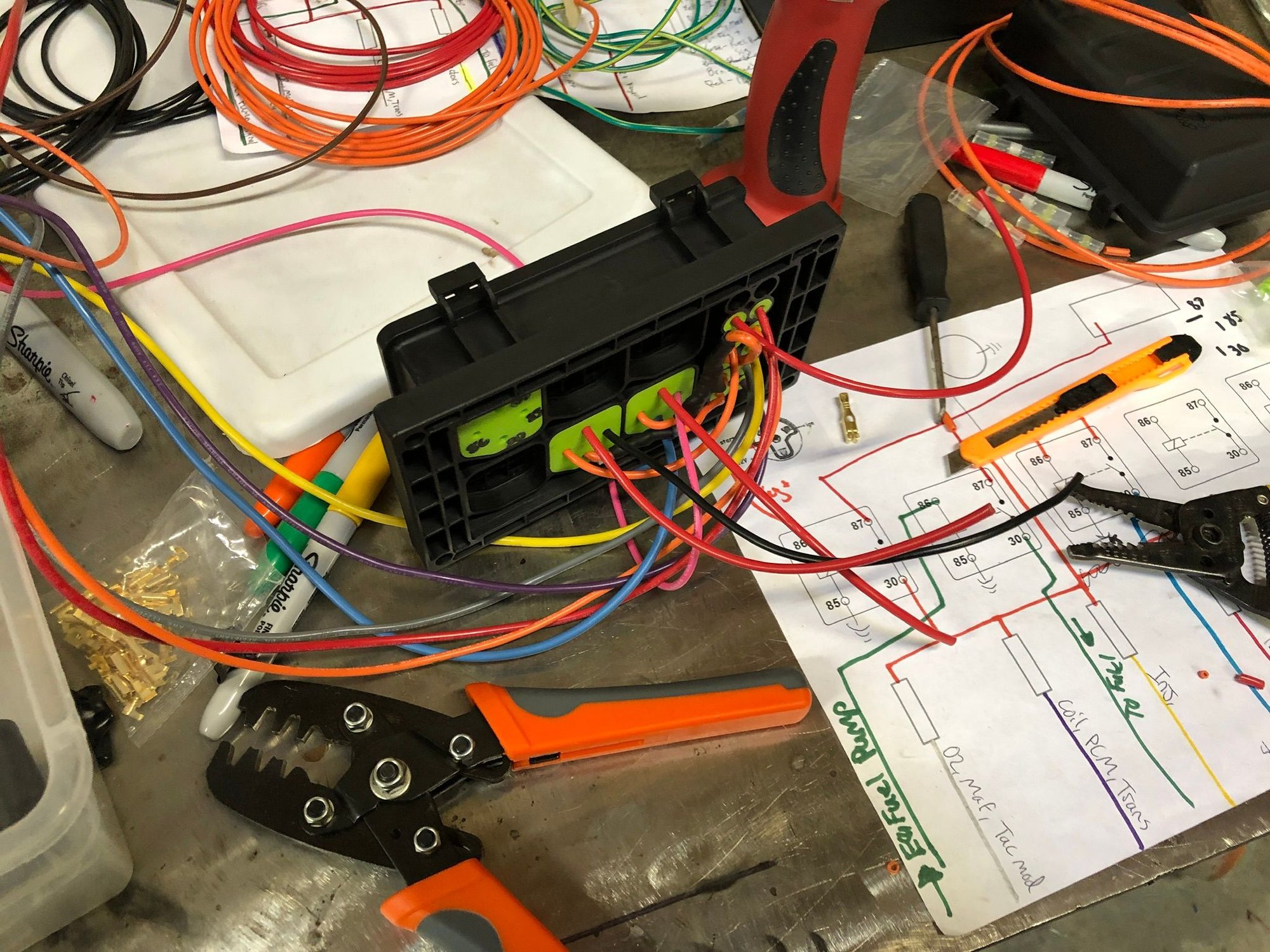

Started working on the fuse box that will provide power to the LS harness.

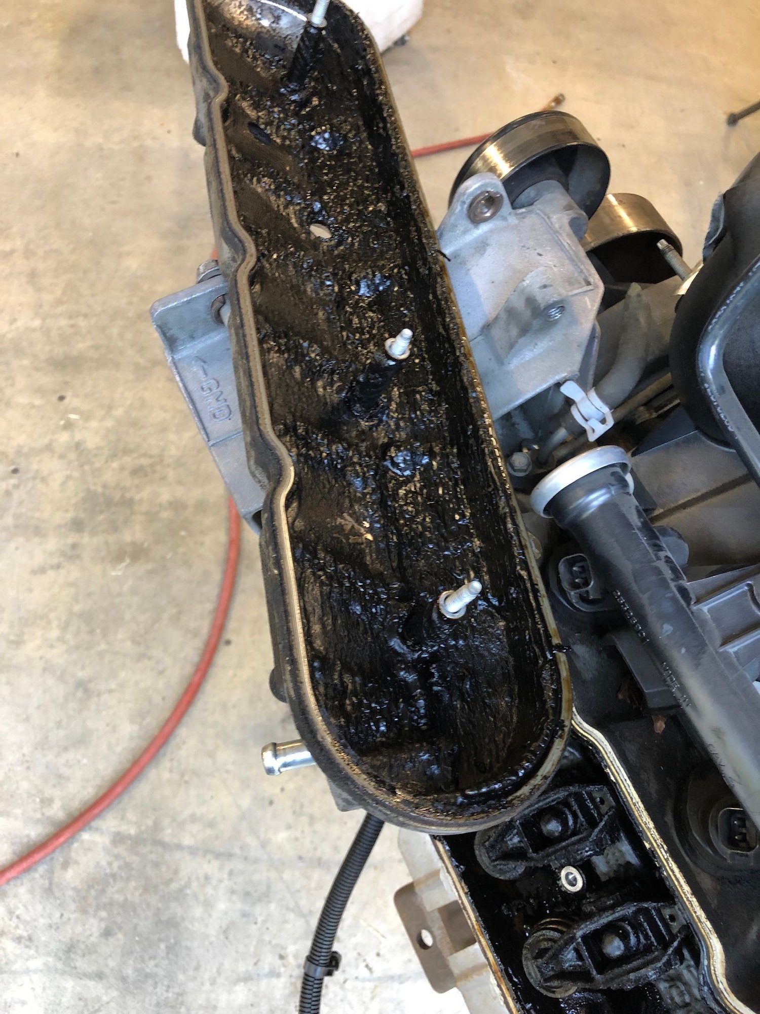

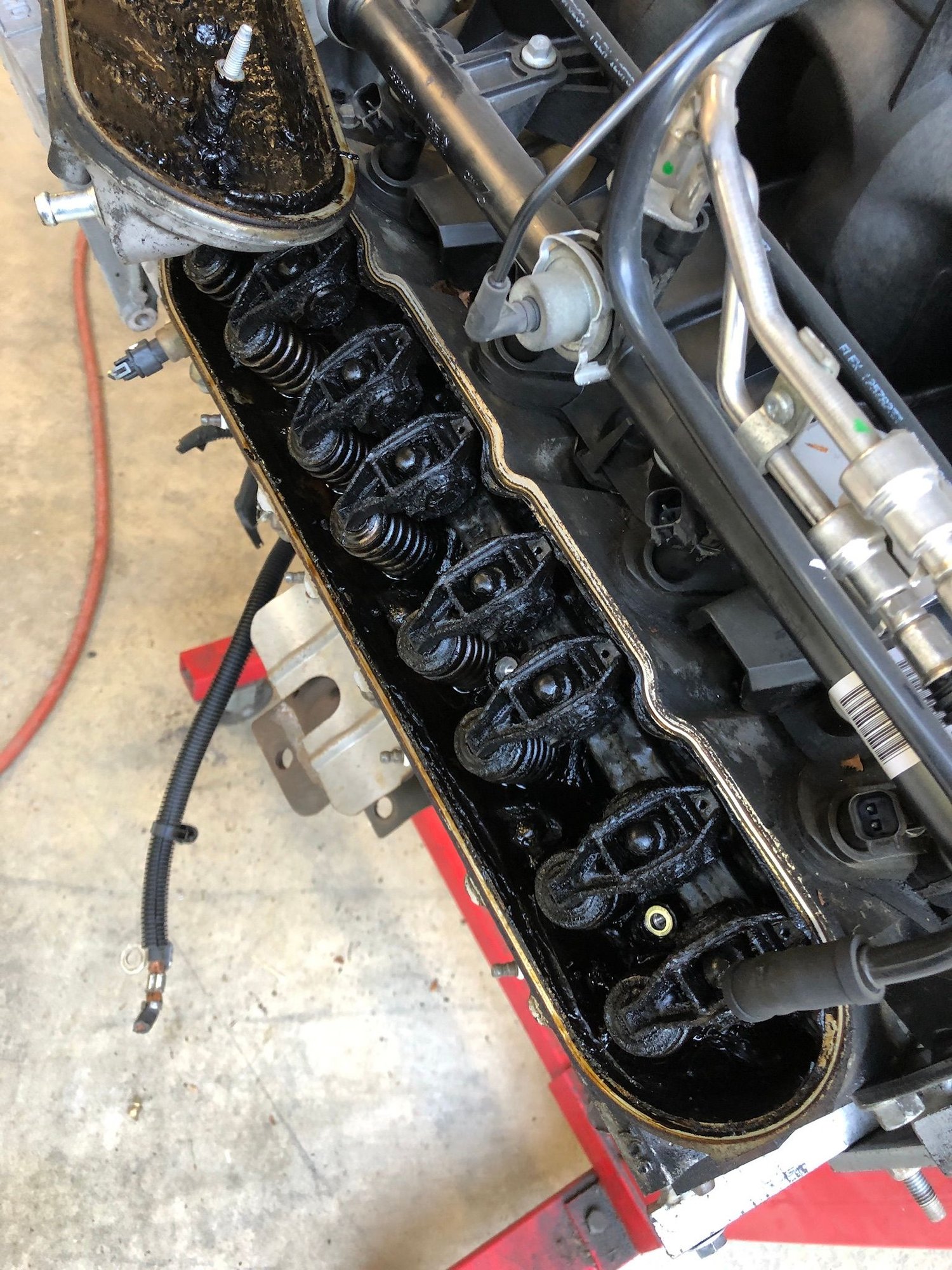

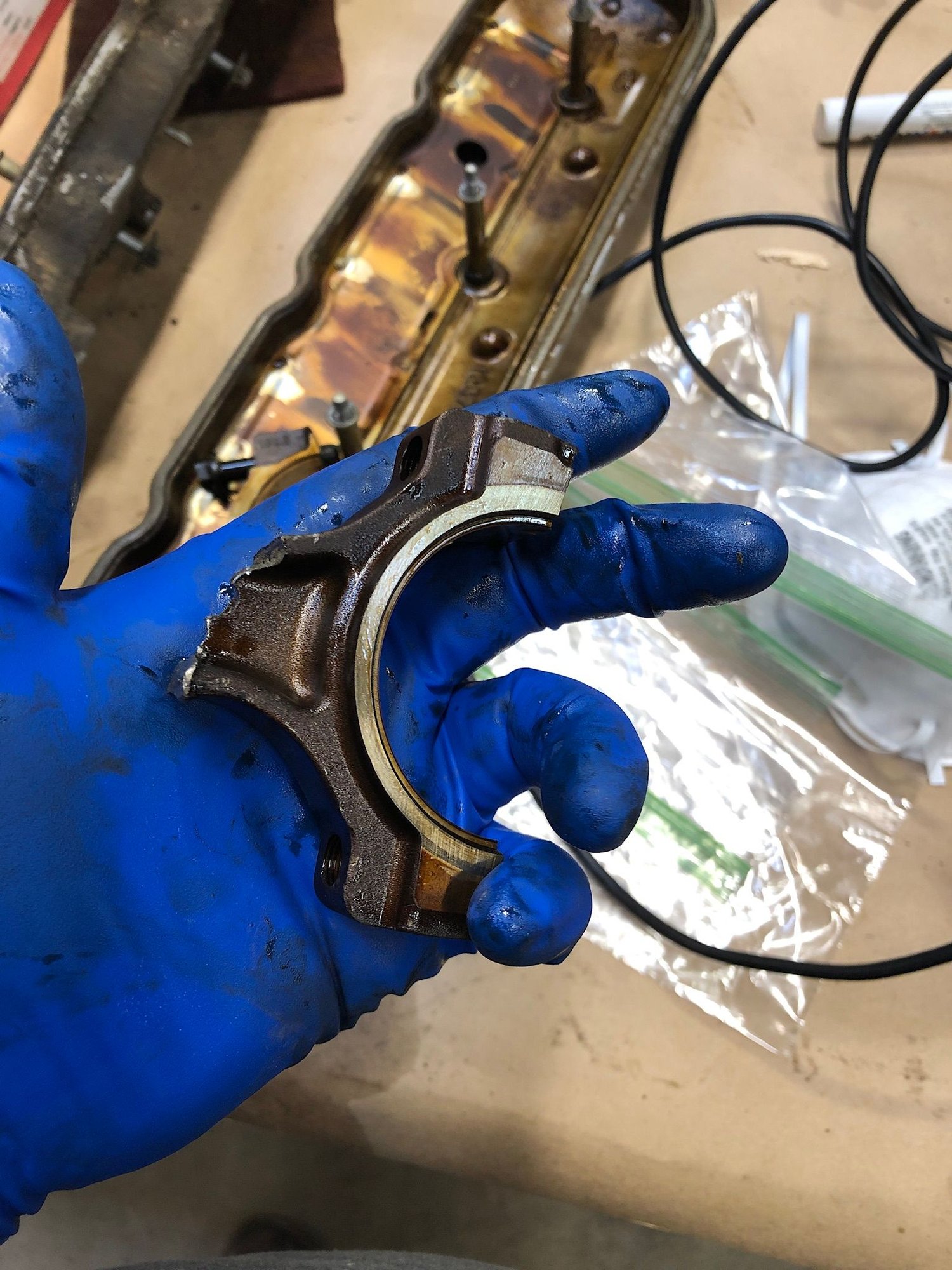

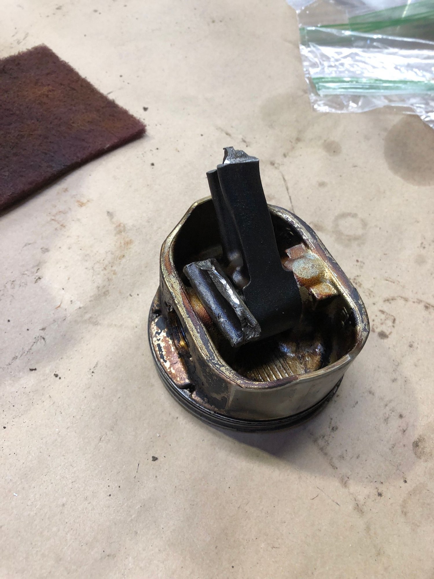

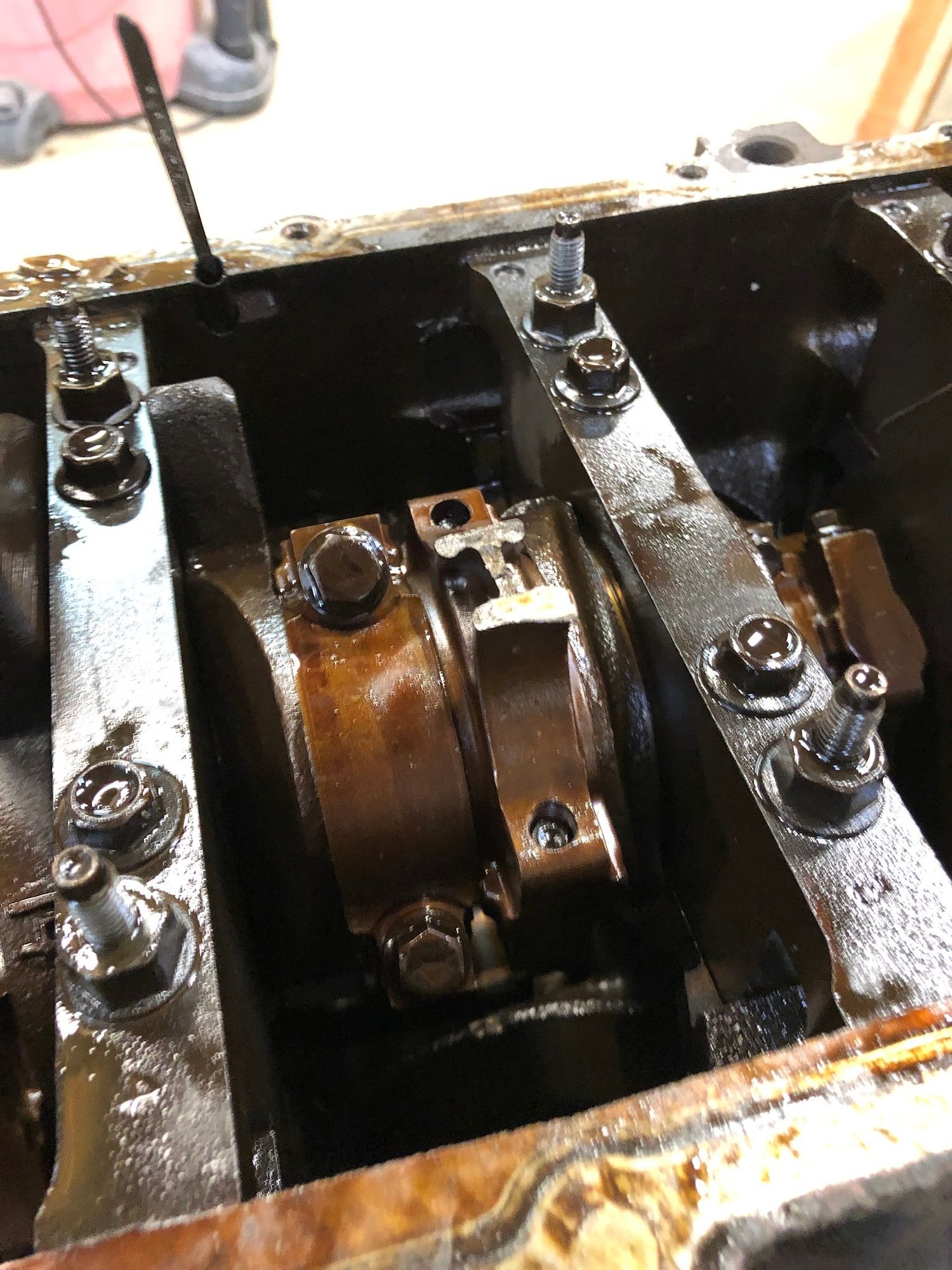

Picked up a another engine from LKQ, pulled the valve cover and found a surprise.....only 130K
Loaded it back up in the truck and returned it. I ordered a second one from them...much better. They were very easy to deal with on the return.

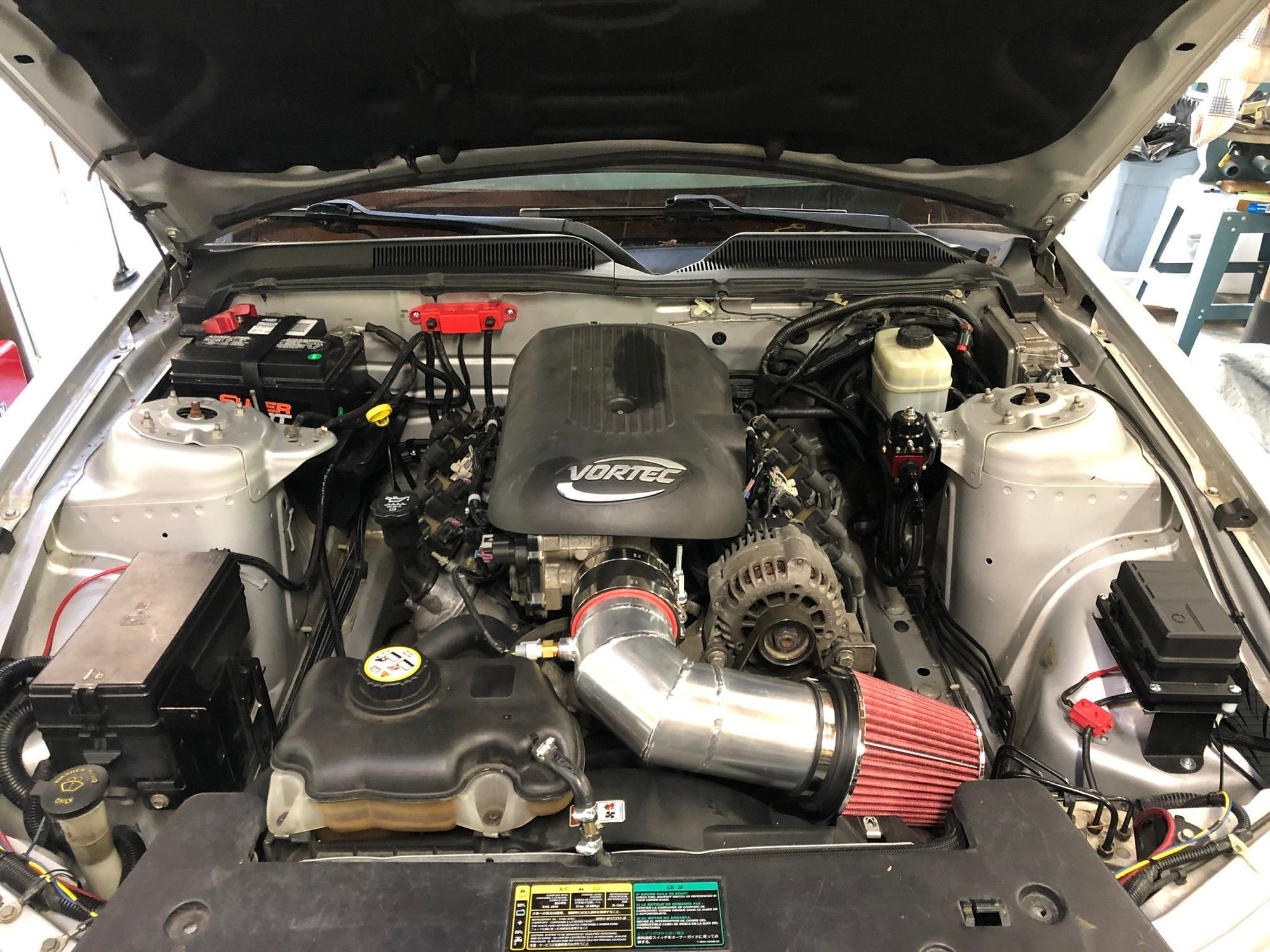

Plumbed in a fuel return to the fuel hat and ran a -6 return line. Also added a Automotive adjustable fuel regulator. Running the stock pump.

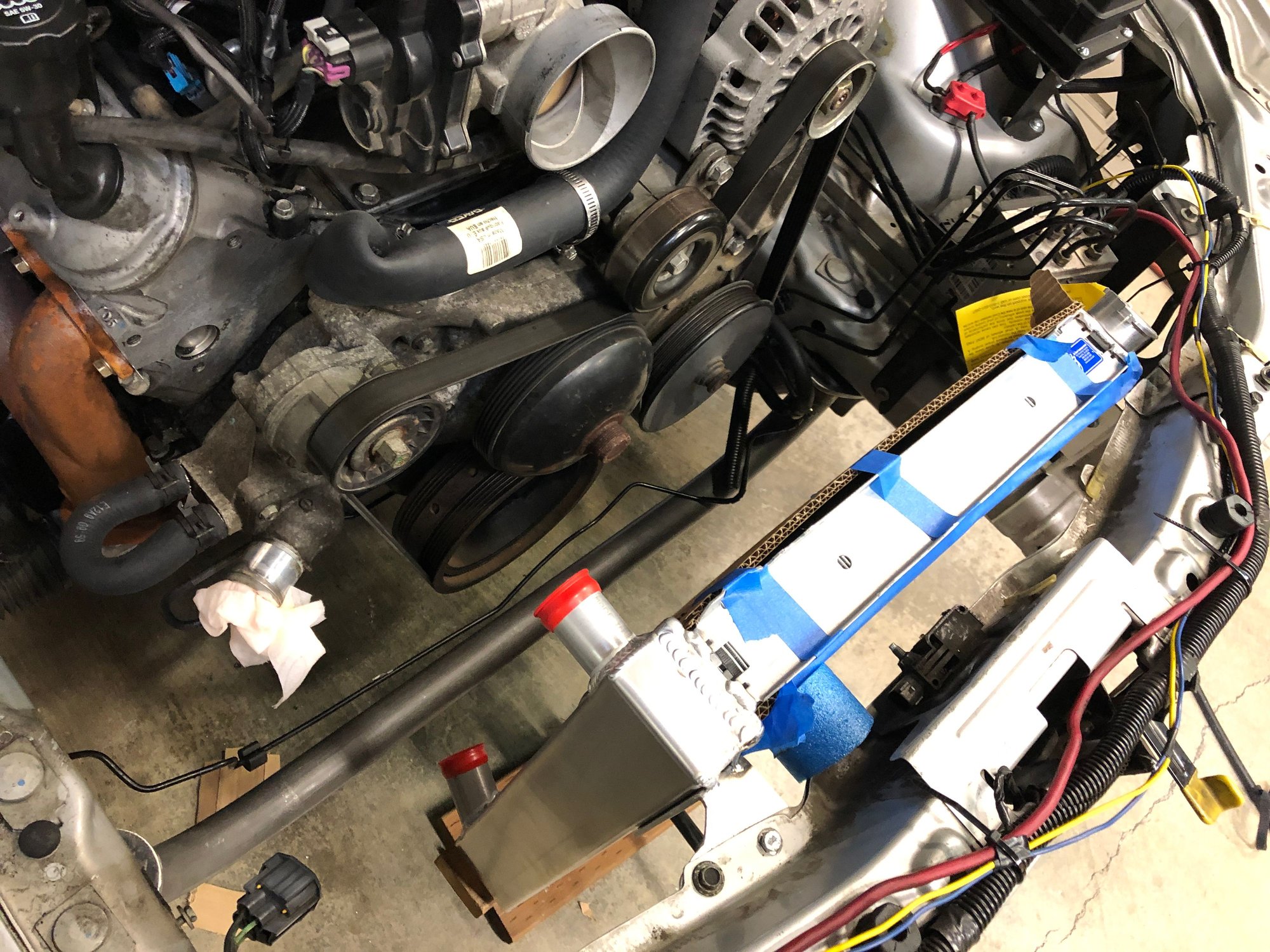

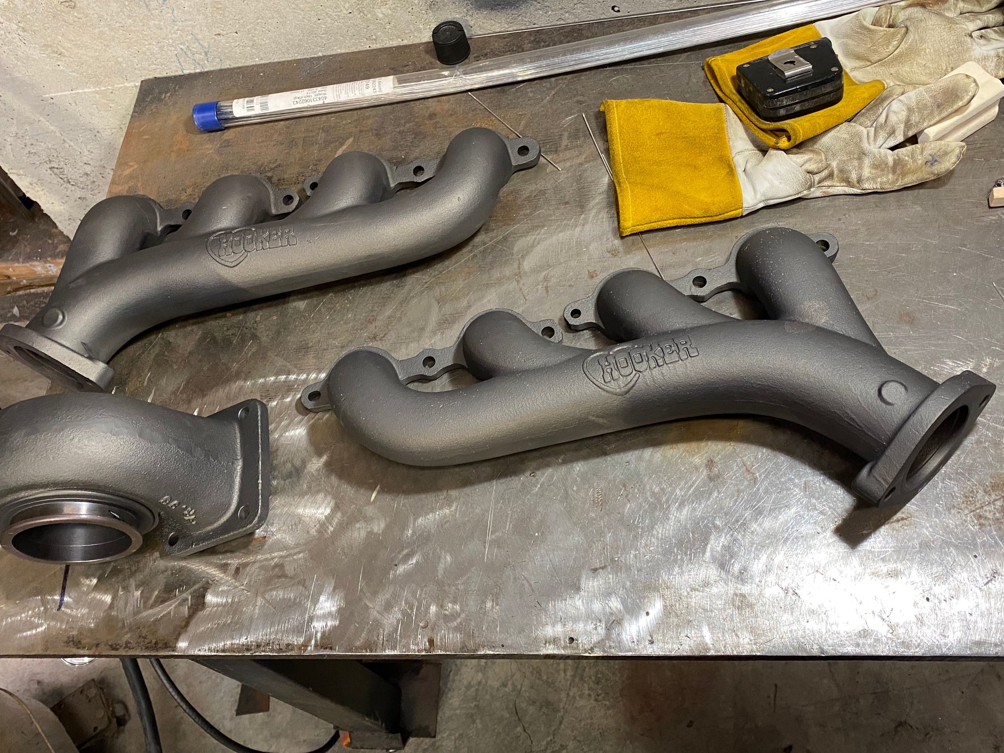

I was able to run the factory radiator and fan. I used Hooker exhaust manifolds 8501HKR. They fit great plenty of clearance on both sides. Running a remote oil filter housing with the aftermarket pan.

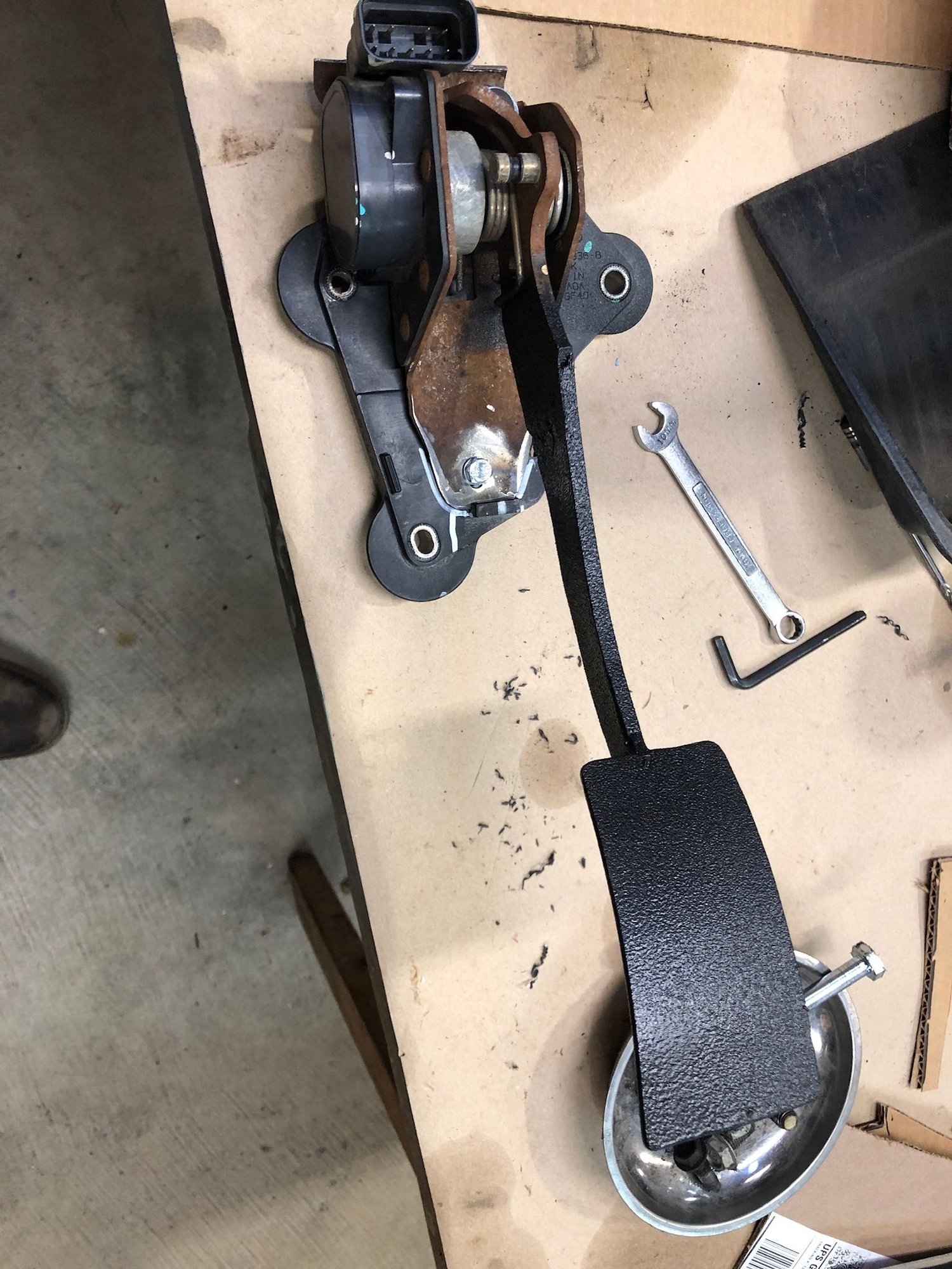

Fab'd up a gas pedal using a Silverado DWB pedal.

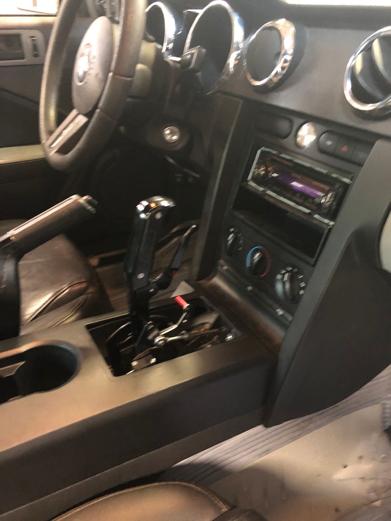

Installed a B&M shifter. I also swapped all the interior to black with leather seats. Found a great deal on craigslist, $200 for all the interior of a wrecked mustang. I was excited to get rid of all the ugly grey cloth.
Also, swapped in a 8.8 rear end from a GT.

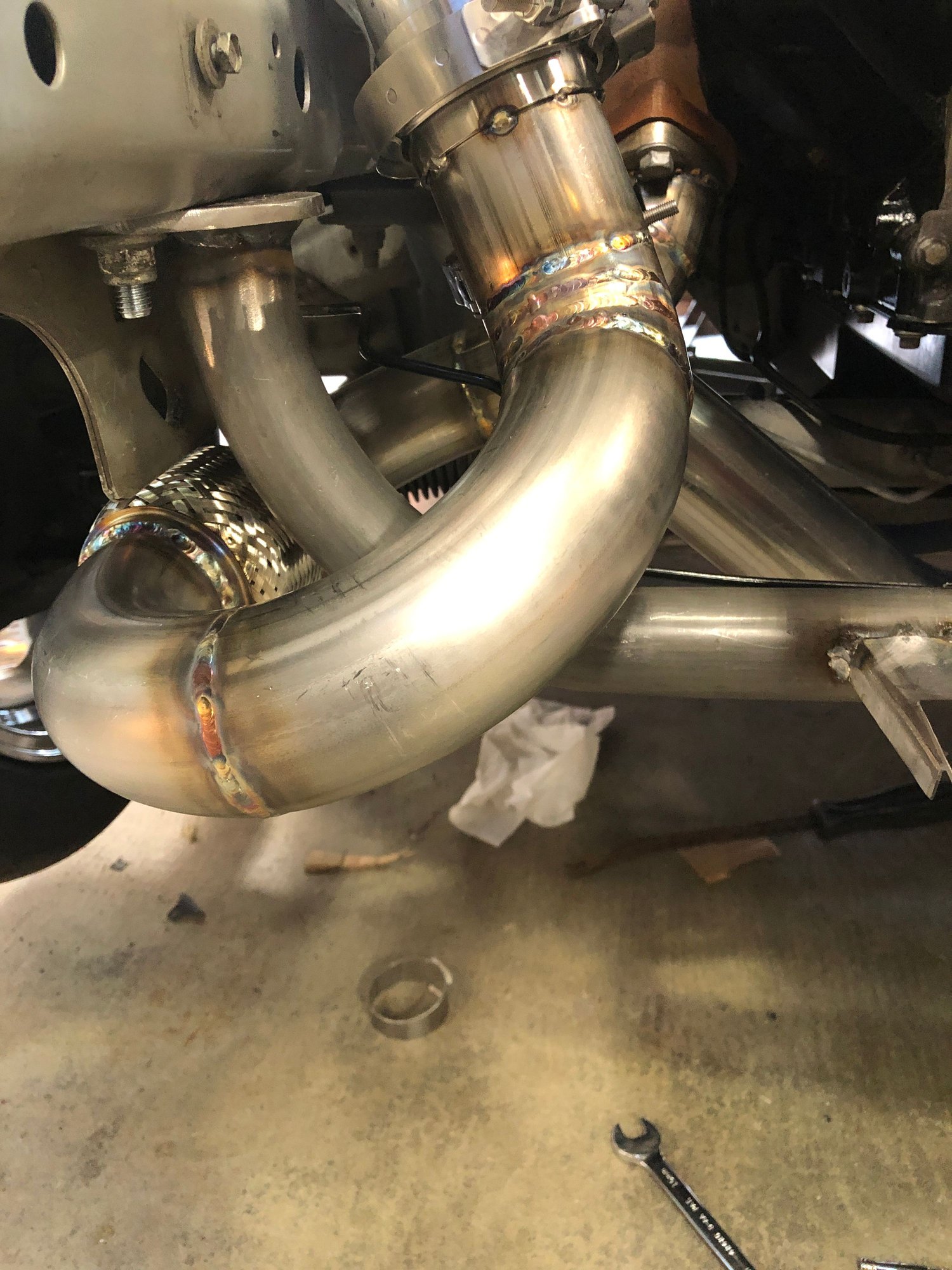

Build an exhaust and buttoned everything up.

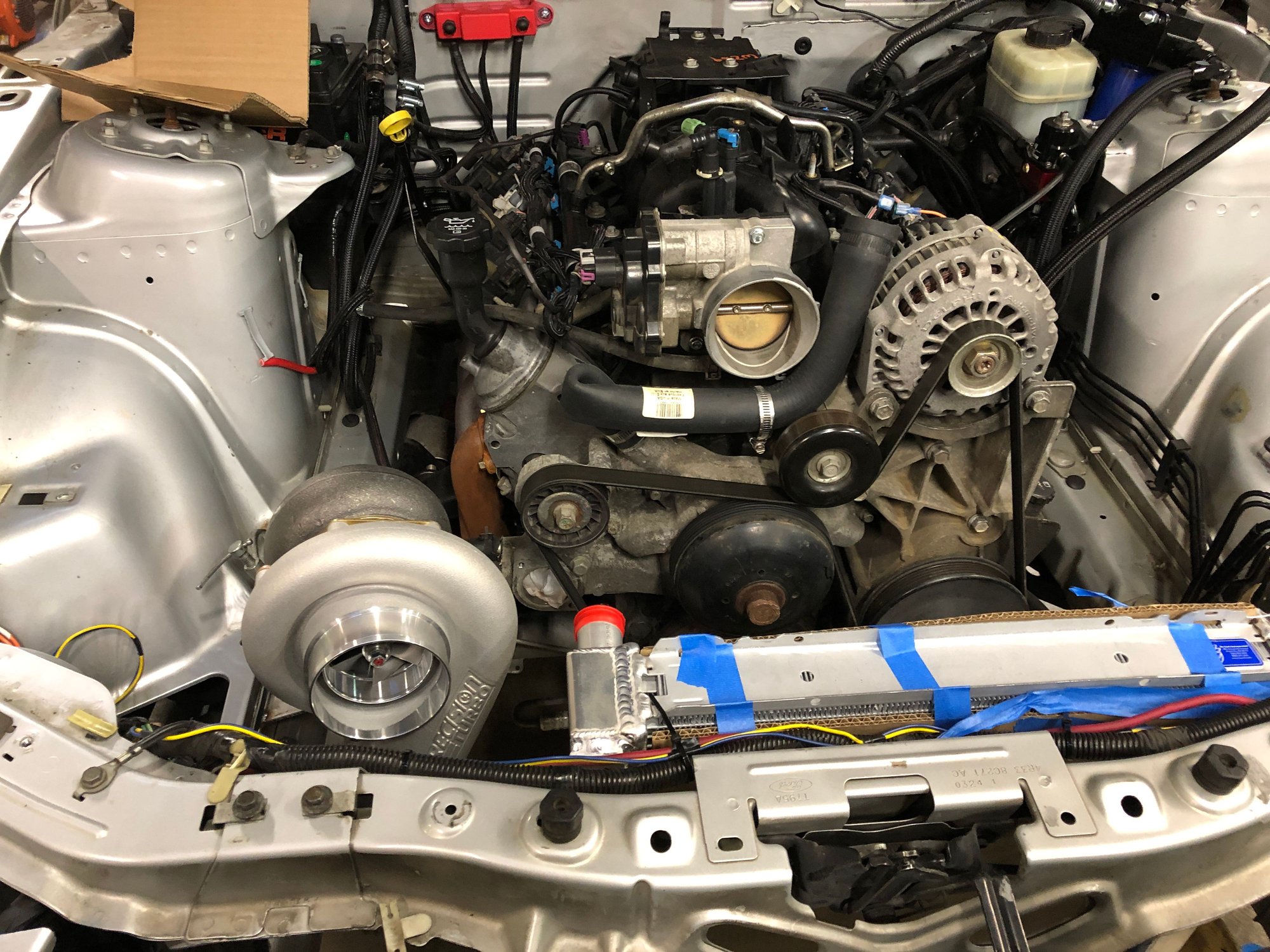

Turbo Time!

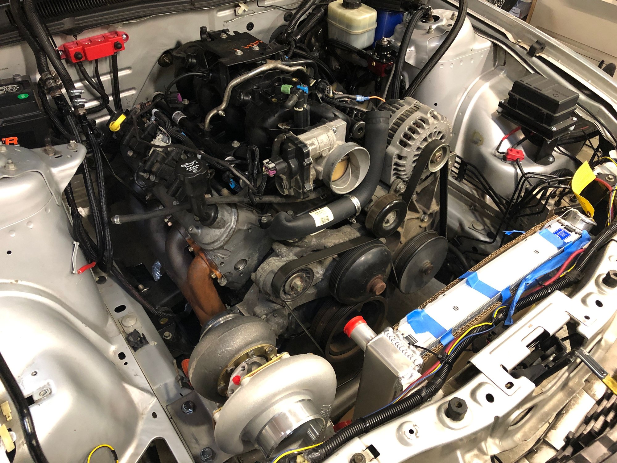

Decided to go with the 'merica kit from Motion Raceworks. In my option its a very good DIY kit with quality components for the price.
Comes with:
PT7675 .96 AR
JGS Wastegate
JGS BOV
Hot and cold side kit with flanges and vbands

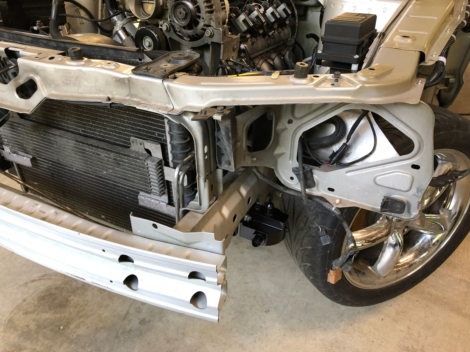

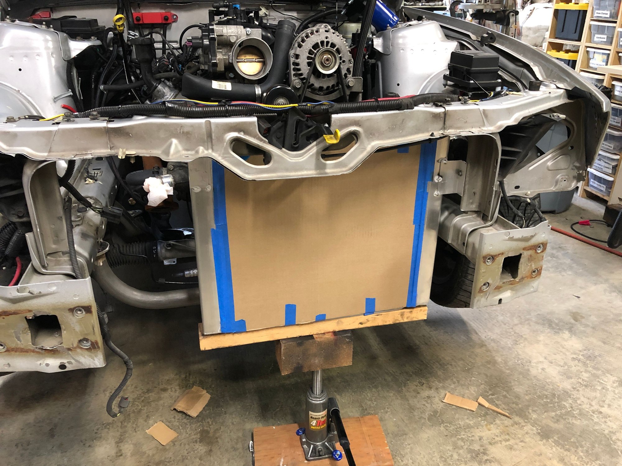

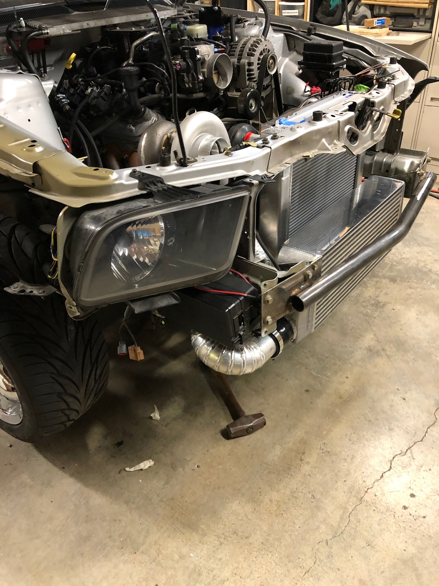

I need to get some stuff out of the way to make room for the turbo.

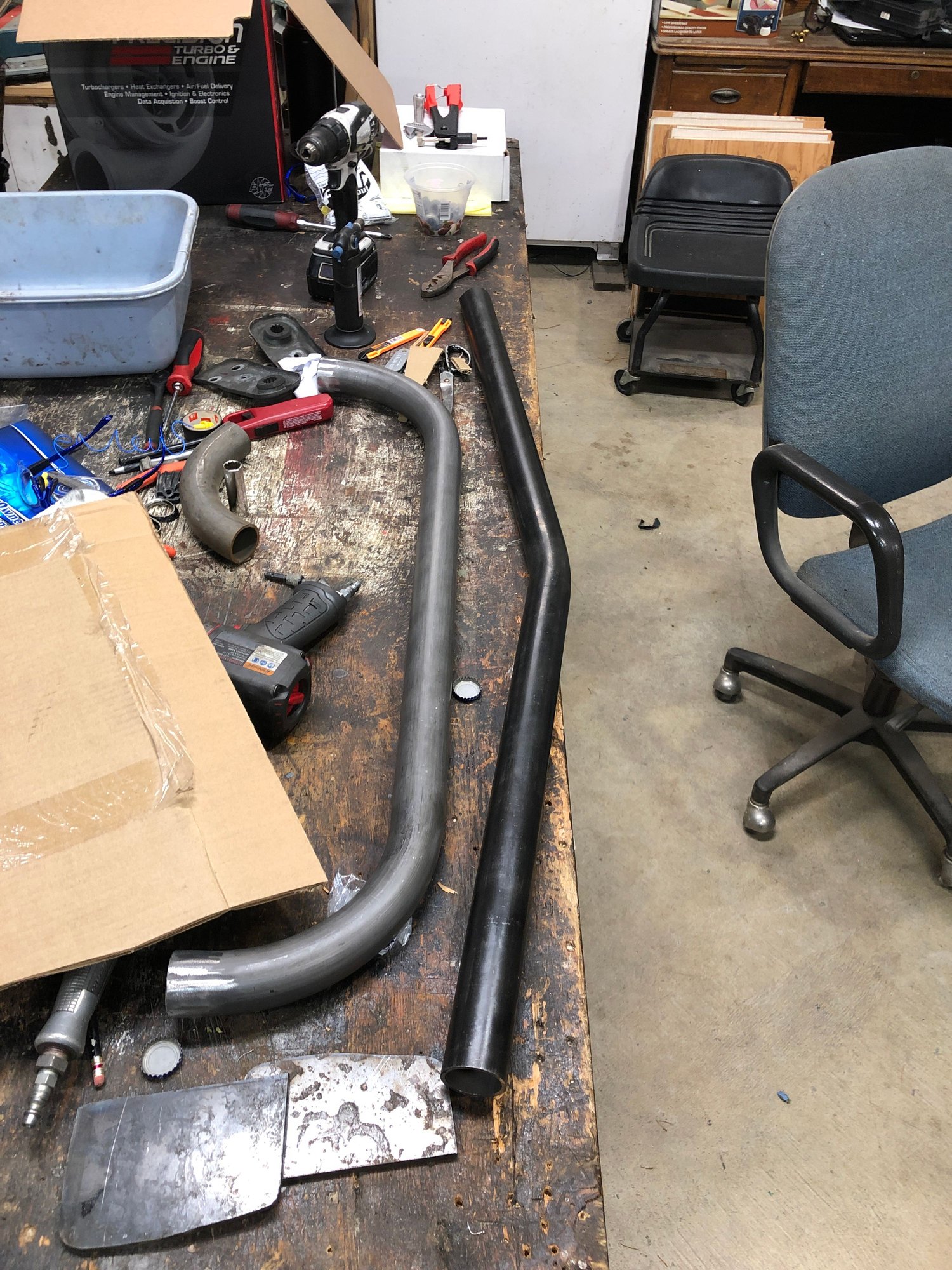

Bent some tube for a front bash bar and lower sub frame.
Removed the factory radiator and went with a aftermarket dual core.

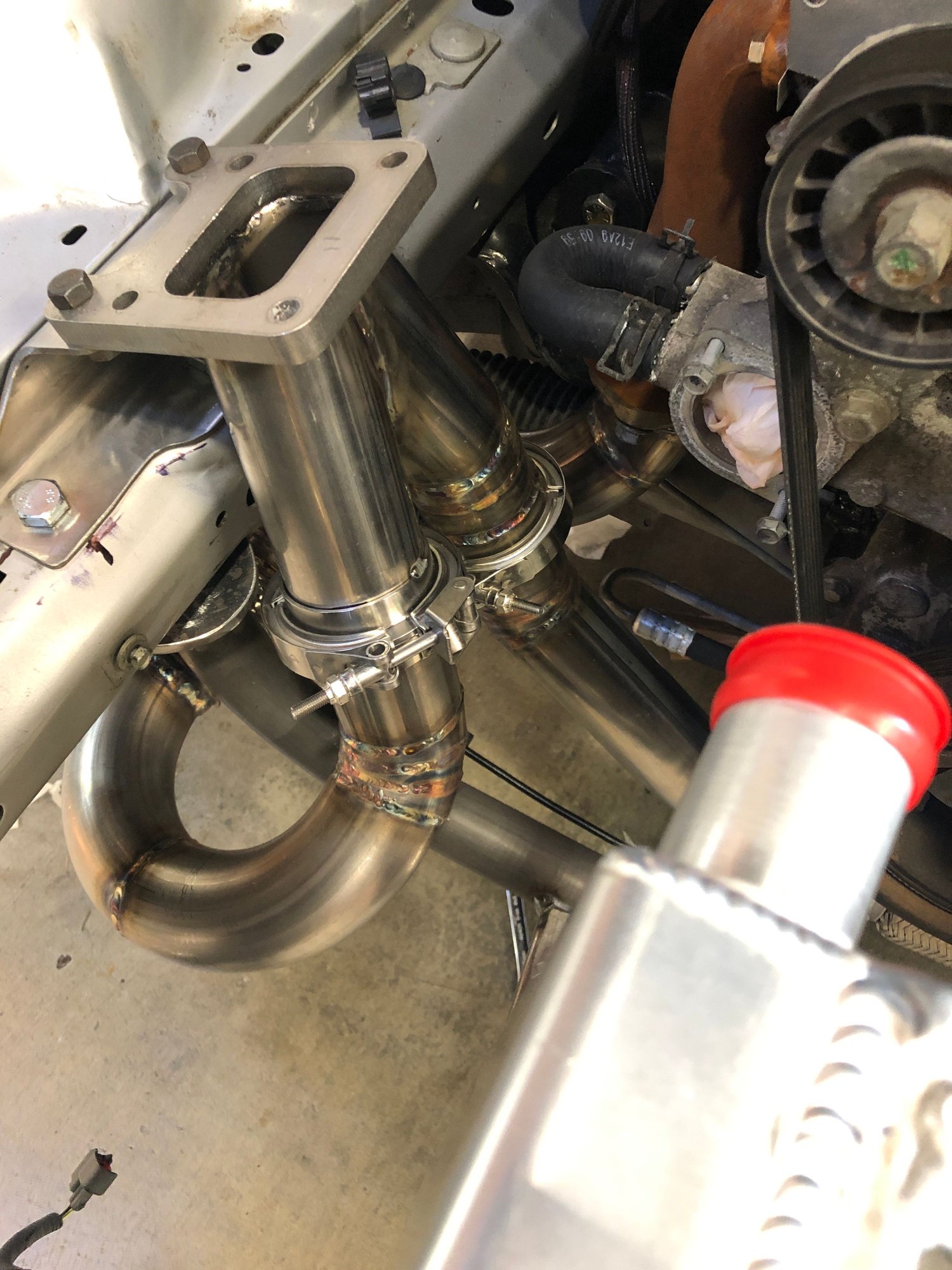

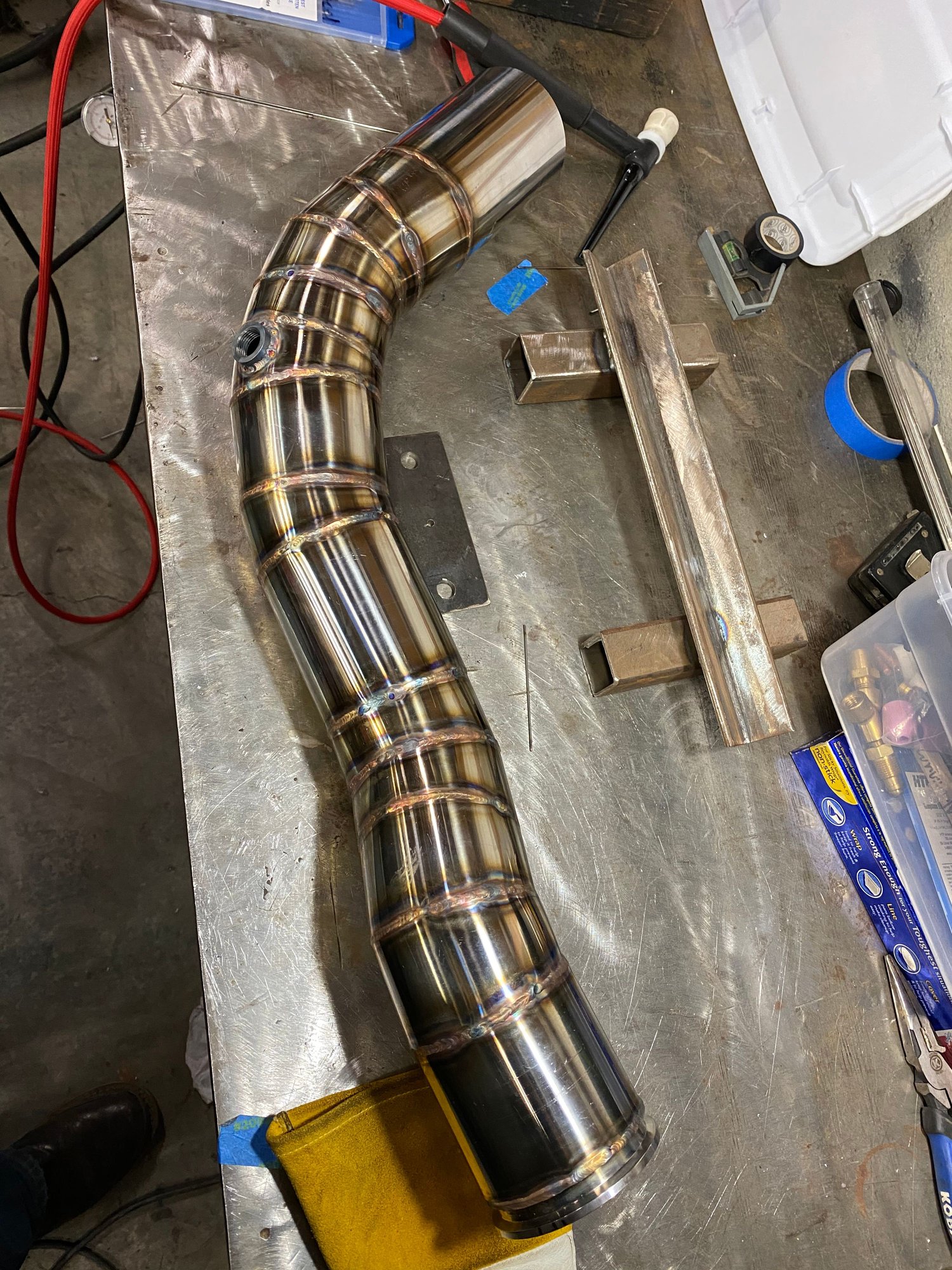

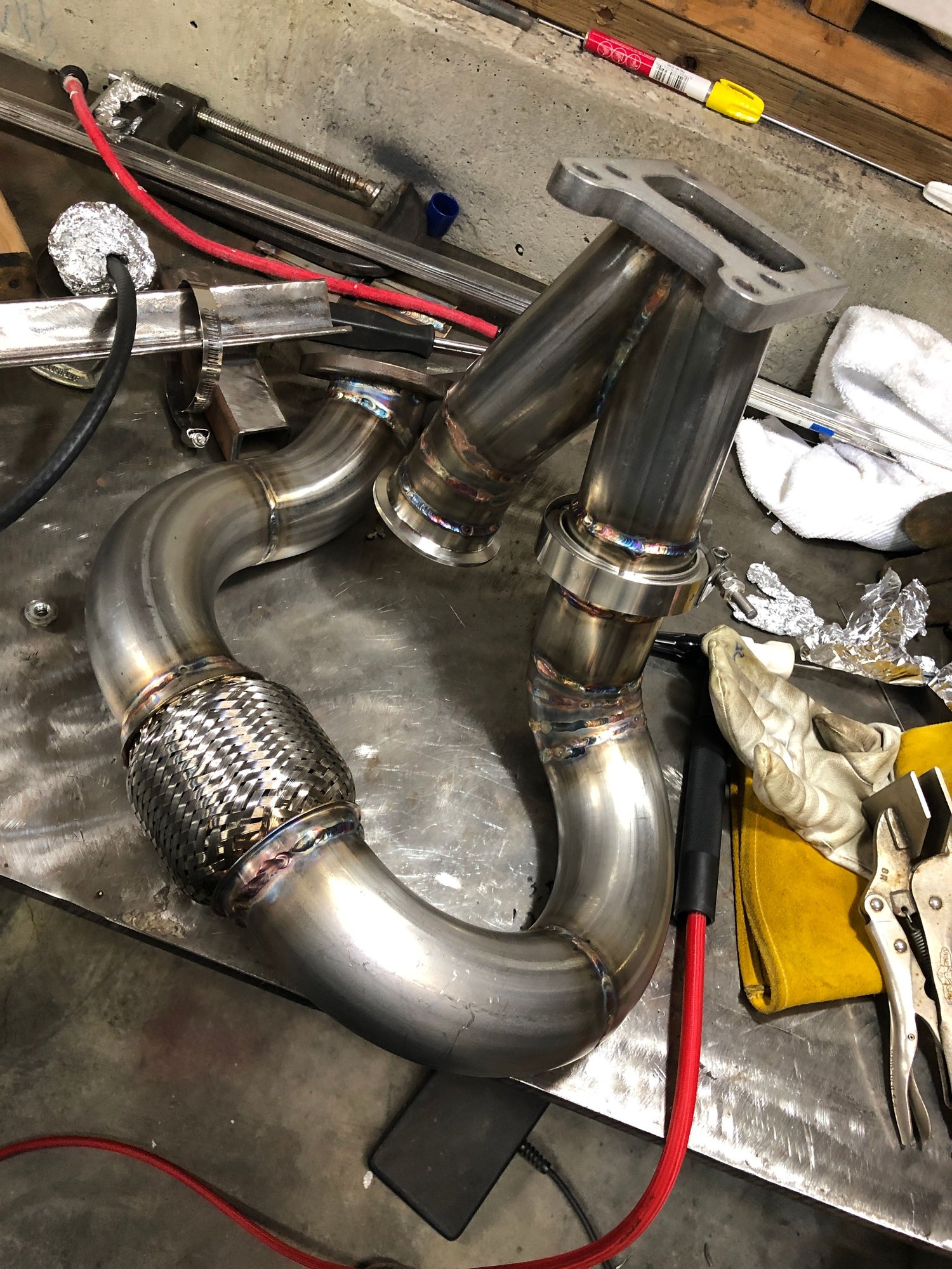

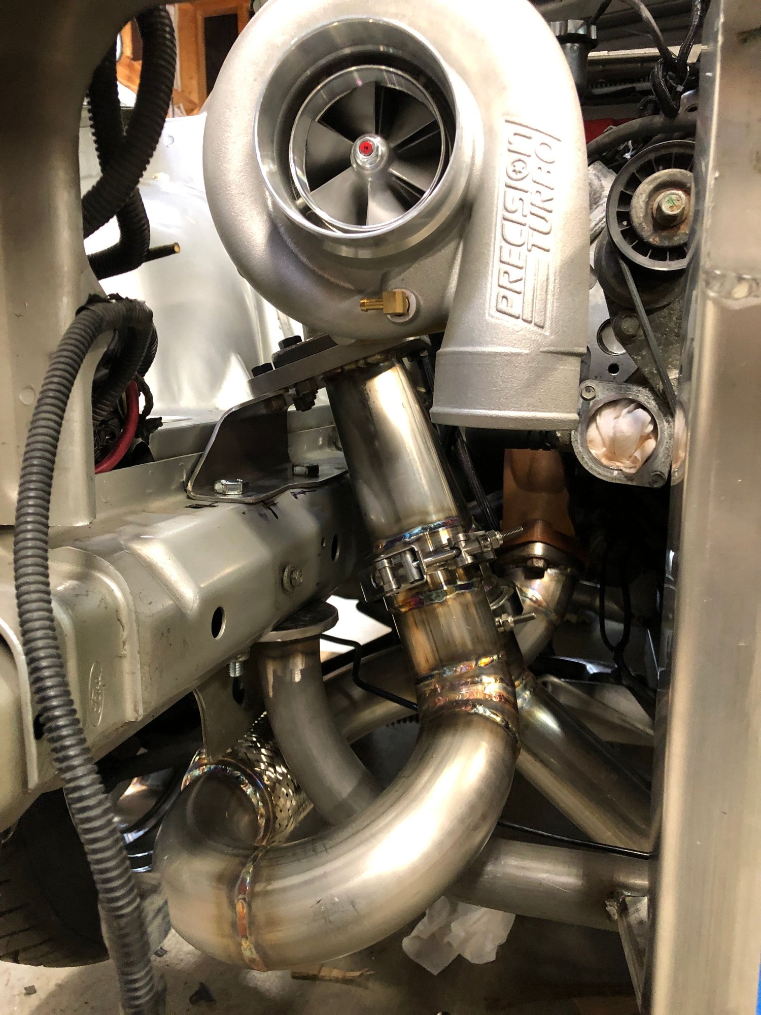

Build a bracket for the turbo, then started cutting some tube and pie cuts. This project would have sucked without a metal bandsaw. Luckily I scored a old one off craigslist for $100.

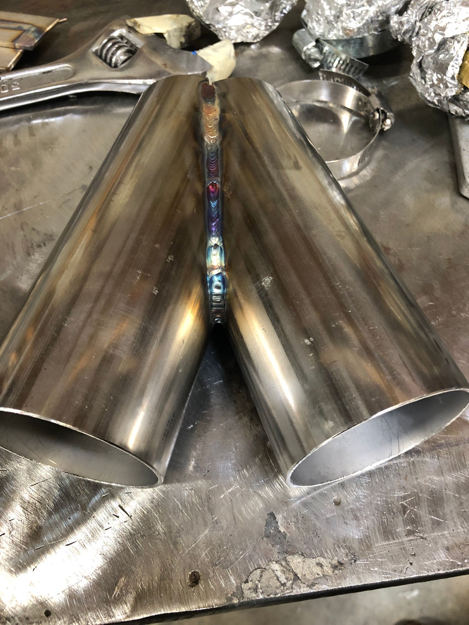

TIG Time. I've been welding as a hobby for a few years. Pretty happy how most of the welds looked. Everything was back purged as well.

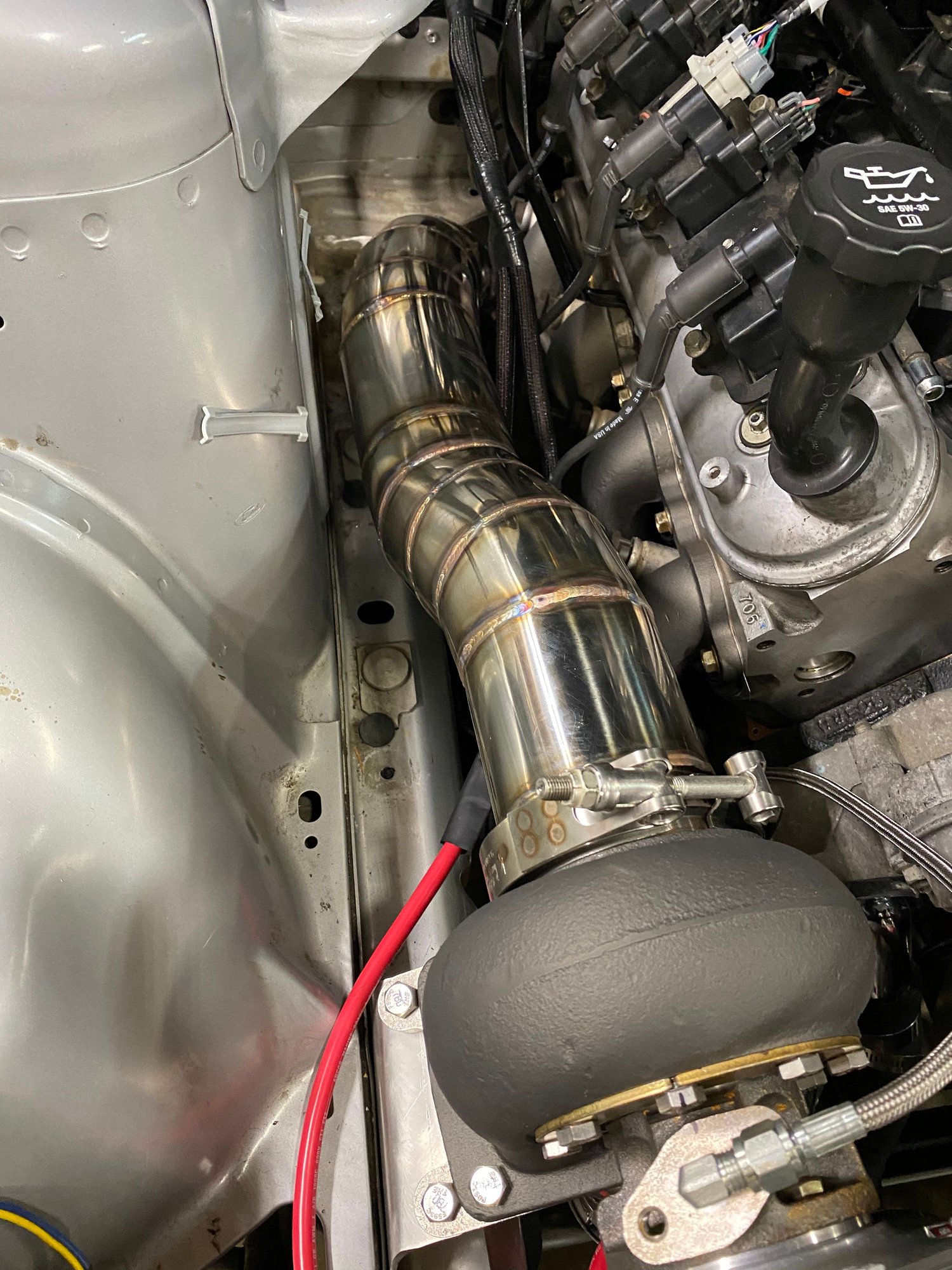

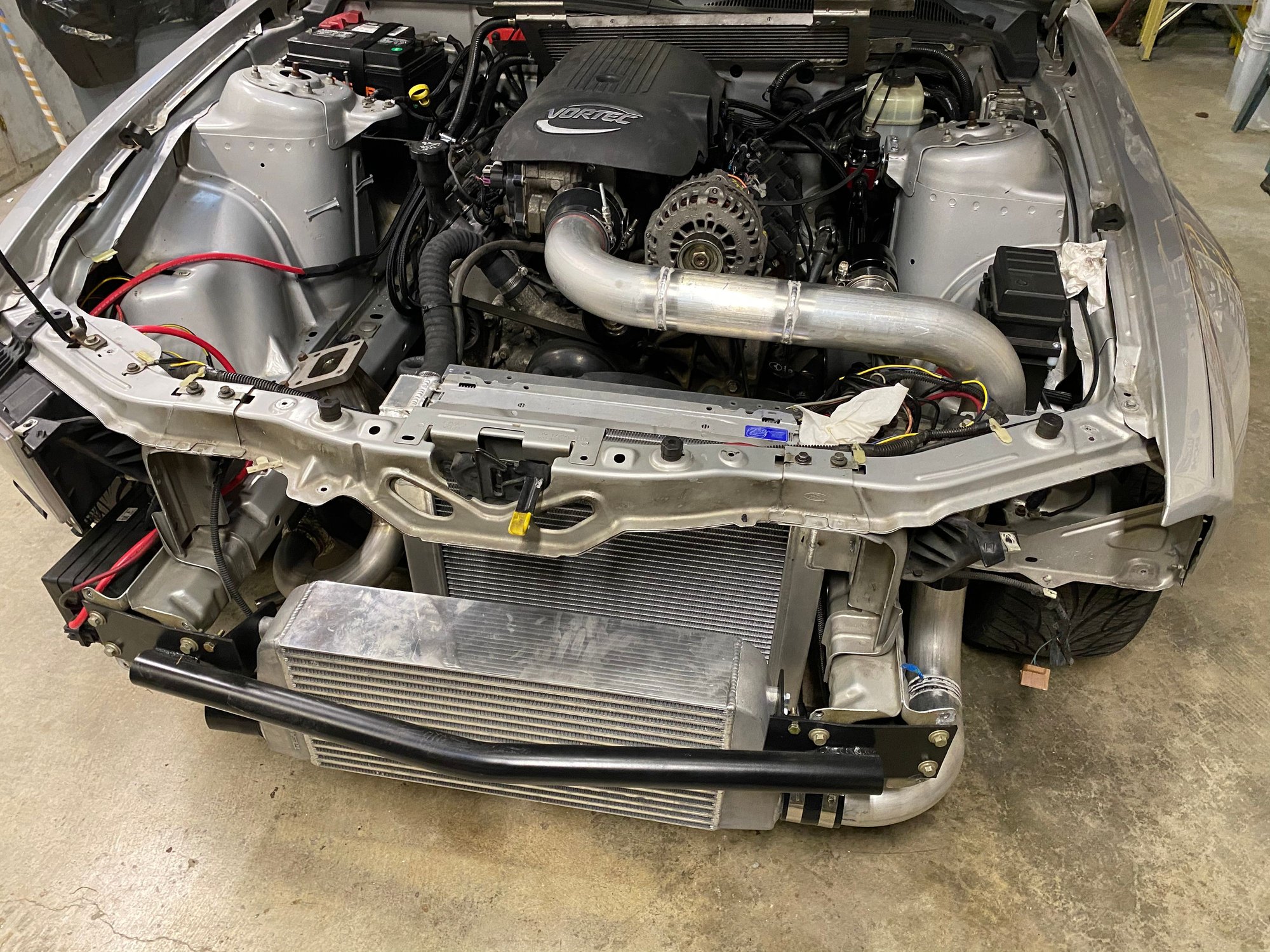

Picked up a Treadstone Intercooler and built all of the charge piping.
Put High temp Cerakote on the exhaust manifolds and turbo housing.

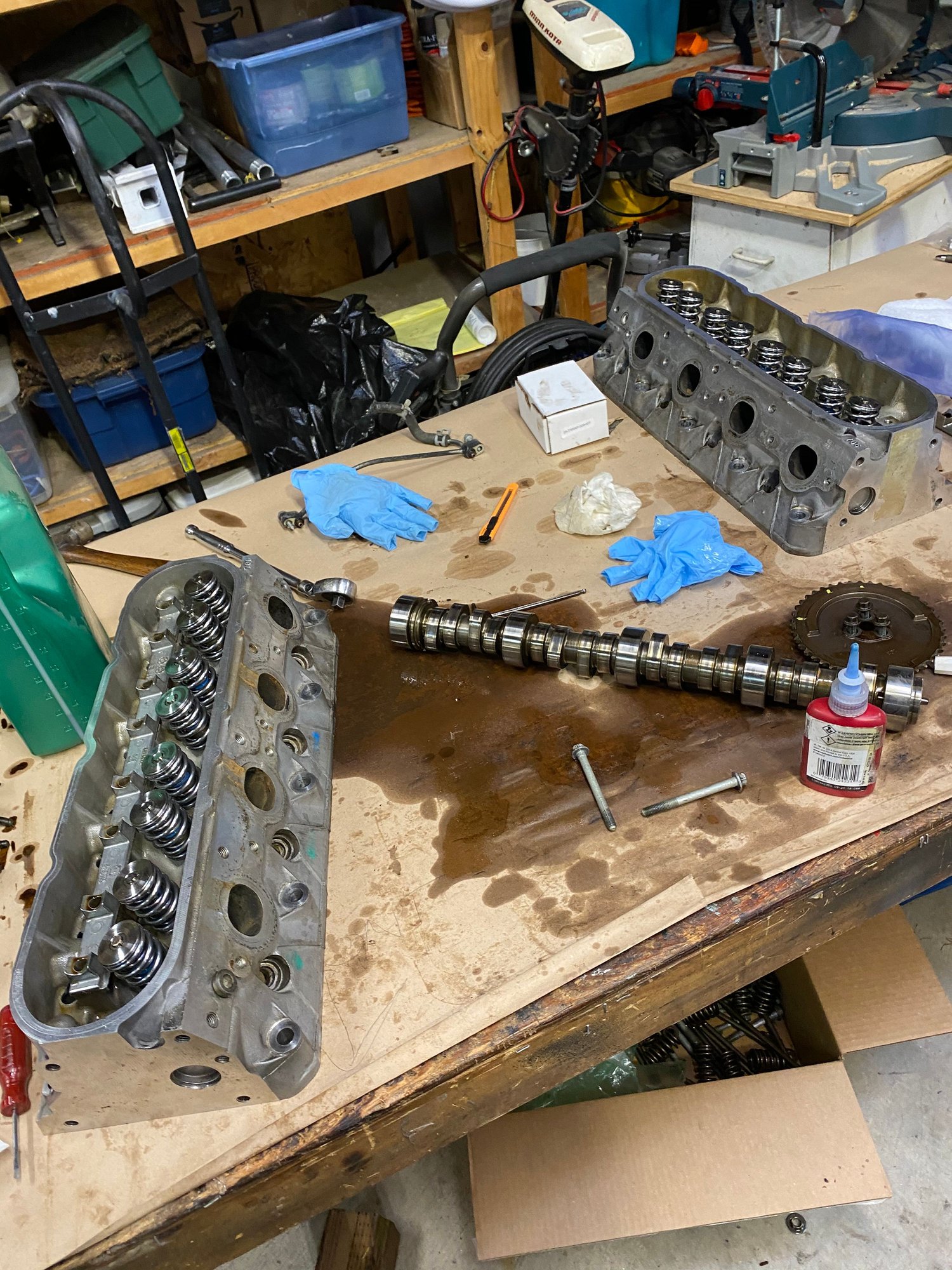

After the turbo stuff was all built, I pulled the engine for a Cam and Stall.
TSP Stage 2 Turbo cam with springs and retainers
Arp Head studs
3200 Circle D billet stall
Swapped out the pan with a Summit racing pan with the filter housing built in. The remote filter was a pain to deal with. Everything had the same dimension.
After reading about terminator X, I was convinced to ditch the factory computer. Wish I would have done this from the beginning.
With the terminator X I converted over to Cable throttle. Luckily a company makes the cable pedal conversion but you have to delete your windshield wipers.

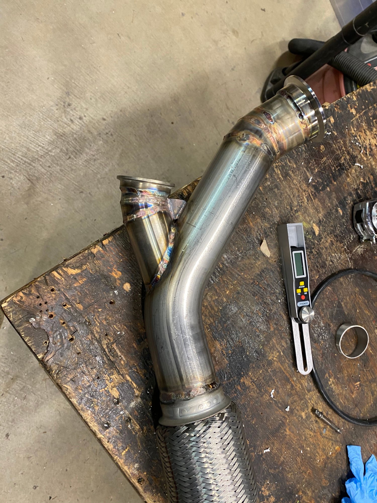

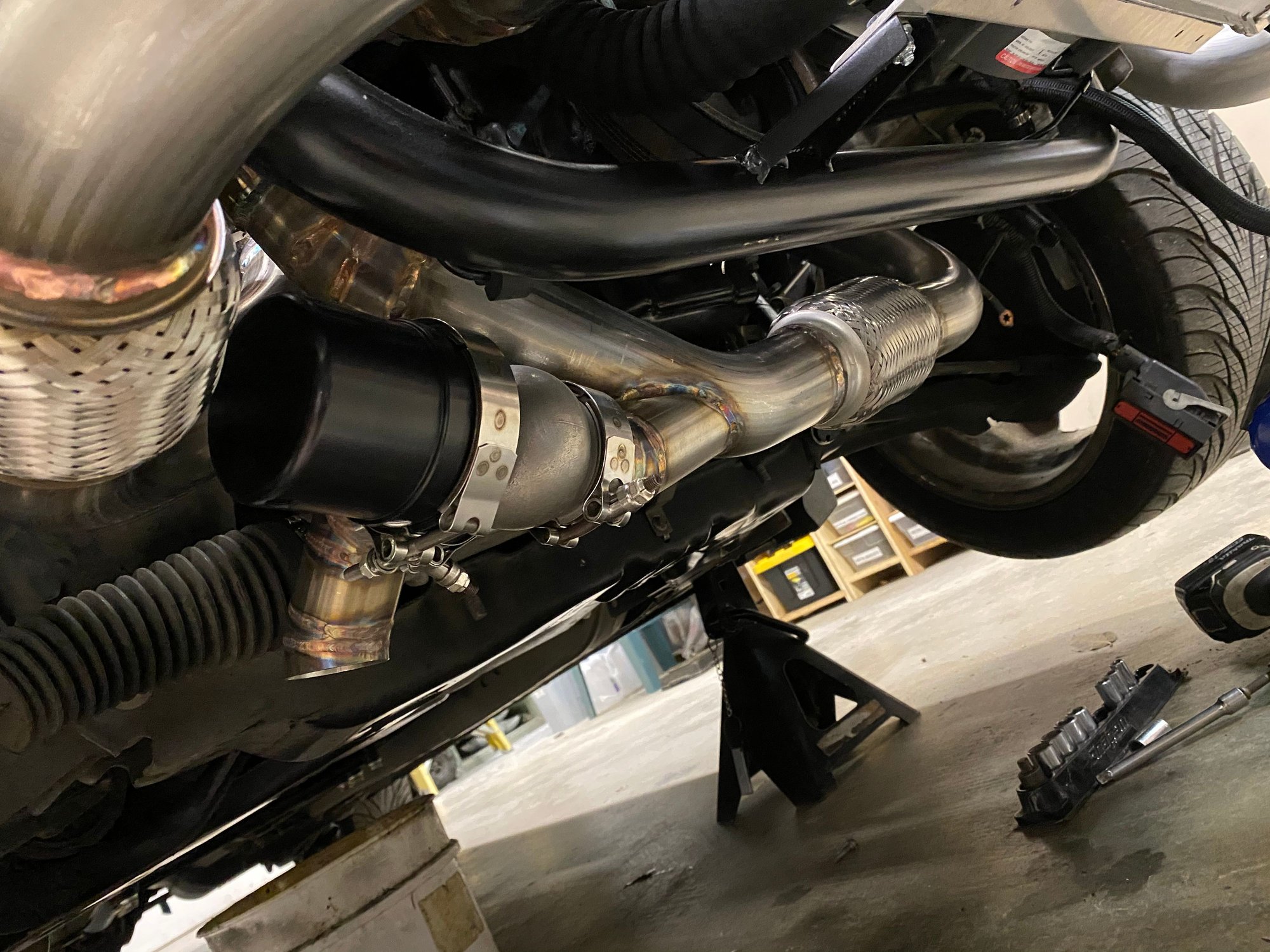

Downpipe done.
Old Apr 21, 2020 | 04:48 PM
02b4ccamaro's Avatar
Joined: May 2008
Posts: 157
From: new orleans, la
damn that down pipe came out nice !!

Those S197s have a lot more room under the hood than the Fox/SN95 platform cars. The downpipe routing is still obviously tight, but the truck accessory drive and intake manifold don't clear the stock hood on the older cars. Pretty cool.
