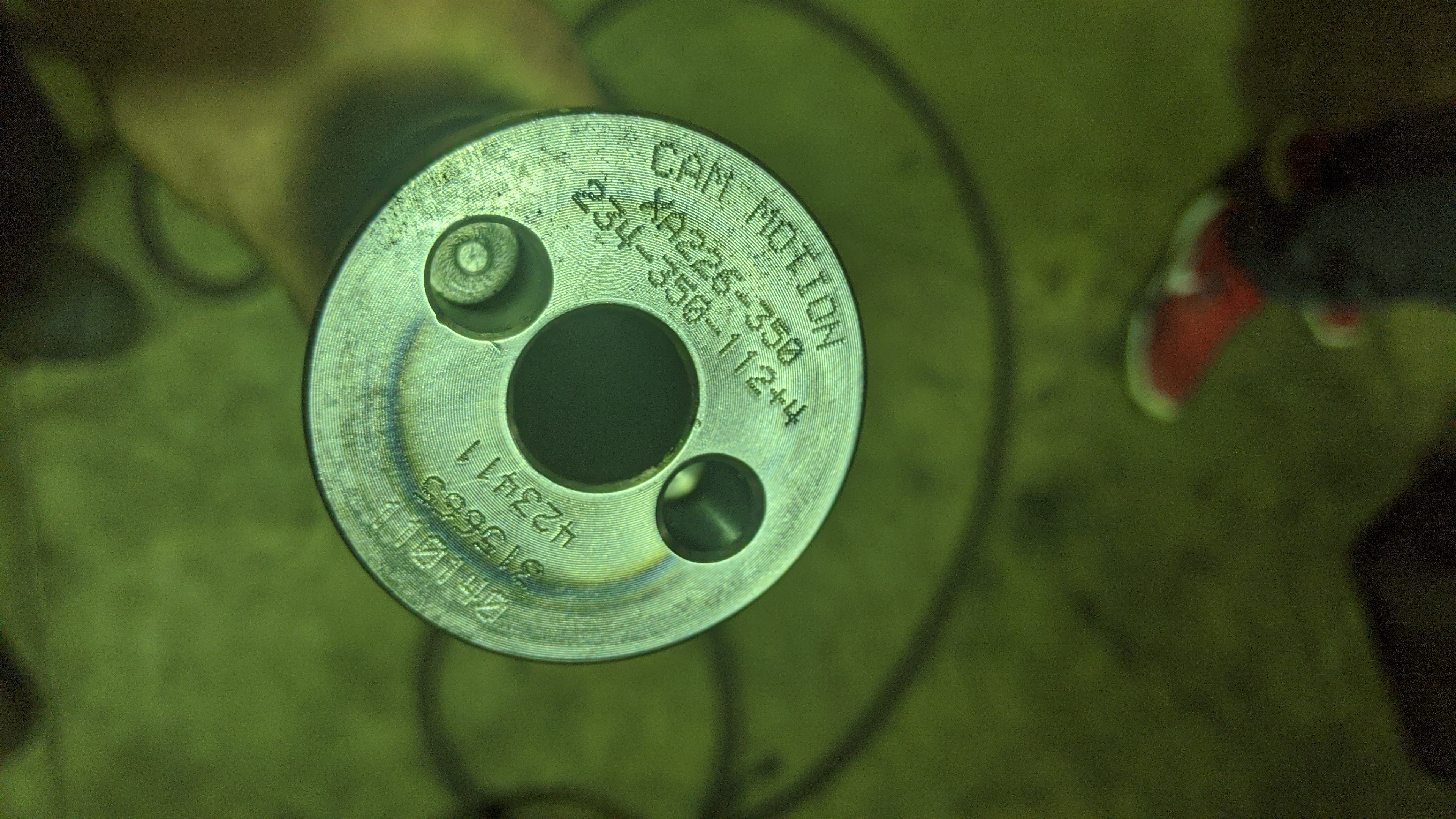

Cam motion camshaft and double valve springs being installed

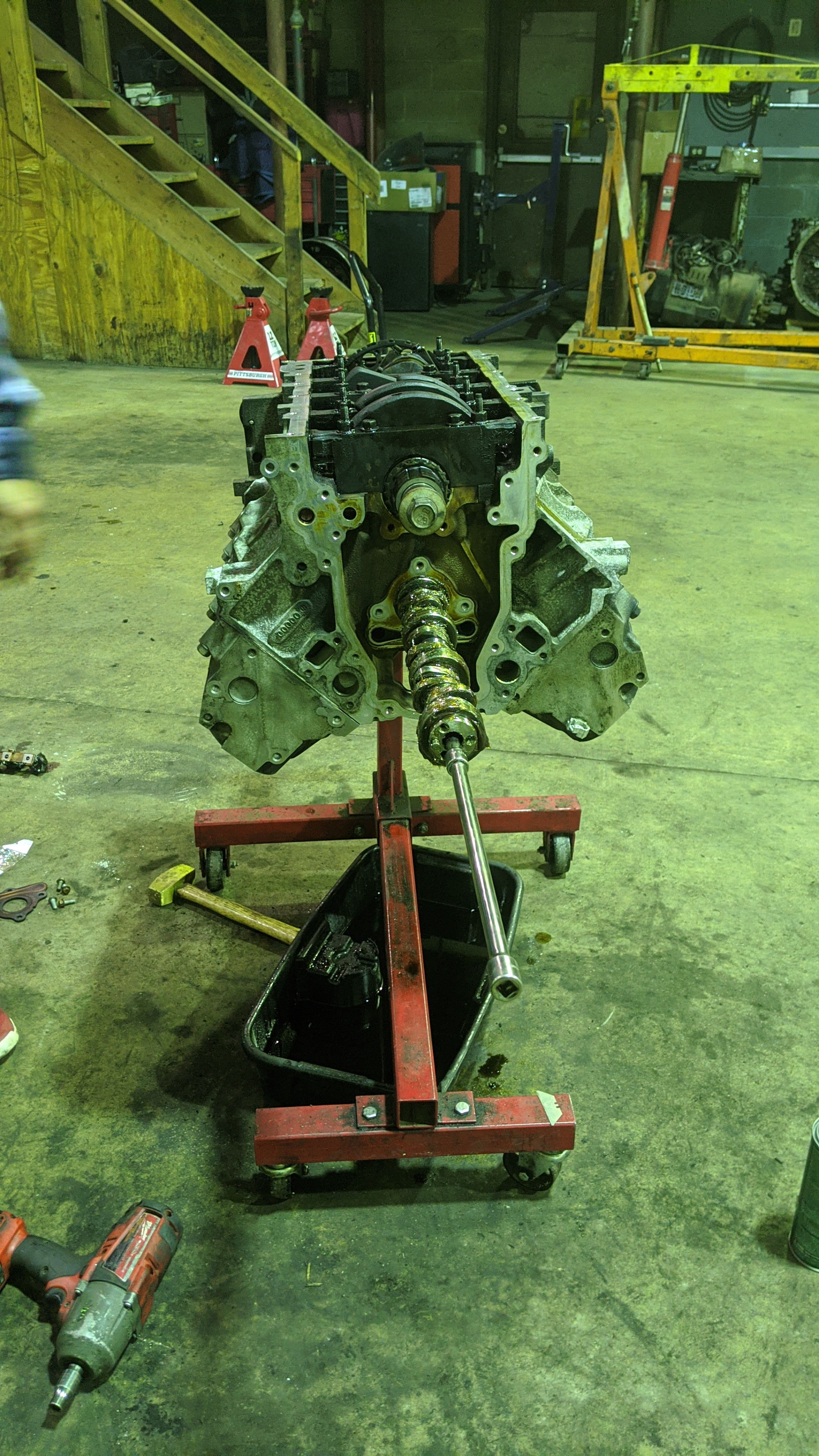

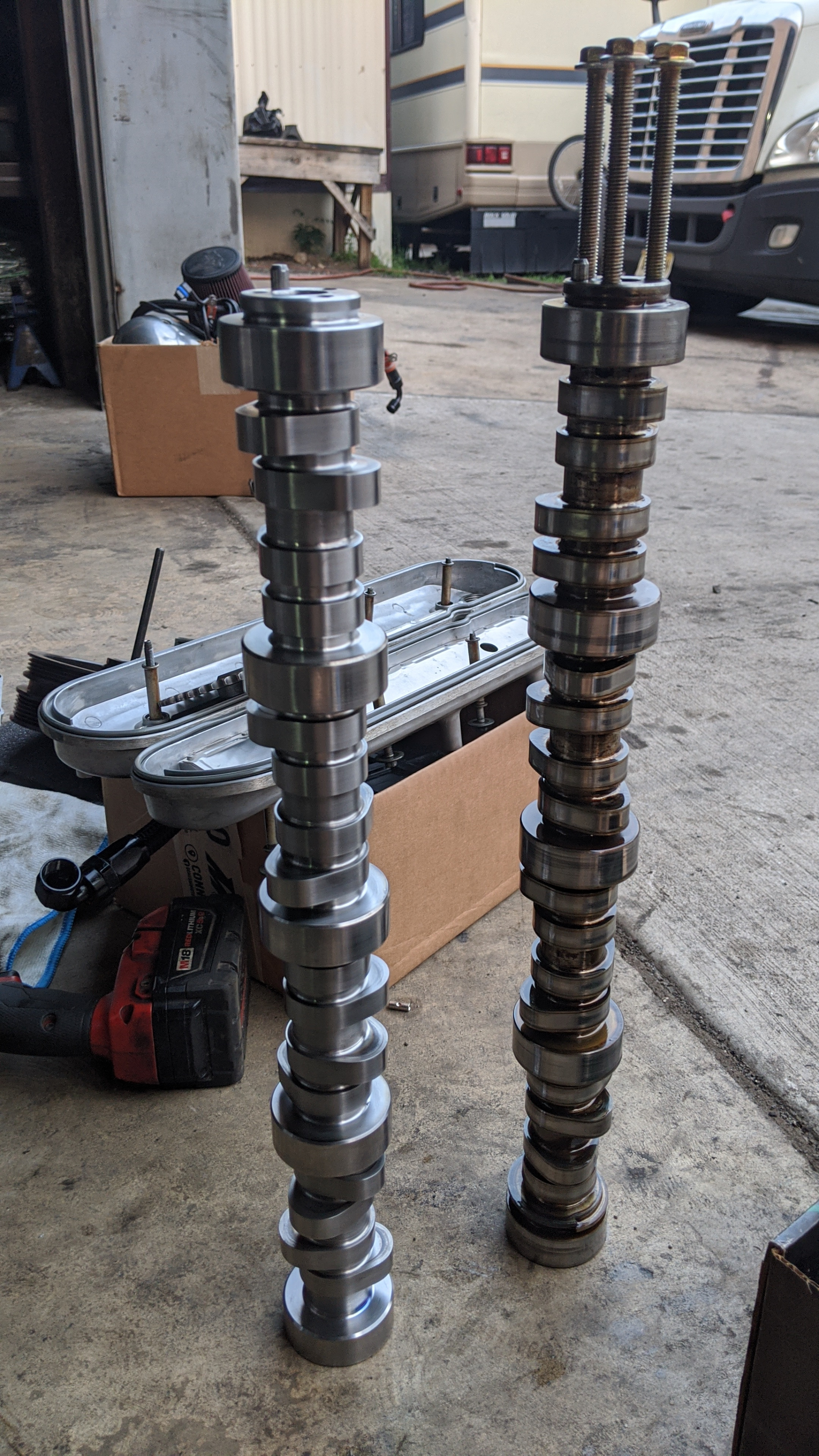

I put the LM4 back in the car but I decided to try an LS9 cam .The cam motion cam from my L33 is too much cam on the LM4 because of the lower compression and "shitty heads", I just can't word this better.
I already had all the parts to do the swap and the cam is only $130 and has a stock idle so why not. The LM4 doesn't serve a purpose other than a trial engine until I finish the LS2 build or get another L33.
The magnet trick for swapping cams is ideal
I couldn't tell if cam tool in the picture would work and I didn't want to drop a lifter and have to pull the heads . I thought I would try the magnet trick.
I still don't trust the cam tool.
LS9 cam vs L33 cam

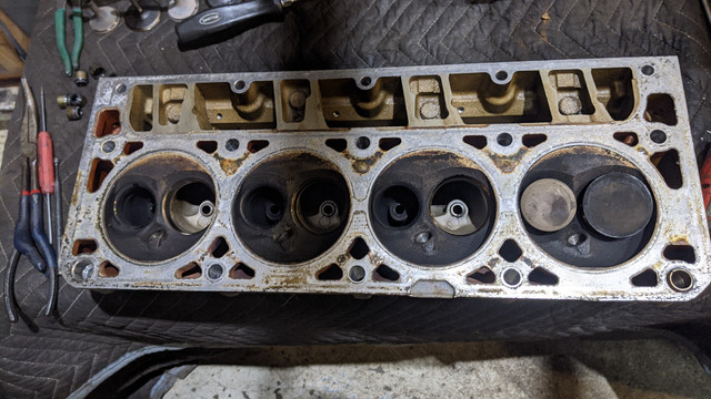

The first motor (L33) I bought turned out to have blown headgaskets cracked heads/worn cylinder liners.
The LM4 in it right now I bought to just get the car running again. I swapped around a bunch of things that I didn't like how they came out. The change to FAST 102 is to make the hood lower, I kept the single plane for another project.

Pulled out the LM4 due to excessive oil consumption and smoking. Installed the LR4.....which had a spun bearing apparently. I went back to the single plane intake.
Spun bearing in LR4 on Rod #1, the shells were on top of each other. I actually drove the car like that for a day, it wouldn't make noise until it had some load.
So all 4 used engines I bought are broken. The L33 had two worn liners, the LM4 all the liners are worn almost to the next size, the LR4 had a spun bearing, and the LFA had a collapsed lifter.
So I am rebuilding the LFA into an LS2 at the moment.
ring gap looks ok, liners have some wear...
Taking out the cam bearings
Cam bearings are shot...
Main bearings are shot too....
Installing new cam bearings
Moving onto measuring the mains
1. OEM mains out of the LFA
2. KING HP
3. CLEVITE/MAHLE H

Progress on rebuilding the LFA/LS2
Disassembling the heads.
Before cleanup
Tried cleaning with diesel, its not very effective on carbon. I used some MEK/Carb Cleaner and it still couldn't dissolve all the carbon. I didn't want to waste too much time on it so its a light cleaning.
Intake valve after using wire wheel to clean it up
Exhaust valve after cleanup. After seeing this, some lapping is neccessary even though it may not help.
Before cleanup
After lapping head surface and cleaning, still need to lap the valves...
The factory surface finish wasn't this good
