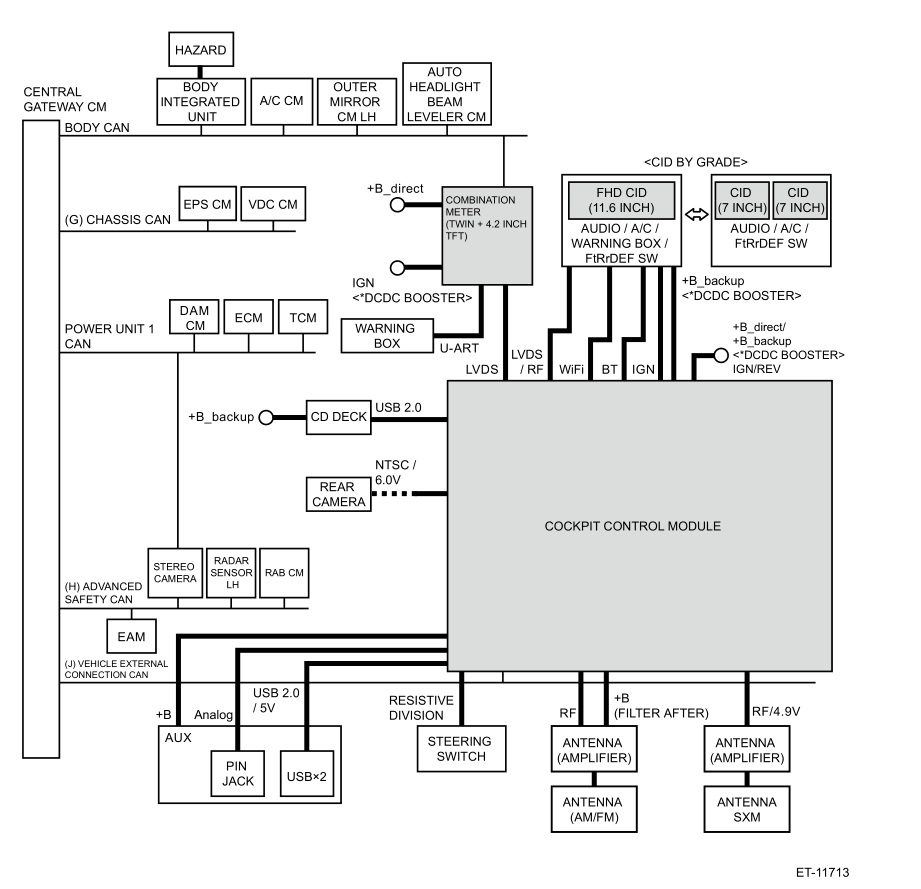

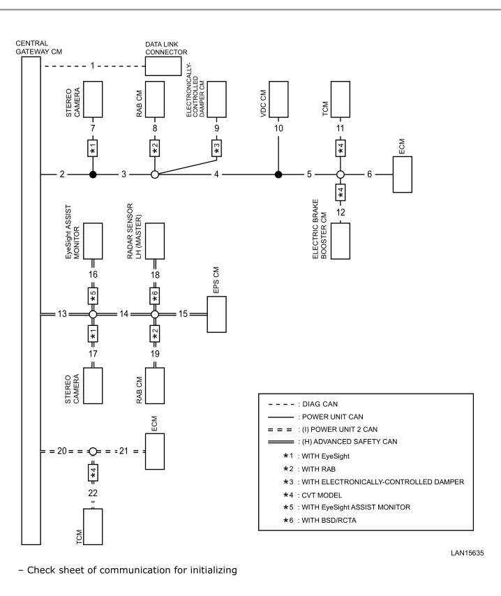

Ok, the reason there are no updates. I need to get with the modern times:
So I went and picked one up
Lots of space in front of the stock rad support
plenty to mount a decent cooling package.
13.5:1 electric rack..stock. awesome
Gear ratios wider than the widest ratio TY85 6MT USDM legacy spec B and JDM forester STi...that being said it looks a lot like the gear ratios from a 2011 legacy/outback TY75 6MT

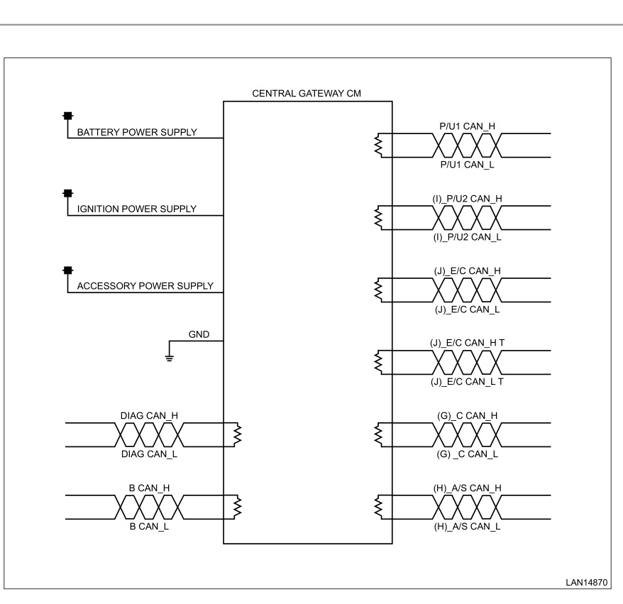

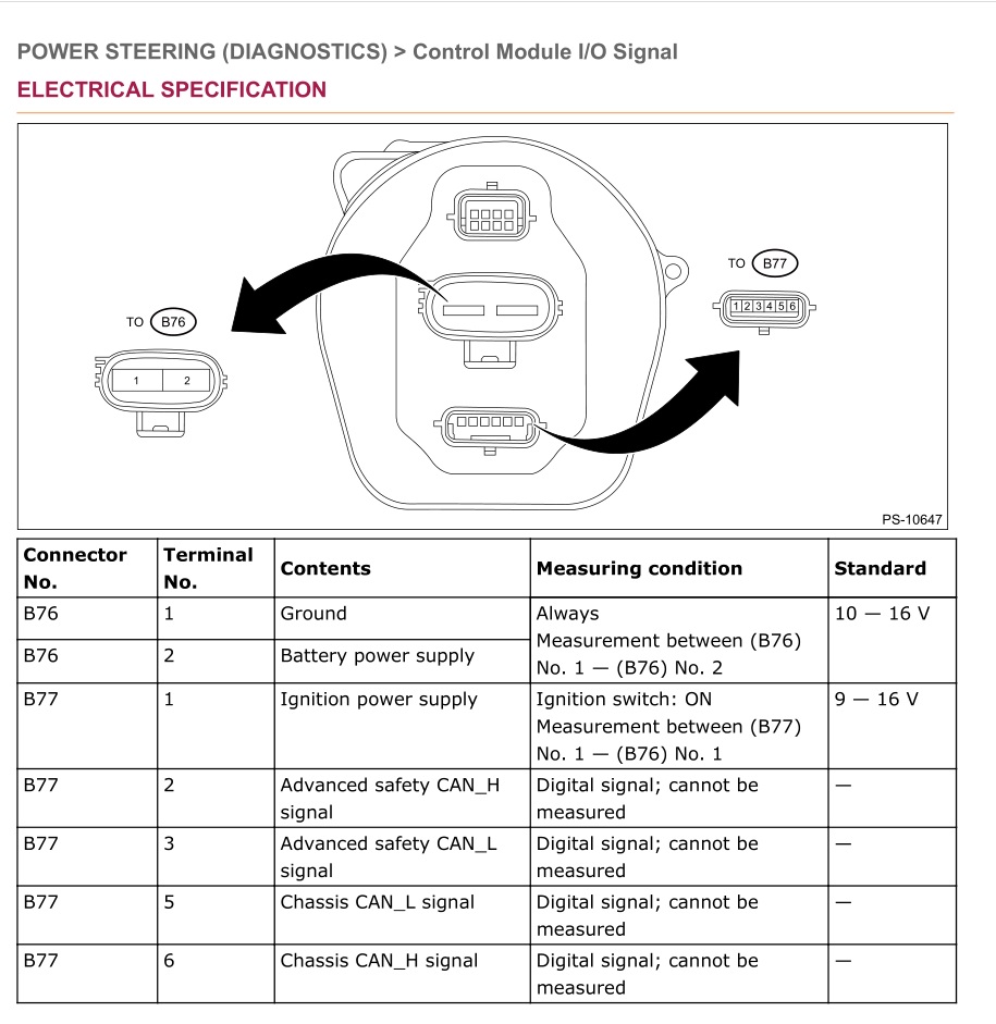

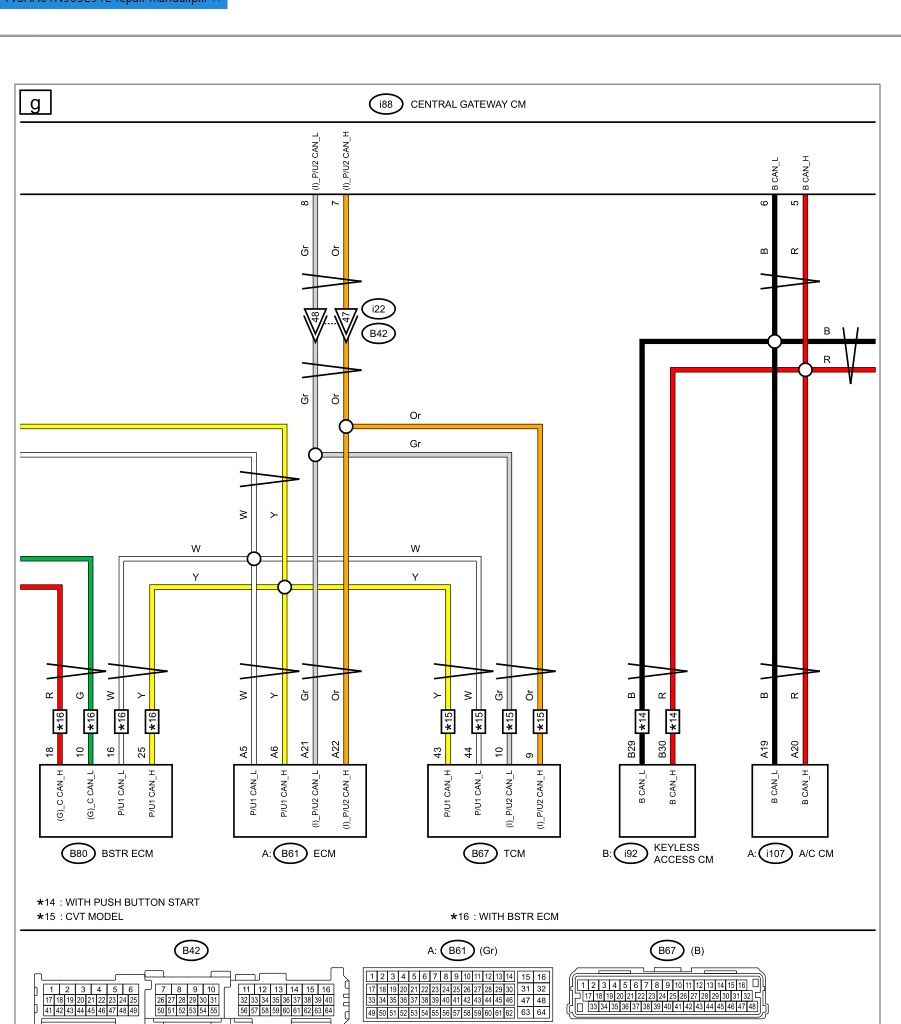

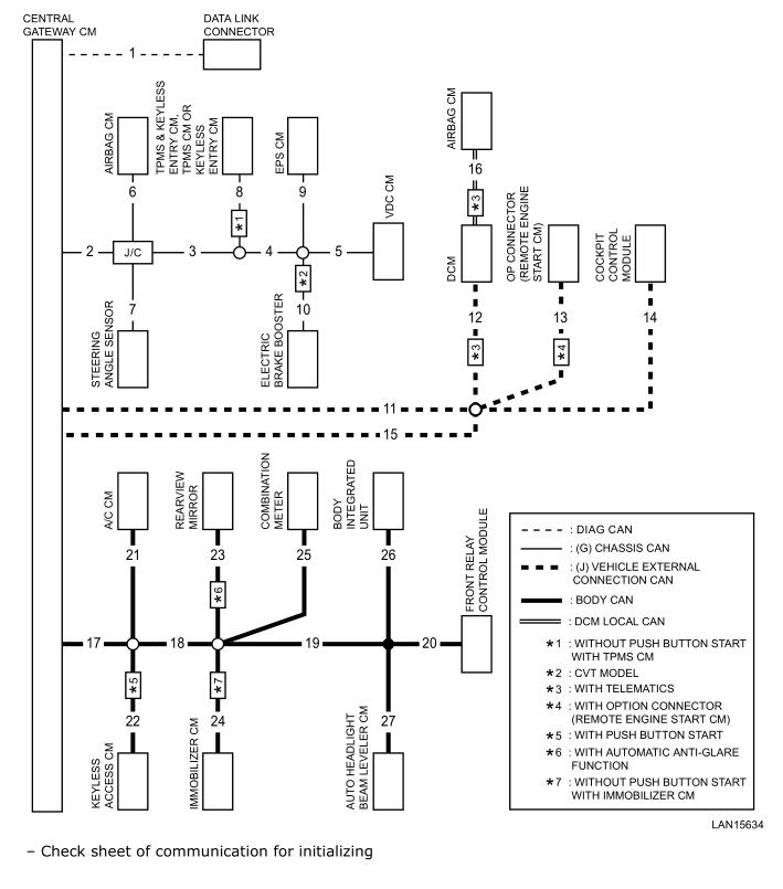

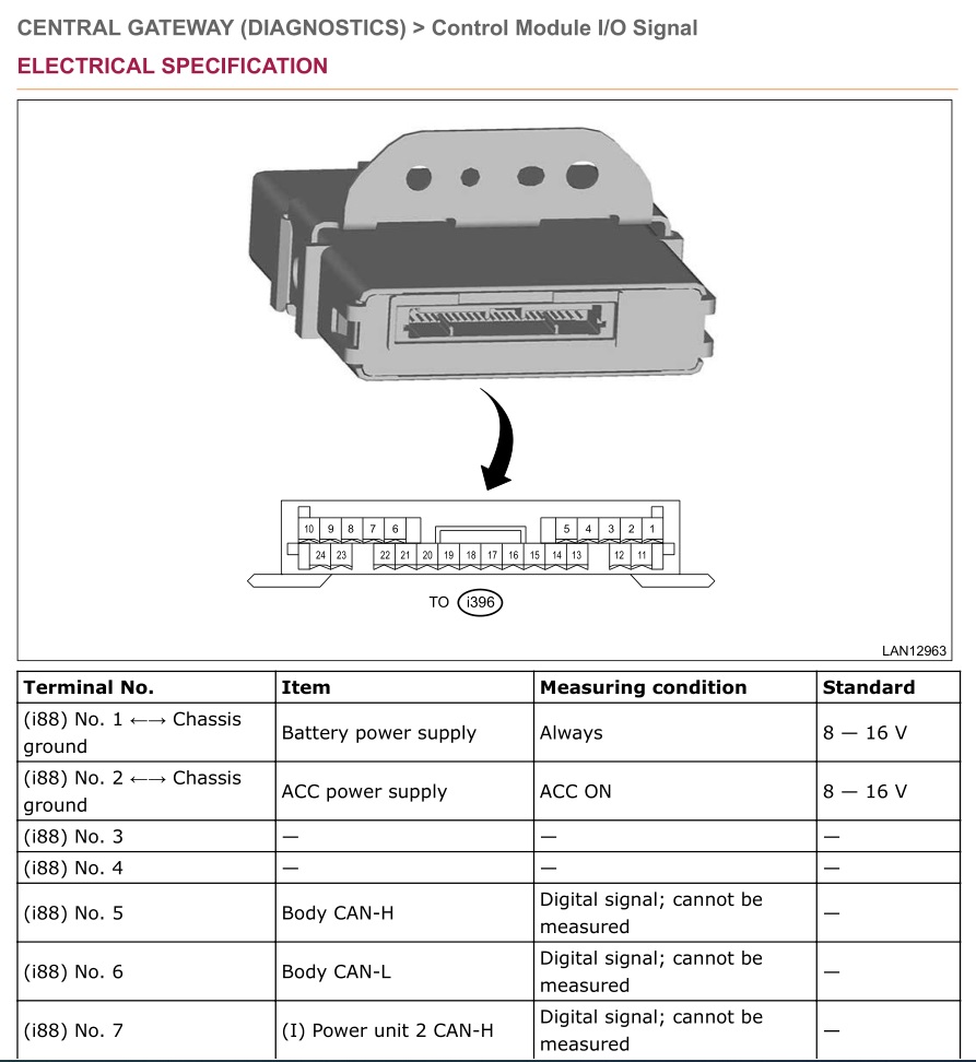

Ok now the reason I needed a new car: CAN BUS. Two CAN lines run to ECM, one CAN for things the manual version doesn't have such as TCM, and the other CAN line for things like the Radio, active suspension damper, electric brake boost, instrument cluster. The annoying part is it looks like P/U2 CAN has to communicate with the gateway to avoid faults and/or gateway translates the data to another module. I have ran into this issue before with Siemens/Continental CAN base CAN systems.
Old cars the CAN is out in the open, SGP (Subaru Global Platform) cars have multiple CAN BUS behind a gateway. This is pretty common nowadays
The multiple CAN daisy chain....
silly gateway
So now I am trying to develop a CAN emulator. I need to emulate two separate CAN lines and translate them to Analog and/or a third CAN such as Haltech, AEM, or OEM. I can also attempt to construct my own gateway and use OBD2 PID on the diagnostic end of the gateway.
In any case, I am still going to finish developing the LS swap on the GD but unfortunately I would like to start on the newer models. The SGP chassis is a huge improvement on handling for the WRX and it solves a lot of understeer issues present with the original car back from 1993.
