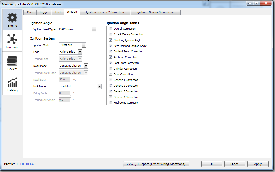

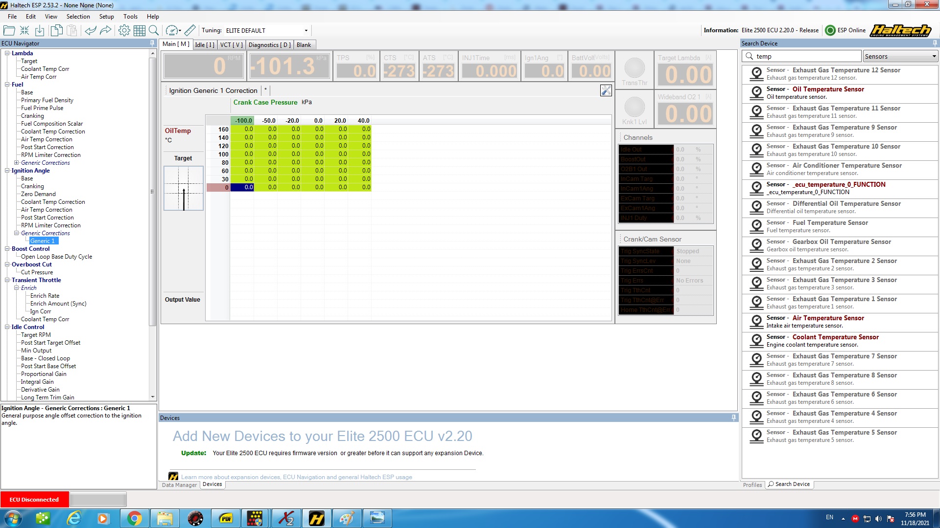

I am considering measuring crankcase pressure and using it as a compensation for ignition timing/boost/engine load. Anybody have any experience on Holley Terminator X vs AEM infinity? Not interested in simplicity, I just don't care to buy a terminator X and then reply to this thread about what it can or cannot do compared to the AEM infinity. The holley is really expensive compared to the series 3 I already own. I make my own harness so I don't consider that anyway. Any comparison between the standalone EMS from "pro tuners" has been useless because well...they have a monetary interest in their work.

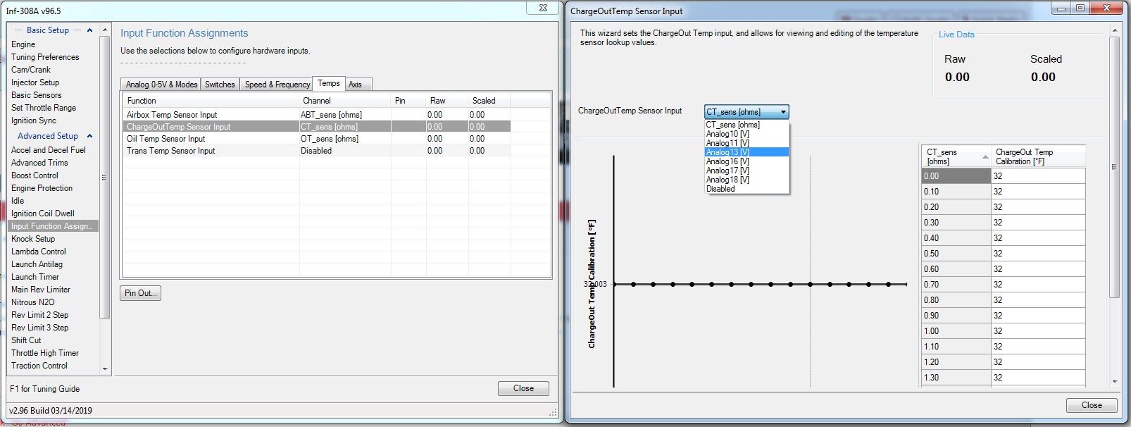

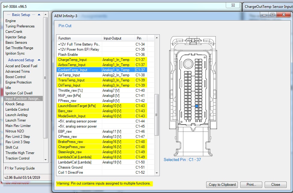

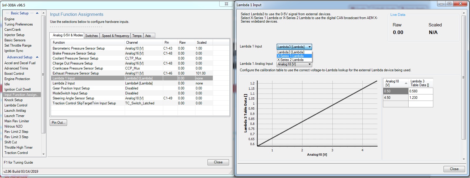

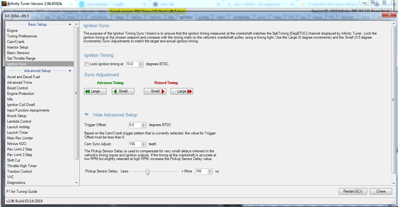

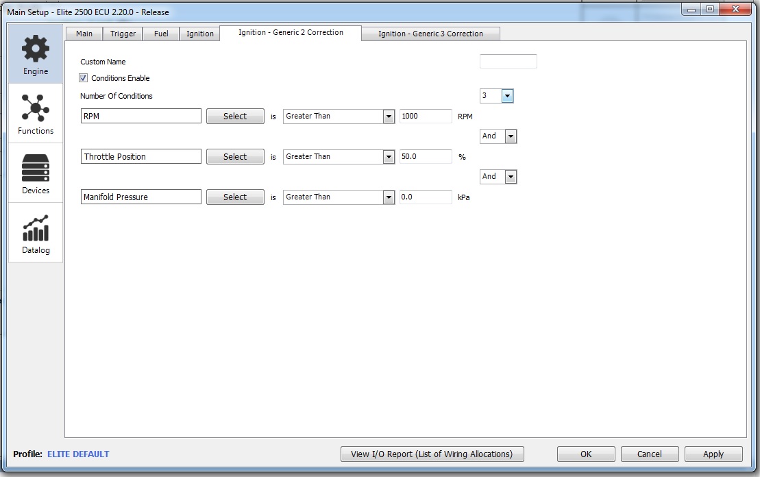

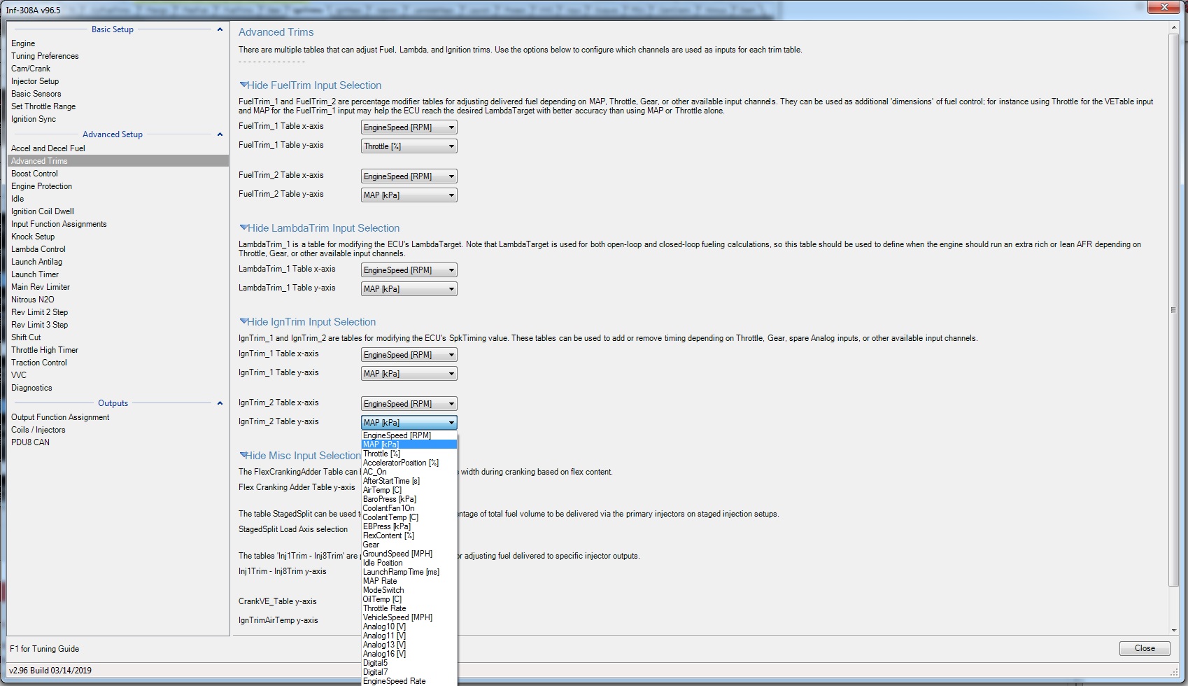

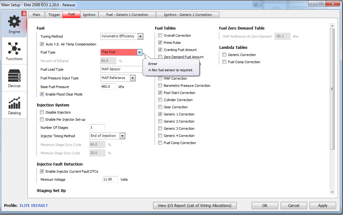

I had similar experiences with AEM V1 and V2, poor starting, bad crank sync, stock wiring causing issues, phantom misfire, software bugs, having to copy paste in to a new file to fix, unresponsive connection... V1/V2 has plenty of issues.
I don't know who manufactured those old models but the infinity is made by engine labs which will sell you an infinity for a lot less than AEM. However it doesn't come with firmware, much like Motec. YES IT DOES, it also comes with engine simulation software and a console to build your own software for running/tuning the engine, the Series 5 and Series 7 is actually an EL129. You have to write the programming yourself or buy an AEM version.
The infinity is annoyingly complicated but it has a few functions that no one discusses in detail for any EMS. Such as closed loop controls, CAN signal integration, timing sync, etc.

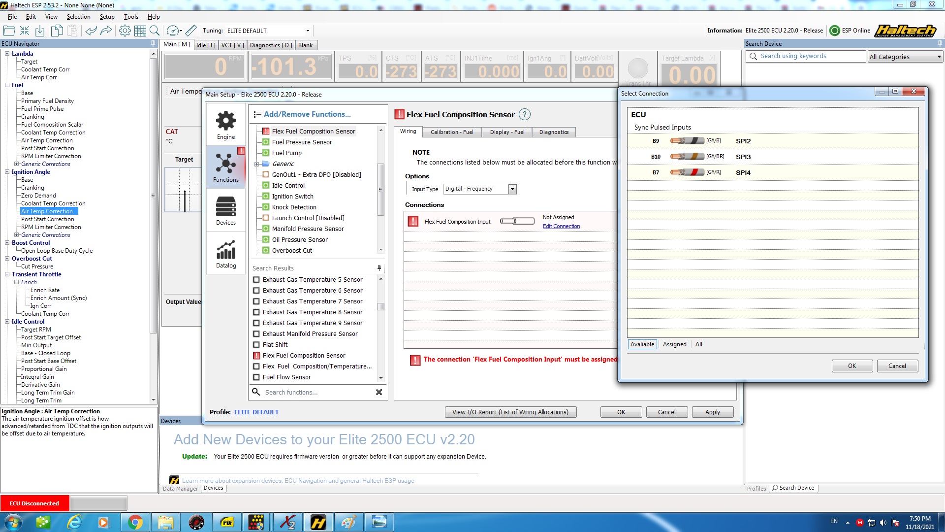

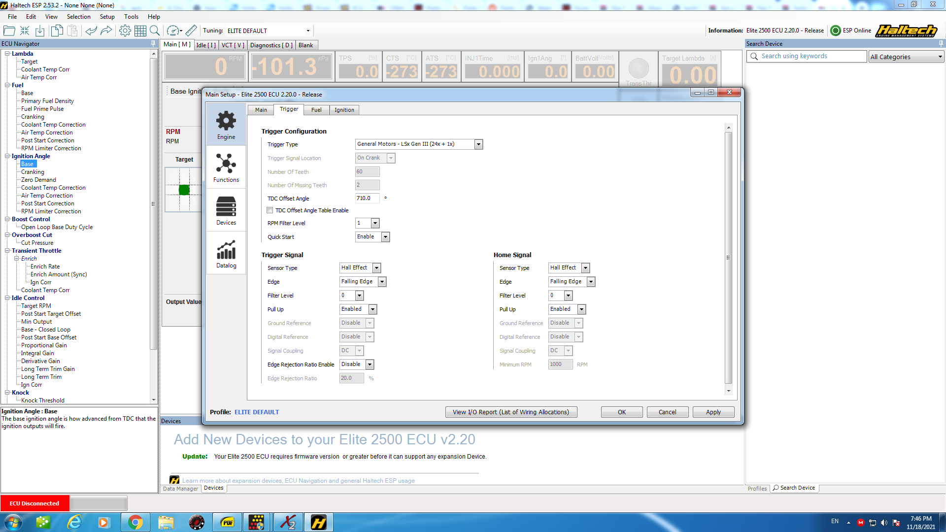

The Haltech looks promising, I've briefly used it live and didn't have much time to explore the software. The pricing is really steep though and I found the software interface very messy. To be objective, it was a 1500 and I was just trying to log fueling and adjust open loop boost control.
I know everyone praises the Holley systems because they're simple and have plenty of support. What if I wanted to change ignition timing based based on multiple compensation axis? Ie; oil temp, coolant temp, and vehicle speed have an effect on target boost, fueling, and ignition timing. Would this all be separate tables, compensation based values, or a hard cut limiter?

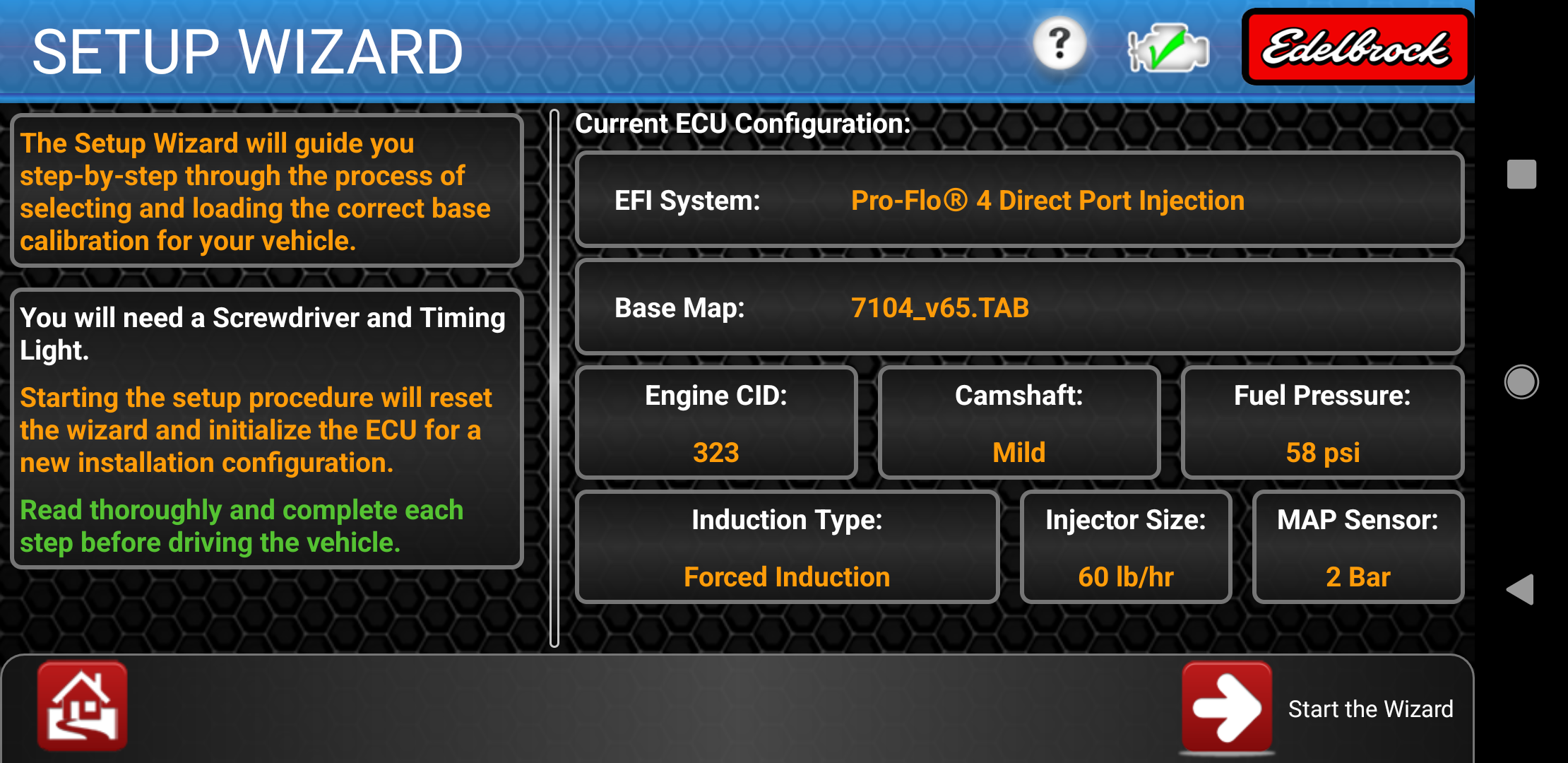

I'm trying to keep my **** box together for 30 minute runs. The Edelbrock PF4 is far simpler than any EMS I have ever seen but at the same time you cannot edit any tables and it doesn't use knock sensors.

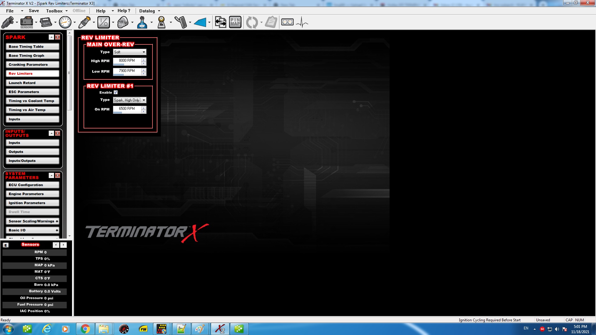

best thing you can do is download the software and poke around in it. holley and haltech for sure you can do that, but almost any standalone has the software freely available.
with the terminator x you can do timing adjustments with advanced tables, and the axes can be almost anything. limiters arent dynamically adjustable, or able to be activated in software without eating up outputs, they ONLY activate on a wired input so you can never adjust the rpm but you could use a software-defined output fed into the input to control when it happens. i have a 2step/anti lag i do that with. termx only has a main rev limit and a single secondary one. i believe the hp and dom have two secondary rev limiters. the holley can io box adds 8 each inputs and outputs to expand the termx but none of those IO can be used for activating things or for predefined functions like AC, rev limiters, boost control, Fans, etc. they can only be used in advanced tables and logging. i found that out AFTER buying it. yay.
the HP and dominators are similar but a little more powerful. dominator has a ton more i/o.
both holley and haltech are pretty powerful and have modern features and seem to stay up to date. the big difference that ive heard is haltech support is excellent and holley is poor. i had a few issues with my terminator x and its very time consuming to get someone on the phone to help, then they never really fixed anything just gave me 'stuff' to try that got me off the phone, so if you buy, buy from a vendor that offers support IMO.

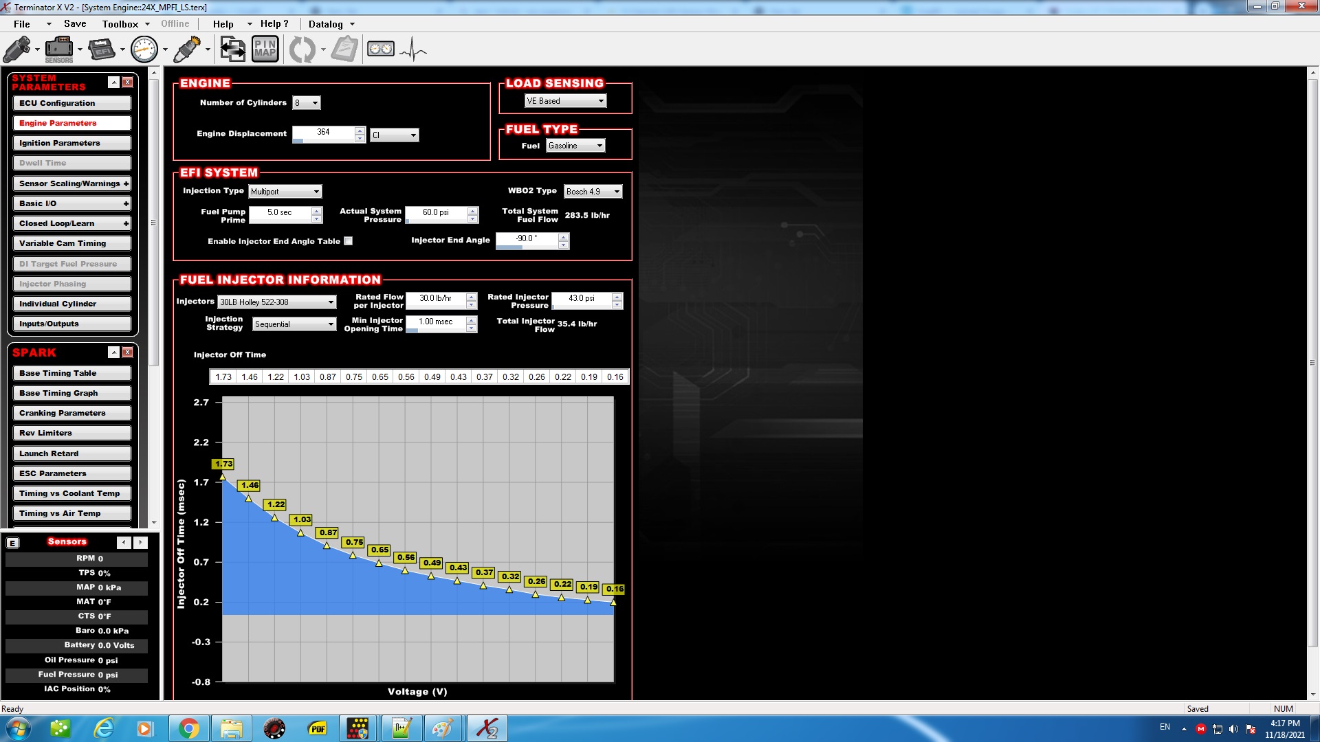

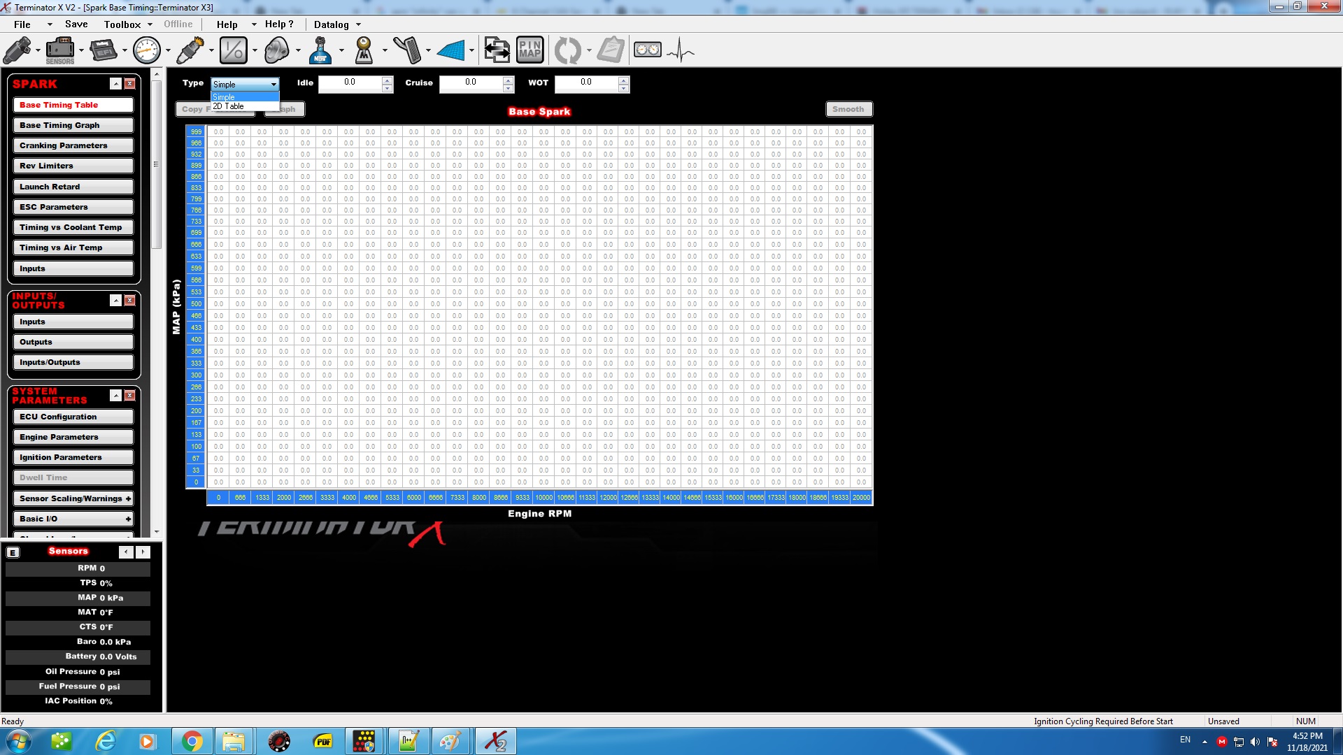

Looking at my actual Holley (Terminator X Max) install, Spark gives you the following:
1. Base timing table (RPM and MAP to degrees timing advance)
2. Cranking spark (just a single timing value until it hits "run" RPM)
3. Launch retard based on some input
4. Knock sensor parameters--a single value for "retard per ring" (how much timing it'll pull each time the knock sensor registers) and "restore degrees per second" and a small RPM vs MAP table where the values are the maximum number of degrees you want it to be able to pull
5. Timing versus coolant temp--a simple adder/subtractor based on coolant temp only; no other inputs
6. Timing versus air temp--same as coolant temp, just a simple adder/subtractor with only one input
Fuel gives you the following:
1. Main fuel map (RPM and MAP to VE % or actual air flow, depending on how you've got it set up)
2. Target A/F (RPM and MAP to target A/F ratio)
3. Alpha-N idle fuel (useful if you have some giant cam, I guess)
4. Acceleration enrichment (lots of different parameters here, they're all tables that map a single variable to an enrichment percentage)
5. Temperature enrichment (Coolant temp and MAP to enrichment multiplier, also an air temp enrichment that's just air temp to enrichment percentage)
You CAN build additional timing/fuel modifiers using custom tables, but you're stuck with the limitations noted above. You get:
1. Four "1-D" tables where a single input maps to a single output
2. Four "2-D" tables where two inputs map to a single output
3. One 1-D per-gear table (per-gear logic only works with auto trans or with an input configured as a gear selector)
4. One 2-D per-gear table
For all of the custom tables, you can define simple switched or thresholded inputs--for example, you can activate a table only if oil pressure is below some specific PSI, or if RPM is above some value.
So, to answer your original question directly, there are built-in modifiers for timing based on coolant and air temp, and you'd have to use up a custom table to get one based on oil temp if you have a sensor for that. There's already some logic to allow you to make fueling richer/leaner based on air and coolant temp, but again, you'd need to use a custom table to get an offset based on oil temp if you wanted that. Fuel can be done either as a raw offset, a raw multiplier, a target A/F offset, target A/F multiplier, etc.
One of the sillier things I've done with mine is use a 2-D table that uses vehicle speed and RPM to do boost-by-gear on a manual transmission without any additional inputs. This has done wonders to make a ~700 whp manual transmission Mustang vaguely controllable on plain street tires.
You should totally download a copy of the Holley software and see if you like what you can do with it. As others have stated, the Dominator is more capable than the Terminator X and X Max, but that's largely a question of how many inputs and outputs you need, and how many custom tables you need to achieve what you want. I agree that Holley's support can be hard to reach, and that EFI-specific support may be hard to come by, so you might be better served by Haltech or one of the other more motorsport-oriented offerings if you're not comfortable relying on forums as your first source of information. I'm fine with this for a "hobby" street car, but I don't know how I'd feel about it if I were building a fancy track car.

I downloaded the terminator X software and I am at a loss for words.
I understand now why its so popular and why "professional" tuners are obsessed with it. should have done this sooner.
Its as close to idiot proof as you can get for dyno tuners, especially if you are using a base cal.
It reminds me of how simple the PF4 is. If you could edit the cals in the PF4 with a PC it would probably look like the Terminator X.
I should have originally picked up a Terminator X instead of the PF4. The price difference is negligible, around $200 I think.
PF4 engine configuration:
I mean seriously you can switch the tables in the Holley to self interpolating points
I get this feeling Holley makes the PF4 for Edelbrock

I figured out how you can do a custom igniton based compensation on the Terminator X. You can add it through Advanced ICF. I can not figure this out on the Holley HP/dominator though...
It seems the Terminator X software is more advanced or the Holley EFI software is missing ICFs.

I am liking the Haltech more than the AEM. The features are there, a lot of them. A lot easier to setup and plenty of options. Most of the motorsport and interesting features are predefined on a list. Unlike the AEM it gives you a long list of items you can add or remove.
I am not liking the price though and the fact that this is an Elite 2500 and there are not that many input/output pins available. It does requires a modern PC/laptop, too slow to run on anything budget, minor software bugs, forces you to make a Haltech user account, and requires an internet connection to properly setup.
Overall, pretty impressive but for an Elite 2500 without any harness is $2000 and it can only do one DBW throttle body.

Trigger setup:
Flex fuel is integrated:
Assigning an input to a sensor:

Adding a custom sensor input:
Creating you own compensation table:
