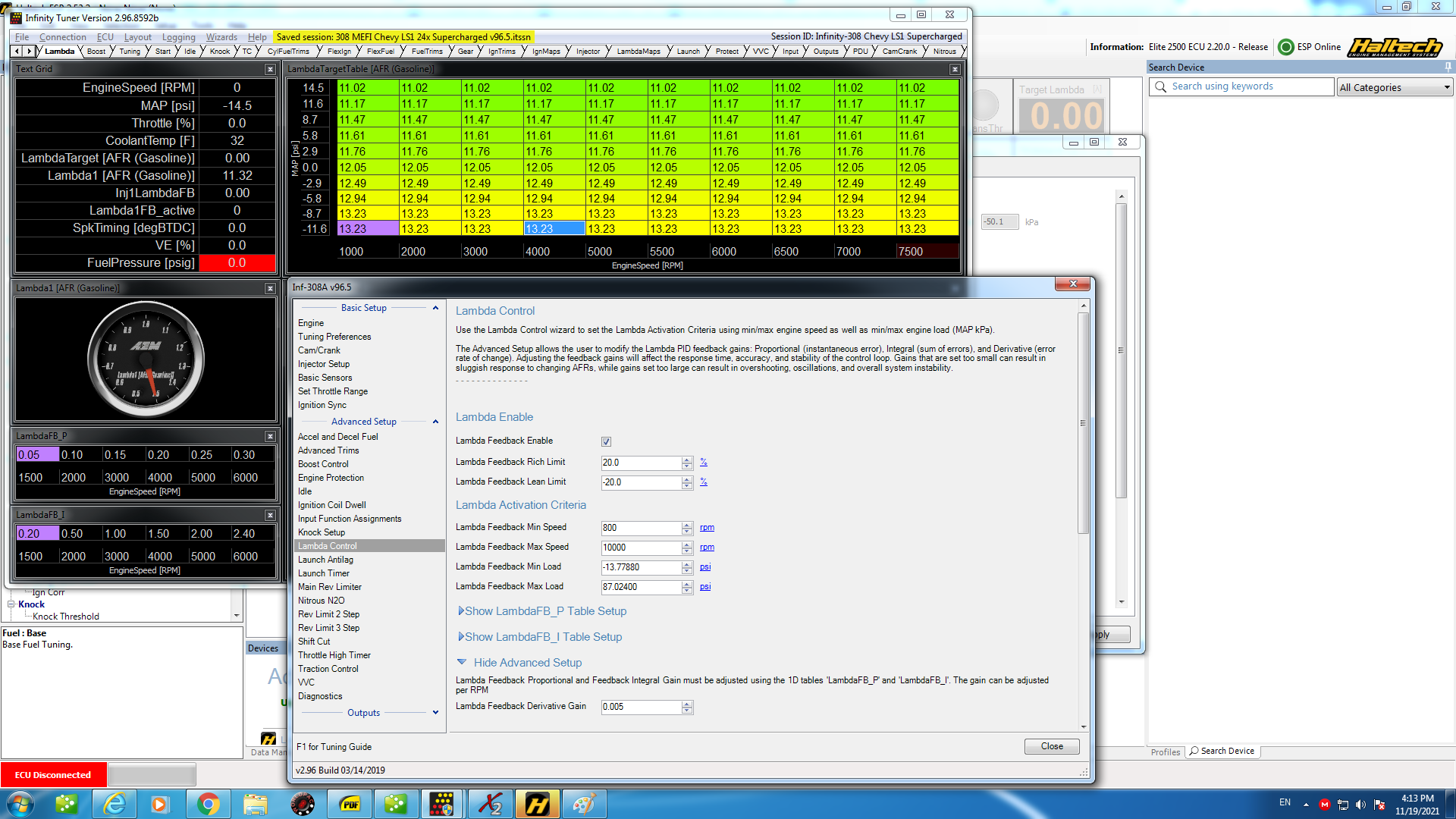

AEM Infinity Series 3 is cheap for an 8 cylinder non-DBW setup and has a 200Mhz processor. The software has a lot of features, some customization, mostly predefined. Available data, software layout, and AEMData logging is really good, unfortunately the software is linear and some users find it complicated. It is motorsport oriented so if you can deal with the quirks you will like it. You have to make your own harness for the Series 3. There is not much you can do outside of the options presented in the menu, although it is more than the Terminator X. Its disappointing because the Infinity is actually the Engine Lab EL129. The EL129 allows for custom software and their version comes with engine modeling/simulation. The Series 5 and Series 7 are more expensive than the Elite 2000 and 2500 but offer less customization.

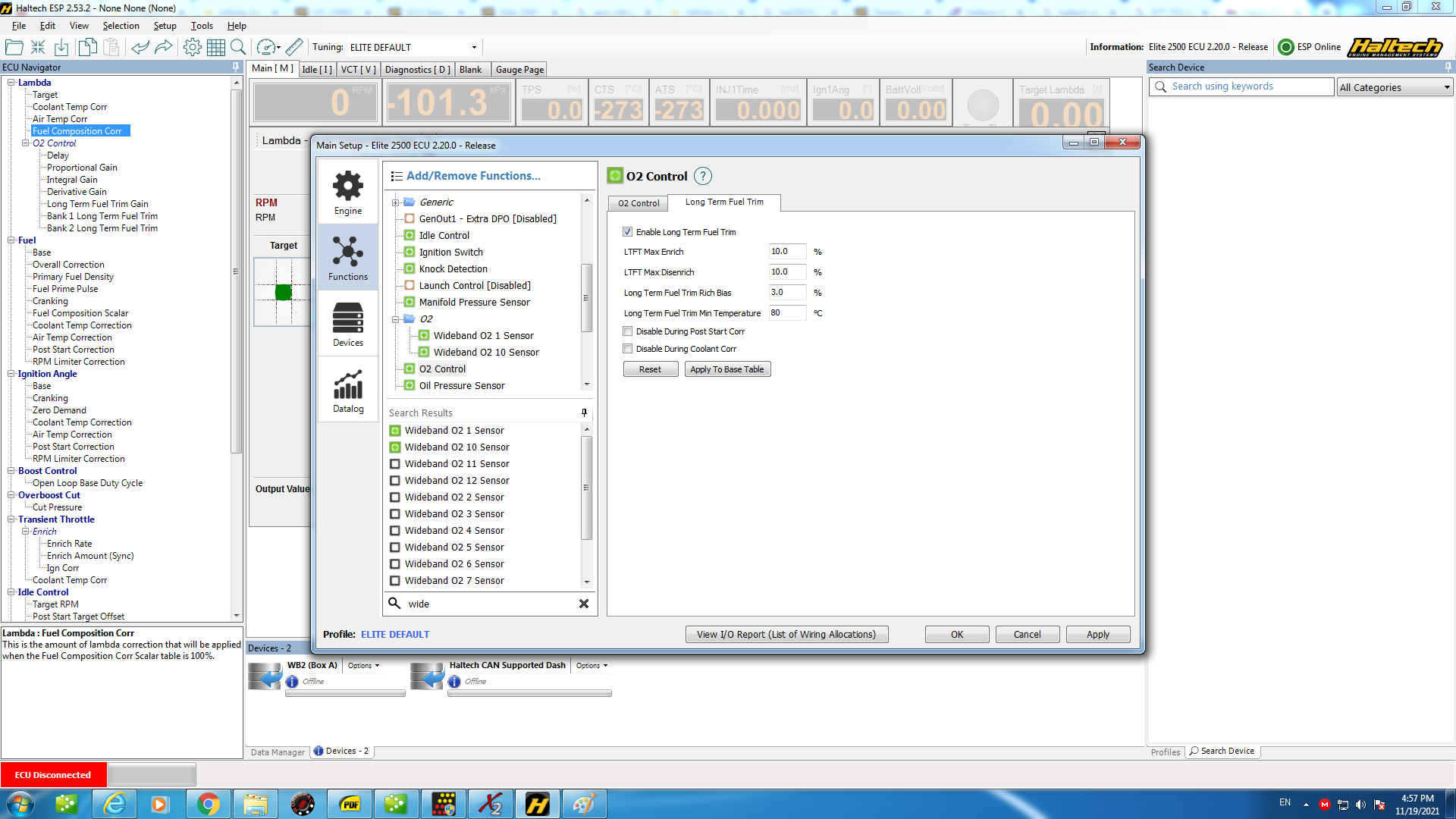

Haltech can do short term and long term trims. You can correct the VE table on the fly while logging and there is a way to apply long term corrections to the VE table from the settings menu. Not something I can try out but whatever.
You can scale up to 32x32 and change Axes. I haven't seen a table yet that does not allow you to do that.

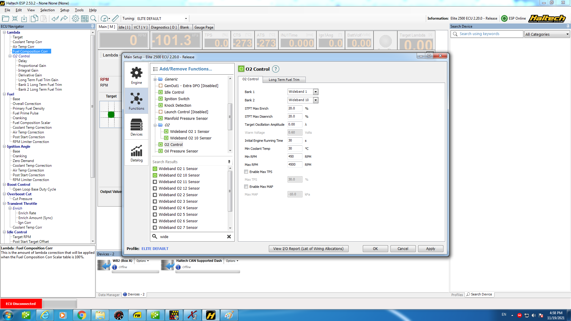

You do have to setup O2 control. This is the nice thing about Haltech, lots of simple ways to apply a table to something.

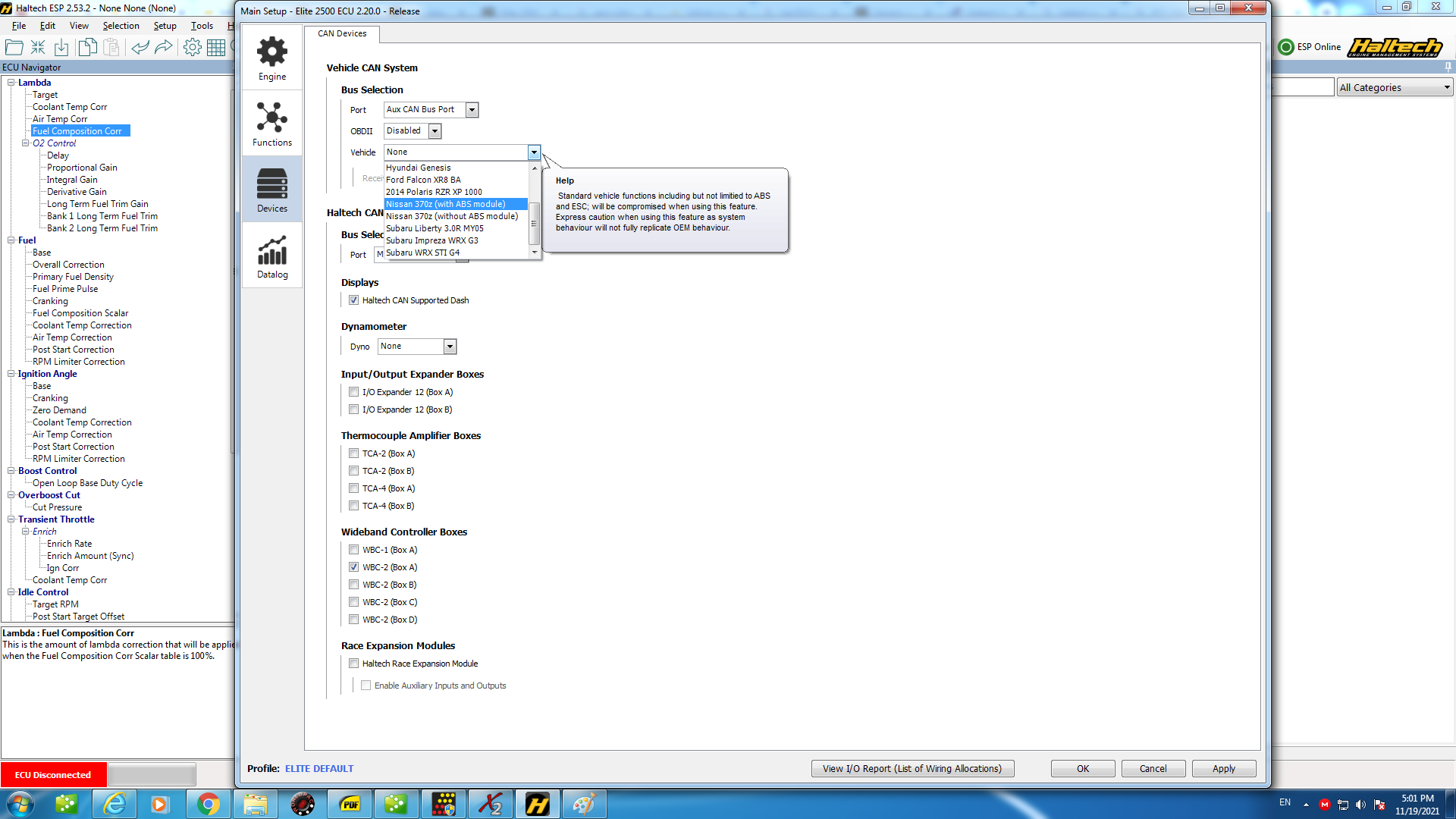

Long term trims:

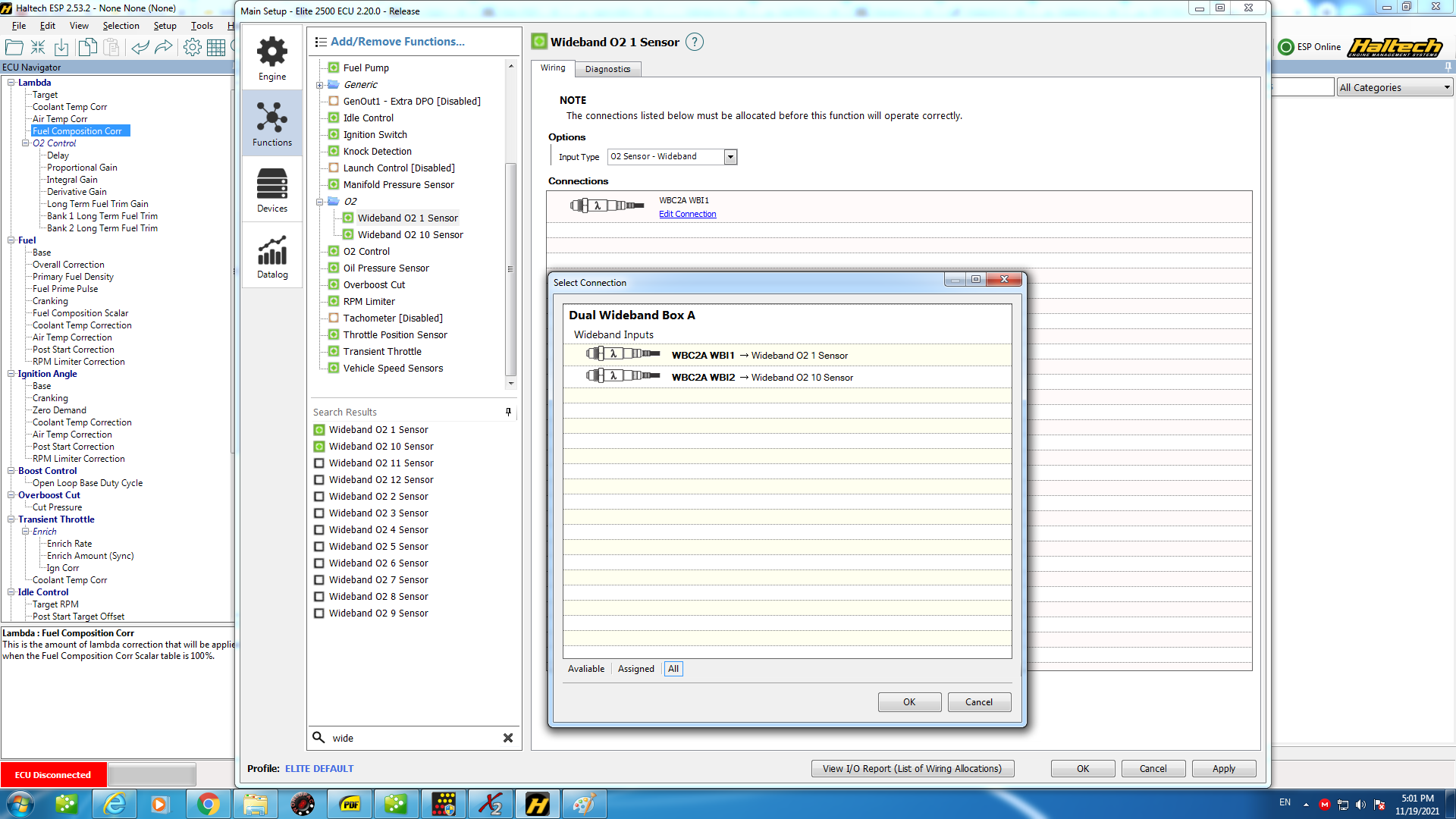

You have to setup CAN. There are a few cars that the Haltech is compatible with on CAN.
Haltech has a lot of CAN expansion options but they only support Haltech devices.
That simple

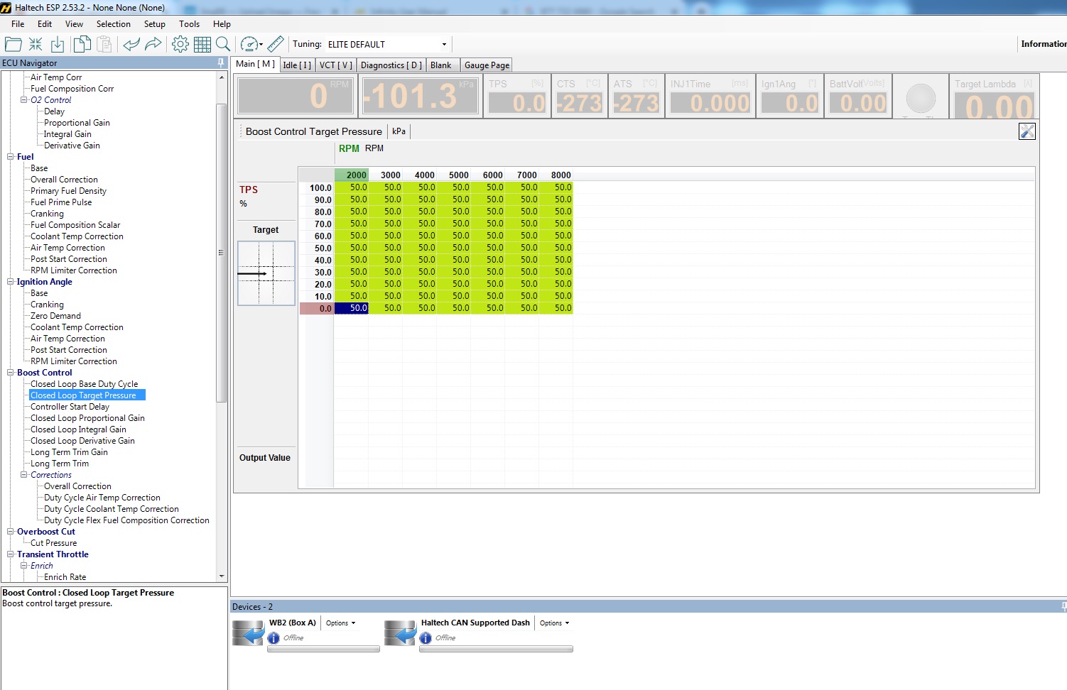

Haltech Boost Control is on point, closed loop, open loop, long term, wastegate pressure, manifold pressure, duty cycle correction, target pressure correction, trim, scramble, whatever.

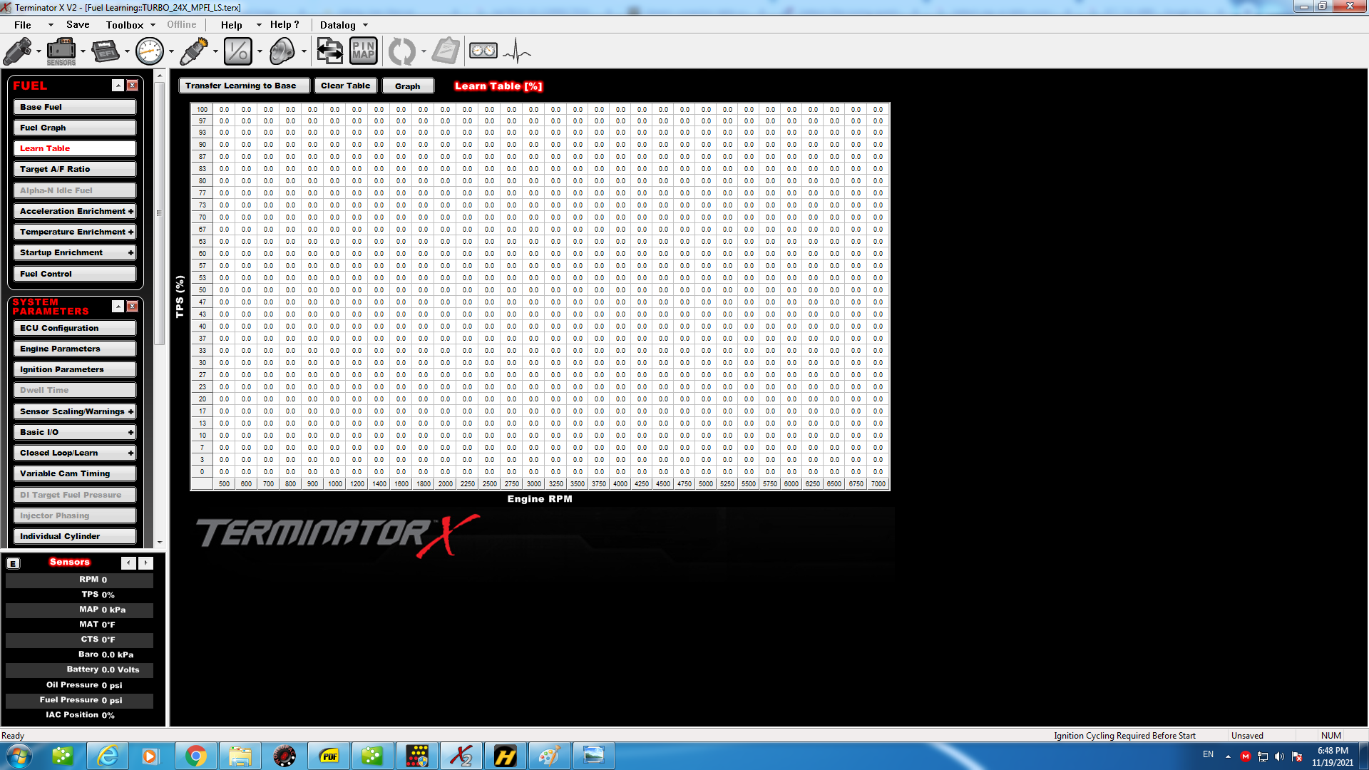

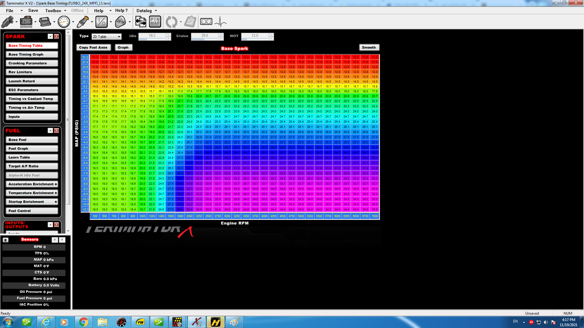

Terminator X VE table, plenty of resolution. I don't know if you can scale the amount of cells/resolution.
Holley VE table corrections are a simple button under Learn Table, "Transfer Learning to Base".

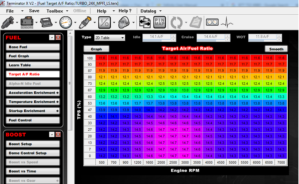

The AFR target table is a bit small, its the same way for the HP/Dominator

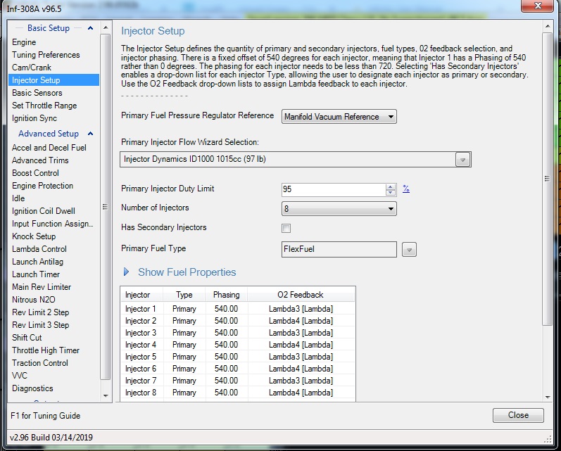

The AEM isnt any better, its only a 10x10 table but I like the AFR trim options. Correction factor is on point but applying it to your table isn't straight forward.
The only use I have for boost control is with flex fuel, this is where the AEM shines:
AEM flex fuel. Pretty straight forward, just set the fuel type to Flex and setup the sensor.
All the tables you need for flex are there, ignition, boost, fueling.

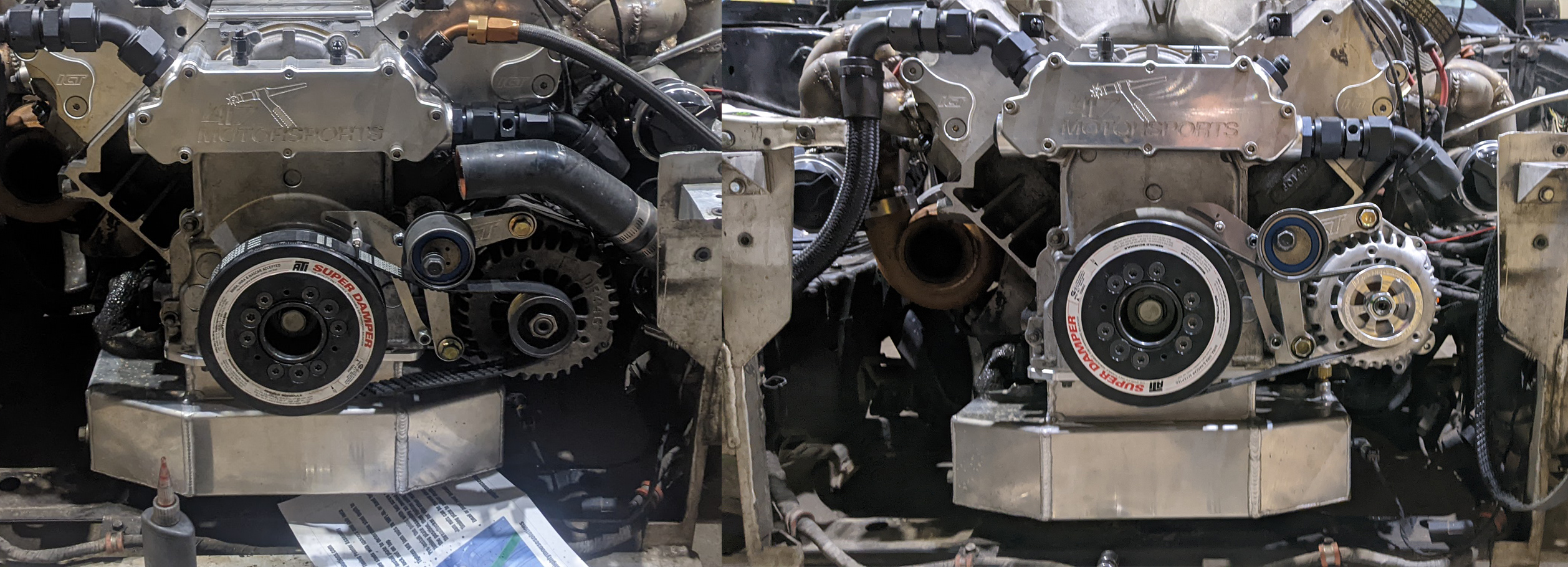

I got back to working on the car...
I had copies made so I can either make a midplate design or something that bolts up to the subaru motor mounts. Clutch Masters helped me out once again. Don't bother trying to order the adapter plate from them...you can't because they're sold through a different channel.
Subaru engine on the right
The lowest transmission bolts are actually studs on subarus and they aren't plug and play with either of the adapter plates. They have to be studs. The axles are in the way of using bolts...unless you plan to pull the axles to install the engines. So I modified the stock studs and made them a little shorter.
EJ vs LS, long block dimensions. EJ is missing a bunch of parts
For reference, EJ205 long block with a stock turbo on it. My 6.0 LS long block was ~300lbs
I did not know that GEN IV knock sensors fit on GEN 3 blocks...or rather 24x crank 1x cam engines that have one wire knock sensor castings in the valley
My L33 had two spots for it already

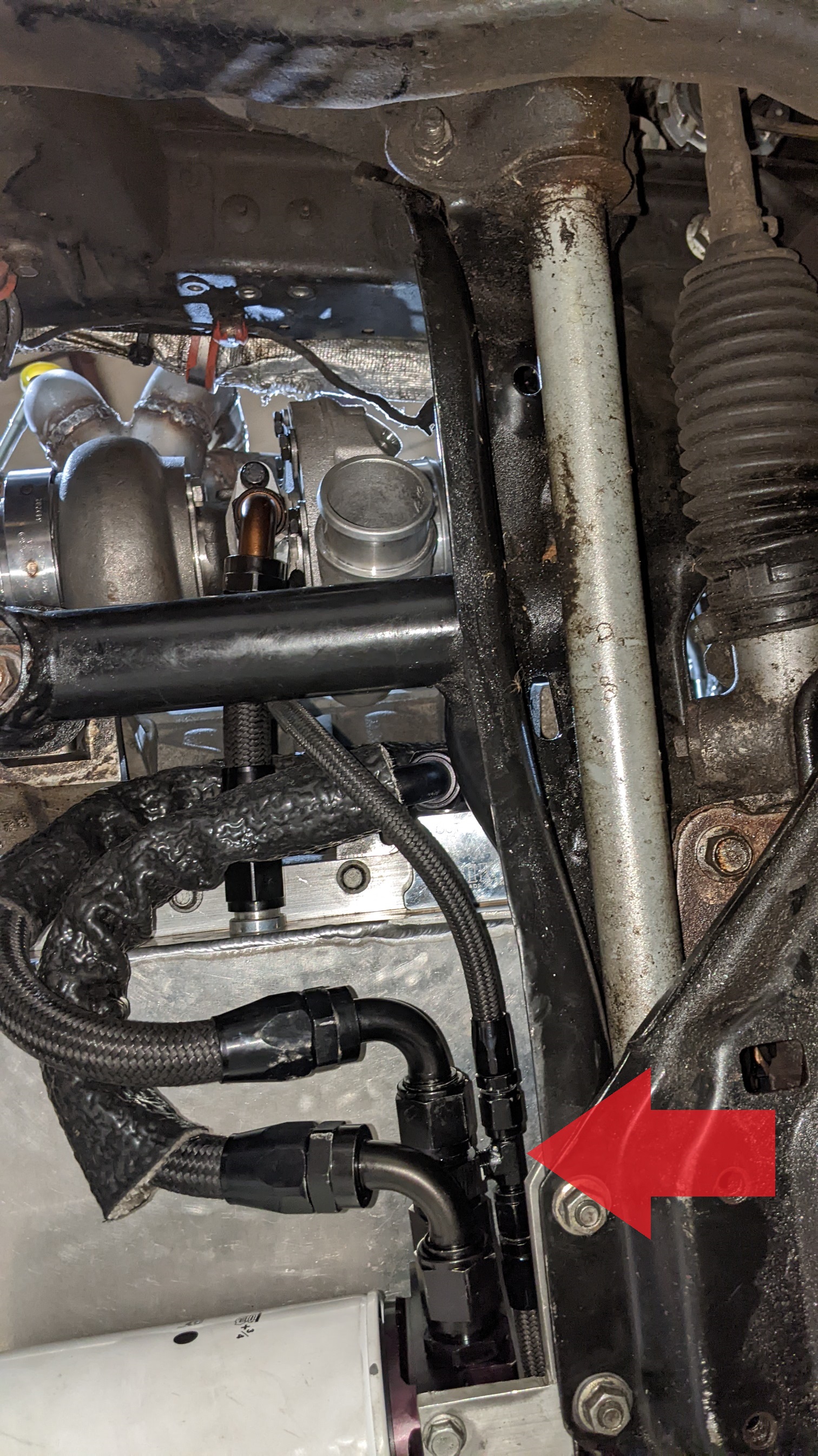

The turbo oil feed is kind of nifty. The best place for a turbo oil feed is generally oil coming out of the filter as opposed to a passage in the block or before the oil filter. Either of those cause an unnecessary pressure drop or require separate filtration on the oil feed. There is a caveat though, most oil filters have bypass valves. The filters I use usually don't. How do you feed oil to a turbo off of a -10AN line? Simple, a 10an male to female fitting with a 1/8 npt port on it, like for a sensor. 1/8NPT is way more than enough, it is a larger diameter port than 4AN.
10AN sensor adapter examples:
4AN tee with 1/8npt:
I have a dual 4AN to 1/8npt Tee attached to the 10an adapter on the outlet of my remote oil filter setup.
Like so:
The oil feeds to both turbos out of this Tee before the line returns to the block. If you keep the branches to the turbos equal length it will not cause any problems. If one line ends up being too long just make it loop around something or a coil. Also running 4AN off a 1/8npt port attached to a 10an is a simple way of preventing excessive oil flow and pressure at the turbo. This would work just as well on a single turbo setup. If you are being stubborn and still using a stock oil pan and don't have a remote oil filter setup then go ahead sap oil from your engine at the oil pressure sensor port. It works but there is a difference if you can grab the oil before the barbell. AN fittings don't cause a noticeable difference in flow or pressure, get that "each 90 degree turn is equal to 5 feet of straight hose" mentality out of your head. The oil galleries in the engine block have hard and sharp turns and yet LS engines make it to 250k miles. AN fittings are much smoother than that, even the forged elbows. 10AN is over 1/2" ID at the hose and slightly smaller at the fittings. That is more than plenty. Even dry sump setups use 12AN or less for oil feed and they have way more pump flow capability.
Remember those Melling 10355HV pumps I'm so fond of? Or the 10296? Or pretty much any pump that flows more than stock? You can go HAM with the turns, bends, banjos, hard 90 elbows, oil filter size, length of hoses, oil cooler, etc. If it's available, why not make your setup work the way you need it to? No reason to compromise.

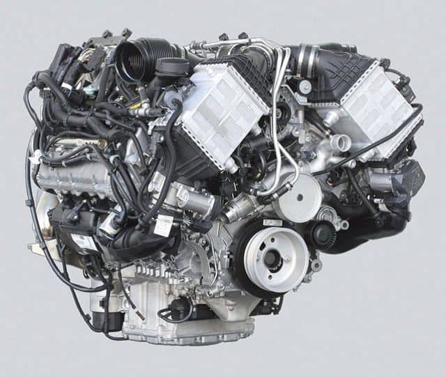

Since you reminded me....I was going to post some info on what I plan for the intercooler setup...
I got the idea from BMW. It works well and its fairly compact.
This is the intercooler setup on the BMW n63 engine. Its a reverse airflow V8 with direct injection and and has twin turbos. The reverse flow heads allow for an easy way to setup twin scroll headers to each turbo. There are two ecms to run one engine and they require cooling, so they use the intercooler cooling circuit which is separate from the engine cooling circuit.
Lets fix that. My setup would look something like this but the intercoolers would be behind the engine:
The S63 system is even more complicated. 3 heat exchangers and 2 pumps. I have never attempted a setup this ambitious and I don't think it would be necessary. I believe BMW used two CWA50 or maybe even smaller pumps on this setup.
The idea BMW has is sound and it works, I already have experience with this. The problem is its BMW, it has to be overly complicated, specialized and meet a very low price point for production (Also read as: low quality, unreliable, doesn't last). The BMW M5, X5M, and X6M are rather large and bulky cars that have space for all this.
Hopefully one CWA150 or CWA100 pump with a heat exchanger stacked in front of my current radiator for both intercoolers should be enough. I am familiar with the S63 engine and the stock intercoolers/heat exchangers are very good at keeping IAT low. Its also not a lot of boost and every car was using E85/flex setups. I have never dealt with N63 cars and turning up the boost. Another point is even the M models have rather small turbos, they flow much less than the S257sxe, they top out where the S257 starts. My intercooler bricks also have larger cores than what comes on the BMWs.
I have to custom make the elbows out of the turbos to clear the subframe and point up towards the hood. The intercooler starts right after that so...yea thats why I don't really want to skip them. The whole setup at this point revolves around making the charge to the intake manifold as efficient as possible.
Anybody have an idea why BMW has the flow reversed at the heat exchanger?

Volkswagen Audi Group V8, specifically AUDI V8 -this one might actually fit better than the LS but they're too expensive. RS4, S8 and R8 engines aren't exactly plentiful either. Doesn't come turbocharged.

I have come to the conclusion that doing a twin turbo setup in this car is more complicated than I originally planned two years ago....Should have just gone single or kept it NA. On the positive, side there is plenty of clearance around the downpipe and wastegate dump. The CS130D provided more space than I was hoping for.
I decided to merge the wastegates back into the exhaust, hopefully it doesn't reduce power output too much. I don't care much for hype or attention so no need for atmosphere dumps...I also don't want exhaust inside the car. I was trying to have the screamer pipes go all the way to rear bumper and I even tried to put mufflers on them..but alas, the space not hereth exist
Oval pipe helps
