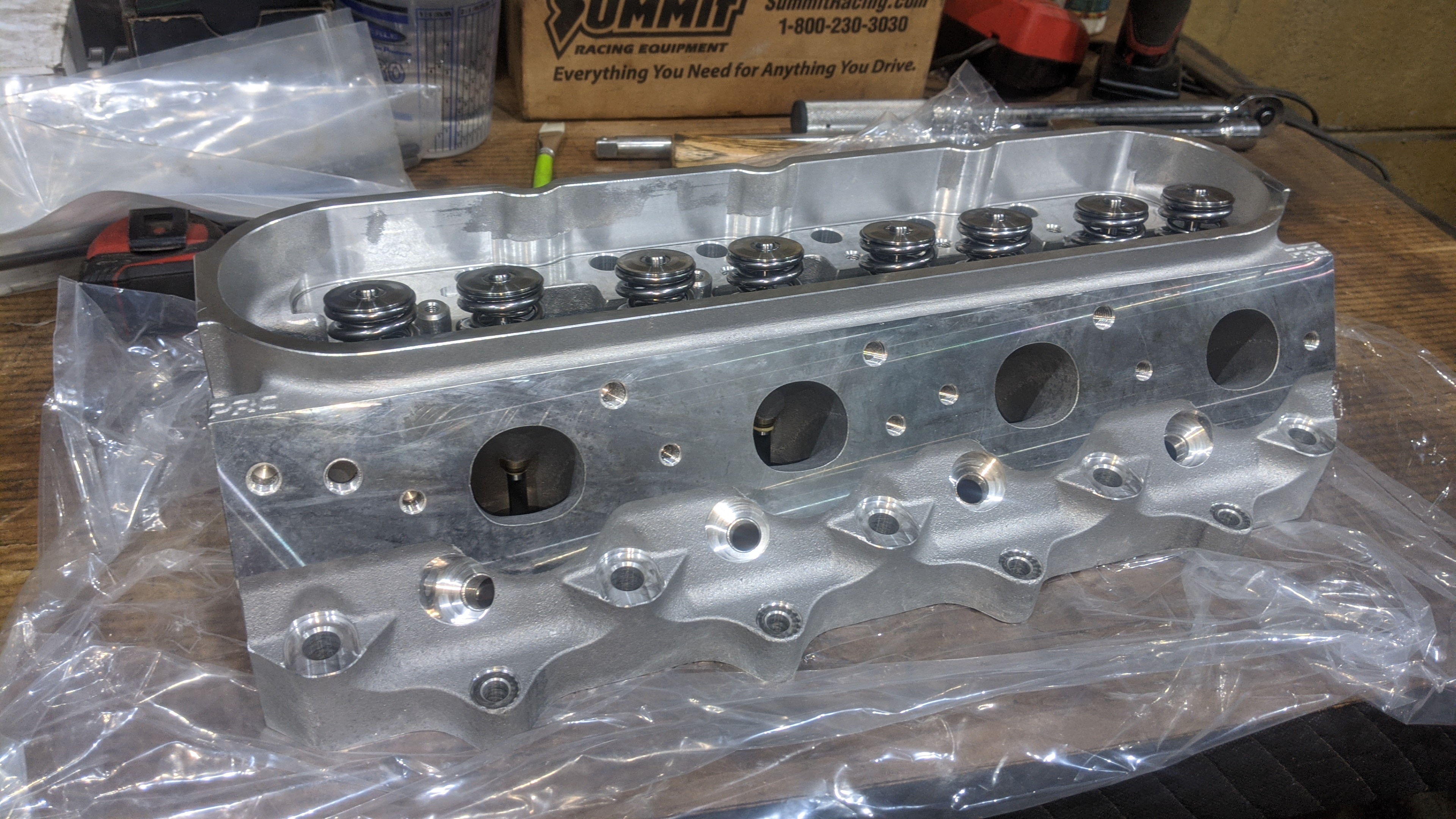

So meanwhile the LS2 "blew up" and I rebuilt an aluminum 5.3 with flat tops and 862 heads. I tried a few different cams and a FAST 102/102. Ultimately the best response and drive-ability came from a Victor Jr and a 4150 throttle body. I want to like the FAST but it just cause a huge torque spike and lops off air flow after 6,500 rpm, it really doesn't work for me unless I short shift.
LS2 sloppy rebuild aftermath, coolant in the oil, heavy oil consumption:
Rebuilding my L33, the 243s that came off this engine caused the majority of my problems
MAHLE OE replacement flat tops
New stock rod bolts, my favorite
My favorite tool, it makes this much easier than it has to be
I usually go over everything with a torque wrench but using the torque to angle method lets me sit in both camps
Swapped out the springs the bilsteins came with, Front 550lb/ Rear 450lb.
The mahle oe pistons also don't go above the deck and they are consistently 20 grams lighter than OEM
junk 862 heads that don't leak, I have been reusing the Melling 10296, Katech C5R chain 5 times now.
I have also been reusing the CamMotion double valve springs, keepers, and retainers on 3 different heads. This time around I bought BTR titanium retainers and put them in. Apparently everyone is using the same .660" double valve springs or at least the same specs
I am trying to figure out an easy way to put twin S257s without making custom headers

Default PRC 225 62cc Heads
So I got some PRC 225 62cc heads for my N/A LS2 build. They feel to the touch more bulky and thicker as a casting compared to the GM stuff. The quality is nice and most people at work, who build oem engines, thought they were worked over oem heads.
If you are deciding on what heads to go with, then PRC is a good deal.
Do not waste money on porting stock heads, they are a pretty weak casting to begin with. They don't get better after 15 years either. Most cathedral heads are usually cracked somewhere and leak coolant internally.
I have two sets of 243s with this problem that I wanted to get ported, That could be as high as $1,500 with valves, guide replacement, milling, etc. and BAM! you find coolant in your oil.......and your cylinders liners have funky wear on them.....
I payed less than $2,200 with shipping for brand new heads with valves, valve springs, and a better casting core. A wet sump LS7 is still $12,000 new with manifolds, an LS3 is $5,000 for a new long block, LSA heads are $1,200 for the pair and don't include rockers.
TFS heads are another option but they cost a little bit more money and there is a lot of rumors concerning guide wear/valvetrain geometry that no one objectively answers.
I wanted naturally aspirated power and owned a $400 6.0 long block with bad heads.
I also ordered a PatG spec'd custom cam made by Cam Motion. I failed to read that the cam core would be an 8620. Apparently 8620 core don't have a large hole in the middle like the 5150 (like OEM), so you can't use a 1/2" extension to help you hold the cam while sliding it into the block. Had to actually thread bolts into the cam this time.
PRC heads are shipped individually and in a box inside a box so damage from shipping is highly unlikely. They are 6 bolt and you can use them on 5 bolt blocks.
I got mine with dual valve springs w/titanium retainers for 0.660" lift, Texas Speed advertises them as PAC springs.
I can't tell if the springs are the same ones everyone sells but I can tell you the retainers look really different compared to BTR, CamMotion, etc. I think they use an integrated valve spring seat/seal like oem, at least that's what it look like assembled.
There is CNC work on the heads even though they are advertised as-cast.
The chambers and head casting look like they are CNC'ed to finish specs. Much like the OEM GM castings have flash where machining is not needed.
I didn't take pictures of the runners but they also have machining done to them. All the important parts are machined on the head really well. Awesome replacement heads. The only thing better about stock GM heads is that you already own them.
Johnson 2116 lifters, I wanted a better lifter and to get rid of the trays.
The 6th bolt doesn't stick out as bad as I thought it would. I could probably grind them down in the future.
