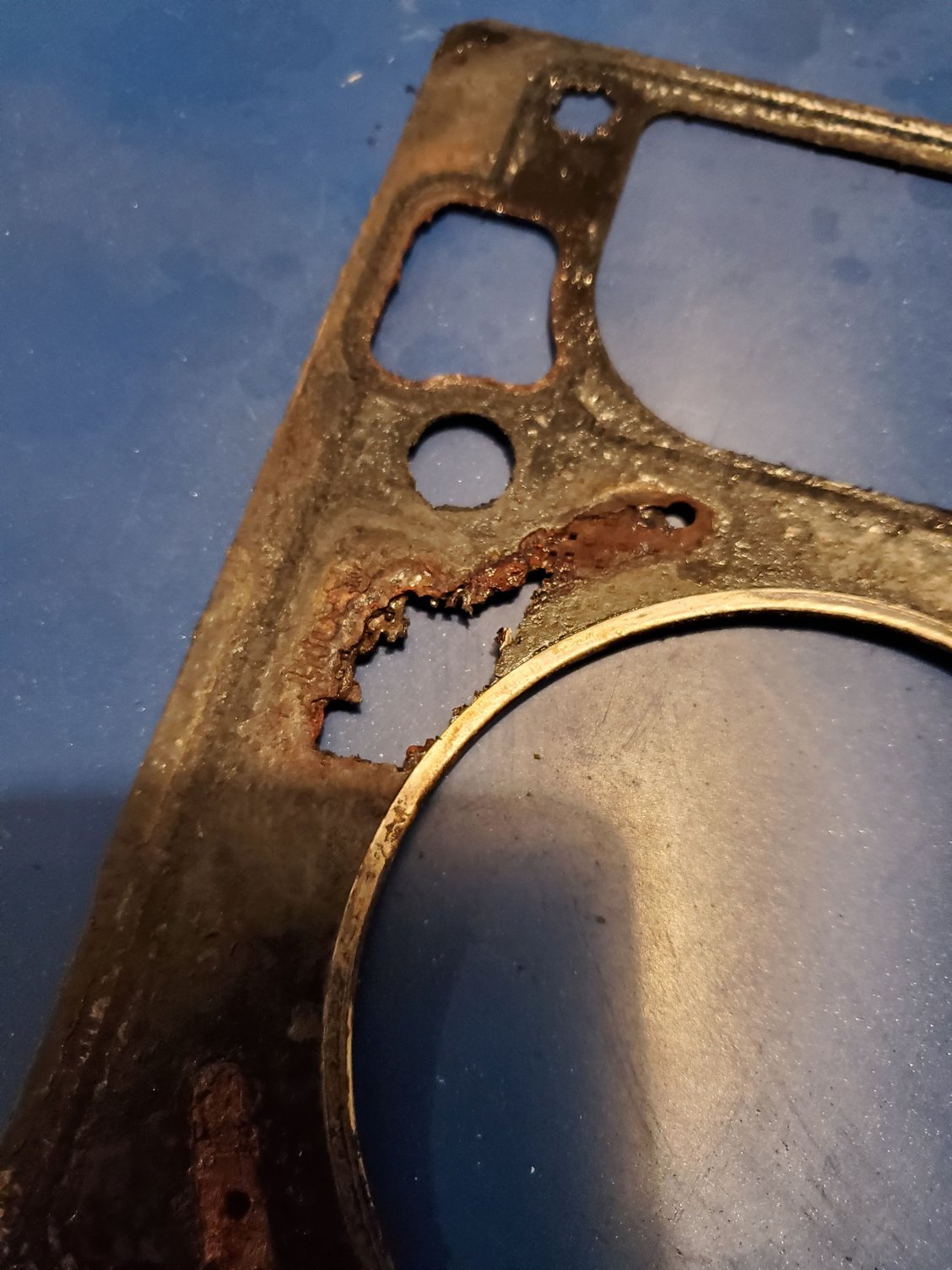

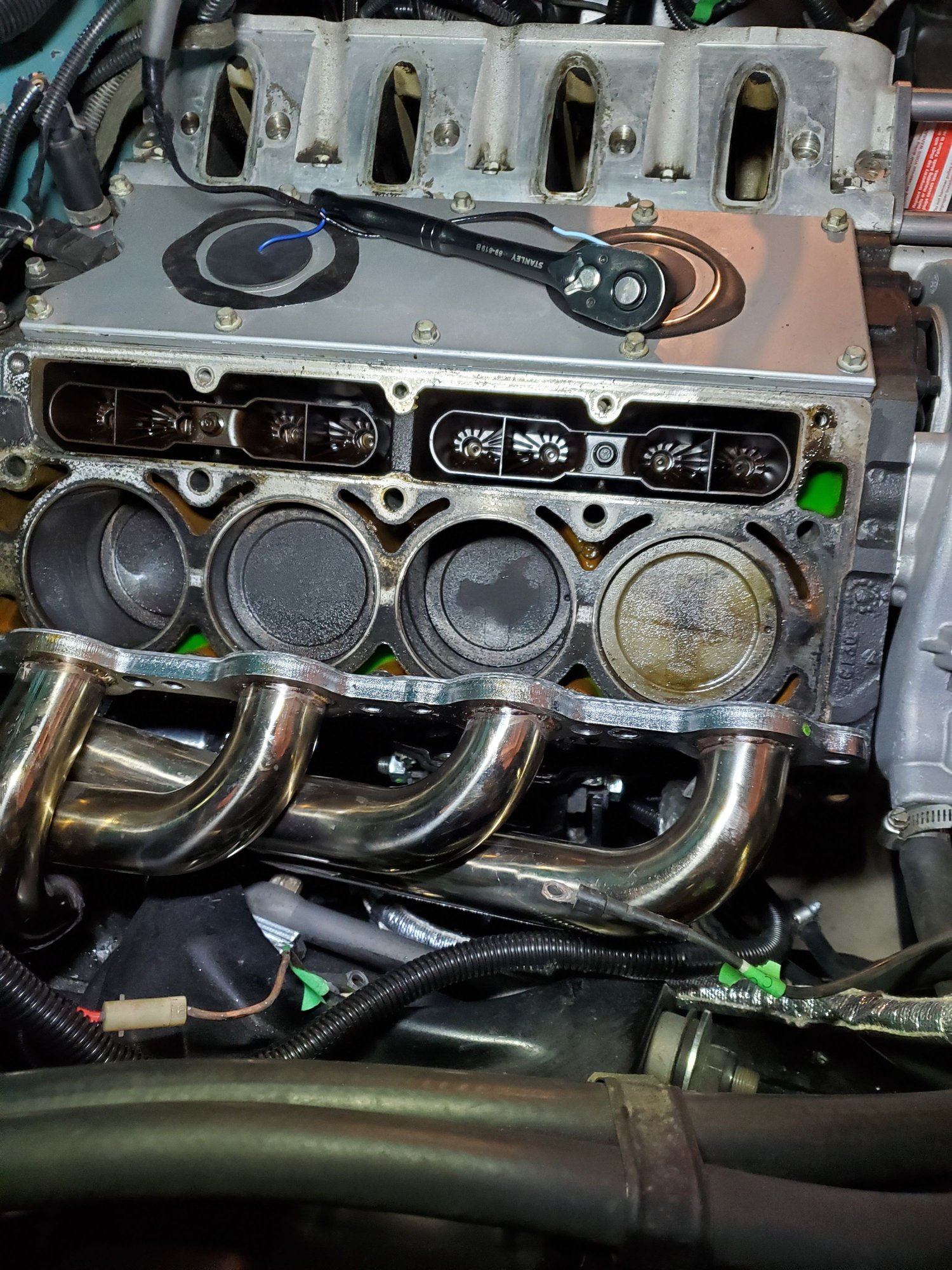

Old Apr 22, 2020 | 10:29 AM
Bradyc123's Avatar
Joined: Apr 2020
Posts: 7
update
Old Apr 22, 2020 | 10:39 AM
Project GatTagO's Avatar
Joined: Mar 2003
Posts: 10,617
Likes: 1,883
From: Little Austin
Well....that seems pretty obvious! At least you are on the right track to getting it fixed up.
