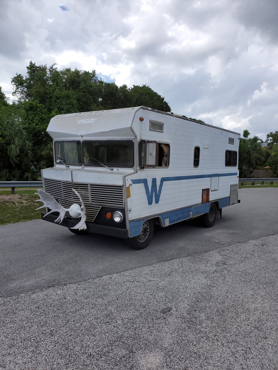

This swap has been fairly easy but I can't figure out this code it's throwing
u0107 lost communication with.....
I ran a bunch of new grounds. Purchased a new throttle module. The programming on the ECM I'm told is correct. I'm out of ideas

id be interested in more info on your build and more pictures of the winnebago. sorry im not much help with your problem.
