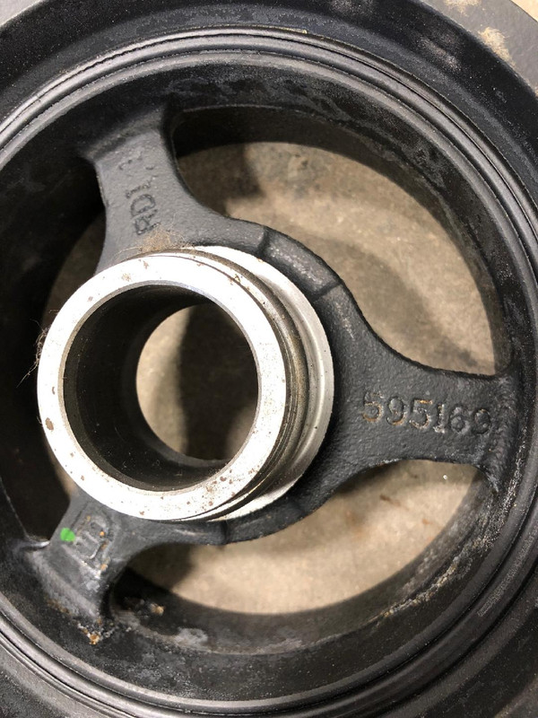

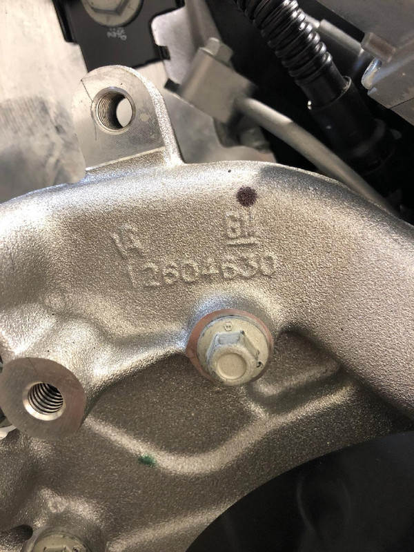

I purchased a GM Connect and Cruise LS3/4L70 package. It seems they come with a water pump, damper, and oil pan which are unable to be used with any accessory drive packages I can find. This is going in a 1972 two wheel drive Blazer and will have AC (factory AC Blazer). the water pump and damper have the following part numbers
Water pump 12604630
Damper 595169
I looked at the Corvette, CTS V, F Body accessory drives and they all use different damper and water pump so on to of the $1,000-$1200 for the drive kit I would need about another $300 for a water pump and $100-150 for a damper. None of these use the water pump or damper that the C & C package comes with (thanks GM)

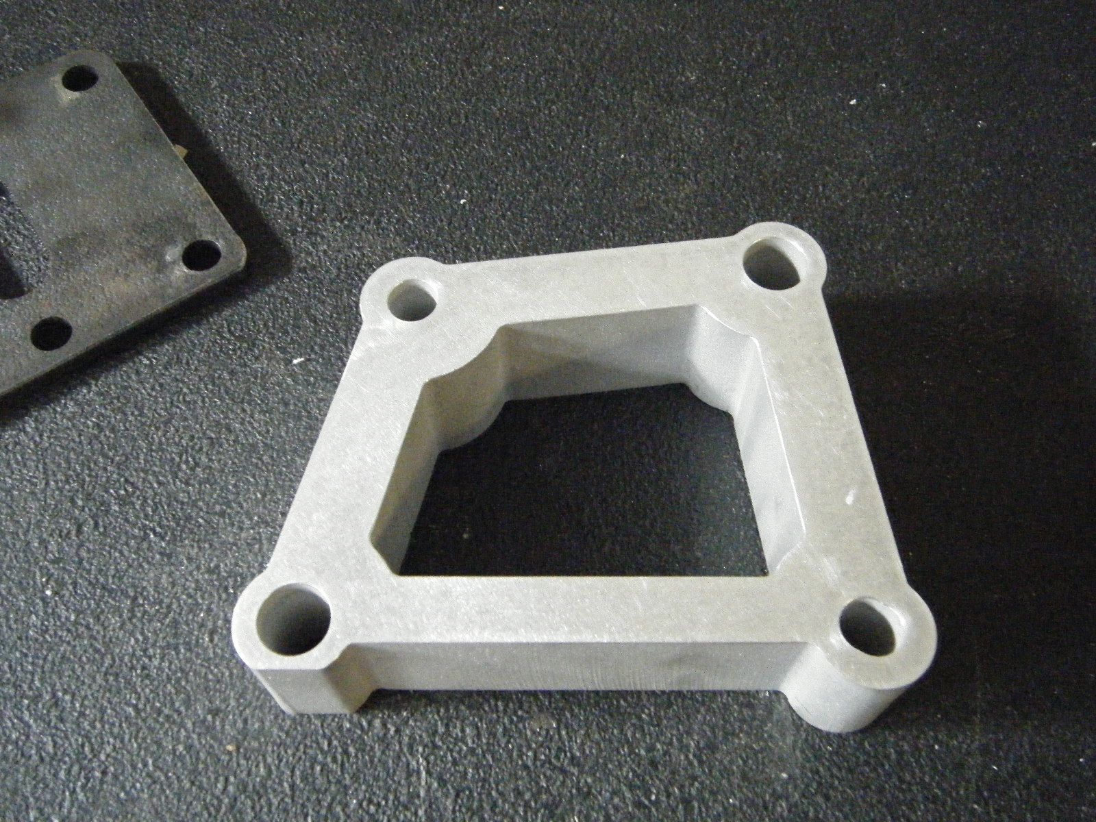

There are only three offsets. Corvette, F-body, Truck, if you call the corvette 0 then the F-body is 3/4" out and the truck is 1.5 inches out. I'm not sure what offset you have but as long as you have the room you should be able to use the parts that came with your crate engine, Holley and others make spacers that you can be used to correct offset. I have a truck off set crank pulley, with a Camaro water pump (Camaro had auto trans and VVT) and corvette ALT/PS bracket with a 1.5 inch spacer, Denso fixed displacement ac compressor with the factory truck bracket. I'm sure with a little research on this site you can find a setup that will work well
Oil Pan is a different story, you need to purchase one that fits your body style.
2009 LY6 Motor, 2010 Camaro water pump, Corvette Alt/PS bracket spaced off the the head 1.5 inches
Homemade 1.5 inches thick spacer used to line up corvette alt/ps bracket with the truck off set.
