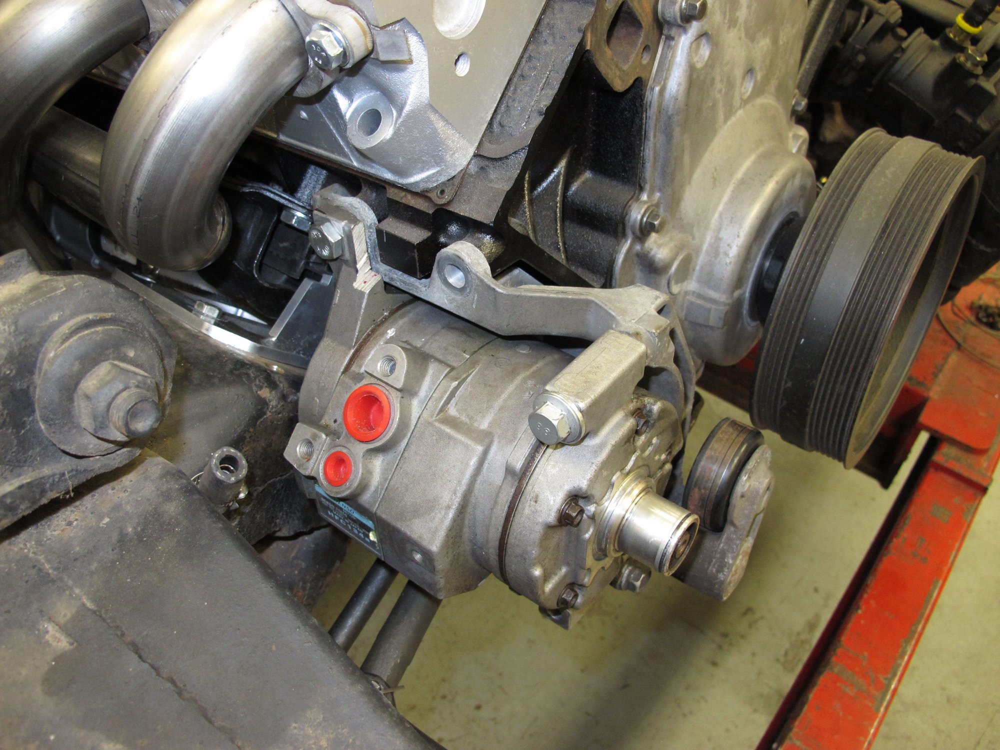

The stock Denso truck A/C compressor will fit if you use an engine mounting method that was designed to allow it. The the engine mounting brackets/motor mounts from the Hooker Blackheart A-body LS swap system are an example of this.

These are the forward mounts, correct?

No, the mounting bracket depicted in the image is from the rear-biased Hooker Blackheart set. The forward-bias set provides even more clearance.

Hmm, good to know.

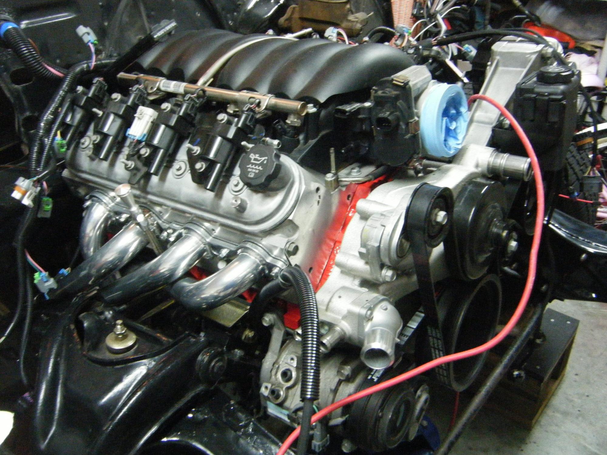

Here is an LY6 with the denso compressor in a 67 Skylark using a vintage air Gen VI kit
