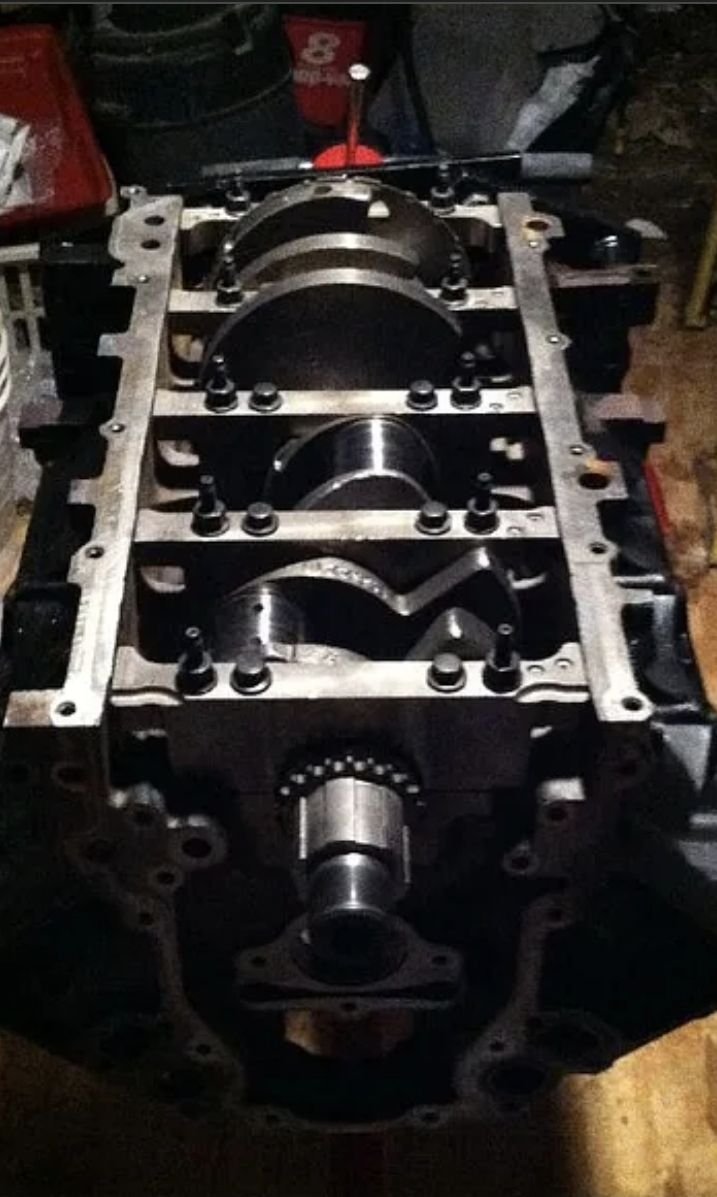

If you didn't have a crank or cam signal you'd be getting P0335 and P0340 codes.
24X systems have black cam and crank sensors and the 58x's are gray. By pulling the crank sensor which is located on the passenger side of the engine block you can see the reluctor ring on the crank.

Looks like I've got the 24.
So now I should go and check and make sure my sensor is the right color?
