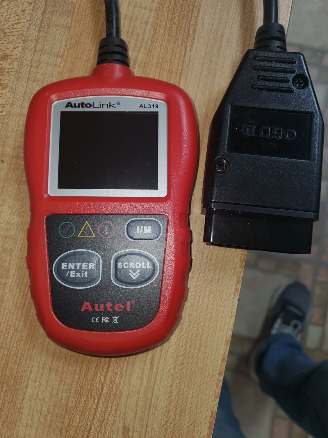

Will this code reader be sufficient?

Old Jan 5, 2022 | 02:46 PM
pdxmotorhead's Avatar
Joined: Oct 2016
Posts: 2,513
Likes: 480
From: PDX-OR-USA
Just thoughts on how I'd start,, you may have already covered it...
You will likely need to run it to get the codes.. if its had a dead battery for a while.
Based on the post timing history your fuel is probably bed if you haven't drained it..
That reader looks like its strictly a code display, you might look at a cheap cable or USB that can connect to a android or iPhone and run the torque app at some point down the road.. Or the Ultra gage.
Check how the oil looks and smells, if it got gas in the oil you'll want to drain that too.
