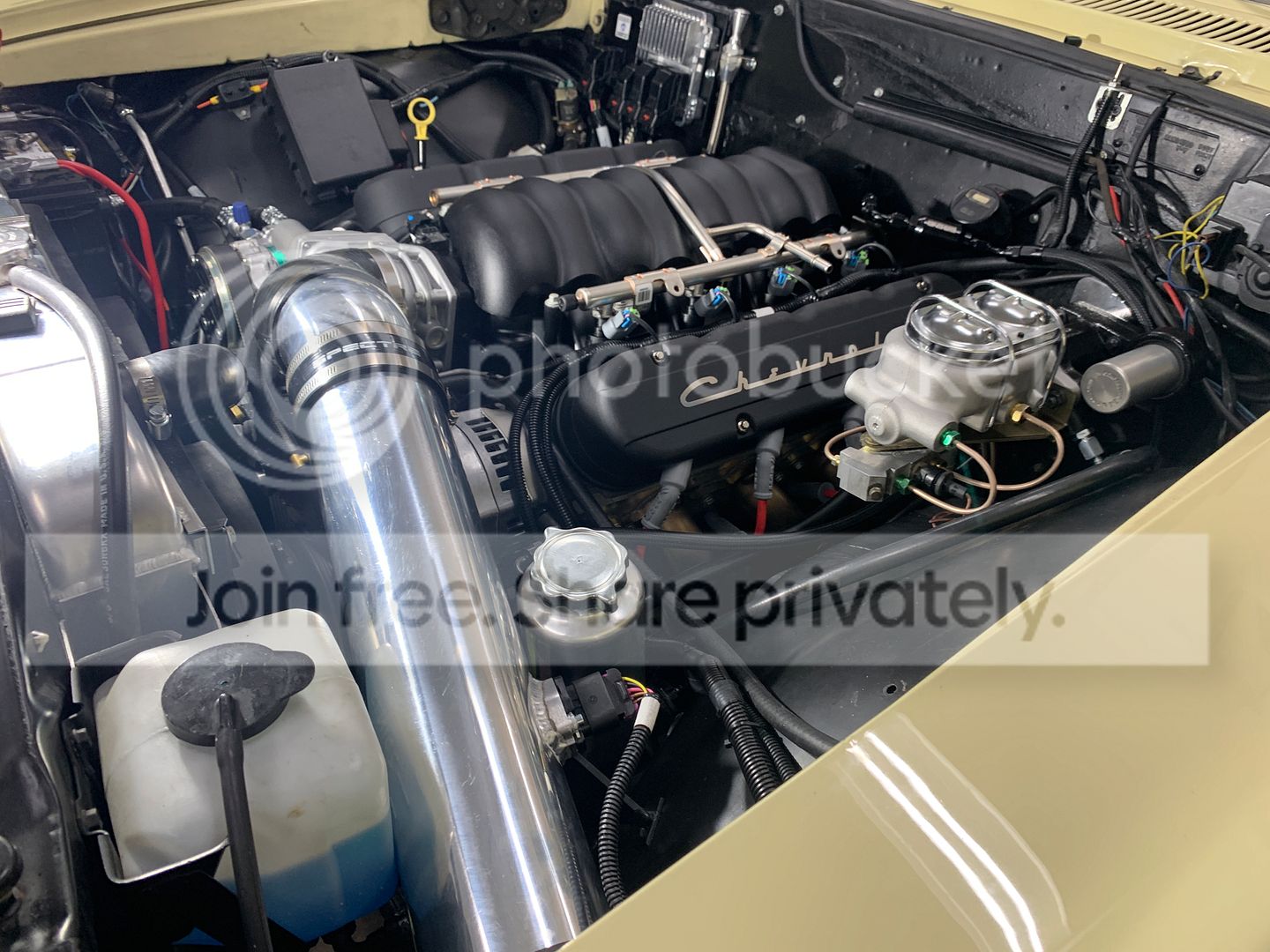

Update....... Trans back in and working correctly .......LOL..... Exhaust system back on .....everything hooked up and working except for the HydraBoost which still hasn't showed up yet...... Been waiting 4 months..... Hummm !!!!.....Probably 4-5 hours away from being finished once the HydraBoost shows up......

Finally got the Hydro Boost and got it installed..... Had the high and low pressure hoses made and installed.... Had to reposition the proportioning valve...... LOL..... Had to take the fender well out to get at the brake lines to make new ones to suit....another one of those simple things that turned into a multi-hour fix......Anyhow got the reservoir installed and hooked up .........filled the system with fluid and have to go thru the process of bleeding all the air bubbles out of the hydro boost system...... Then all I need to do is bleed the brakes and put the Hood on.....Then it needs to go for a Dyno-Tune to get the system balanced.......Another one finally finished......

Got the car finished and took it to ASSC for tuning........ Need to get the front end aligned, get the A/C system charged and it seems the steering box has a slight leak...... Might need to replace it...... Just about there.... Brakes are Awsum......

Kwhizz - I can't quite tell...what is your power steering reservoir mounted to? Do I see a bracket off the wheel well?
Thanks,
Jim

Yes....... I made a bracket that bolts to the Reservoir and the fender well.....
