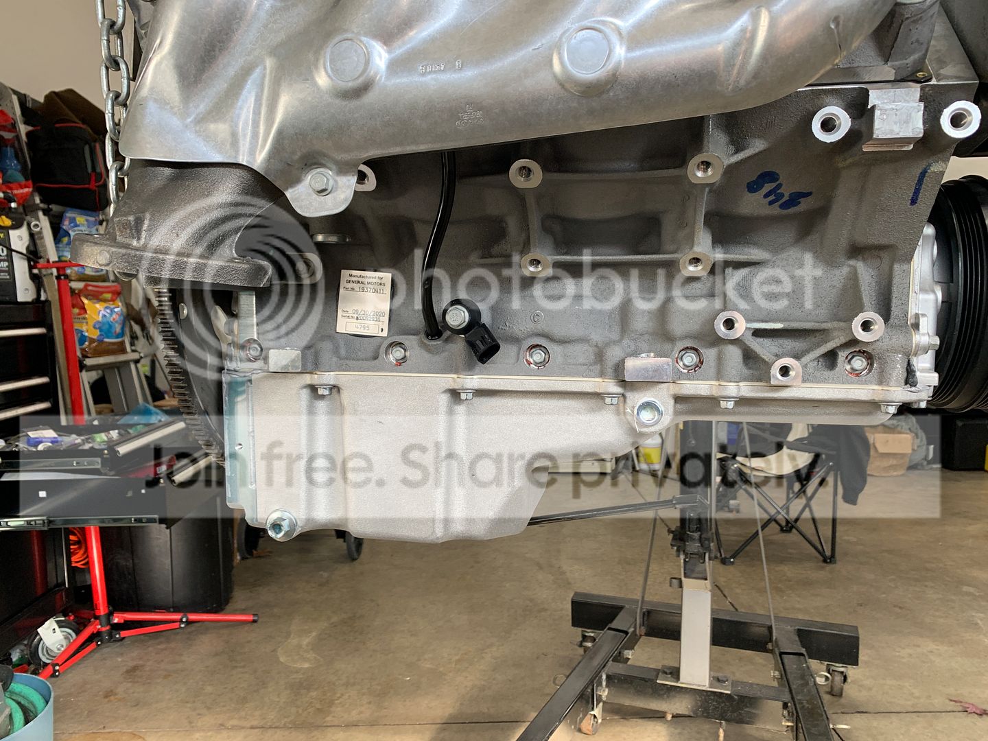

Got the Holley 302-3 oil pan installed along with the Holley mid-mount front drive assy...... Waiting for some trans cooling line fittings to show up to continue with the assy.... Also the Rick's Tank is here....

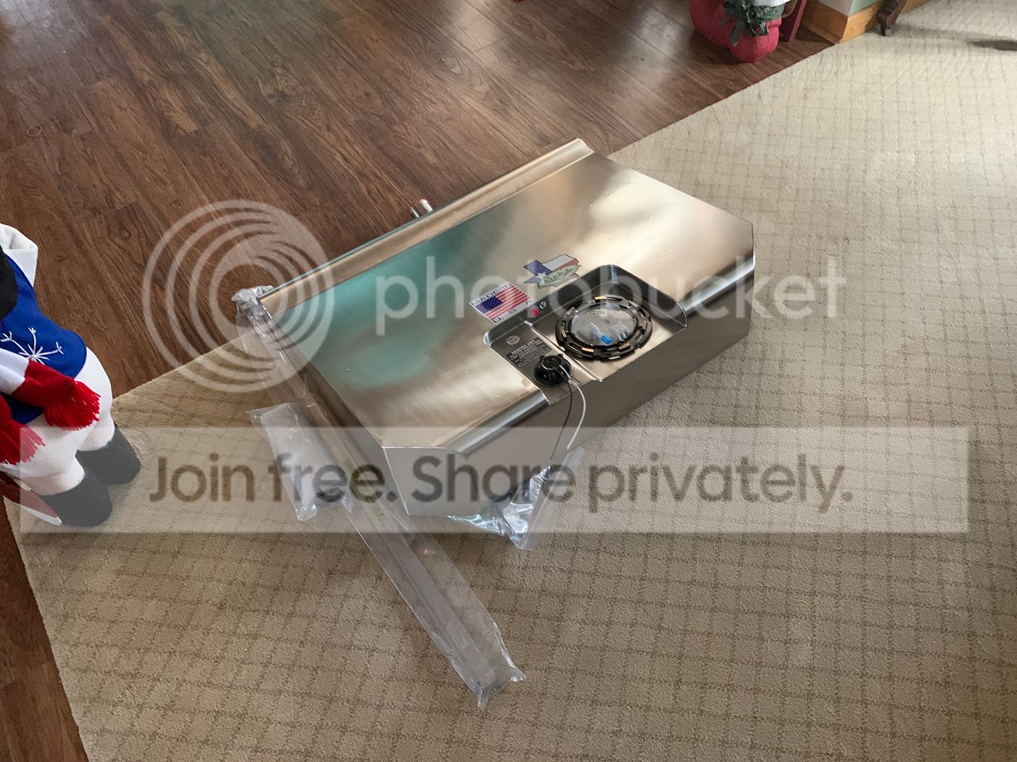

Got the Rick's tank plumbed and ready to install with the Vaporworx sensor and wiring......Simple day without any issues.....
