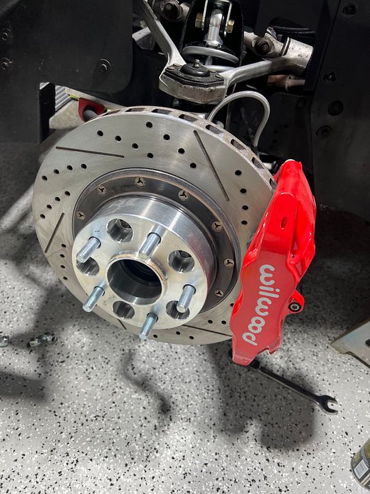

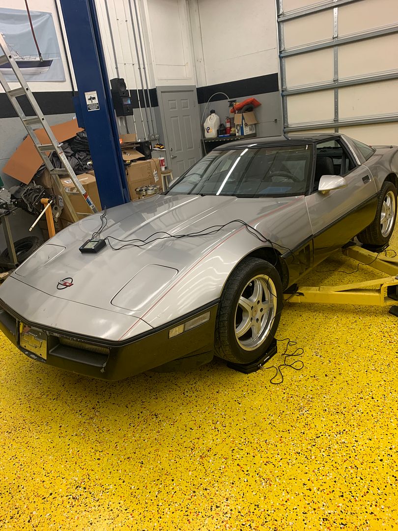

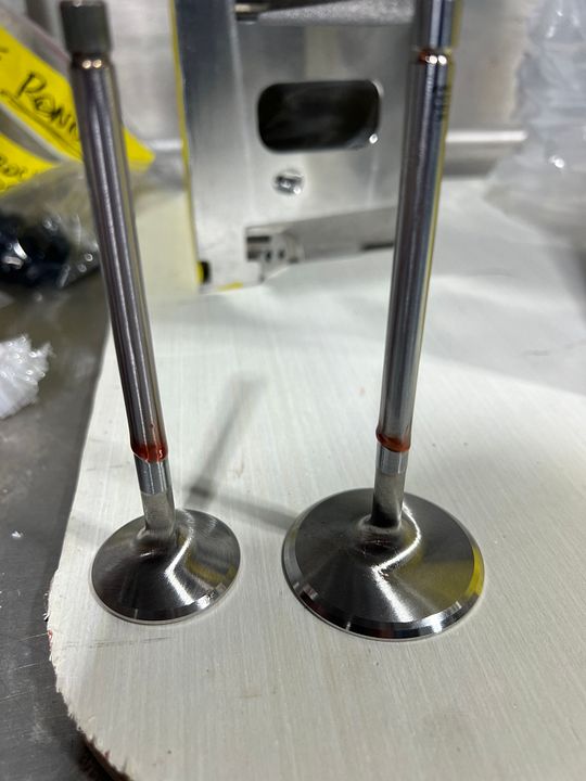

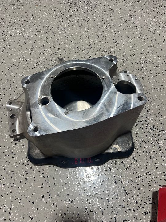

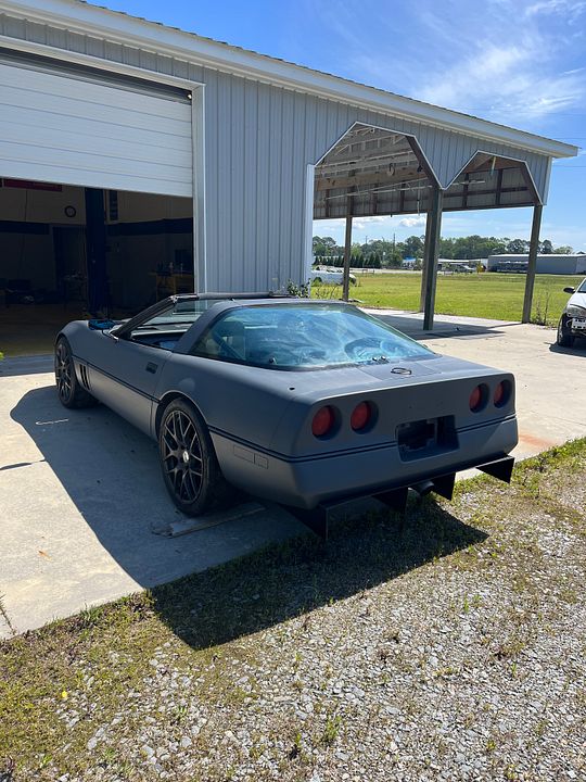

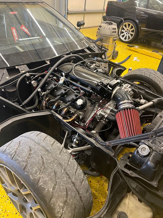

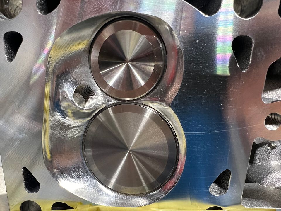

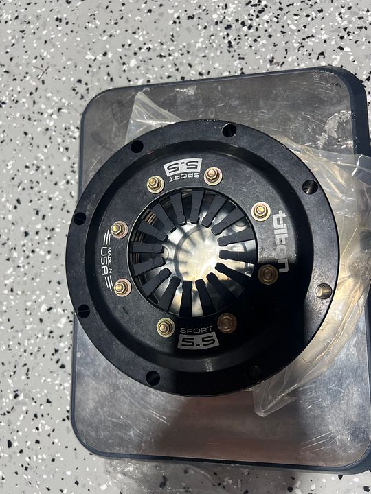

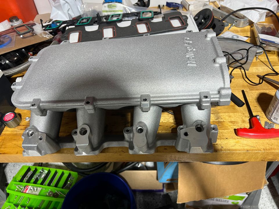

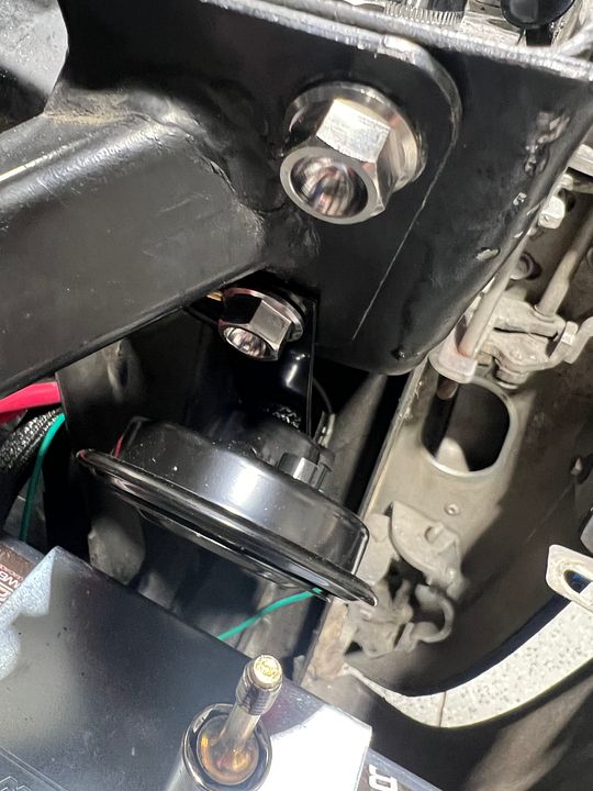

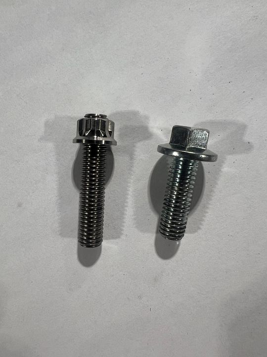

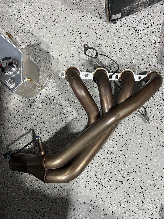

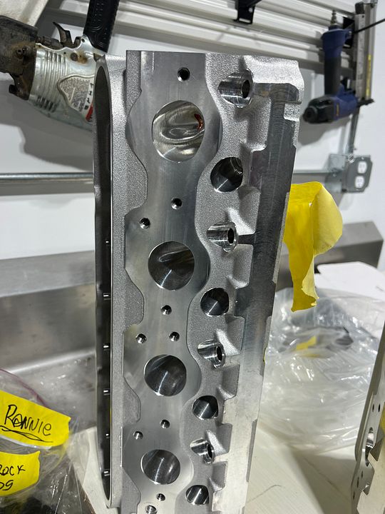

After driving the car for over a year I decided to fix a few things and i took it apart last december. Since then it has gotten out of control on the quest for more power and less weight. I almost have it back together now and hopefully this fall I can drive it again. The car ended up weighing about 2500lbs with the old set up. But I have dropped alot more since then. It made 492whp on a dyno jet with the old set up .
Here are the pics of the old set up
Old Oct 9, 2024 | 04:53 PM
topspeed1's Avatar
Joined: Apr 2017
Posts: 305
Likes: 11
From: Washington NC

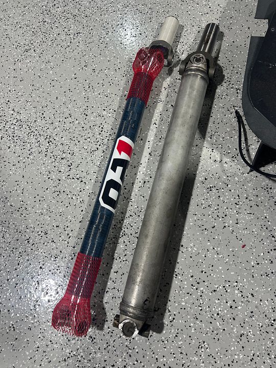

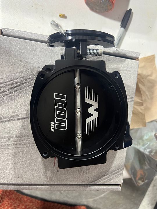

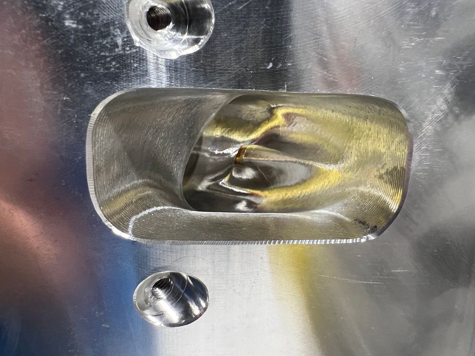

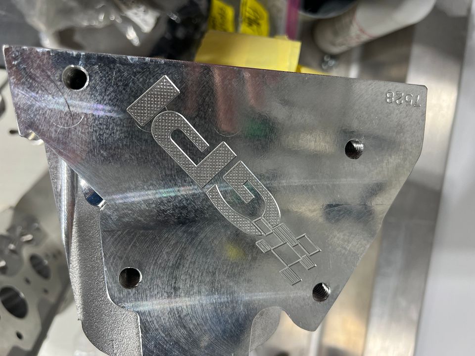

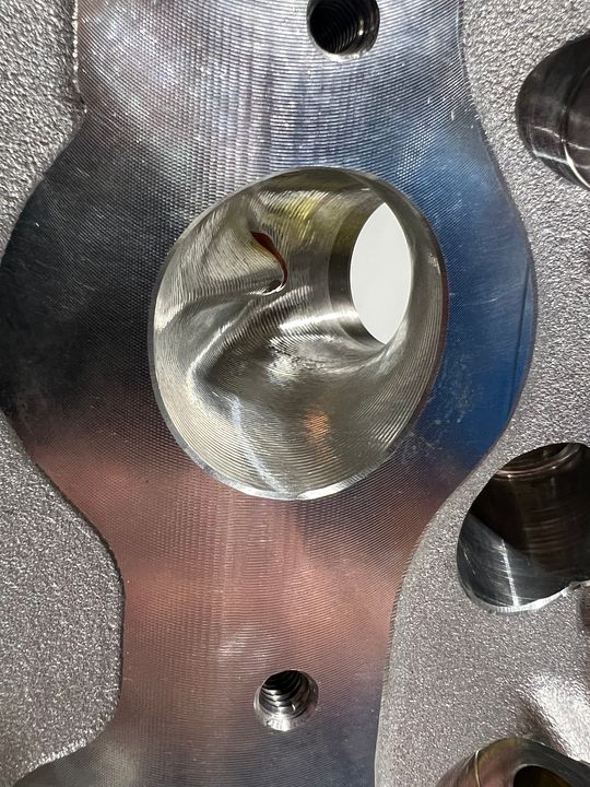

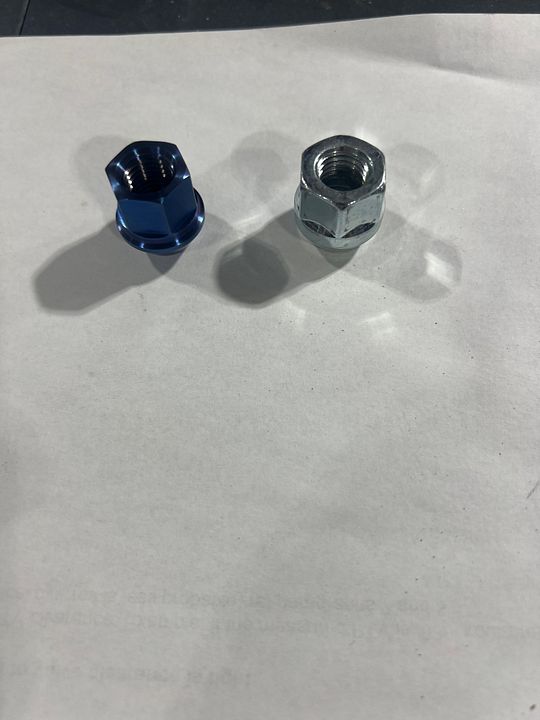

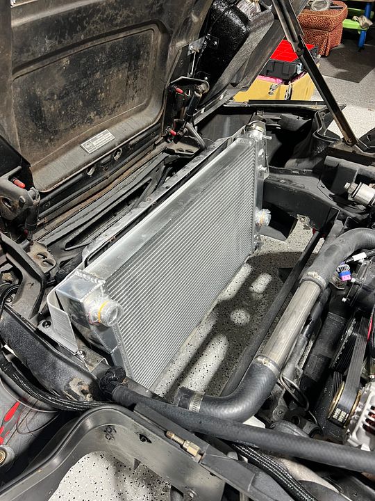

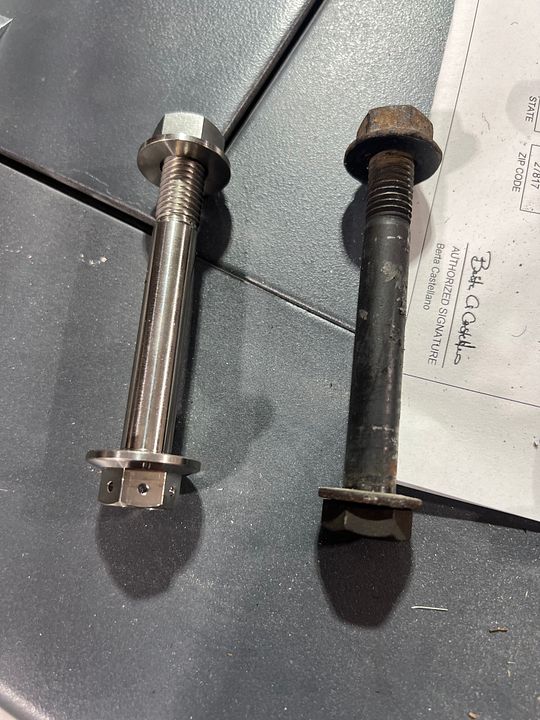

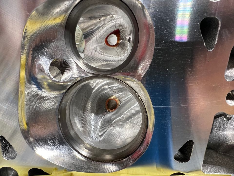

The new set up I am working on
Upgrades I am working on now.
2 inch headers into dual 3 inch center exhaust.
holley ultra low ram intake and motion throttle body. Awesome pieces but they do weigh more than my current setup
holley intake fuel cell pump to replace my out of tank set up.
larger aluminum radiator which is going to weigh more bc of the higher capacity.
I have been replacing bolts with titianium ones where i can and also aluminum bolts on non critical components.
Gutted hood
I just picked up a set of baer two piece front rotors which saved 2.5 lbs per side.
GPI Heads
Tilton 5.5 Clutch
Carbon Driveshaft
Rebuilding the transmission with gun drilled mainshaft lightened gears and roller bearings

do you get hollow stem intake valves in the heads for weight reduction?
Old Oct 11, 2024 | 12:24 PM
Jimbo1367's Avatar
Joined: Jul 2009
Posts: 8,028
Likes: 660
They should be replaced for longevity of the valve train alone.
