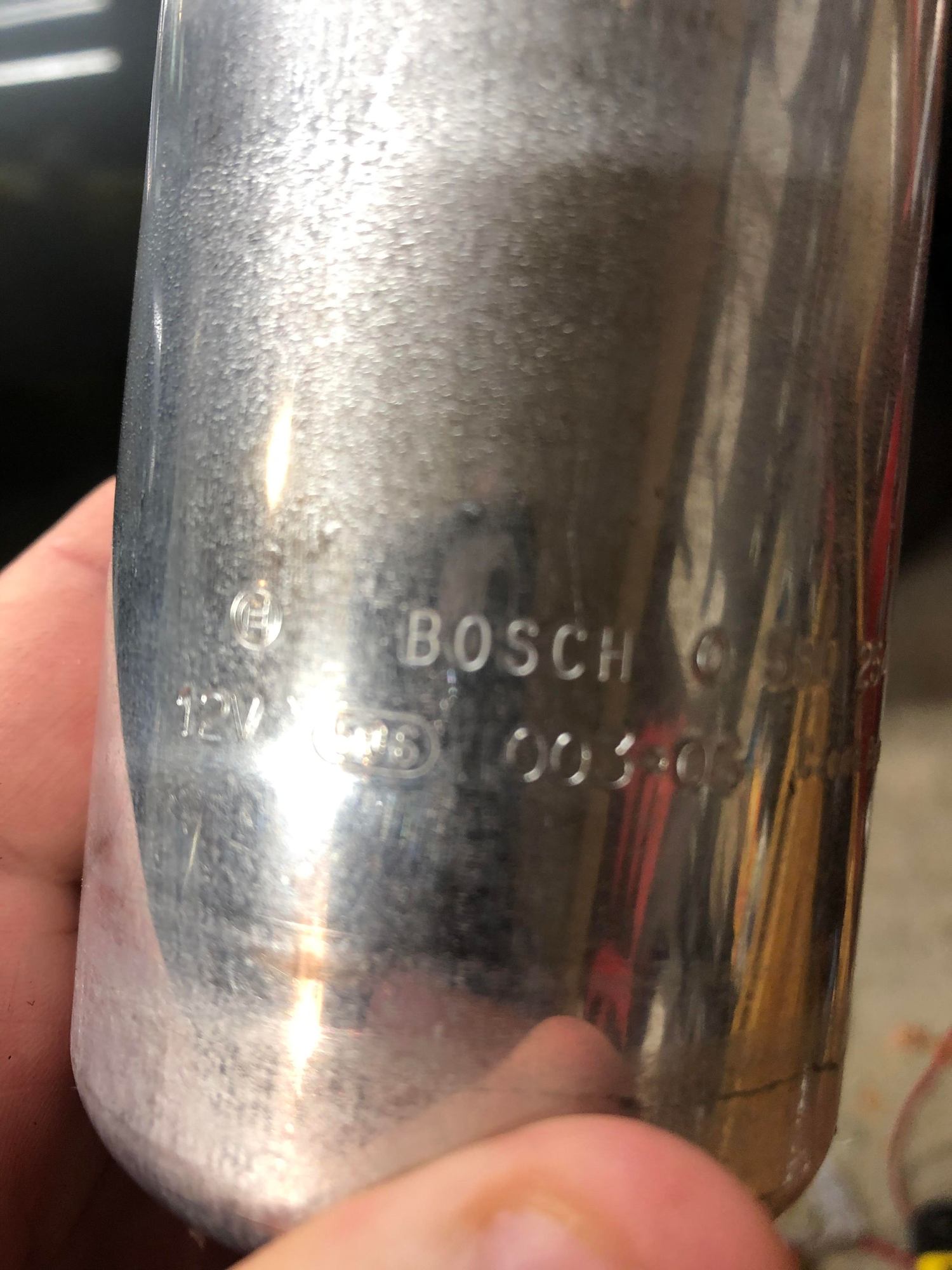

Hmm i can go take a pic of my spare 044 new in the box

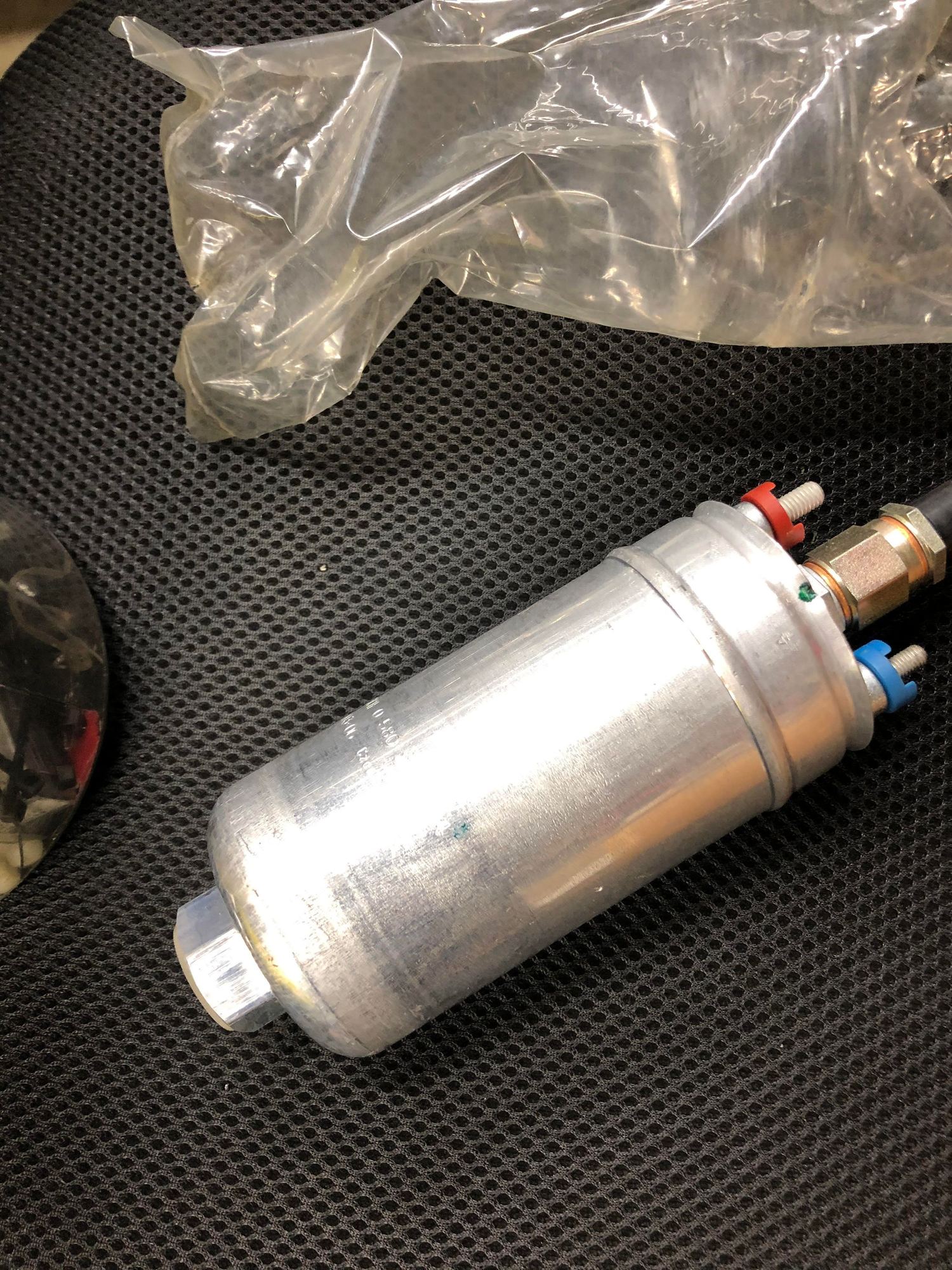

pics

He is talking about the banjo outlet fitting. Which is also a check valve. It can be removed. Also many come with an AN8 adapter.
The issue is clearly that baby pre filter and line. Remove it and install something suitable and continue on with the Walbro IMO. I doubt that setup needs the 044 and they are typically louder. No reason to reinvent the wheel here. -8 feed and use a filter with some actual media area. Somethign like this...
