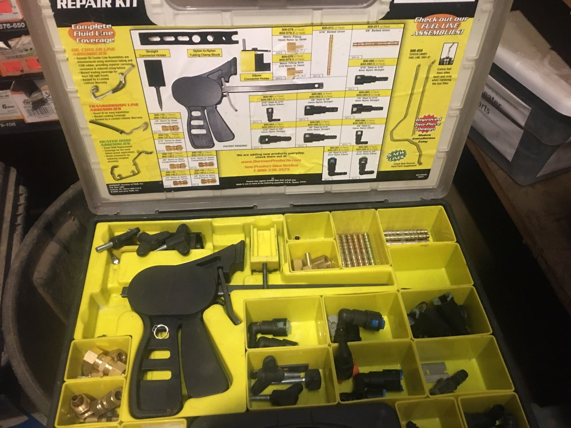

Another option is buying a roll of Nylon line and some fittings from Dorman. I've done it on 3 cars/trucks now with zero issues. I used the "caulk gun" method to press them in rather than heating the line in boiling water. I have 3/8" line and will do so with my LSA swapped LS3 engine and have no expectations that it will be a restriction. Much more concerned with fuel pump and/or injectors.
I like this approach as well. OE quality fittings. I use this kit a lot for fuel lines...
