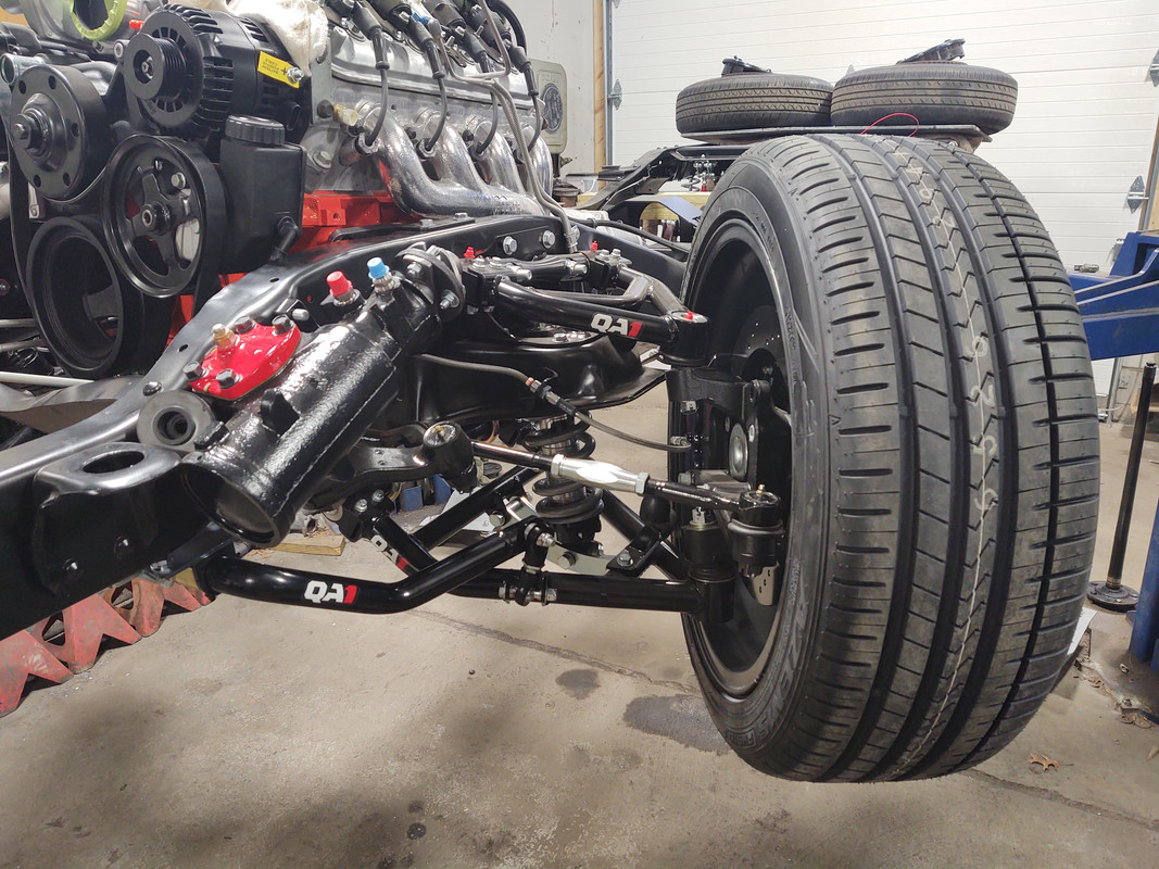

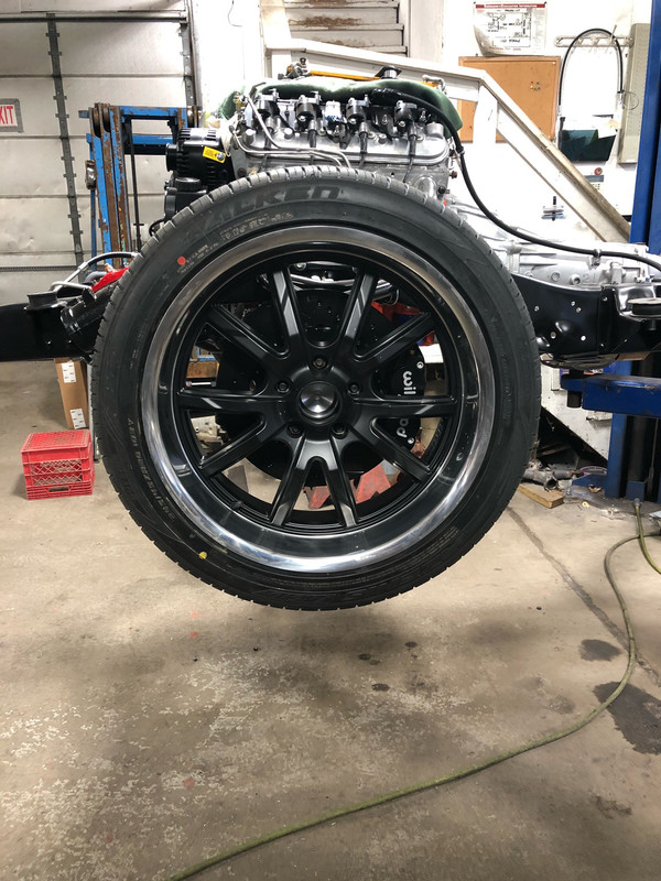

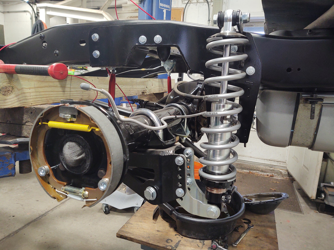

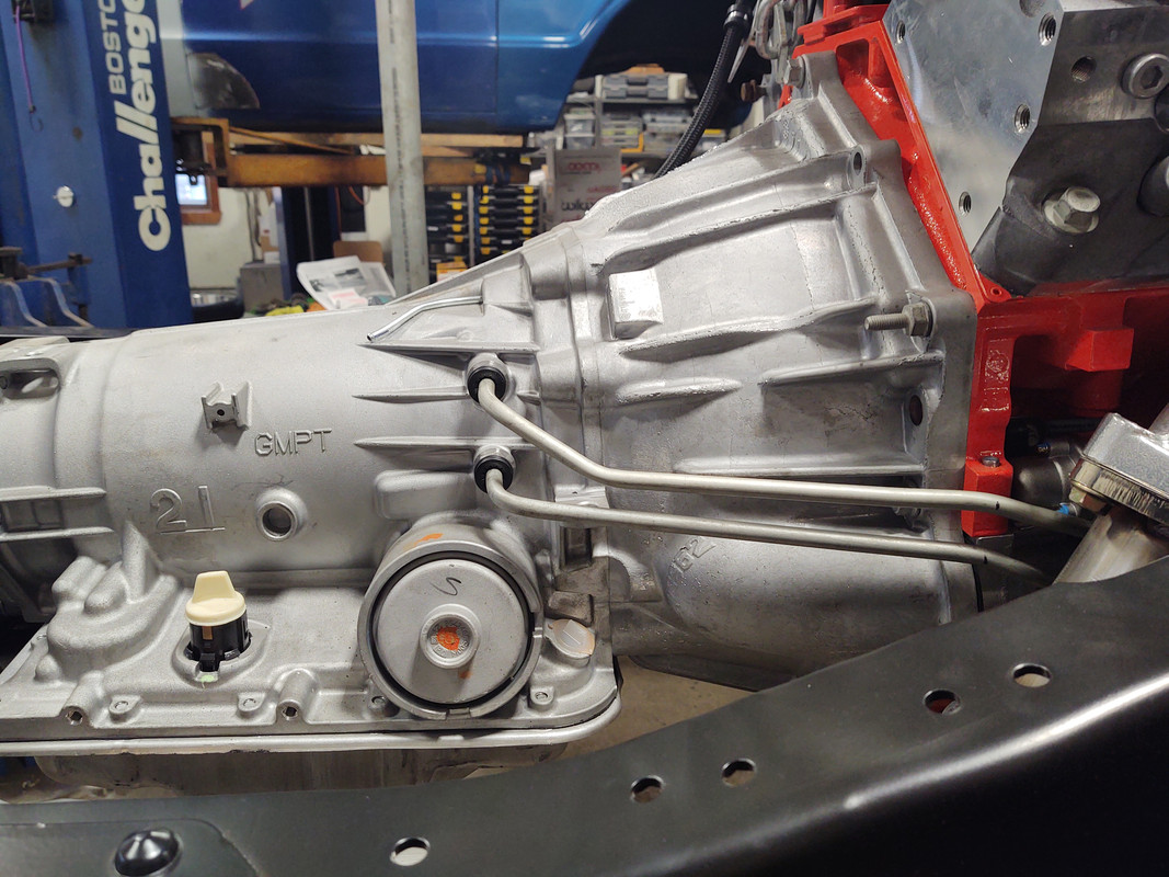

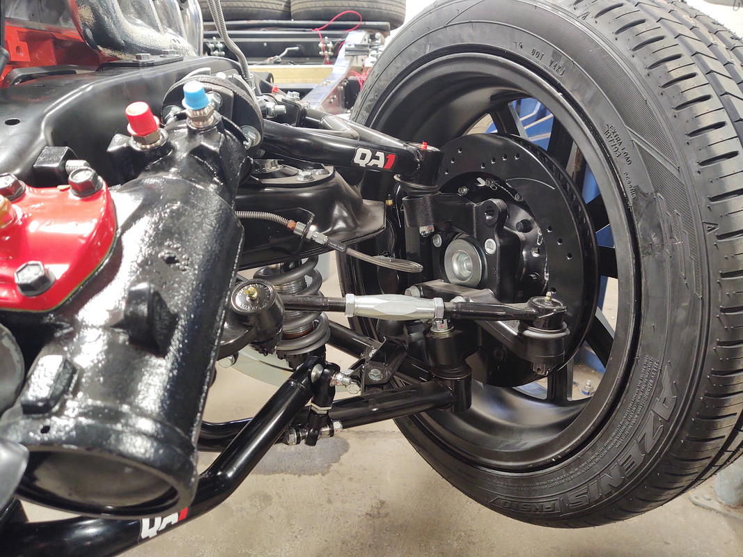

Some pictures from today.

Wow...some nice parts in your build.
That being said, I ran a 5.3L/4l60e 3.73 28" tire combo in my wagon before I went to a T56. I thought the 3.73's were a great gear with that combo...
