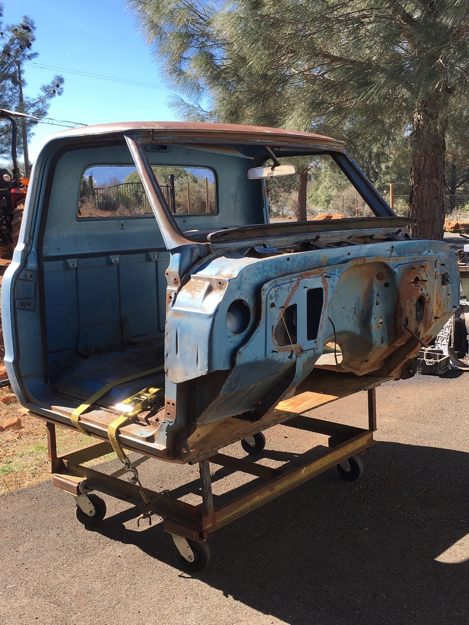

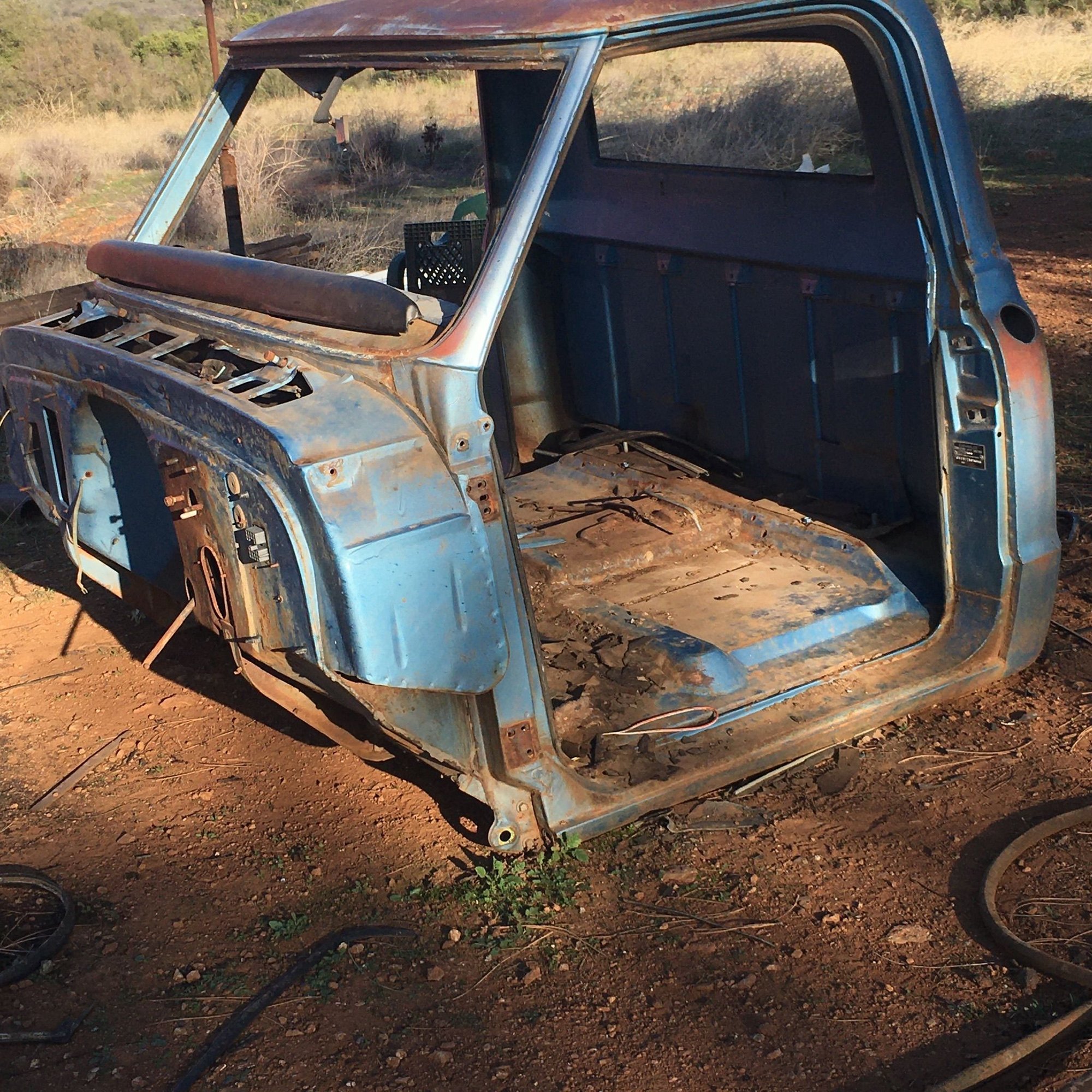

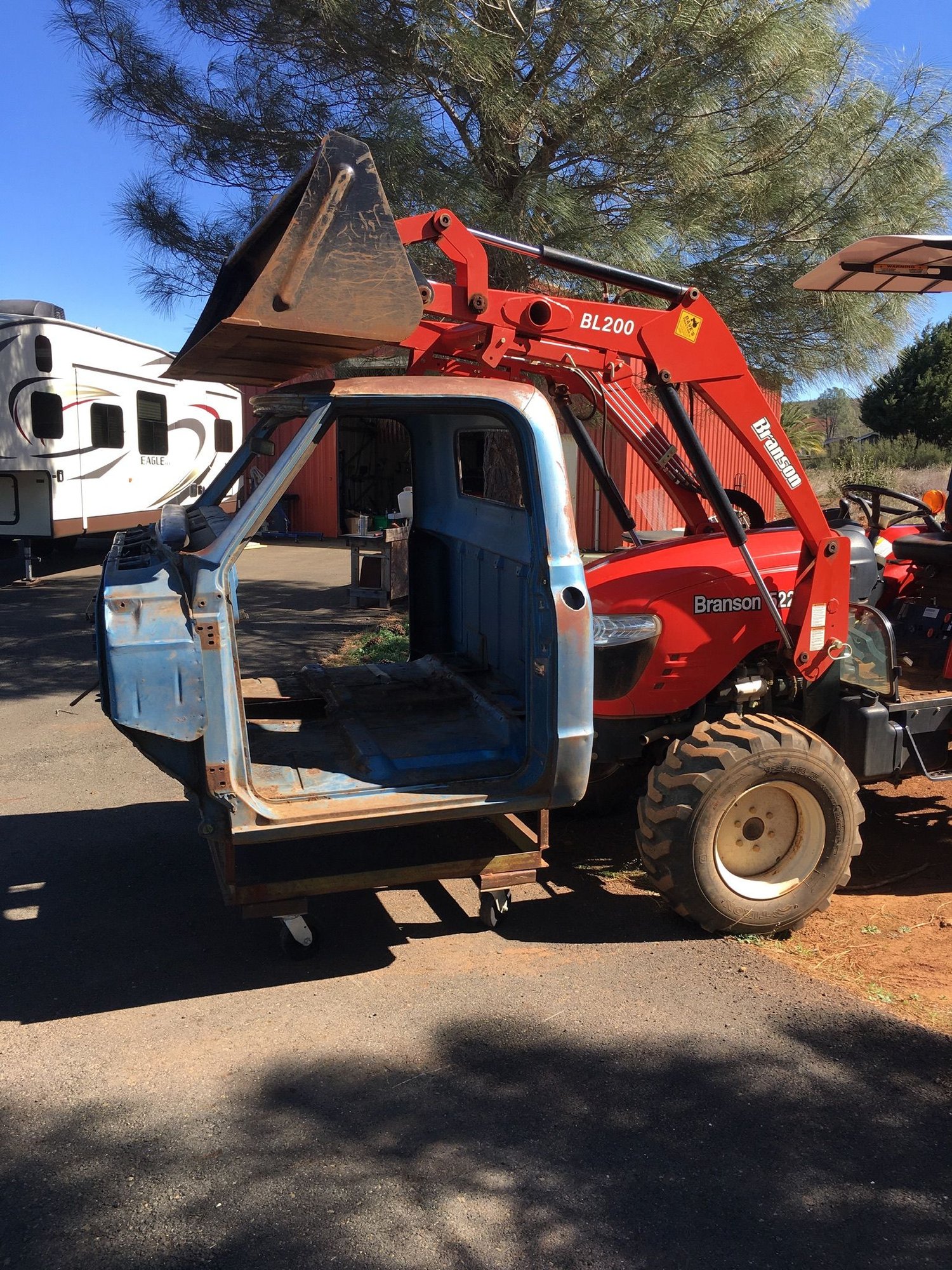

Well, finished stripping the cab and it’s been put on the dolly so it can be brought into the shop, I’m doing a little sand blasting on the scale and surface rust outside right now but that is a REALLY slow process . As it turns out, I was all wrong about this cab being rust or rot free, after removing sill plates and sound deadening tar it has some cancer but not so bad that it cannot be fixed. The passenger outer/inner rocker boxes will need replacement along with a good sized portion of the floor panel so I ordered up those pieces" In the meanwhile I’ll get started on removal of said parts. Drilling spot welds can be a bit of a bitch when you can’t find them. I used my tractor to set the cab on the doll (carefully). Removed the glass.
