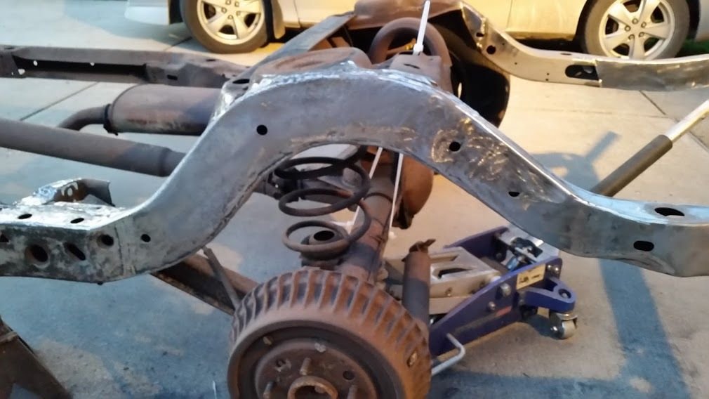

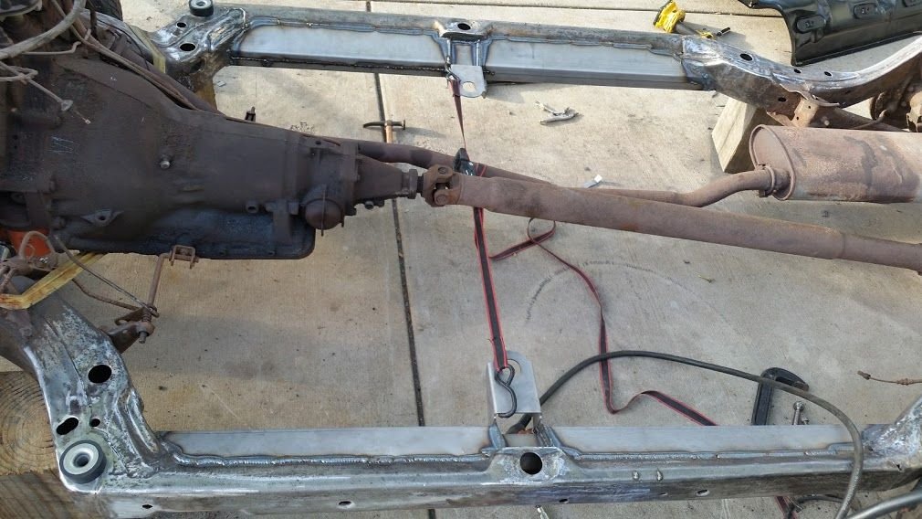

I wish the P.O. never tried to fix this thing, it only has 30 thousand miles. It was sandblasted and then got wet. Any little spot of surface rust or any holes were buried in all metal. Even on the frame where the body mounts sit. Not so good welds slathered in all metal filler. There were mouse nests inside of the frame rails in a couple spots, causing rust, that they covered in all metal. I cut it all open and replaced it. While I was in there I narrowed the rear rails and boxed the center of the frame rails with a kit from Hellwig. Turns out I barely took any pics of this work.

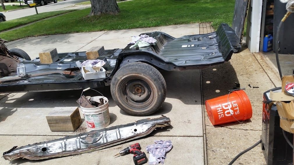

I ended up changing the whole floorpan and trunk pan, as there was bad welding and brazing onto the small amount of rust there was. I started to try and get the old repairs out but gave up and cut my losses. It turned out better.

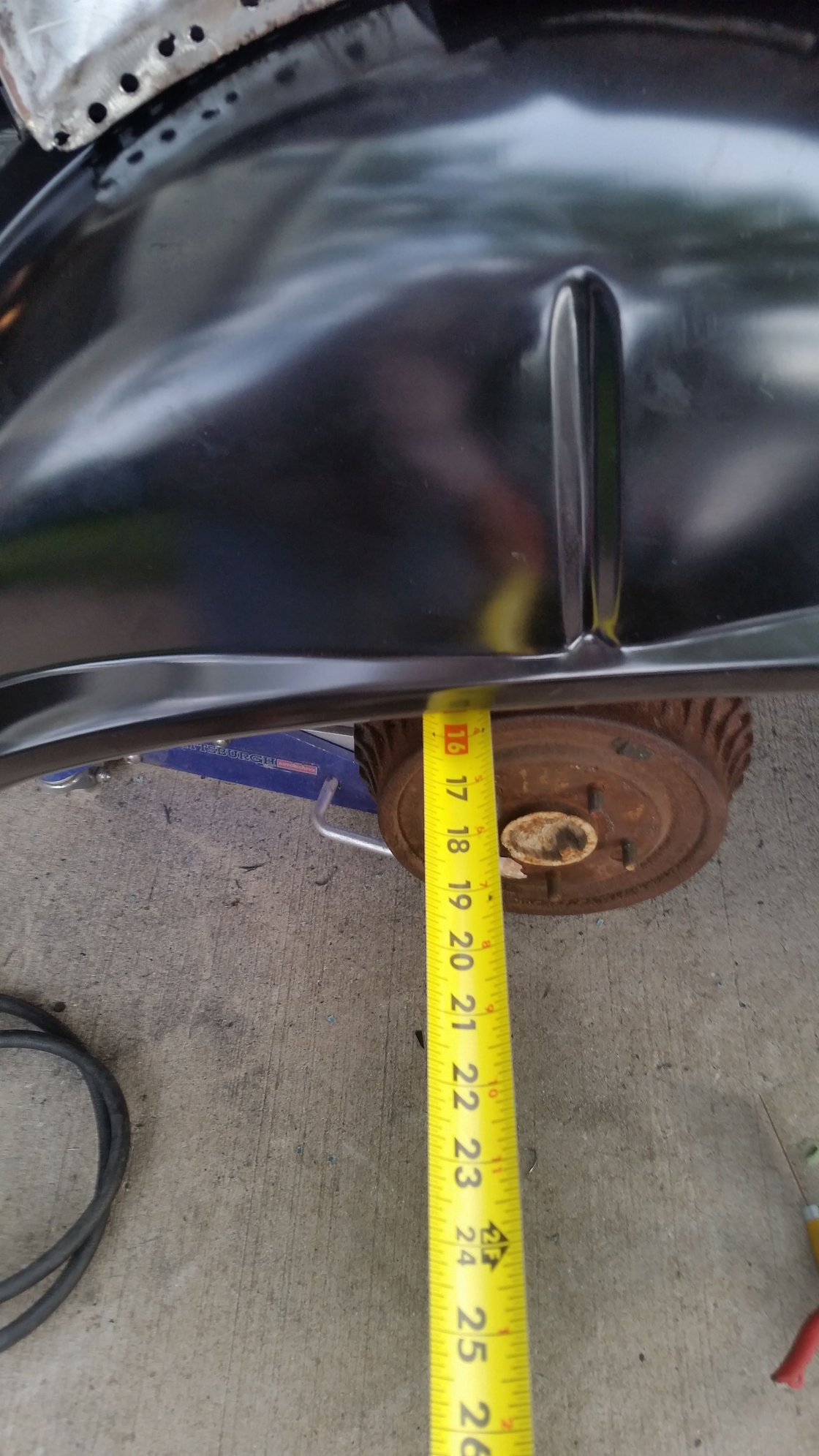

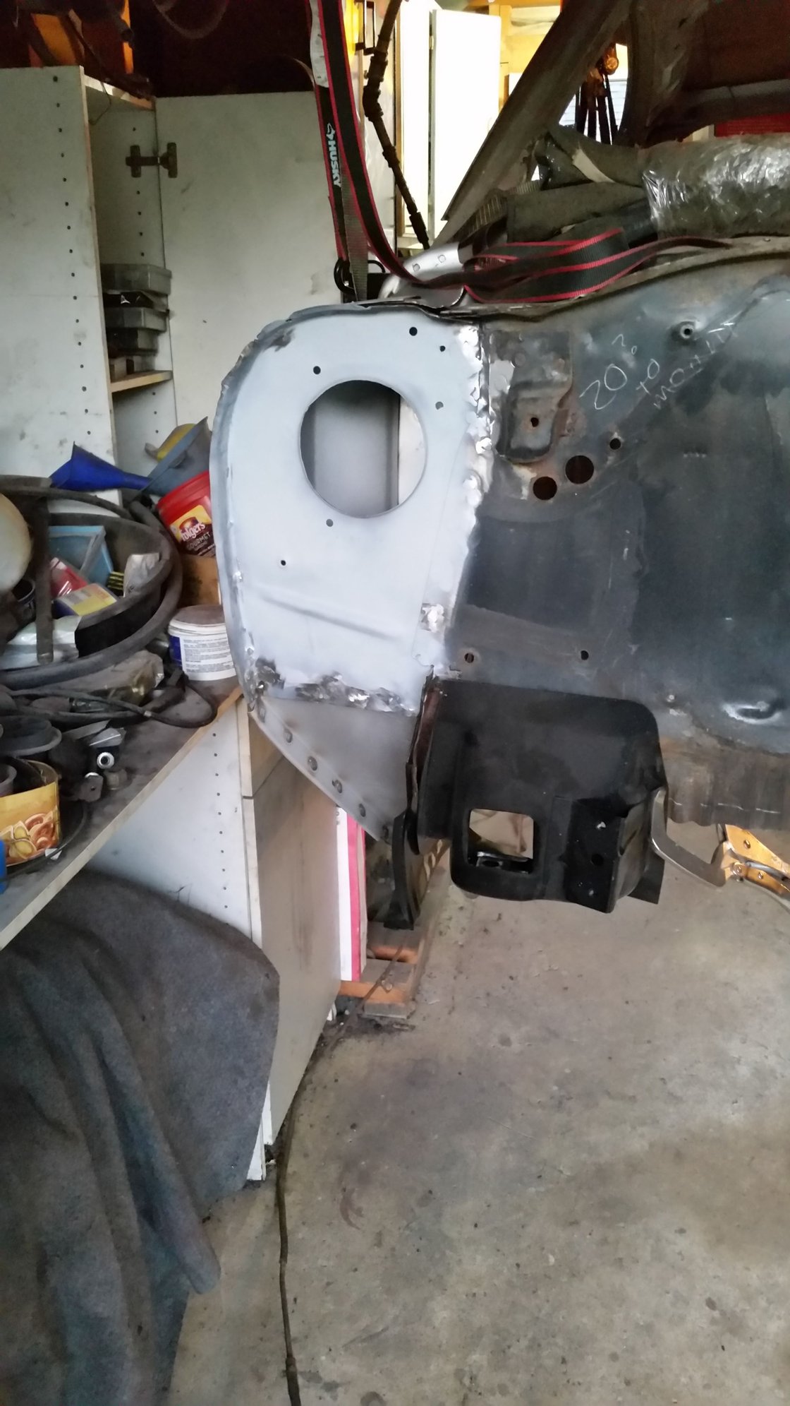

I have a few more updates until its at current time. Since I narrowed the rear frame rails, I then widened the inner wheelhouses to suit.

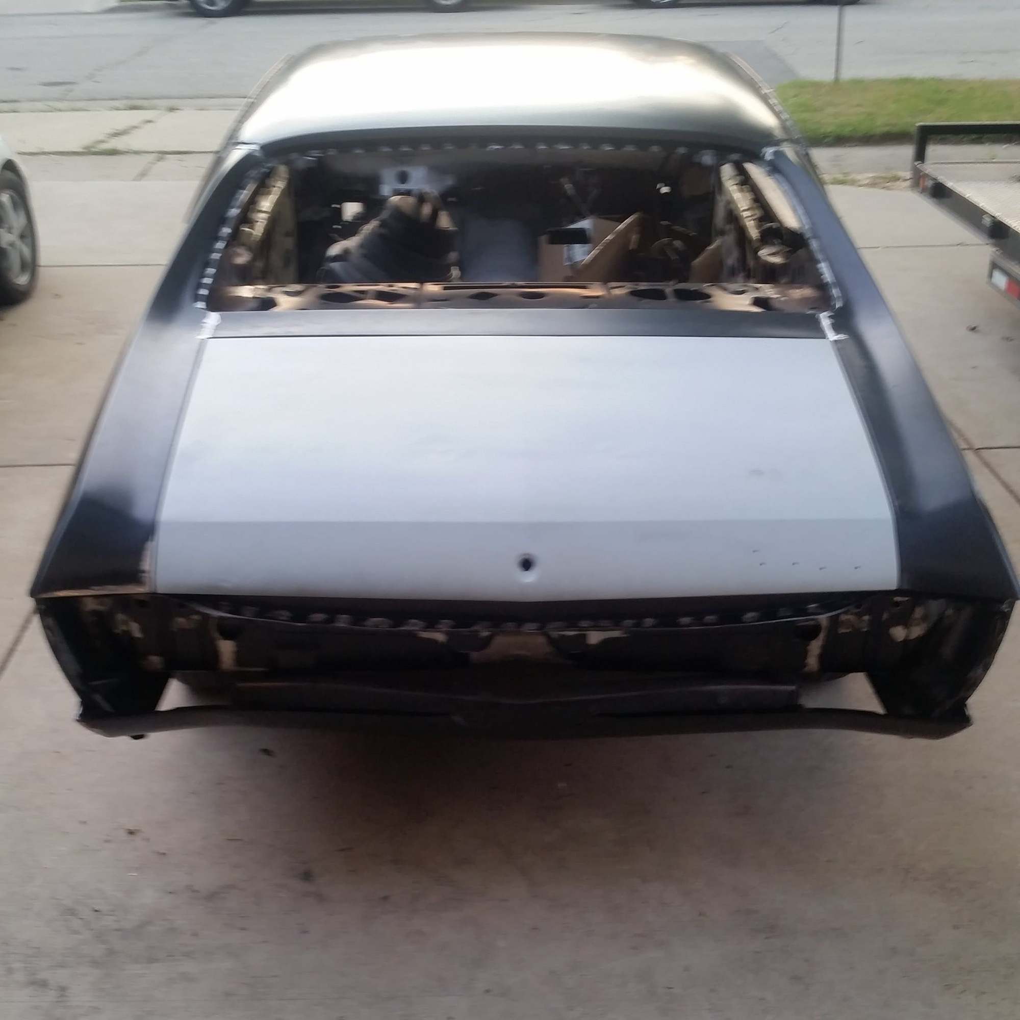

This car had a vinyl top so the window beds were in tough shape. I replaced the quarters as they were cut half off when I got the car. There were 5 doors,extra fenders, used trunk floor and so many other spare parts that came with. The inner structure was all cleaned and blasted before paint/primer. Then new metal.

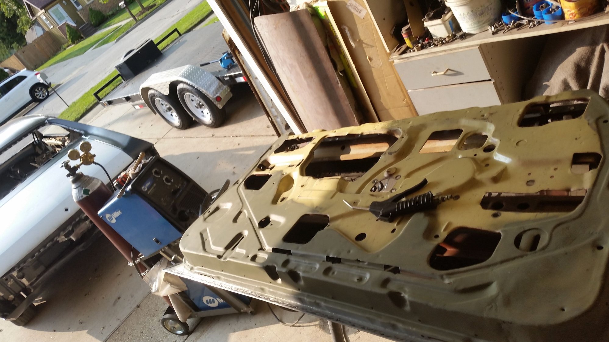

I had trouble getting all the parts I ordered. A bunch of stuff that I had ordered never came. A few things just weren't available. I used a 69 trunk floor and sectioned in the 70-72 rear bumper mounts. Repaired the door shells so new skins could be installed.

Got the roof skin welded on, along with the upper cowl.

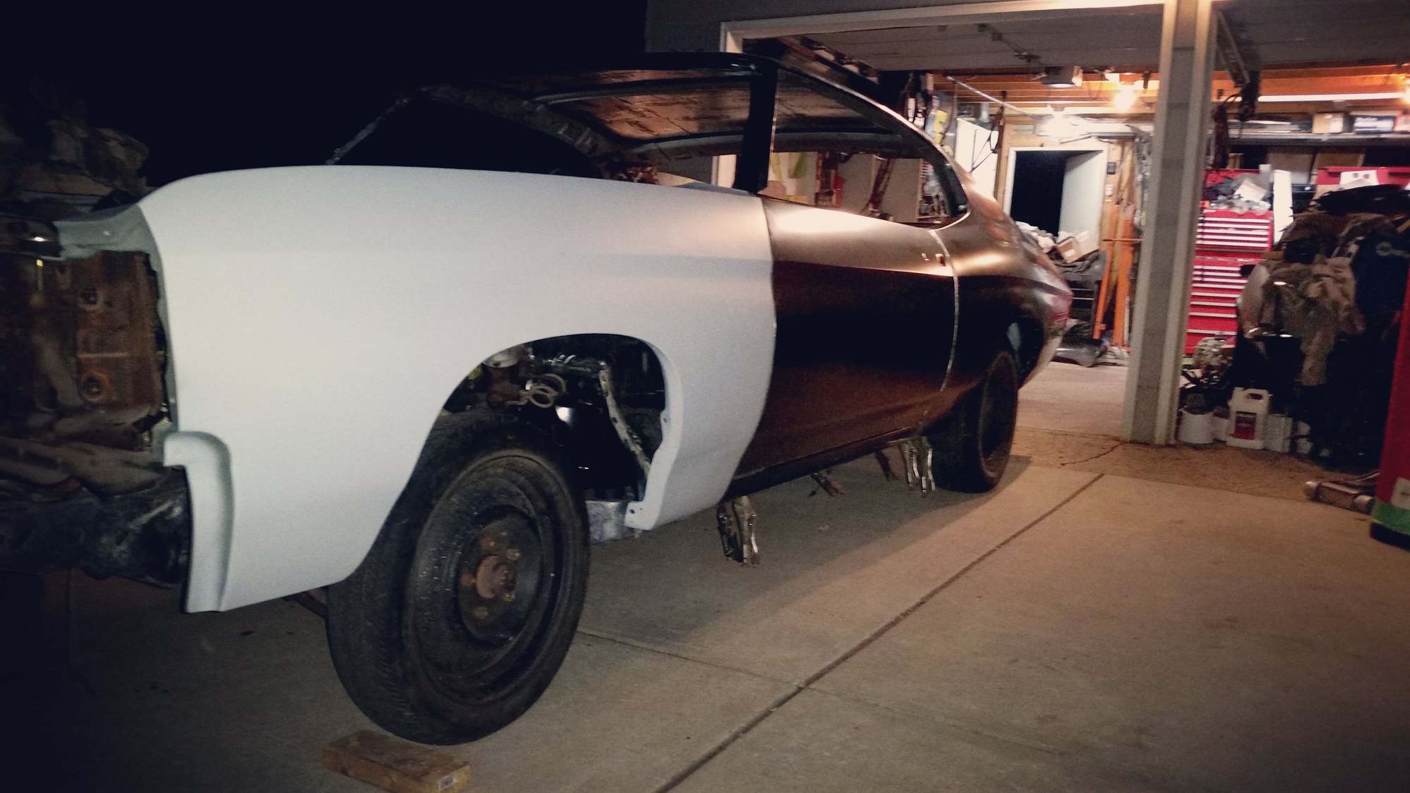

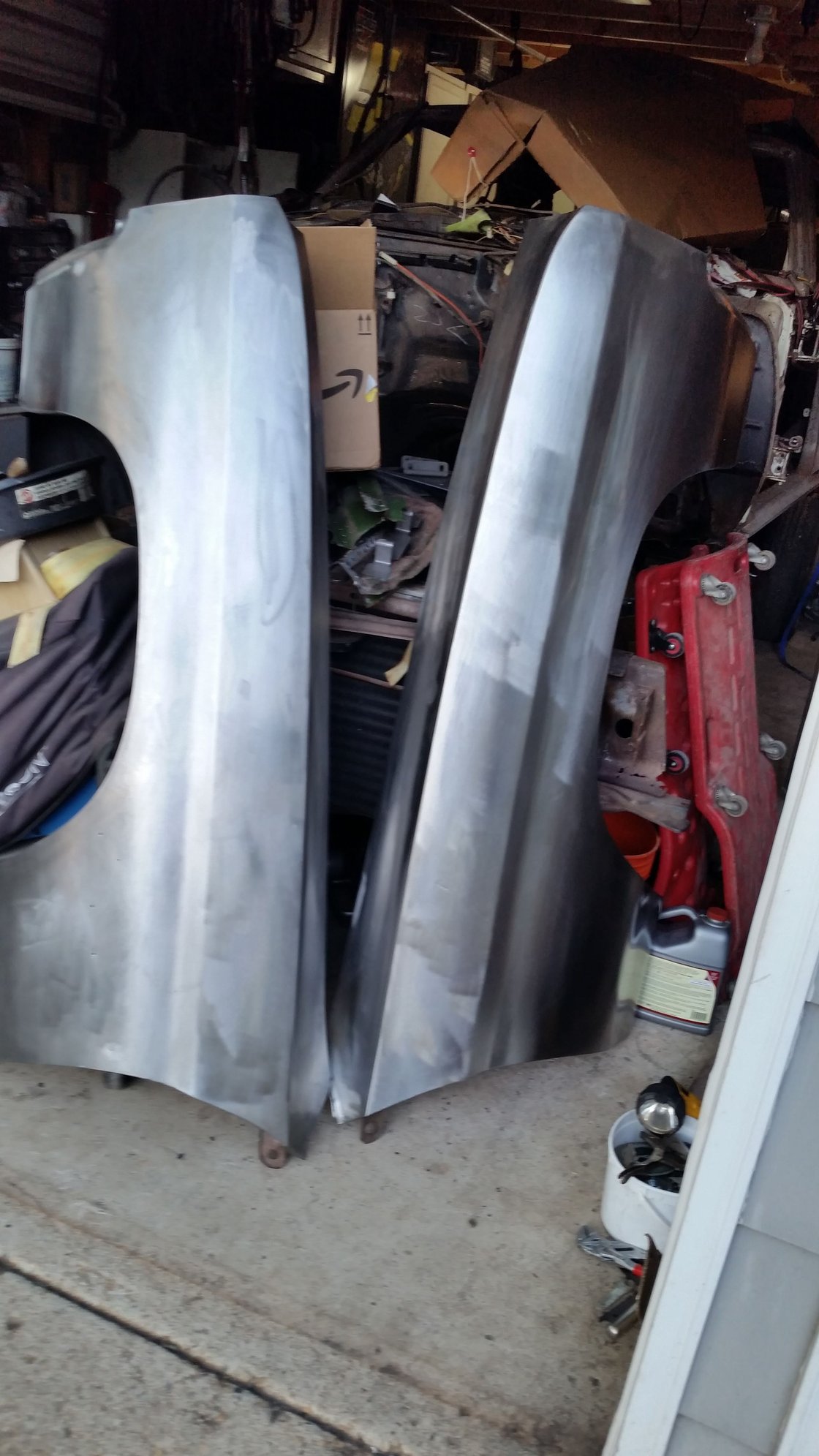

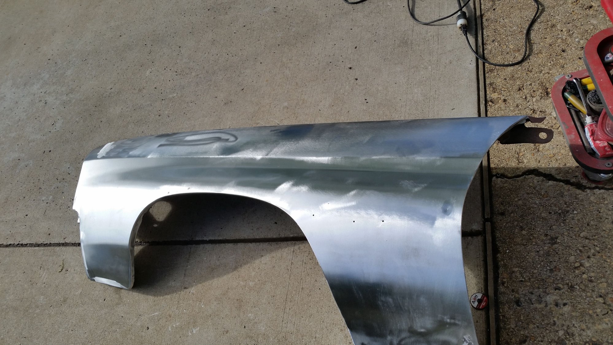

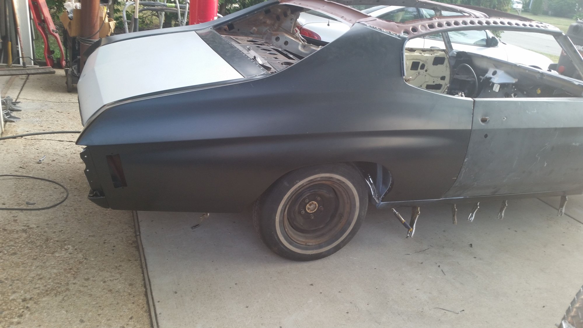

I picked out the best of the parts that came with the car. There were GM fenders for both sides. One was never painted but left outside. The other had been edged out for instalation but had also been left outside to collect leaves and pine straw inside and rust. A ton of elbow grease, a patch panel and some sandblasting got to here.

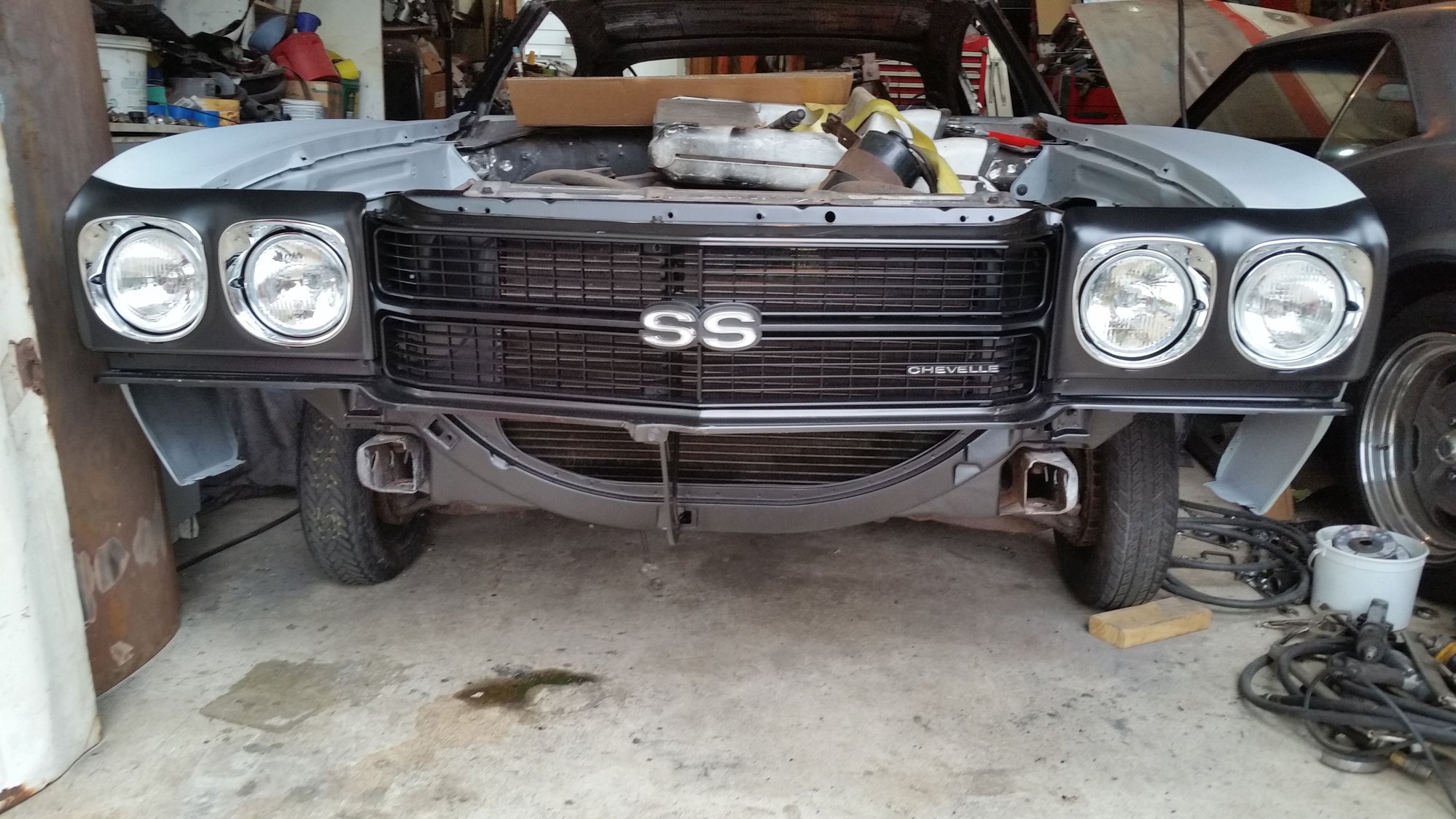

I spent a bunch of time getting gaps looking good. Way too much time. Also so as the title states, I like the look of a 70 better.
