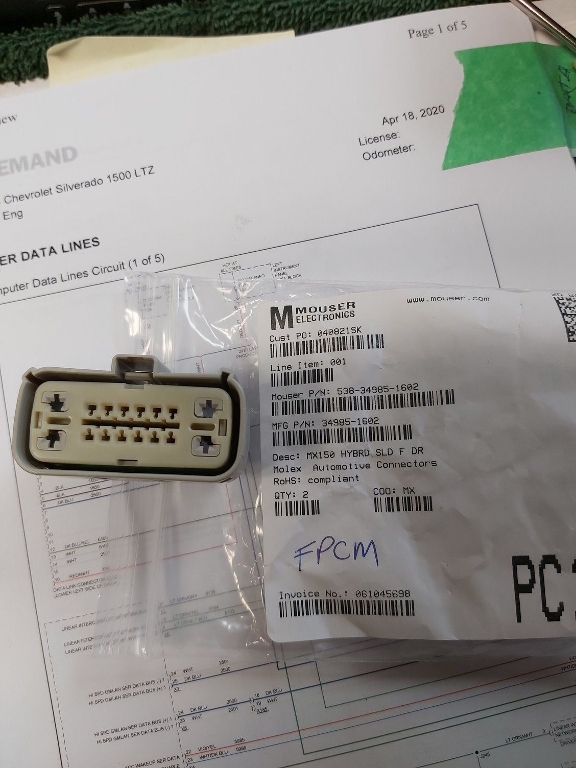

After many hours spent searching I did find the right connector. It is a molex 150. I purchased it from Mouser Electronics. I also found the fuel pump connector at mouser.
Old Apr 15, 2021 | 05:18 PM
Kainz's Avatar
Joined: Feb 2018
Posts: 8
Here is the fuel pump connector for the oem pump fuel pump from a 2014 silverad
