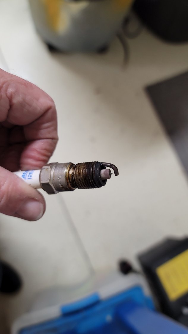

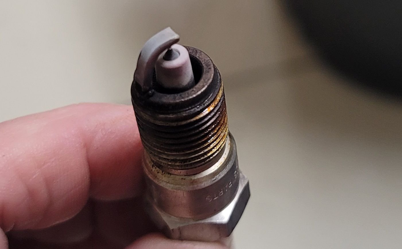

Below are a couple pictures of the plug attached. Frankly I don't think the plug looks too bad. But I think I may replace them anyway giving the experience I had on my 56.
To some extent I probably exaggerated how long it had been sitting. The gas that was less that was in there I don't think was put in that long ago. I don't know how long it would take for gas to " go bad".
The P0303 has only happened once whereas the others were P0300, I don't know that the codes were consistently against the plug three. I'm going to follow the advice about swapping this plug with one out of a different cylinder and see if the error continues and continues to be on plug 3. I'll post back how the test goes.

Those deposits up in the shell around the center insulator can/will promote misfire. Appears like some excess oil in that cylinder. How do the other plugs look? Stock heat range?

Those deposits up in the shell around the center insulator can/will promote misfire. Appears like some excess oil in that cylinder. How does #3 plug compare to the other 7?
Thanks for noting it. I'll check tomorrow. Frankly, I didn't pay much attention to 7 when I pulled it. I'll be looking at all of them in more detail when I get the new plugs.

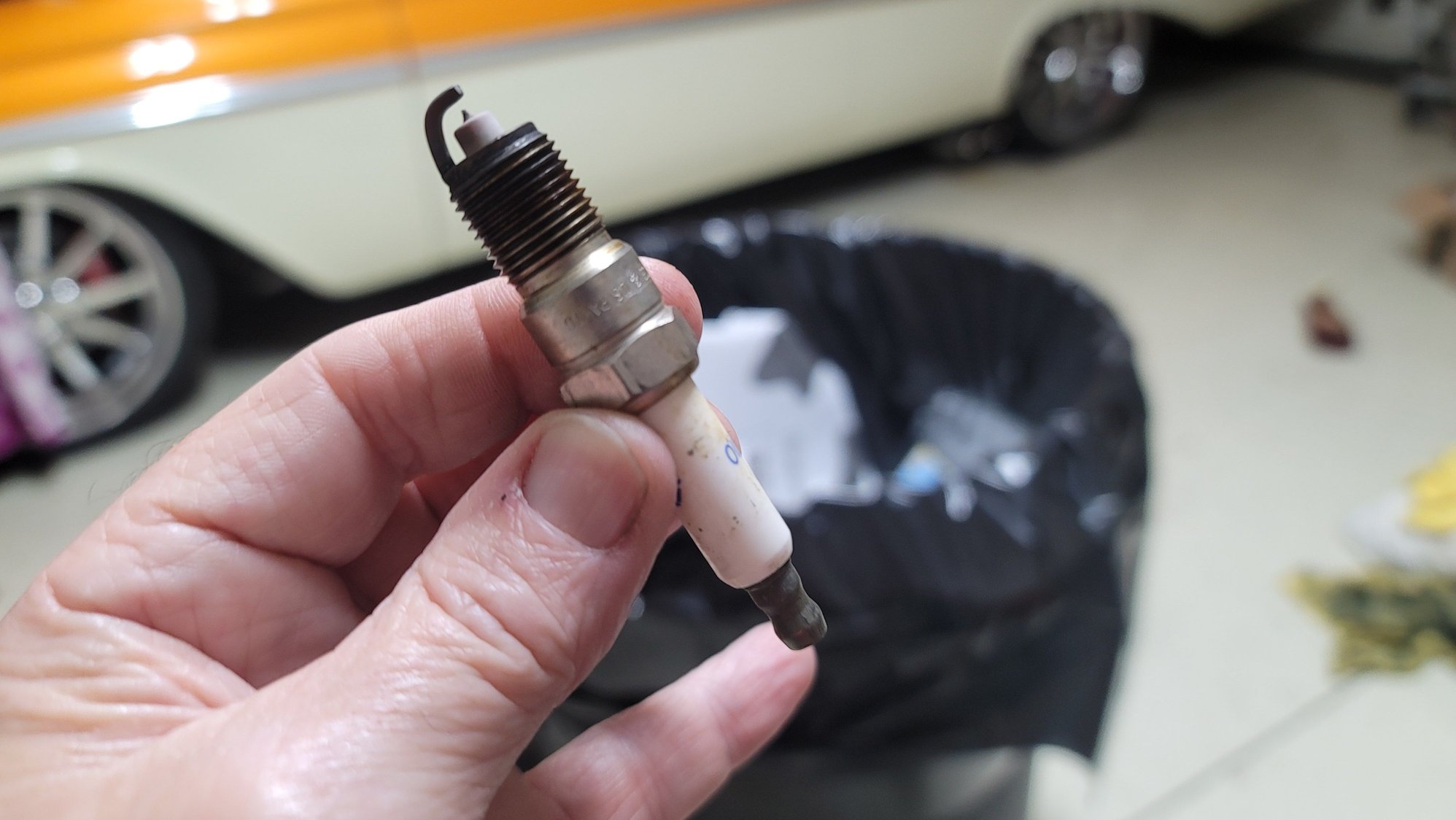

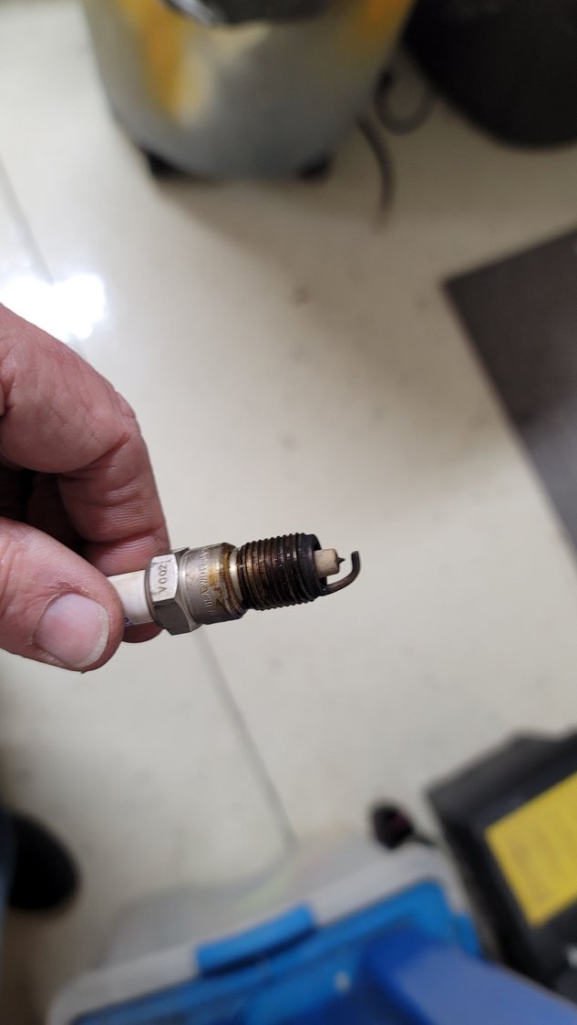

Here is two sides of one plug, all of which pretty much looked the same:
