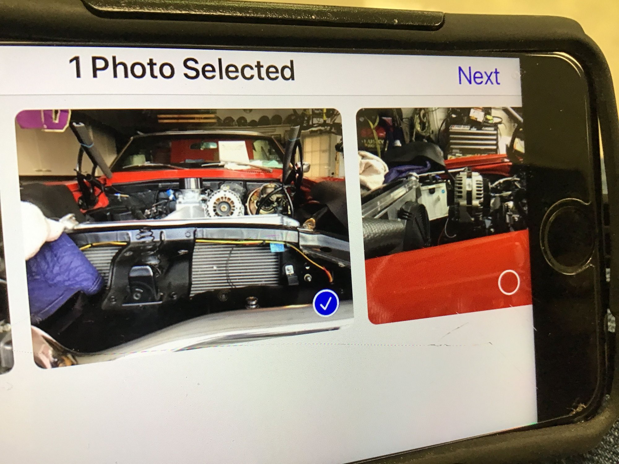

Options galore. On my 3rd gen Nova LY6 with LS3 intake (similar to your L92) I use the 2010 Camaro L99 waterpump, tensioner, and power steering with a truck alternator mounted in a spaced-out '02 Camaro bracket and a truck AC compressor mounted down low. Say that 3 times fast. The FEAD spacing is "truck" which also allows me to use the VVT.
I like how everything is tucked away and the waterpump outlet is on the same side as my radiator.
Of course you may have different space constraints on your 1st gen Nova, but if I remember right the 1st gen Nova has more room due to it's small crossmember.

that little crossmember is gone, replaced it with a tubular and a steering rack, kinda wigged me out when I removed the old xmember, thing is kinda flimsy.
like how your engine bay is set up, clean looking

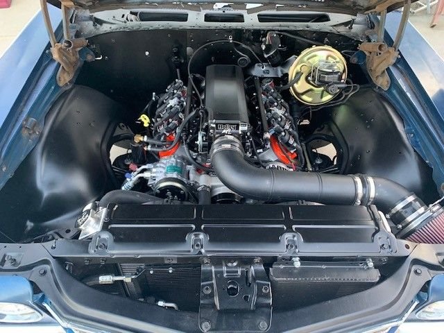

LS3, ICT billet low mount alt, CTSV factory power steering bracket, Alan Groves low mount A/C - all on Corvette spacing.
