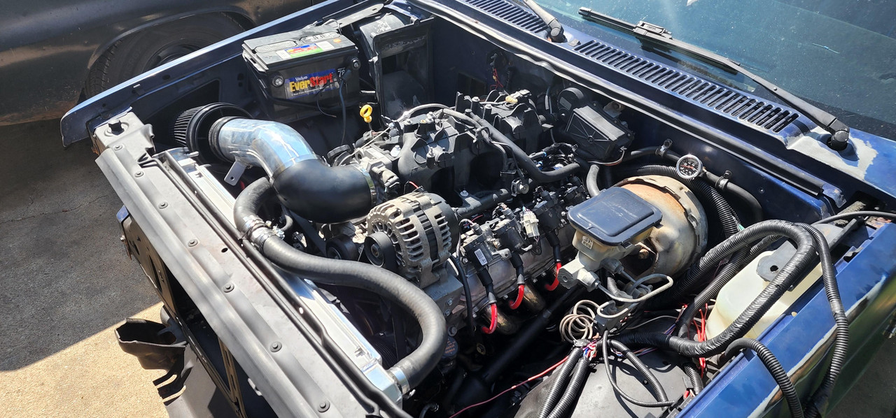

For the past 2 weeks i've been doing a swap on an 84 S10. Just finished yesterday and the guy picked it up. Was an absolute pain, only because I didn't know what to expect before the swap. I assumed being a chevy it would be smooth as butter. It showed me otherwise. Absolutely gave me an *** kicking lol. Was actually easier to LS swap the Cuda... lol. But I got it done and the guy got a running and driving S10. Only paid me $2000 for labor. He definitely got the better end of the deal lol.

Curious what on the s10 did you struggle on? It's not easy getting the actual engine in with a trans on it, which still baffles me, but once it's in. I guess I've done mine more than enough, so I've forgotten the struggles. I did my swap 10 years ago.

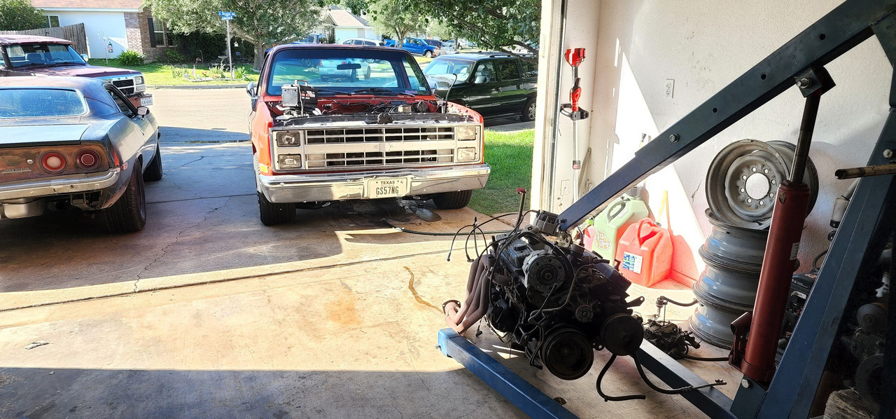

Just not knowing ahead of time that you have to notch the frame so the oil pan clears, then you have to absolutely destroy the passenger side corner of the firewall. I took the engine and transmission out, without exaggerating, 13 times. Then, i got it all in, bolted down, go to start it to build oil pressure and it started making a metal clanking sound... Had to pull it, pull it all back apart to check it, put 3 different flex plates on it, along with 2 used starters to figure out it just needed a new starter. Then, after that I got it all back in, bolted in for good then was able to finish the swap. Took me 4 days to get it bolted in. Took 4 hours to get it running... lol. I posted 2 videos on youtube of the swap but I stopped recording after the 2nd video because it was just a debacle after that day.
Now im working on an 85 c10 shortbed. Its getting a completely rebuilt LQ4 with a monster cam in it. I might make videos on this swap as it should be MUCH easier.

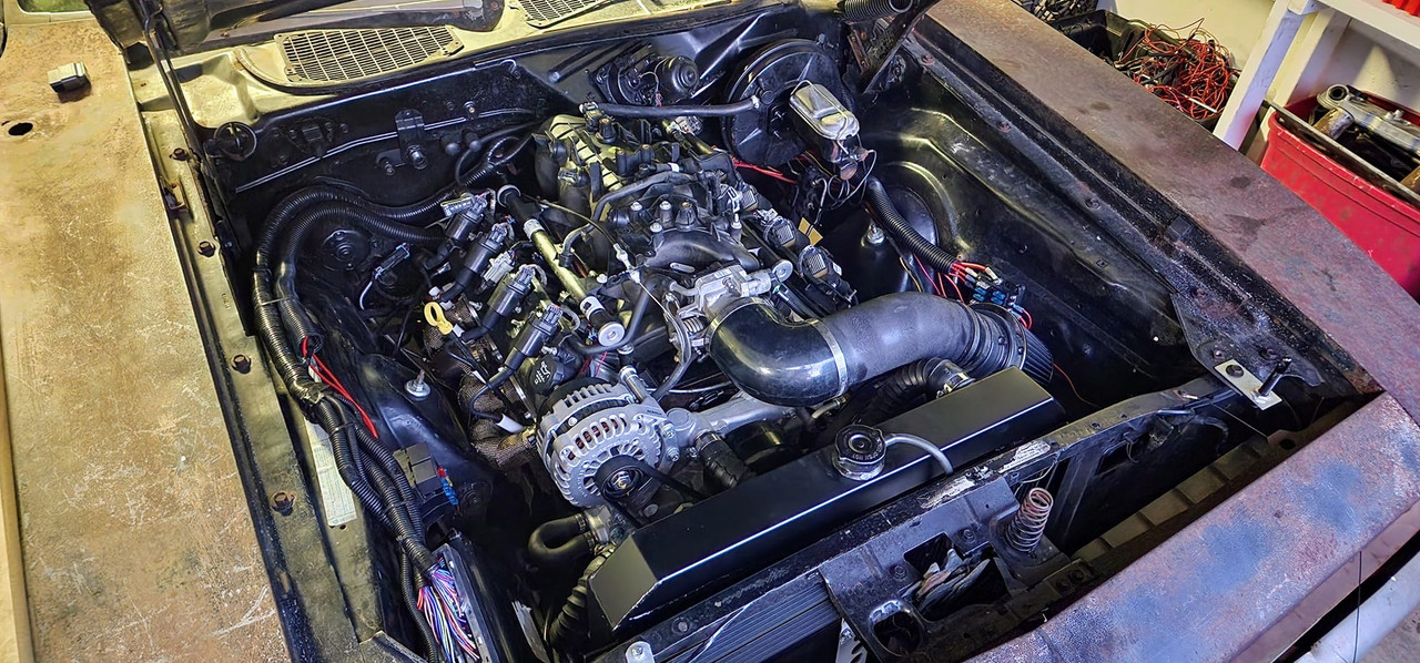

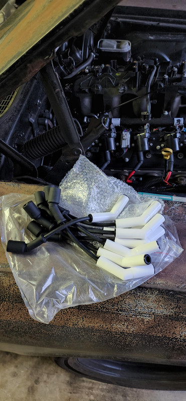

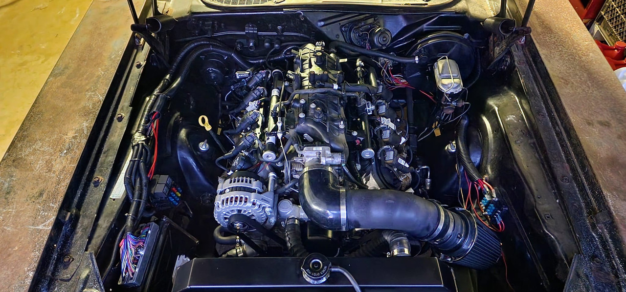

Well that c10 is done and out of the way. After hearing the cam in it, i really want to cam the Cuda now. But, still not happening anytime soon. The first swap I did is back for some minor work and im cleaning up the rats nest of wiring brought to me by a guy that did his own swap.... But, I found some time to mess with the Cuda. I got to finally painting the radiator and putting on a set of black spark plug wires which are also porcelain on the ends. They were only $75 on Amazon.

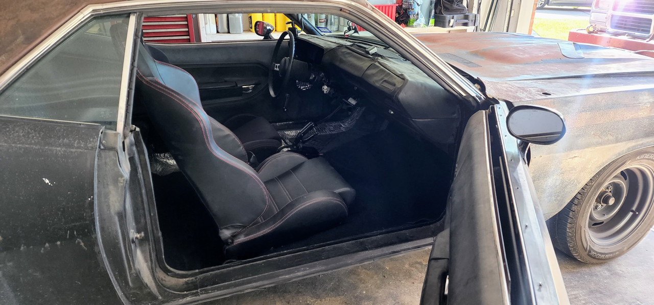

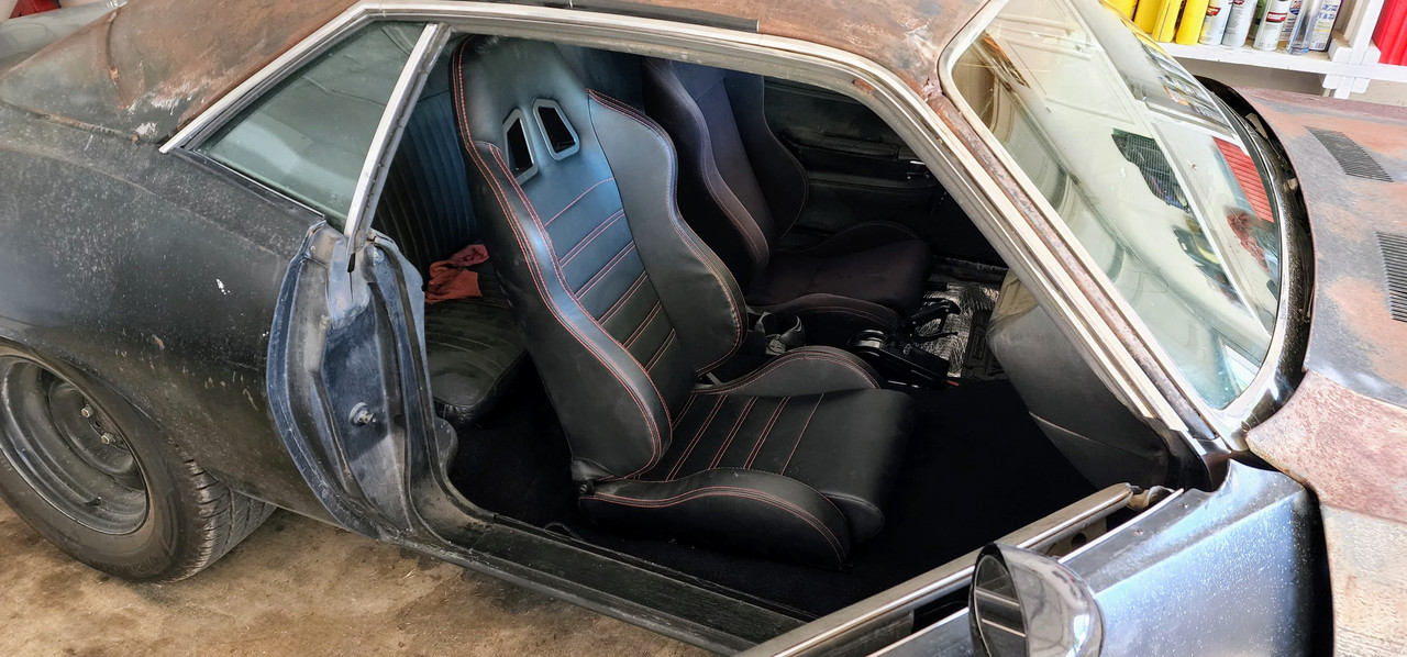

Finally got around to putting a passenger seat in the Cuda. Found it for $40 on marketplace. It has sliders but no handle... But not hard to slide if i need it to. I also finally put in some ebay carpet i bought a couple months ago. Just need to order more and put it on the driver side.
