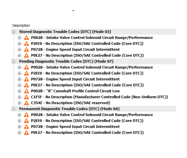

that is first thing i checked the fuses and the ground, but i noticed that the injectors are not triggering, i scanned it here is a list of the errors. my harness that i got is from HPI, the VSS and reverse lock are not connected. also, my clutch wire is to to be +12v or ground when in the pedal is pressed?
