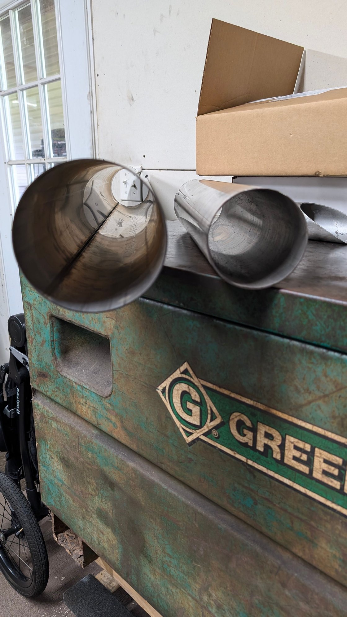

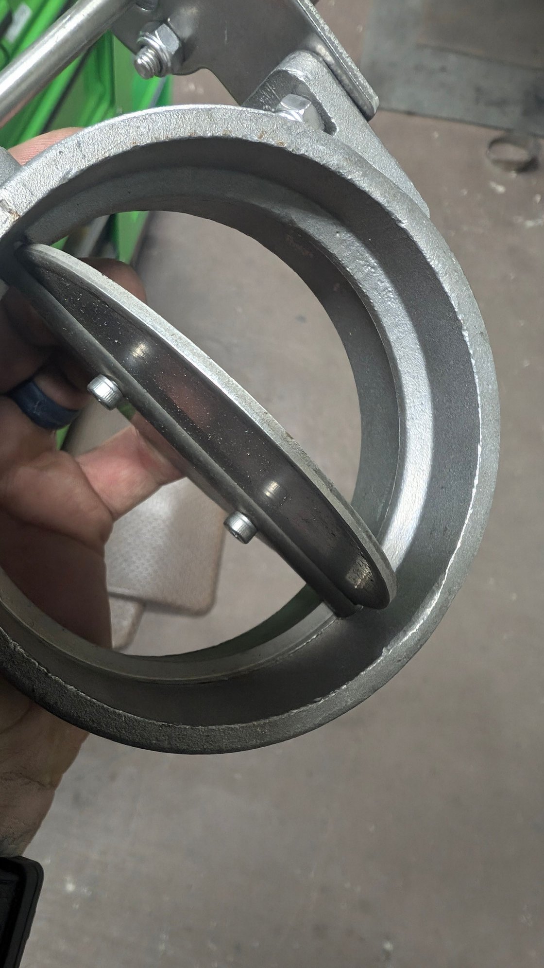

The difference between 4 and 5 inches was significant. Stepping up to a 5inch is like adding a whole nother 3 inch to your 4 inch.
The 4inch loud valves smallest cross section is 3.650 where the blade seals.

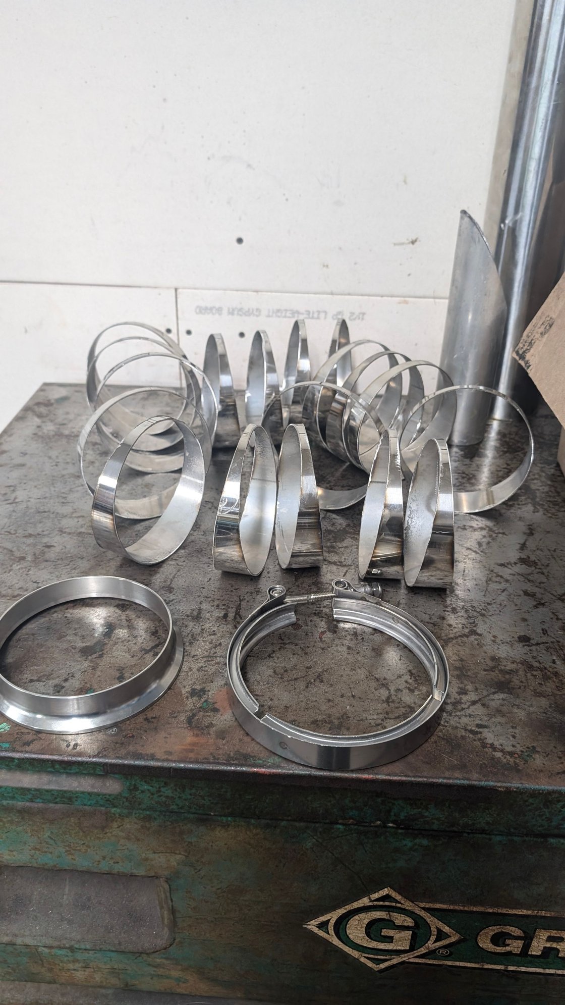

Ended up having to weld over 25ft
I was able to do some back to back testing with the downpipe size. On the same tune-up boost pressure dropped 2 psi throughout the whole run and ran the same ET but on less boost and with a worse 60ft.

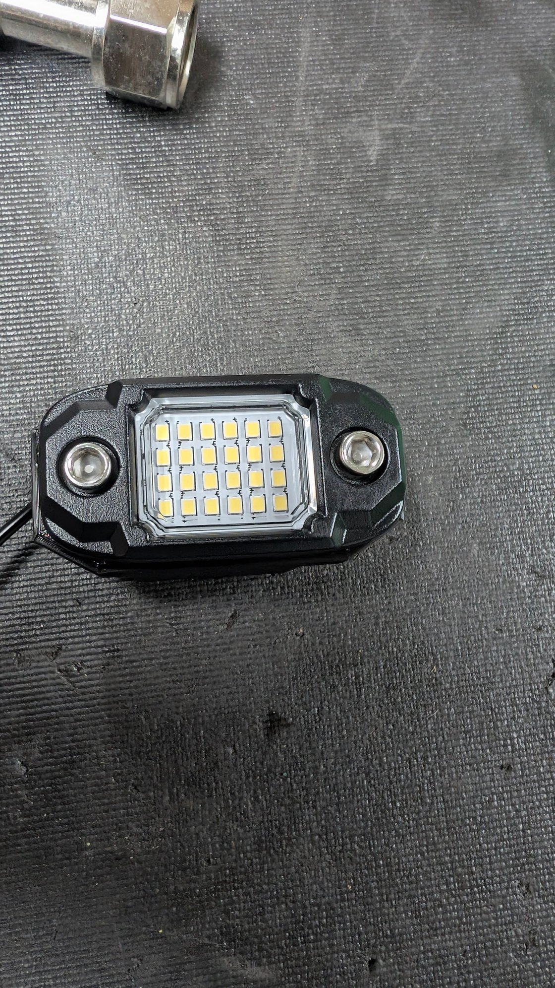

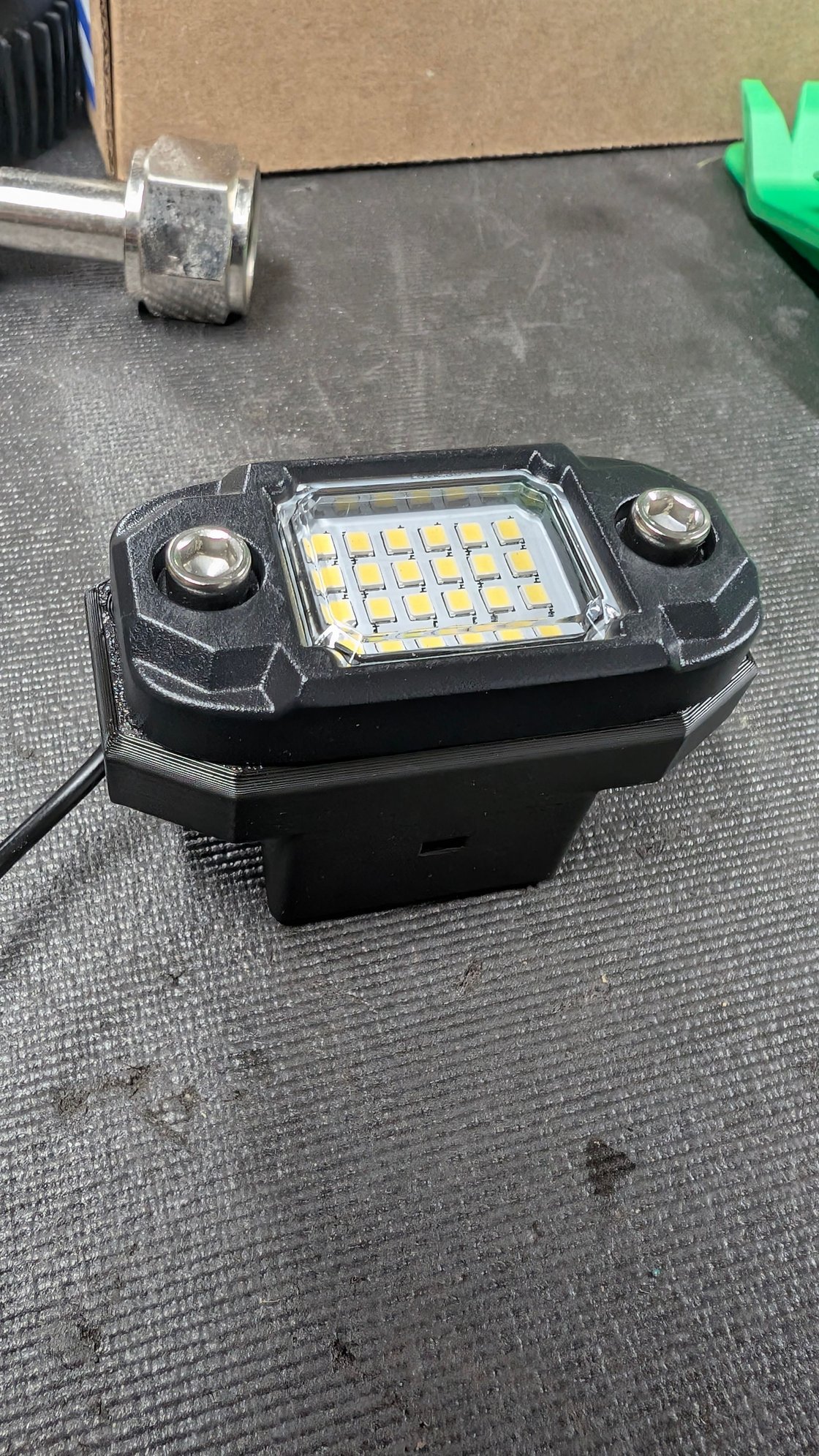

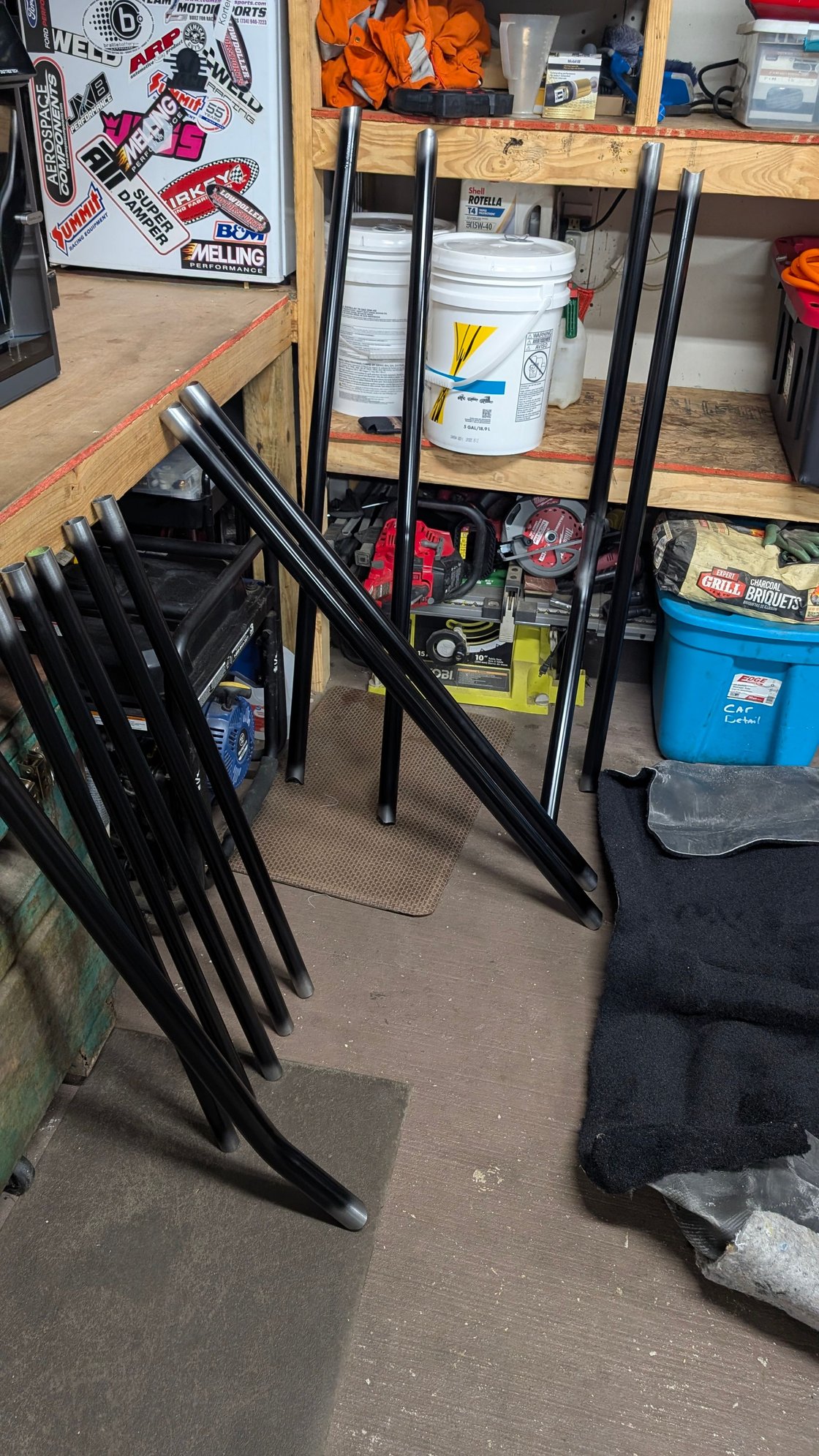

Designed and 3d printed some mounts for these lights to put under the hood and on the roll cage. Didn't plan on mounting any on the hood like I did but it turned out pretty good.
Decide to pre paint some of the bard that weren't already installed in the car.

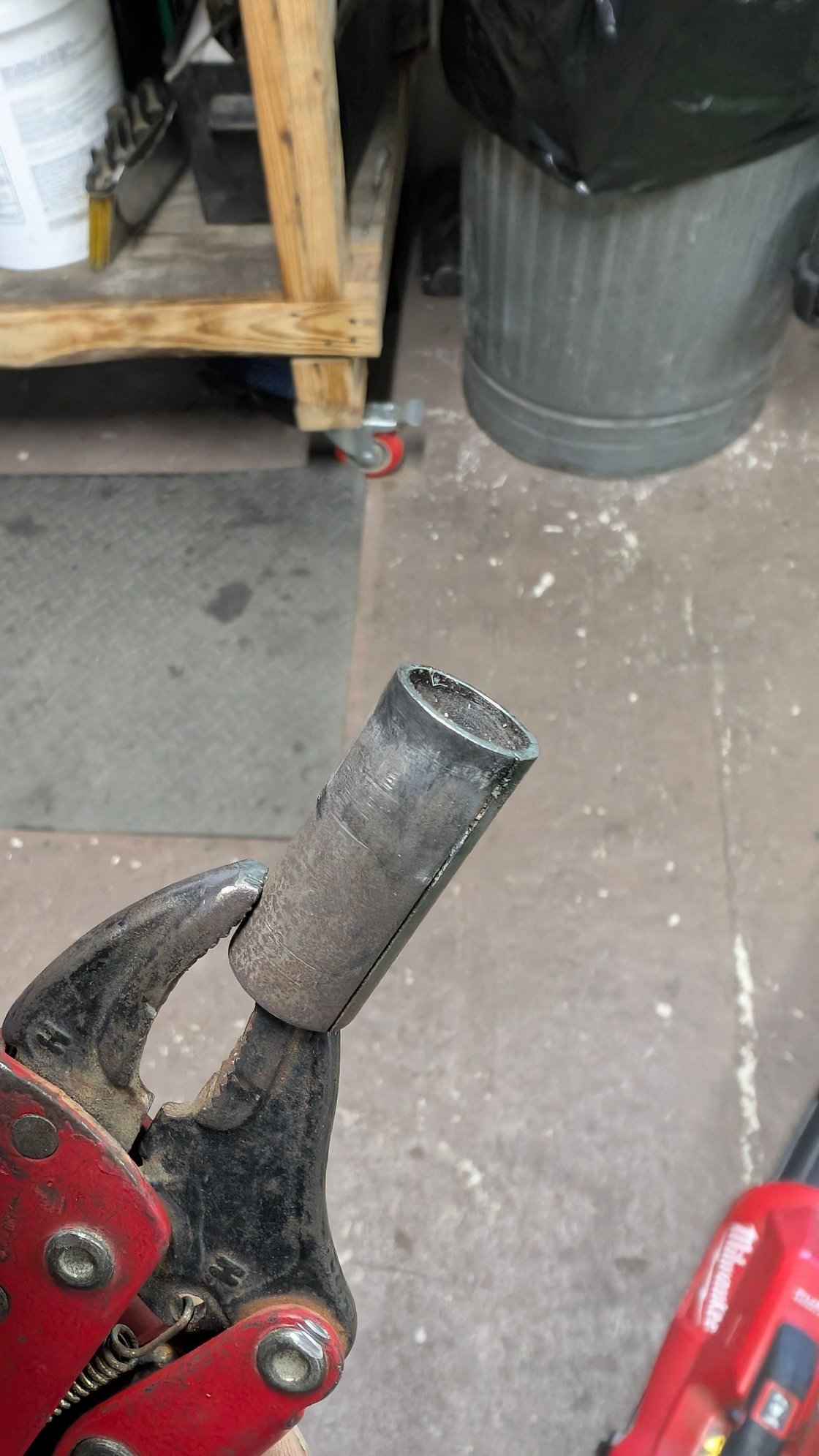

Heating this up with a torch to melt holes in the carpet for seat bolts worked out perfectly.

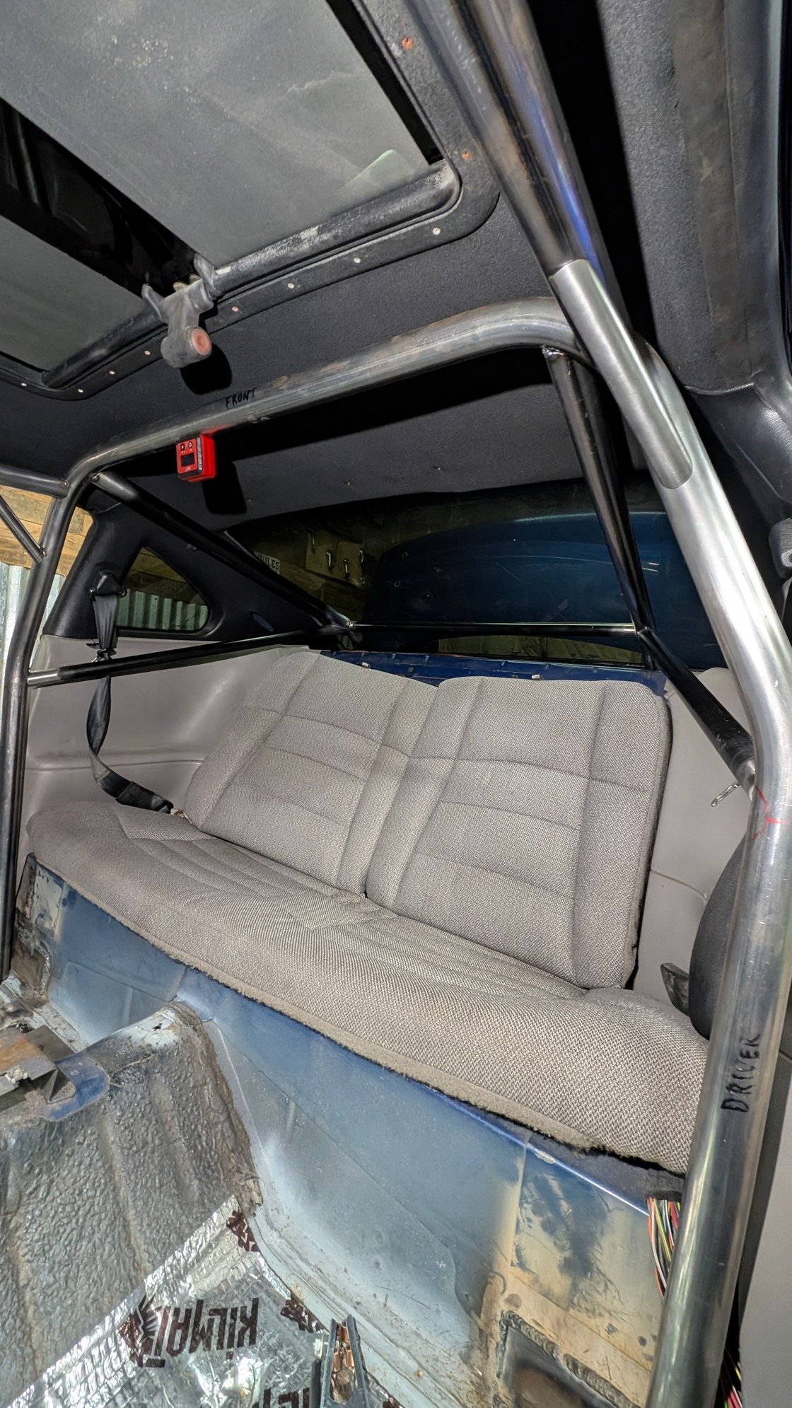

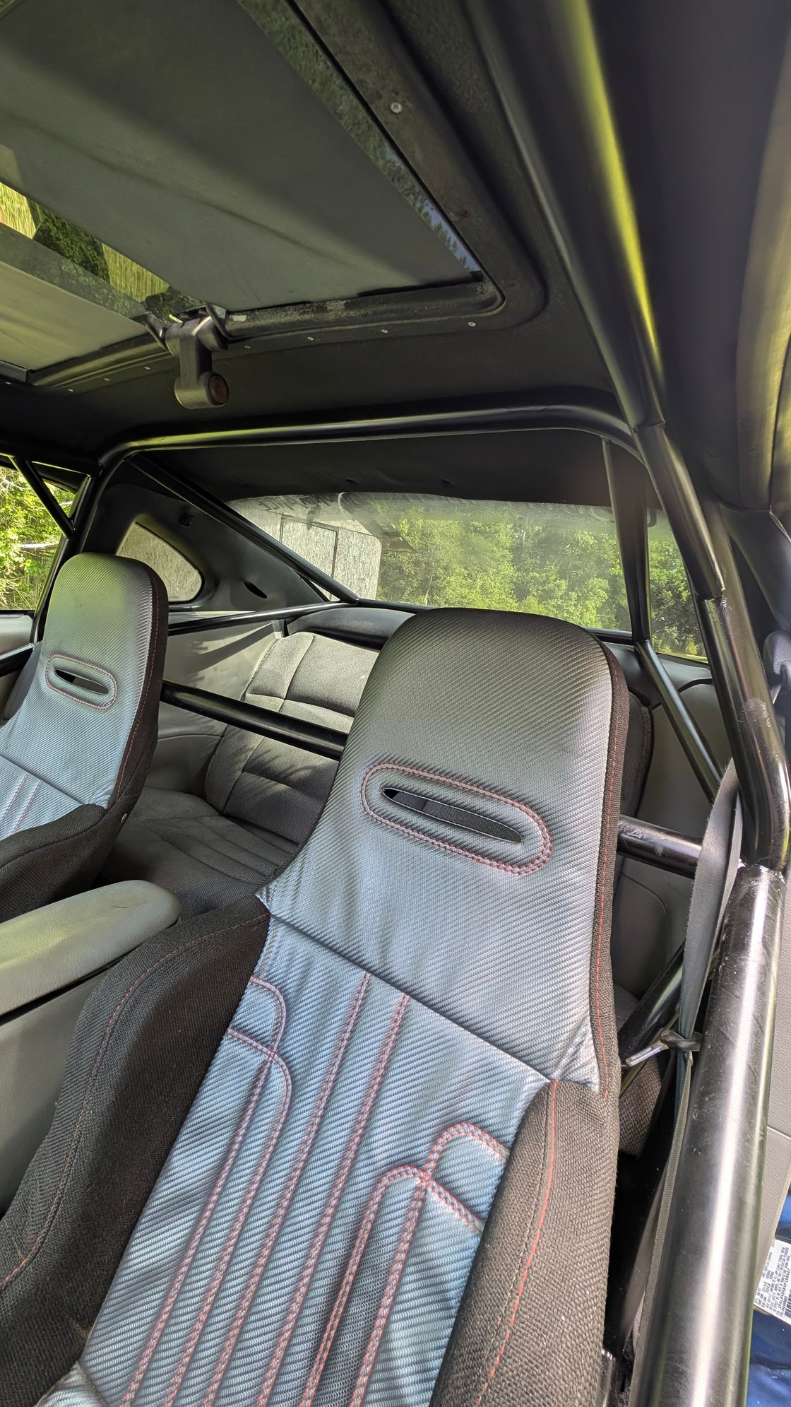

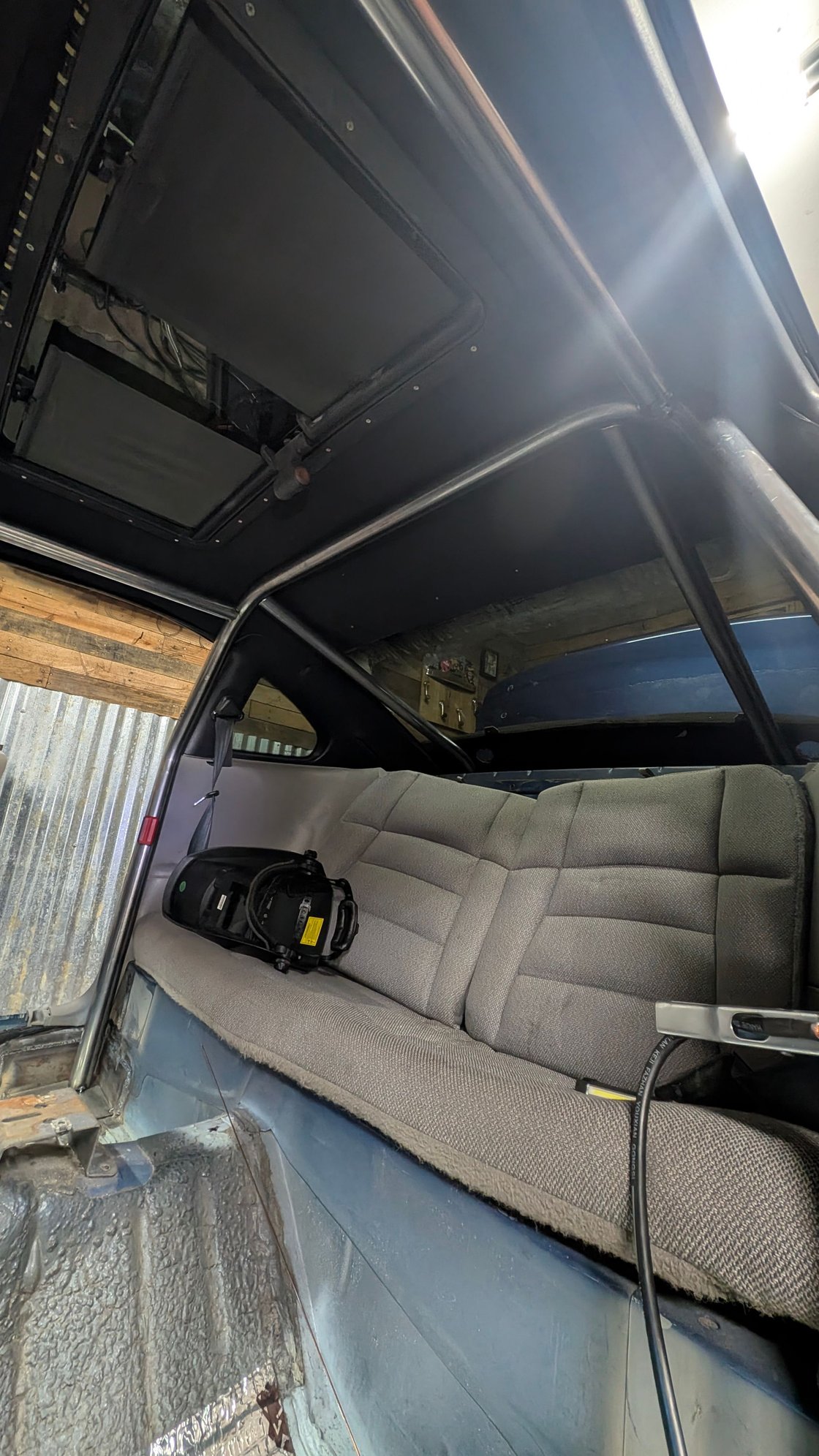

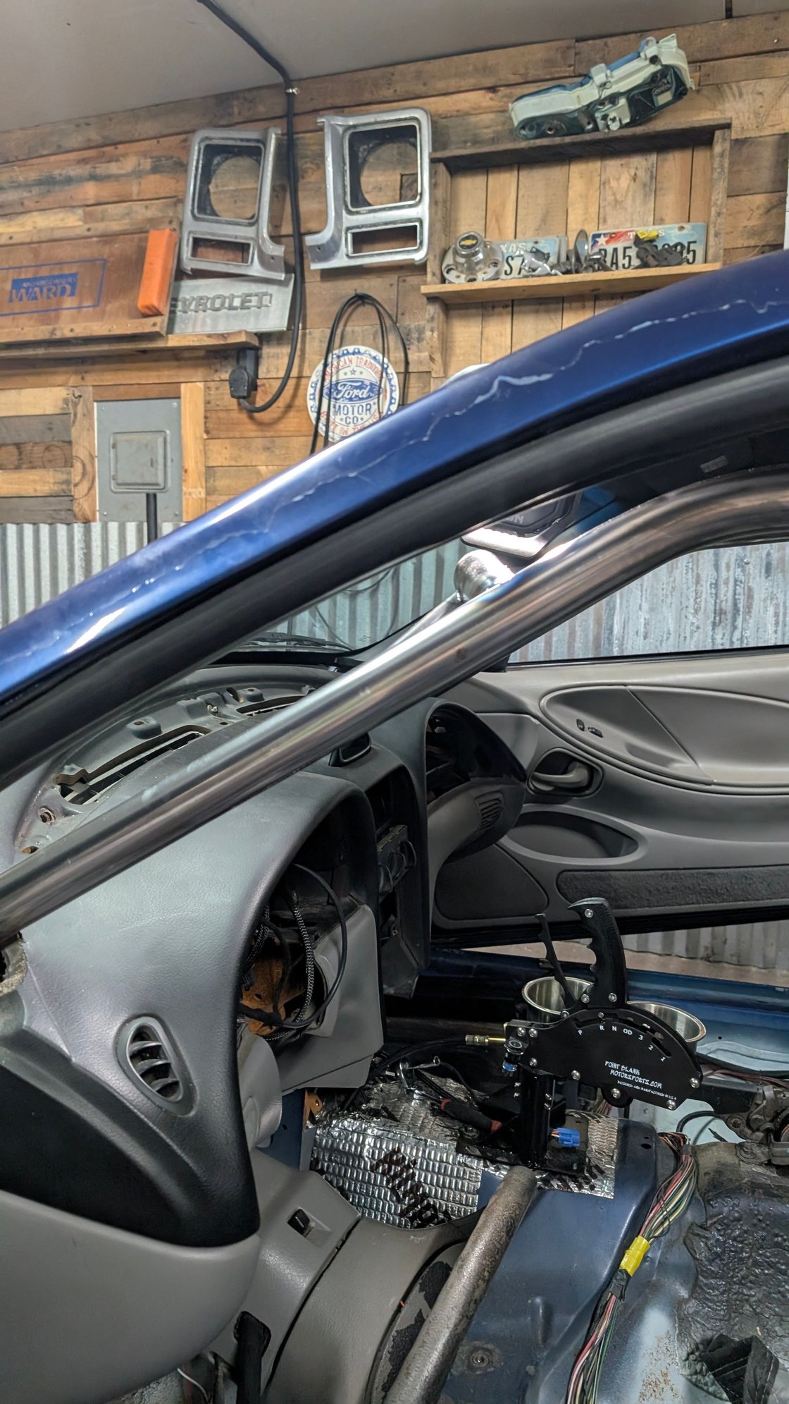

Codions 8.50 cage fits really nice. As much as a hate cages in cars this car for sure has needed one. I already hate getting in and out of the car lol.

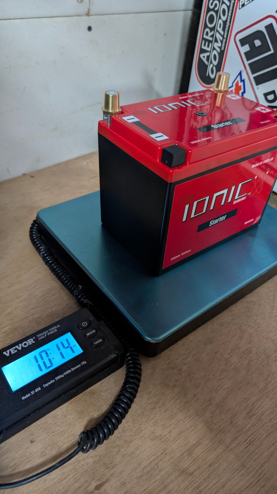

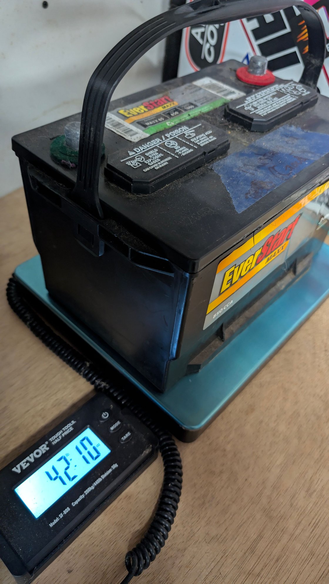

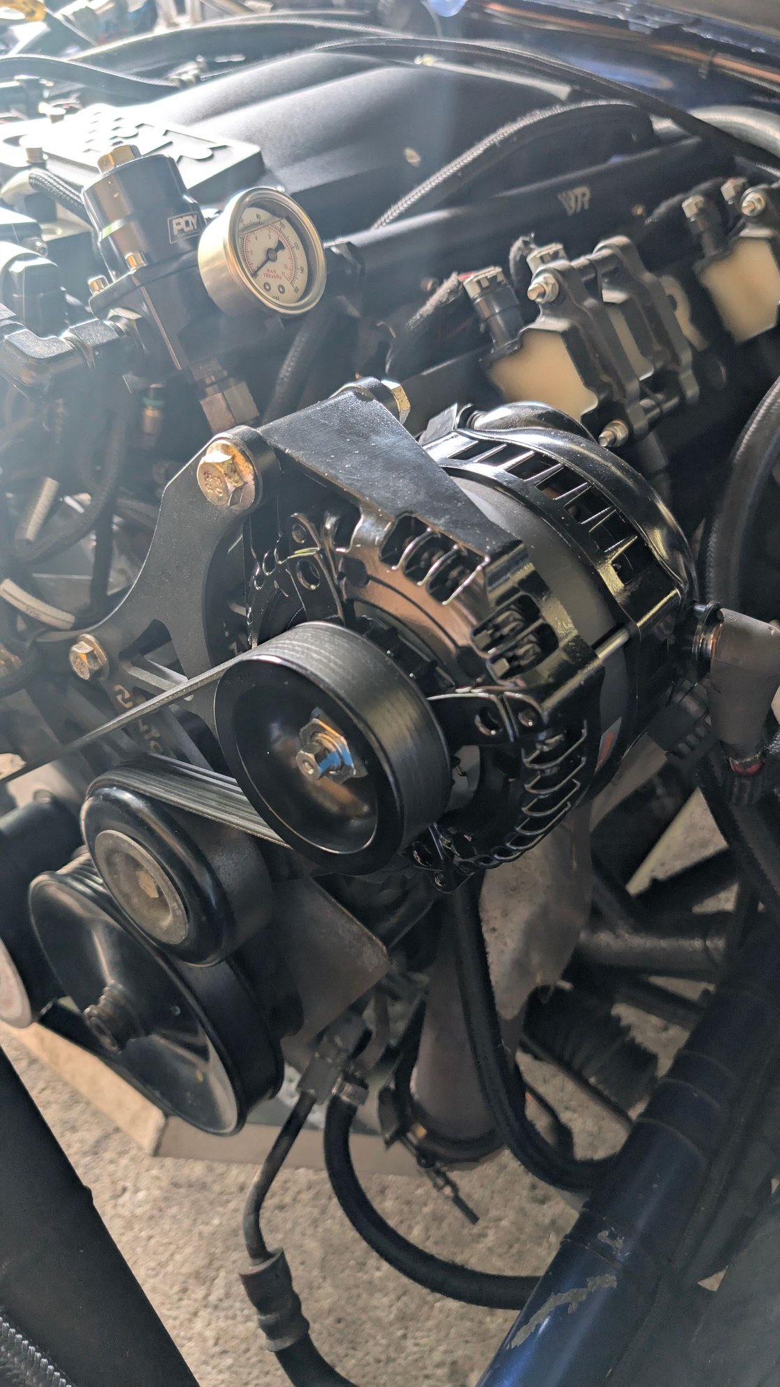

Made the switch to a mechman 240amp alternator and a ionic lithium battery. Was able to save a or 32 lbs on the battery and it's 1220 CA. Voltage stays above 13.6 at all times now.
