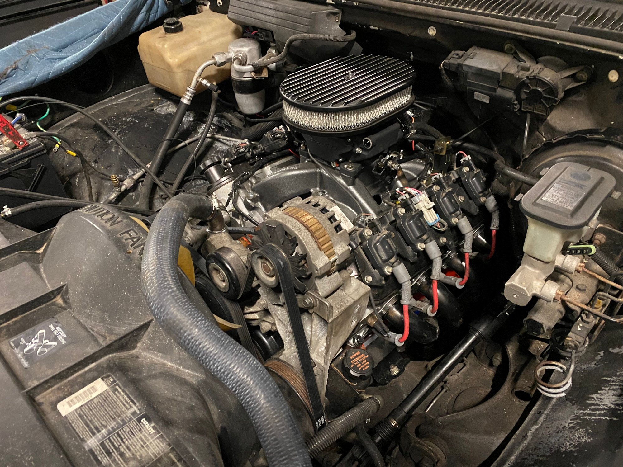

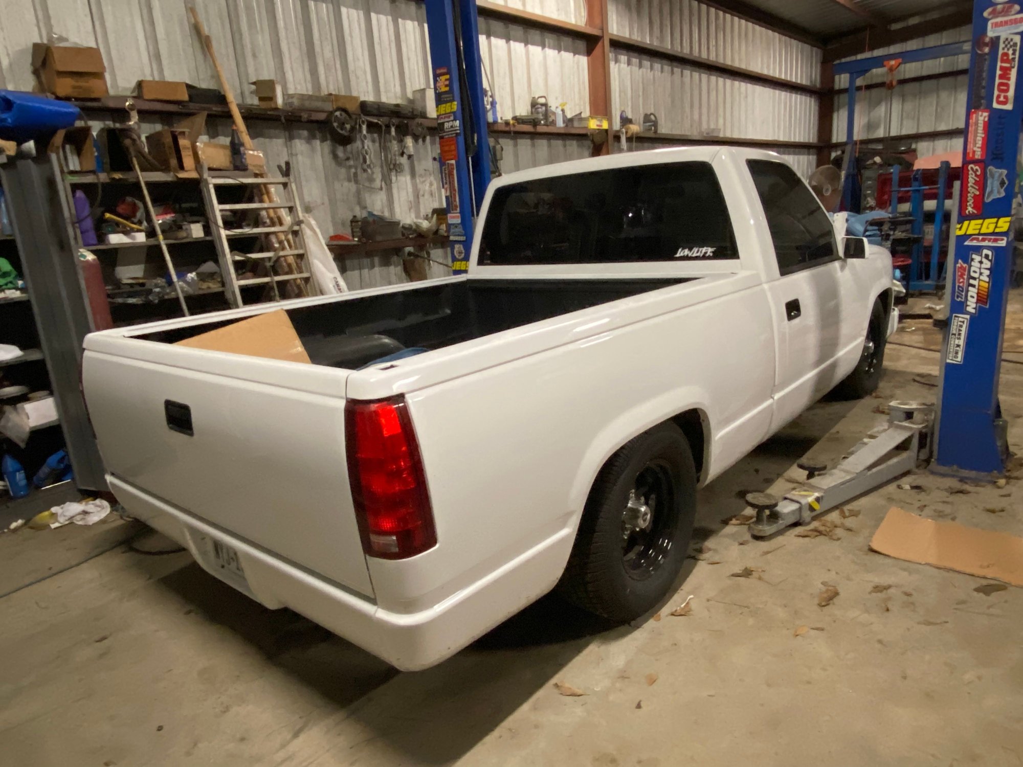

Got this from a friend that ran out of cash. Made a trade and been trying to finish it.
New paint, new interior.
04 5.3, ported and milled 243s, little chopper cam. TH375 for now that has a 3800 converter. 3.42 rear gear.
going to be a bad *** cruiser.
chased my tail getting it to run. Down to needing to figure out a start and idle issue. Have to hold the throttle open for it to run. I’ll hopefully get that situated tomorrow

turns out 1/8 of a tank is empty….
lol
filled it up and she runs fine. Just the TH375 shifts way too soon.
need to get a 80 in there with a manual trans controller

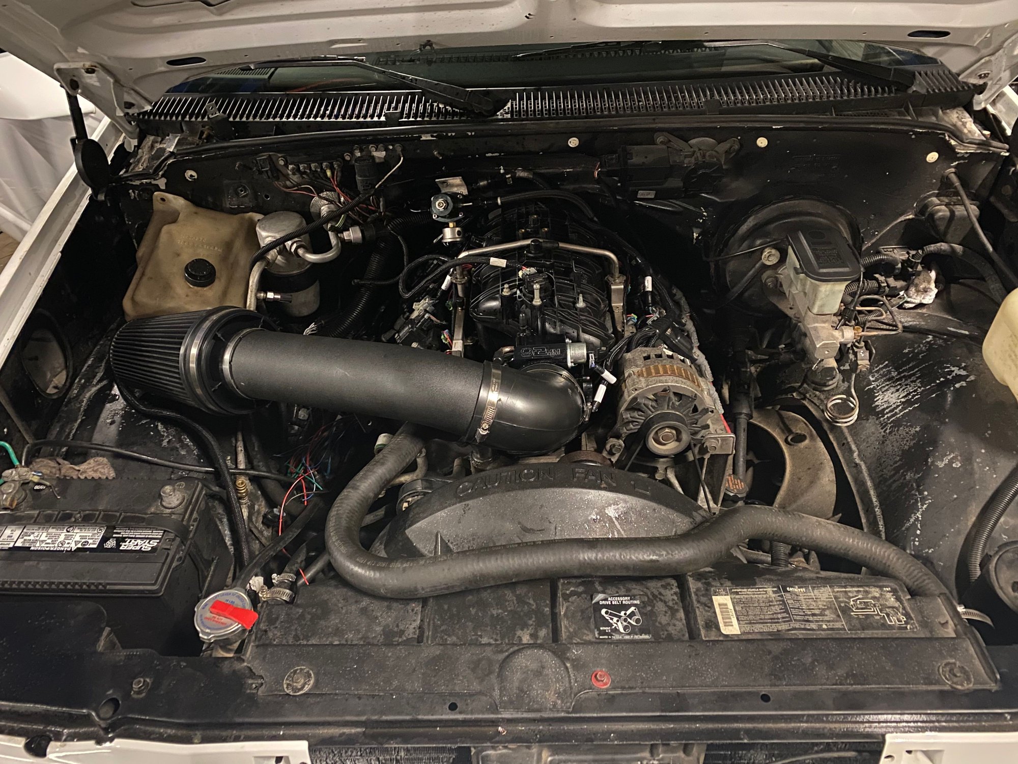

Landed a L76 for this thing today. At least that’s what I assume it is. Has dish pistons. So I’m just going to use my LY6 short block and swap pistons in the aluminum block later
terminator X is in. Have a NNBS intake ready to go. I’ll see if that gets this thing running right til I swap in the 6 liter

Moving right along. Have to wire everything in tomorrow and hopefully it does it’s job. Terminator X conversion

so far it is rather easy. I’m used to my f body’s and mustangs. So this has more room everywhere.
but, to get this look, it’s a C notch, axle flip and other **** that isn’t exactly super quick.
as for the EFI, it’s pretty simple for install. But the thick harness getting in to the cab on some vehicles might be a bit of a issue that might require creativity

You'll like the TerminatorX and that intake setup way more than the Sniper. If I can help with the tuning, let me know.
Andrew
