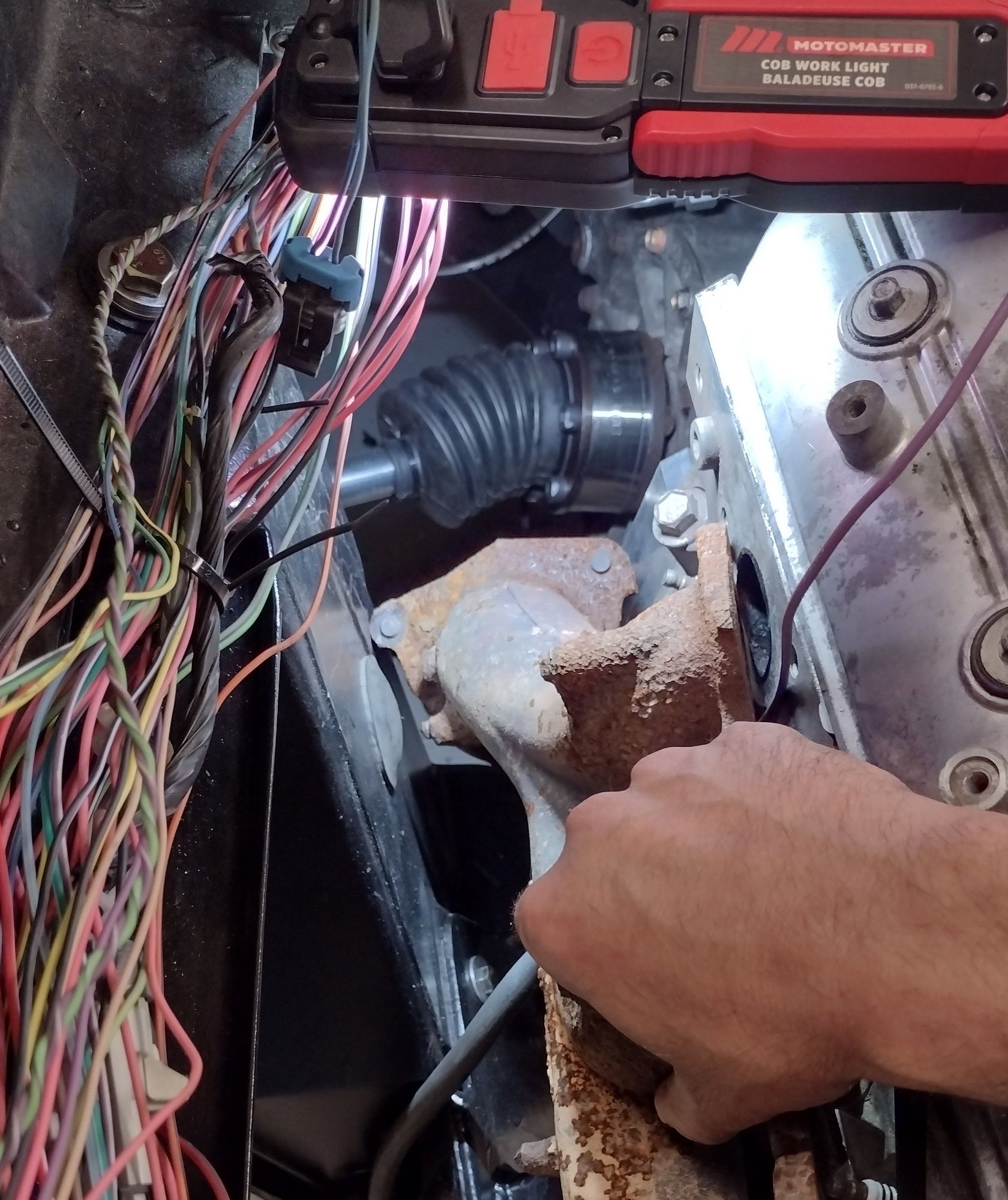

Hey guys,

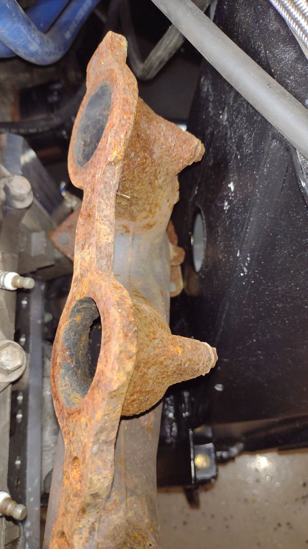

I think I'm down to the final couple hurdles in this LS swap and could use a hand if anyone is familiar with different headers. In a DeLorean so space is at a premium. These are the stock manifolds for a 2005 L33 Silverado 5.3. The LH side could actually be fairly close, except the 3 bolt flange hits the chassis, so the manifolds can't press up against the heads. Same issue on the RH side, although it seems to be tighter (manifolds are asymmetrical so that side seems larger). Hard to get a wide angle photo, I'll try again tomorrow.
The 3 bolt flange style definitely seems to be a problem. (I was only trying these manifolds out since they came with the engine). My first thought was a turbo-style header that goes straight back (or forward in this case) but as you can see in the first photo, I need to go 90 degree down before the axle shafts, so some downward angle may be good. Additionally, turbo headers seem to be 3", which is far too large.
Looking at photos, GTO headers seem to go too low to clear the DeLorean crossmember. Corvette seems to exit too downward as well.
Something with this truck angle, but closer to the block, and a smaller flange would probably fit the bill. Any suggestions?
(Hard to see in the photos, but I think if the manifold could get closer to the head, the 3 bolt flange would stick out even farther, making the below style fit even less.
Thanks guys!

Roger that, the reason I asked is that if you're just looking at a stock-ish build, why even dink around with headers at all? Iron manifolds will likely fit way better, be cheaper, quieter, and be overall less of a headache.
Old May 23, 2022 | 12:28 PM
Stangman81's Avatar
Joined: Aug 2021
Posts: 91
Unfortunately the stock truck manifolds i have don't fit (first post, all manner of flange interference with the chassis). Maybe there are some other ones that do fit better (Trailblazer/Envoy??) but I don't have at my disposal unfortunately (nor is Kijji offering up any deals). The reason I feel like I can be a bit riskier with cheap headers (mild or SS), is I could reweld the steel ones if need be. Am I thinking off-base here? I'd be all in with stock manifolds that fit though!

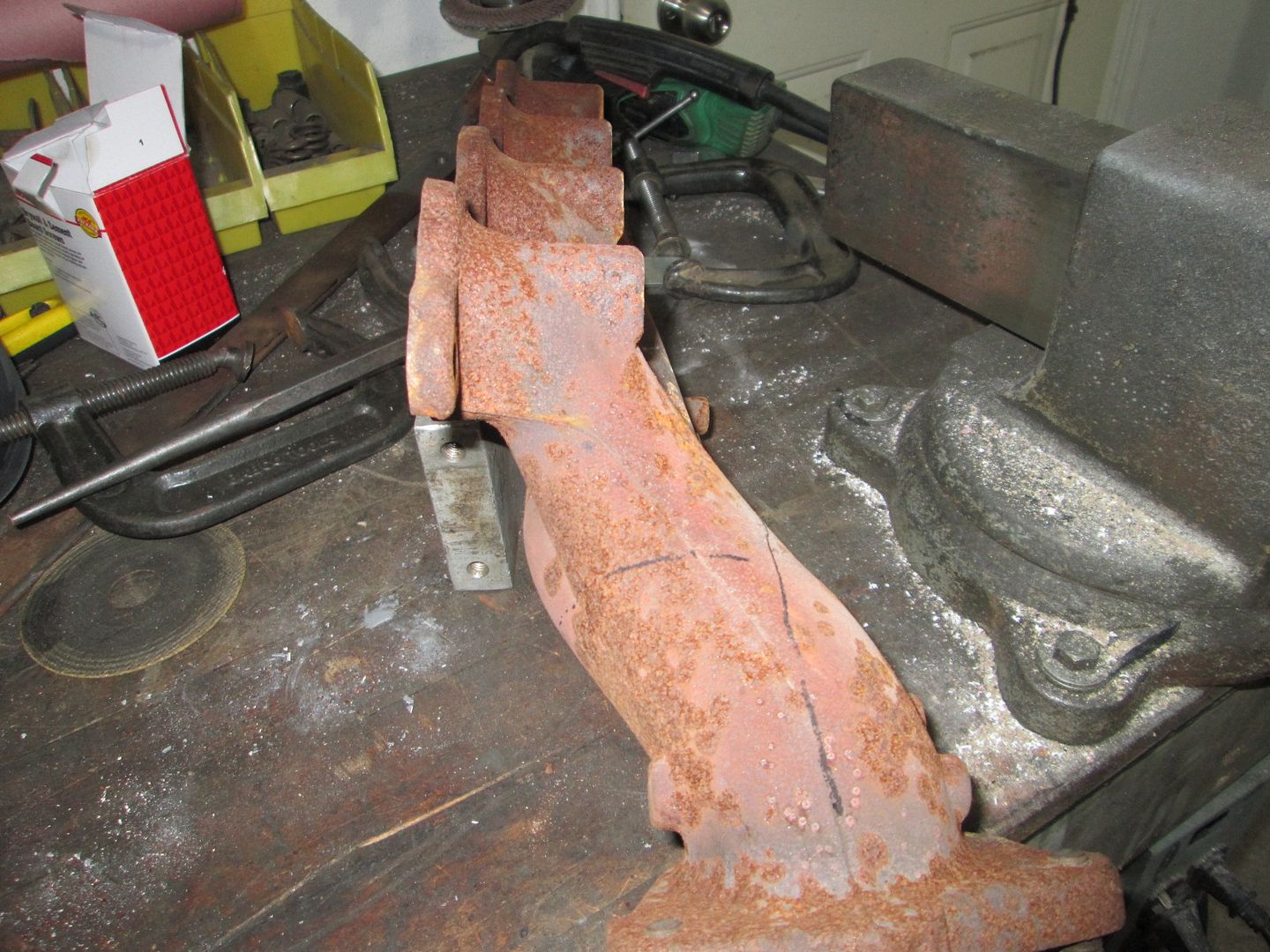

If the manifolds work except for the flanges, why don't you cut the 3 bolt flange off and weld on a v band. Turbo guys do it all the time.
Old Jun 4, 2022 | 07:57 PM
fieroguru's Avatar
Joined: Feb 2010
Posts: 906
Likes: 363
From: Champaign, IL
X2
I modified a truck manifold by cutting it along the sharpie lines and welding on a section of schedule 40 pipe. You can eliminate the kickout and add another turn down with a V-band in an area with better clearance.
